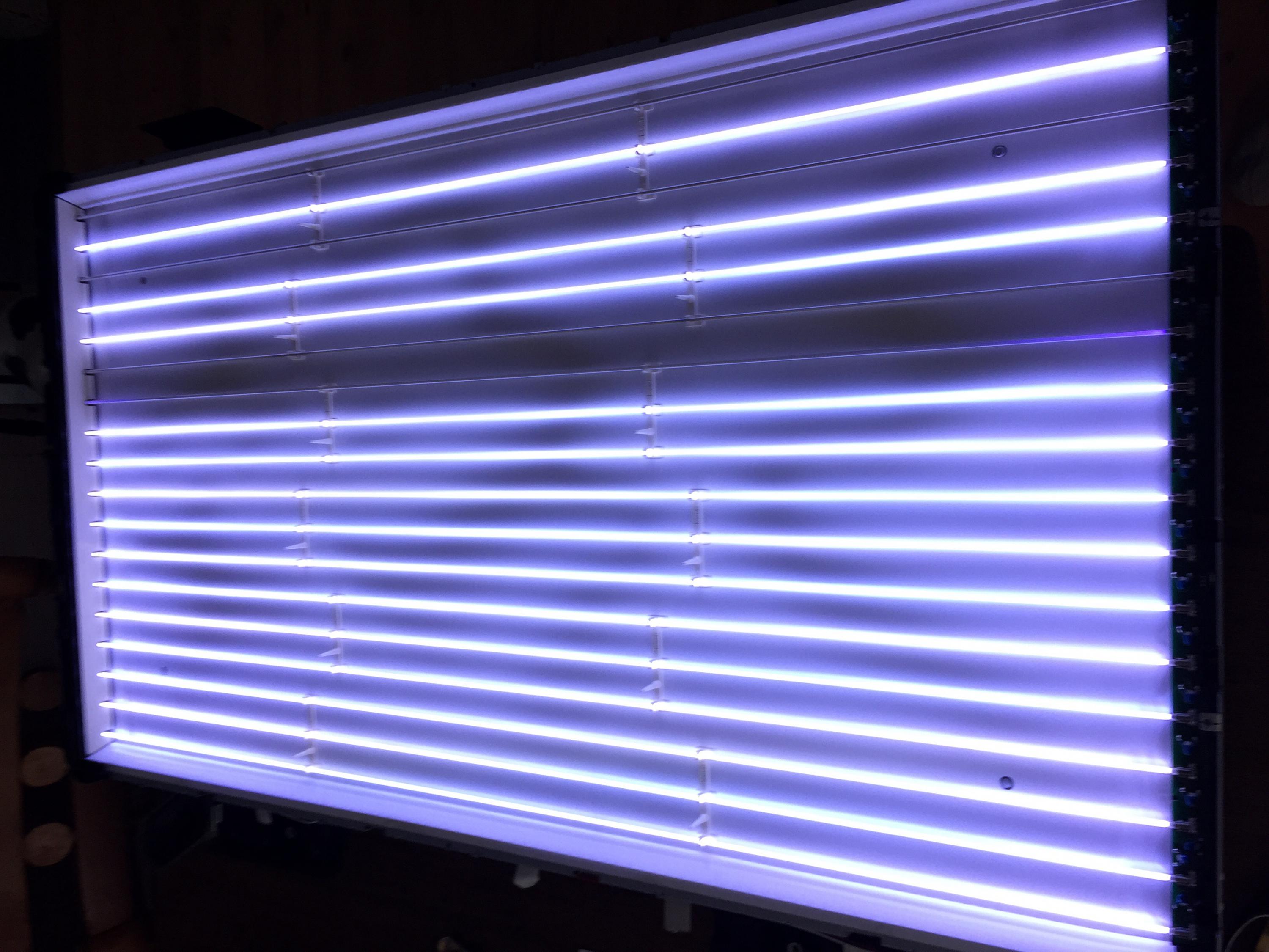

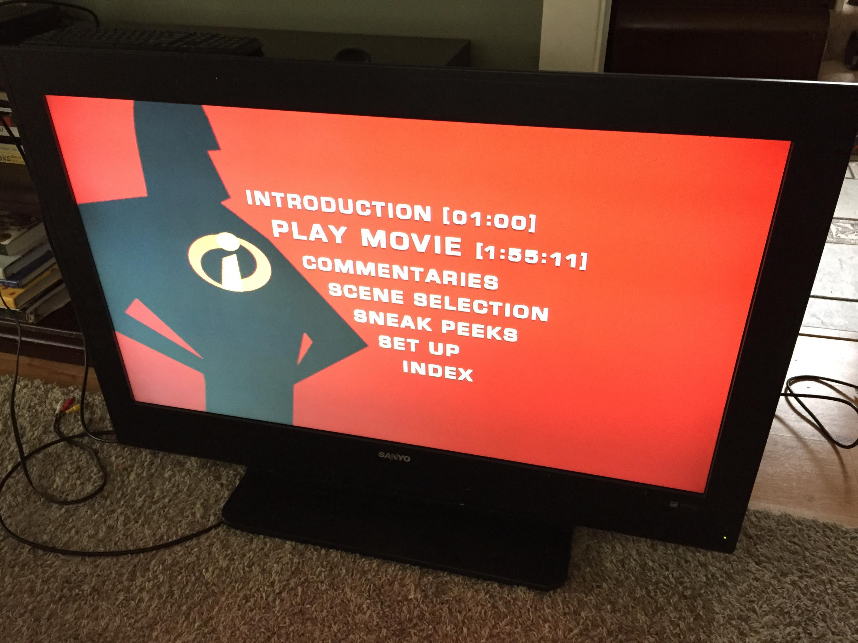

          Had another one come in today with the same fault. I was able to get it opened up, repaired, and buttoned back up in about an hour or so. This one had four bulbs out. I had a bunch of bulbs saved from broken screen sets.

            All buttoned up.
              #66
              Re: Another Sanyo DP42848 Good Sound/No Picture
              Nice fix ... Must be a common issue with those bulbs. Any issues with colour matching between them?
              • johnboy1313
                • Nov 2012
                • 1959
                #67
                The new bulbs had a little different shade of white, like they were almost pinkish. Once the screen was all back together, I see no difference whatsoever.
