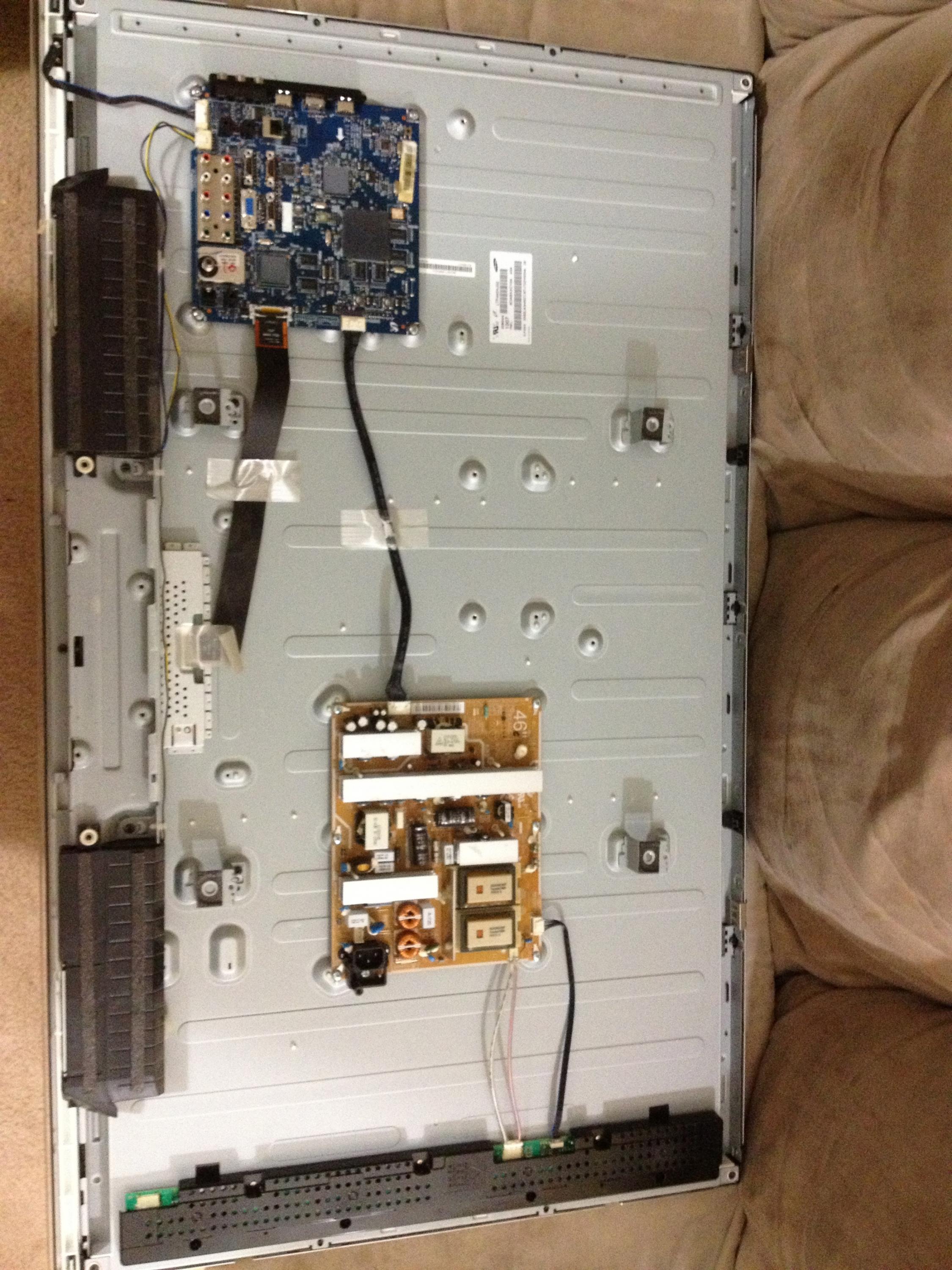

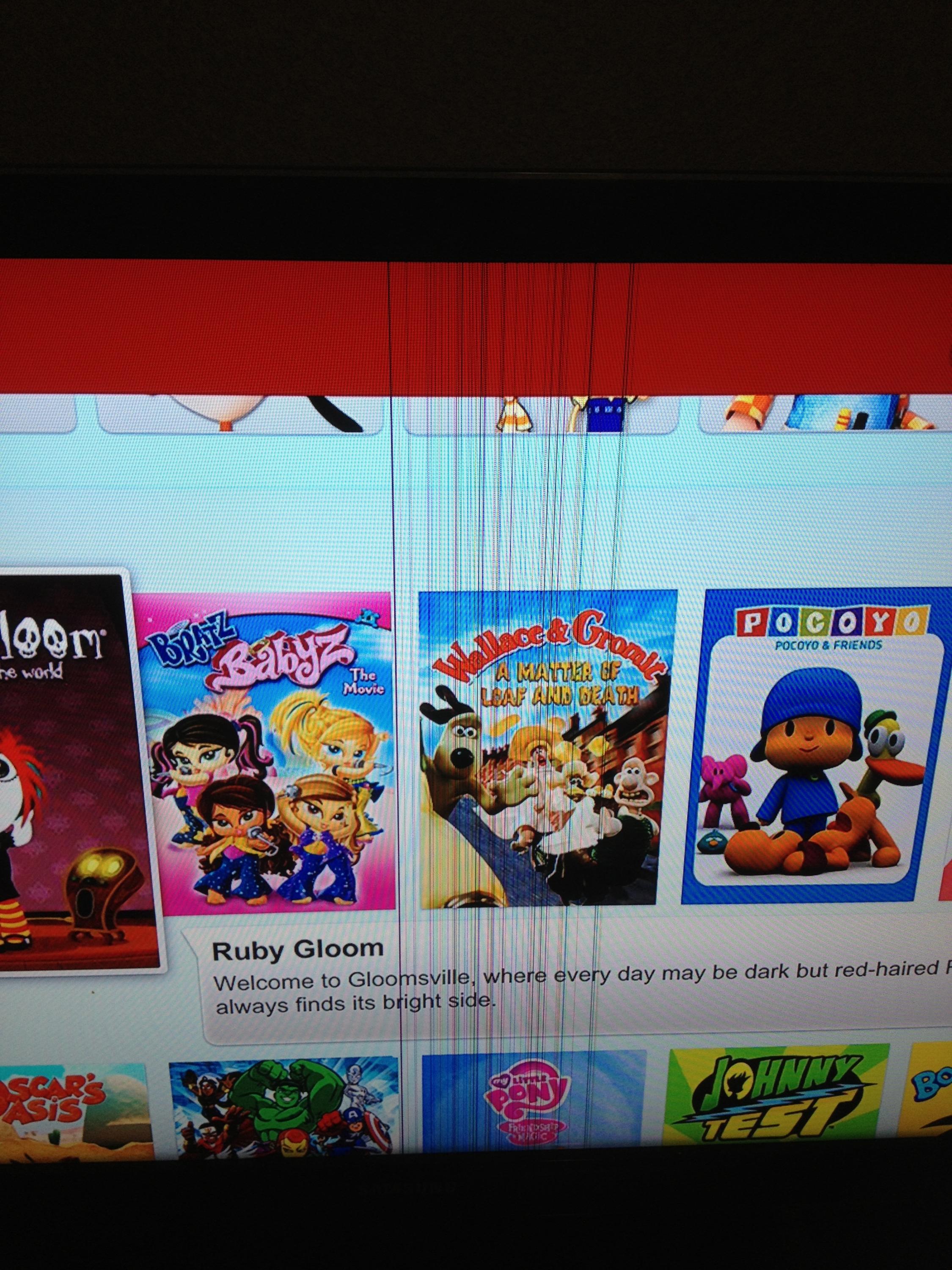

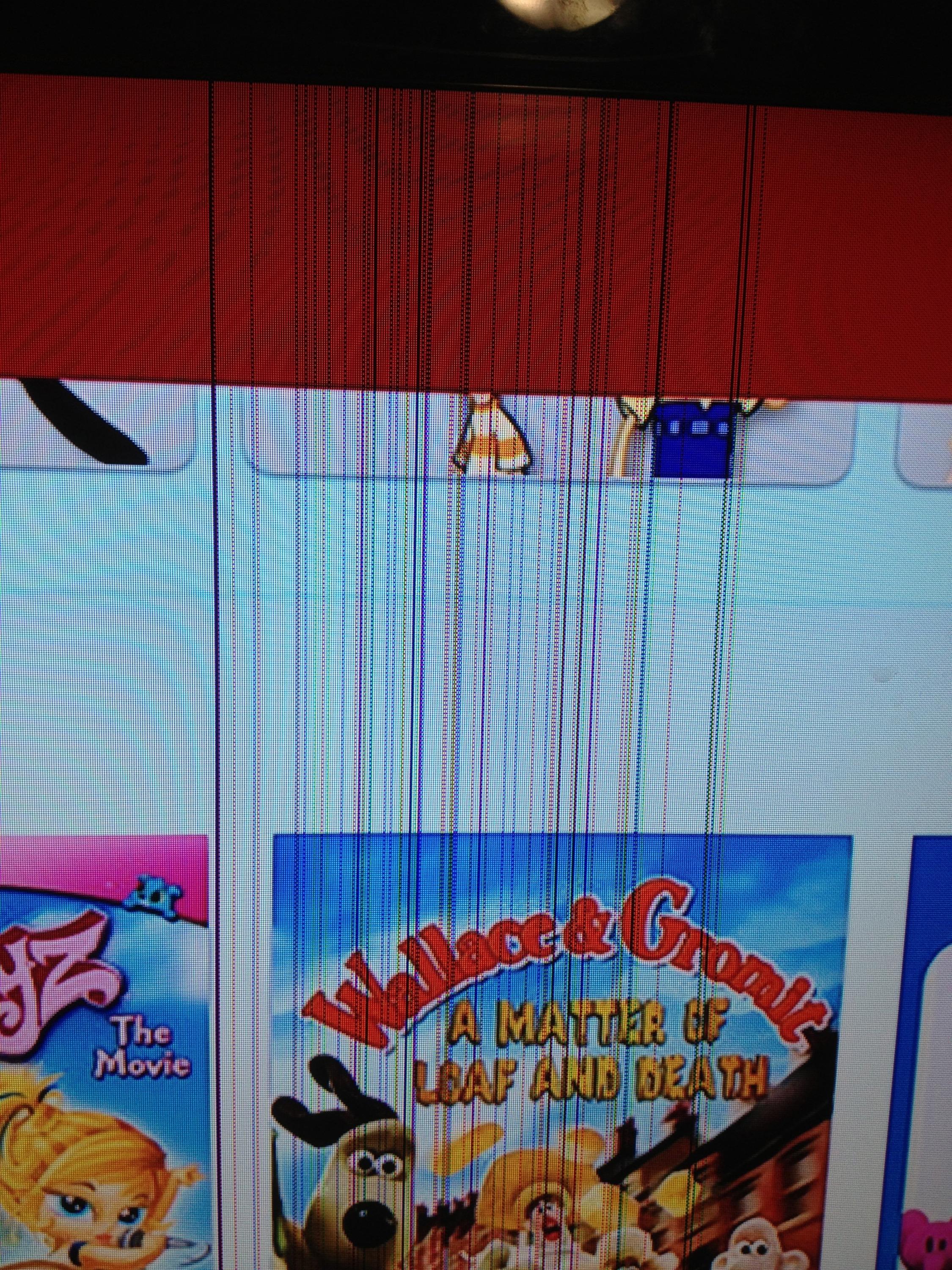

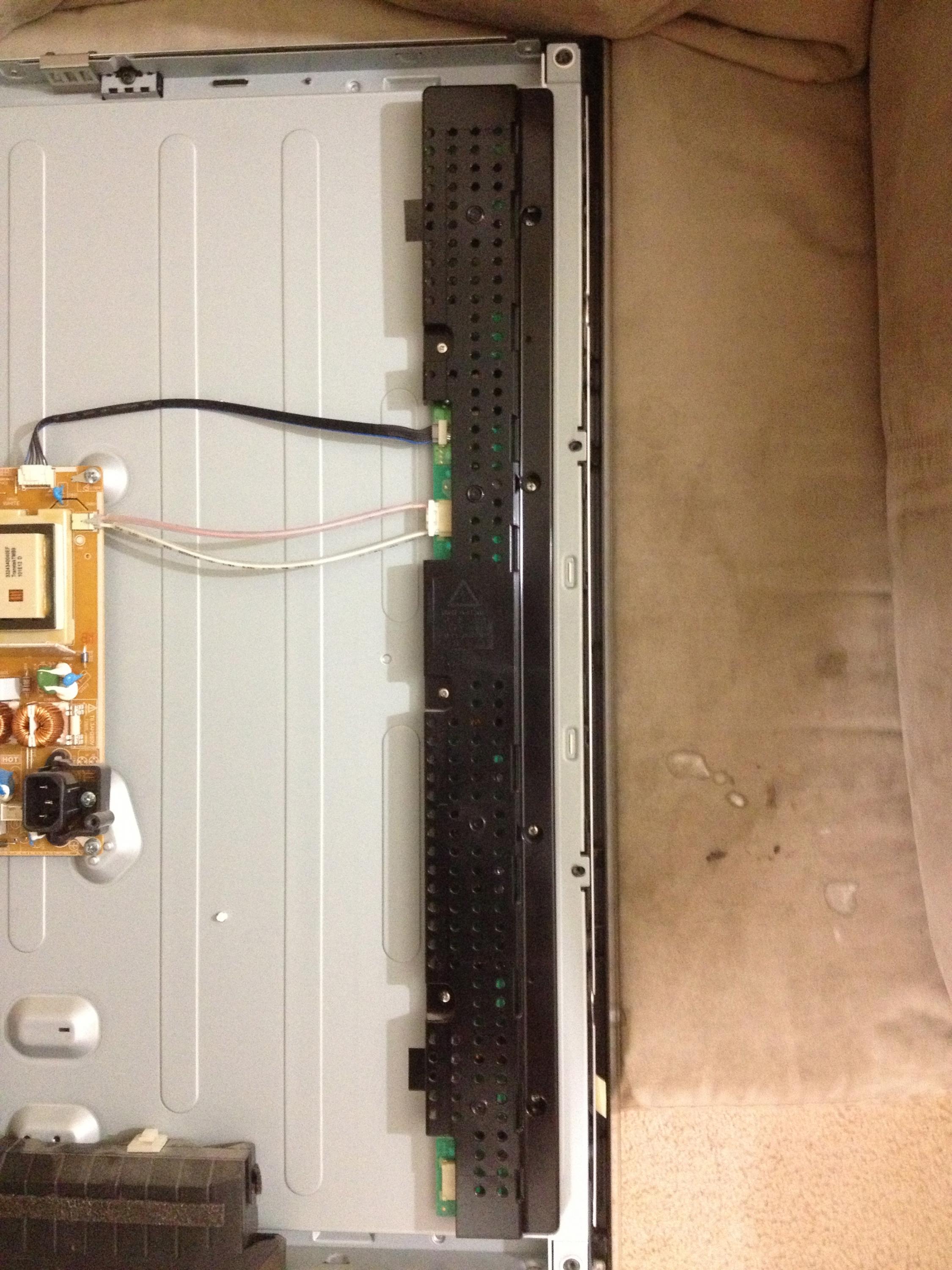

    Hello all, I have searched the forum for my problem and while I have found similar problems, I have not found my exact issue.
    I have a 46" samsung LCD that has decided it needs irritating vertical lines in multi color and one that is black (which worries me). I have tried re-setting the ribbon between the mother board and the screen which did nothing. Attached is a pic that I hope helps to illustrate my problem.
    Please let me know what you guys suggest as a repair while keeping in mind that while I am mechanically inclined, I know very little about TV's
    Thanks all
    Dan

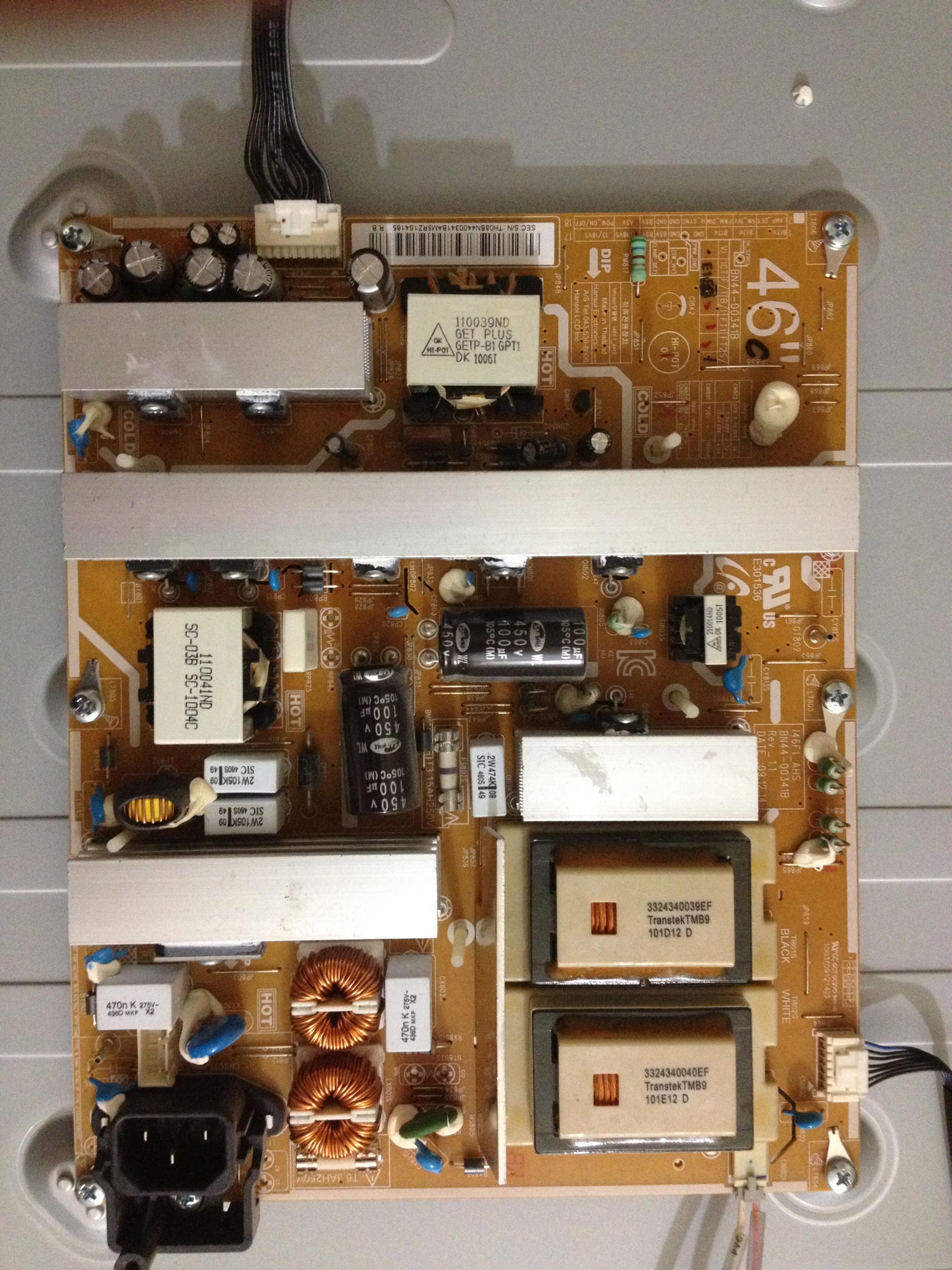

    You probably need to replace the LCD screen. But might as well open it up and post clear pictures of the insides.

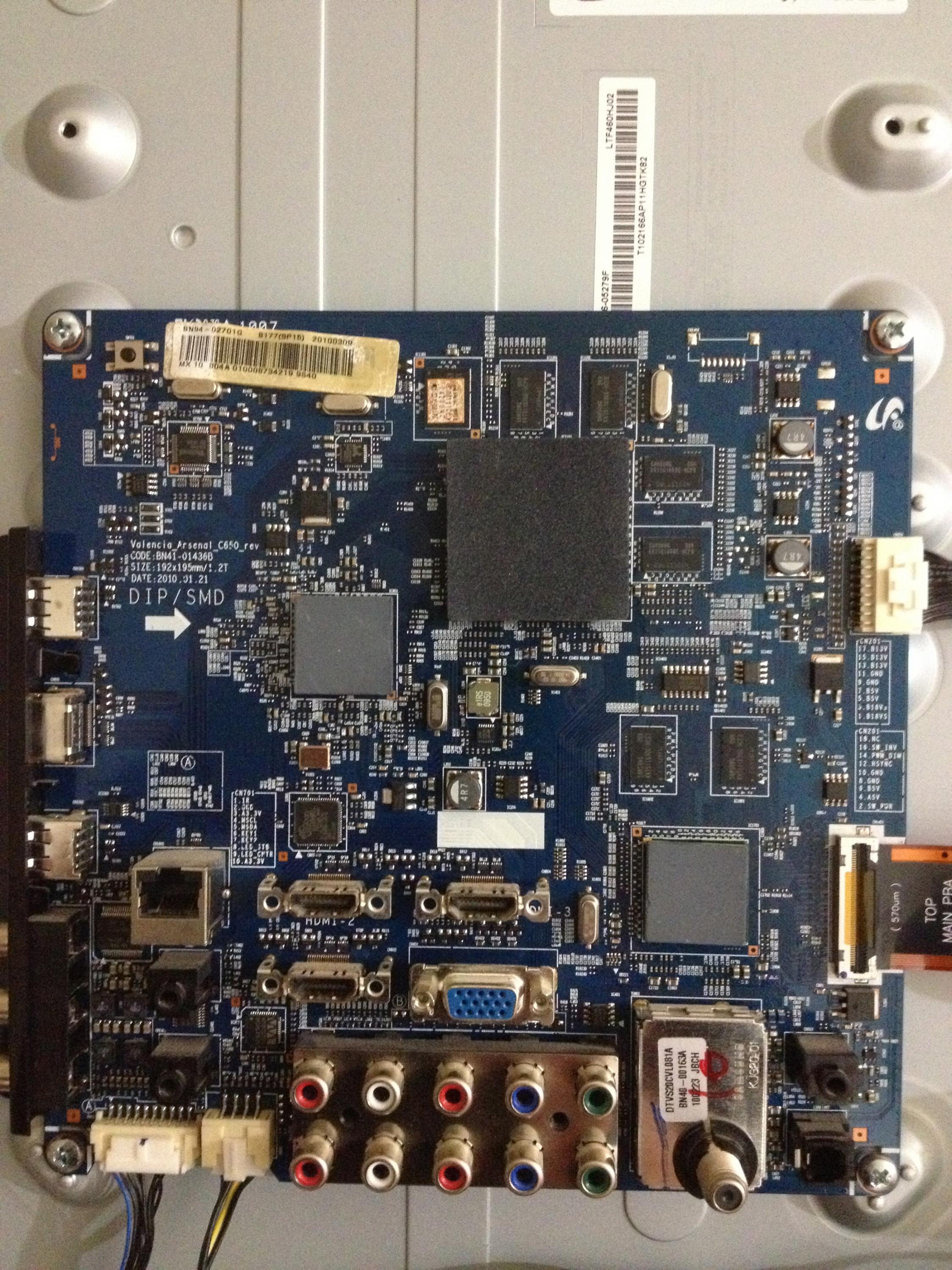

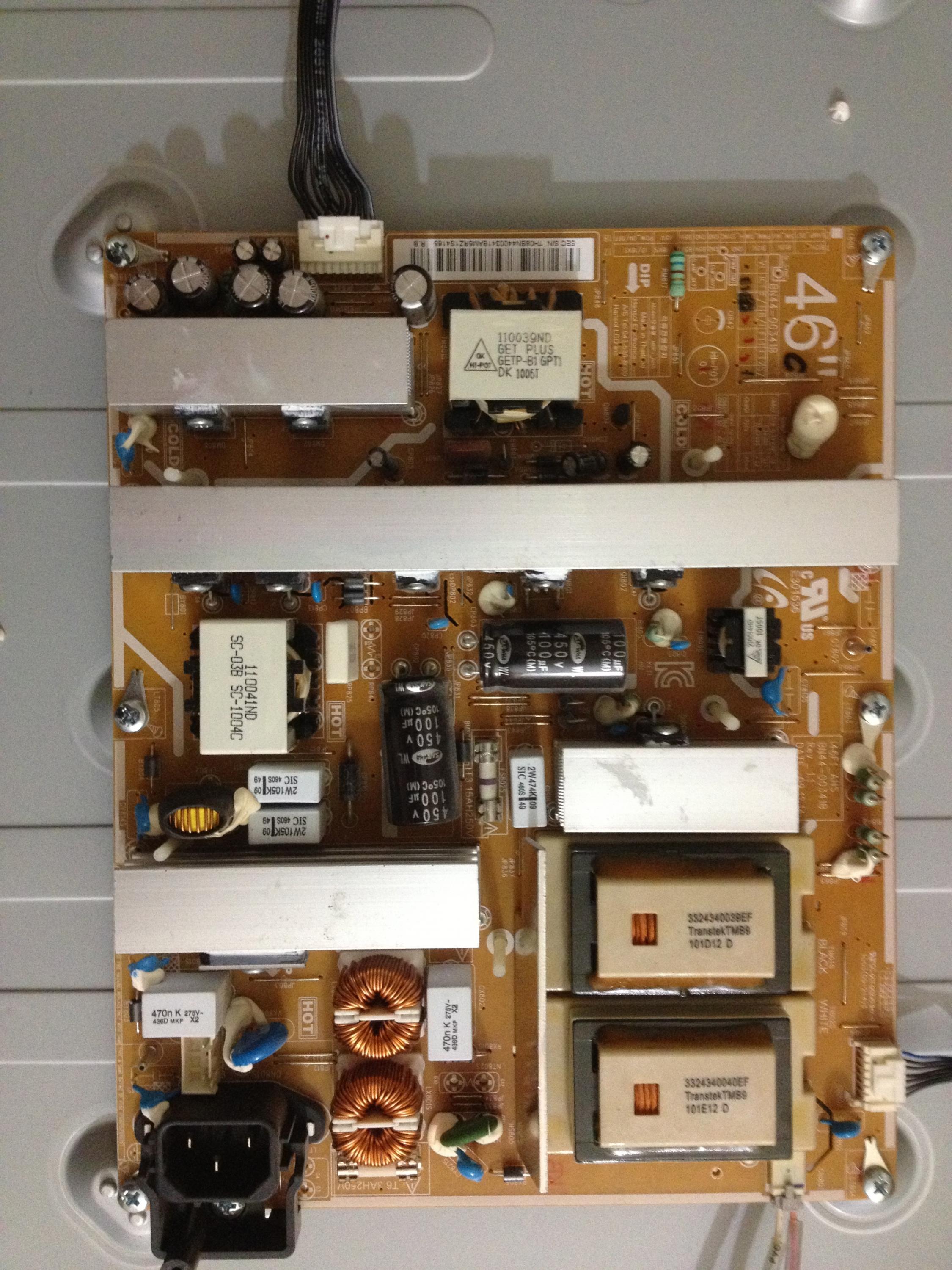

        The power board and the main board at least. Just so by the time the bigger experts come around they'll have something to go off of.

          Gotcha, I'll do that now...

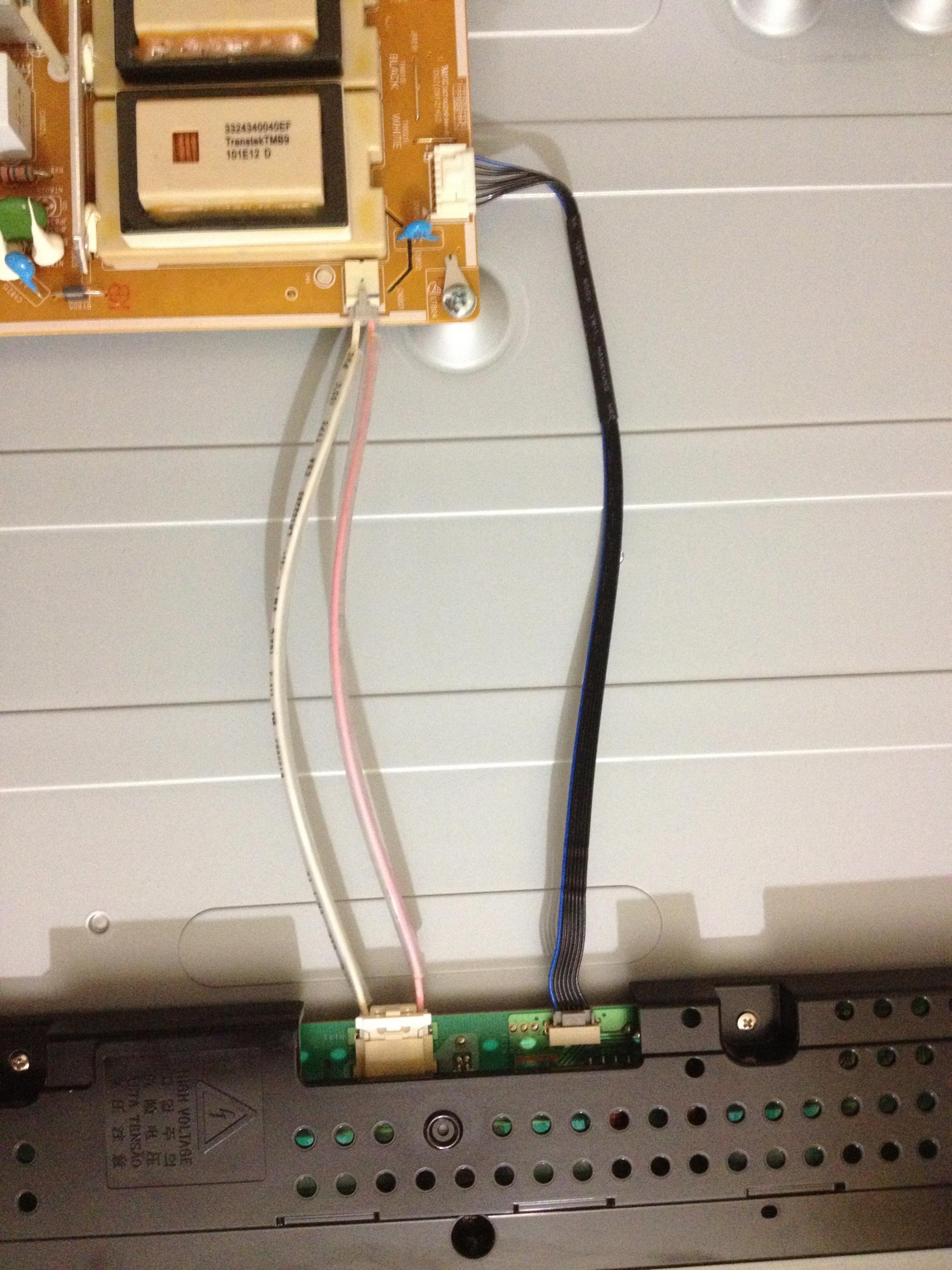

            Re: Samsung 46" LCD vertical colored lines
            t-con board would be good for a photo too

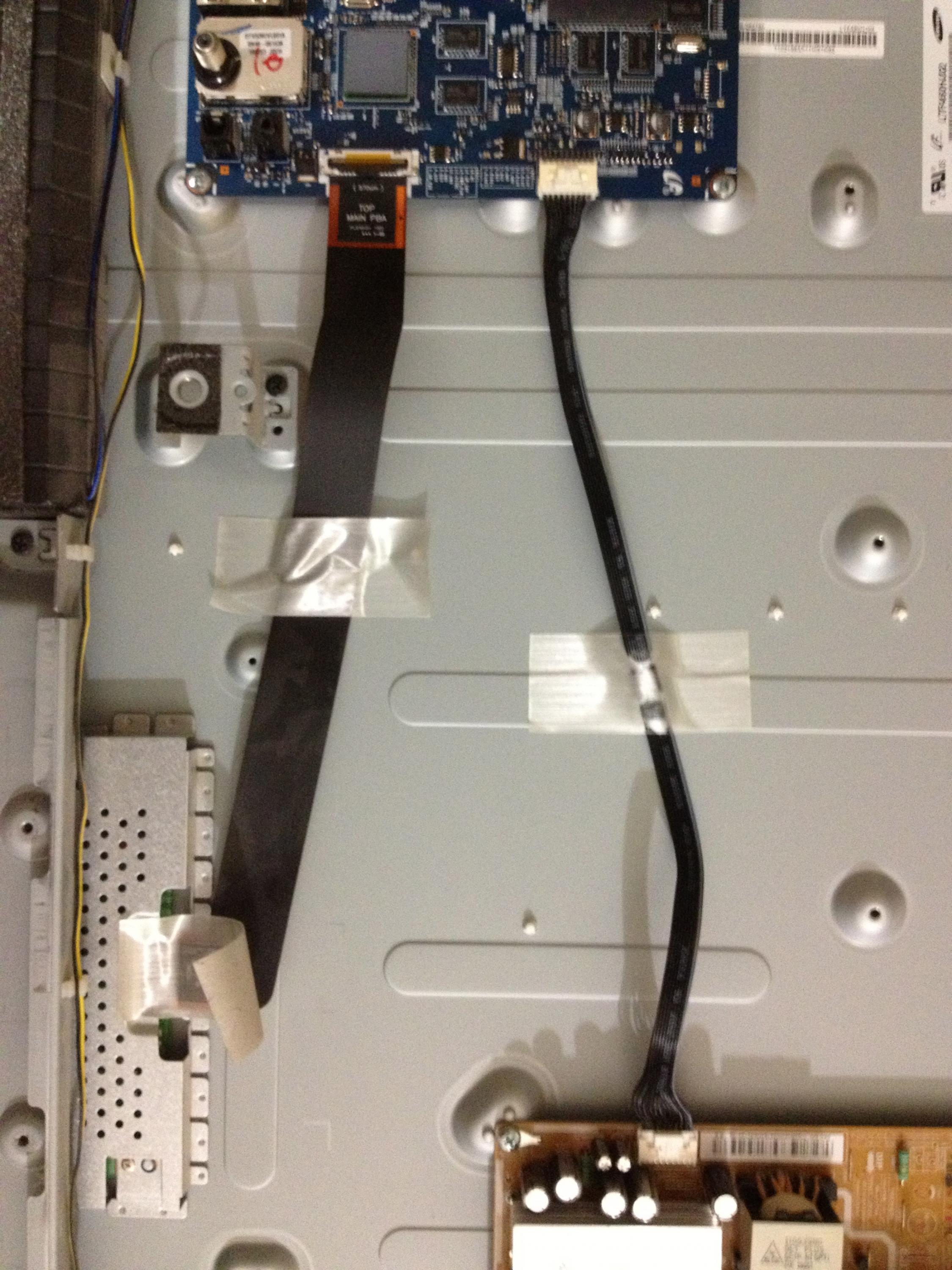

              Here are the insides, hope the T-Con board is a part of these pics.
                    The T-con board is that board between the speakers.
                    How old is the TV? It is most likely a panel failure due to manufacturing defect. Complaining to Samsung is really your only option.

                      TV was bought in 2010 and from what I have researched the 08, 09 42" and 46" samsungs were known for this.
