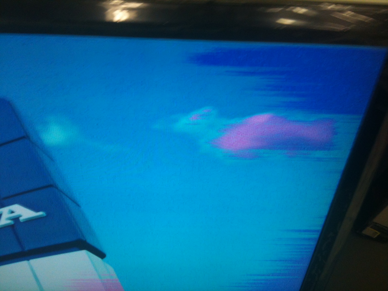

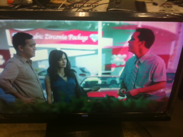

    Vizio E550VL screen issue after warm up
    Could this issue be a bad T-Con?
    Colors bleed after warming up. It can take up to 2 hours.
    Thanks for your input for an amatuer.
  • t.j.
    • Apr 2010
    • 383
    • canada
    Re: Vizio E550VL screen issue after warm up
    take back off, take hair dryer to t-con, speed up the heat up process !when it does not do it heating t-con a bit! goto vid board an do same. i think it the vid board an some bad caps!
