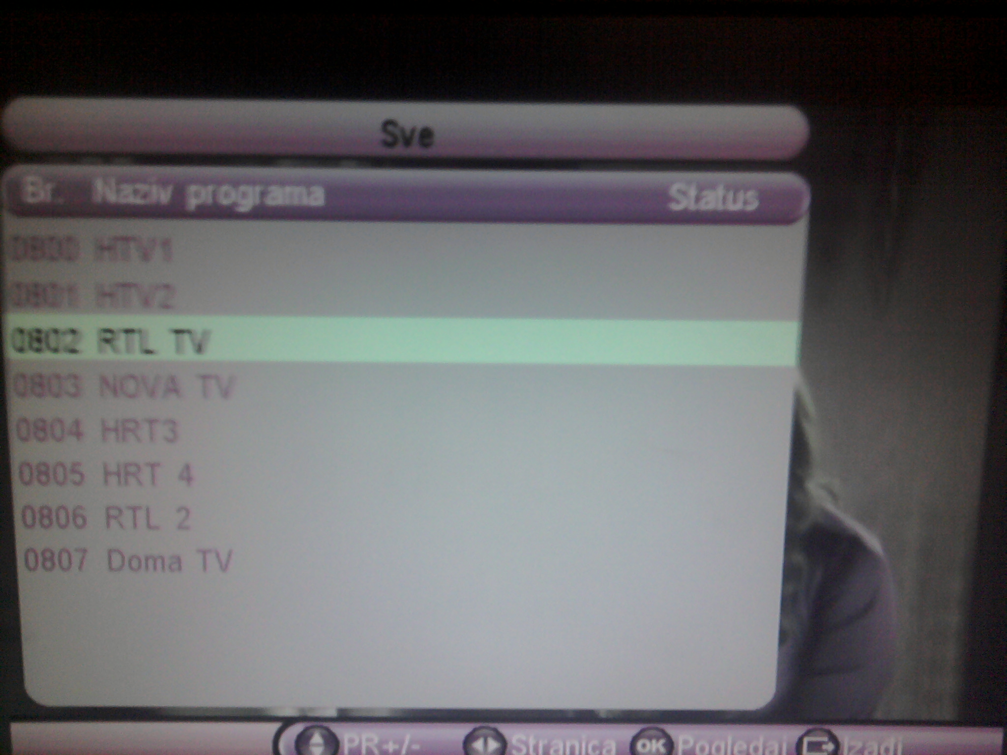

    Hi everyone!
    I think I have problem with scart on my monitor/TV.
    My digital reciever is connected to my TV with scart cable and some colors are missing.

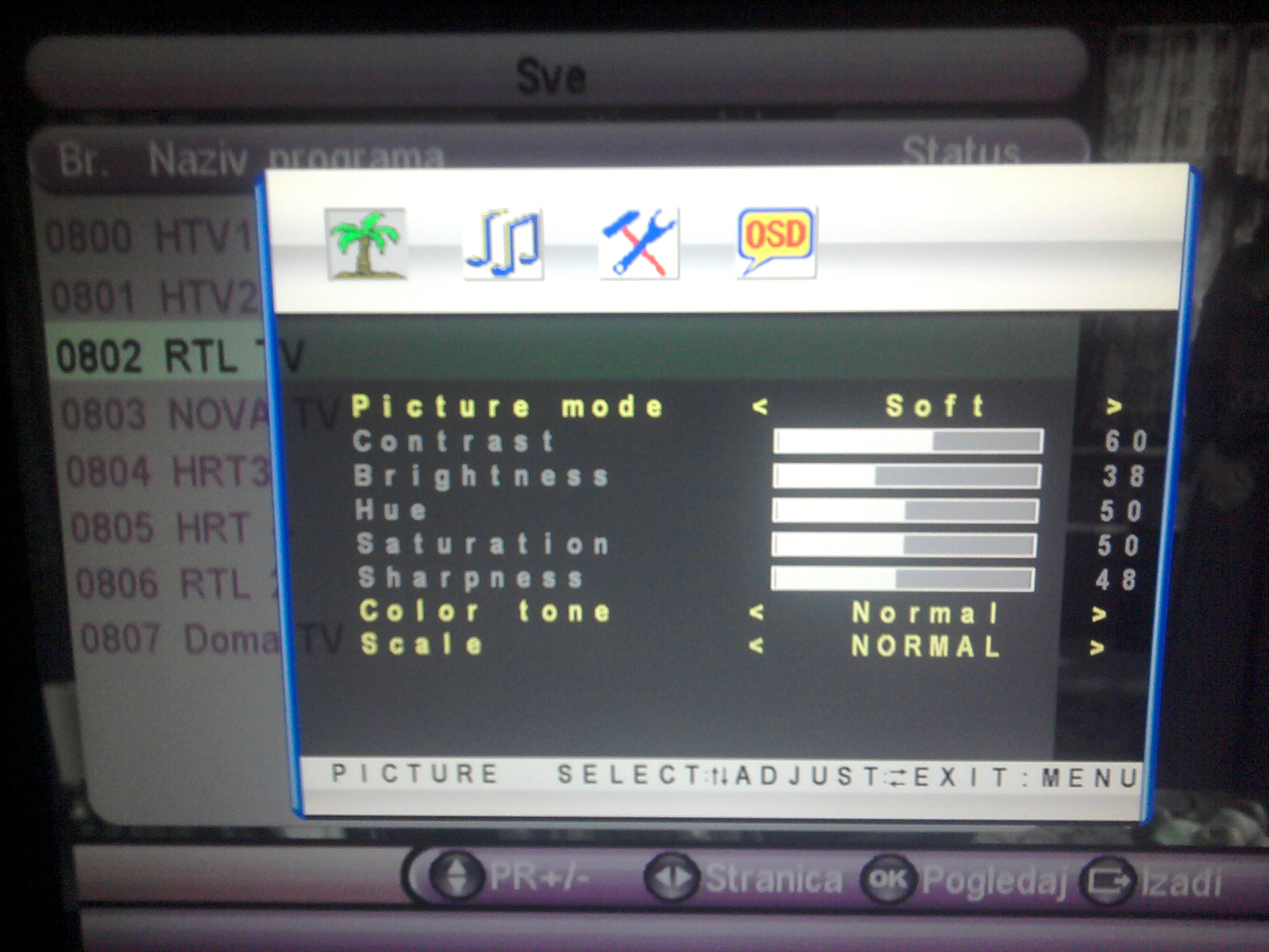

    I tried with another scart cable and no changes. Also when I opet TV menu colors are normal so obviously that problem is scart connection.
    Look at pictures, I noticed that pink and green are more visible like blue is missing or some other.

    You have red and green, no blue.
    http://en.wikipedia.org/wiki/SCART
    Check the blue in and blue ground.
    If you don't mind slight picture degradation, switch the box to composite or S-video output, if it supports it.

      I didn't really understand the meaning of switching box to composite ?
        Re: Scart problem
        In the digital receiver's option menu, there is probably an output setting -- try "composite", or "S-video", if available.

          There are outputs RGB and CVBS

            Switch it to CVBS.

              Didn't help :O

                Means there's something wrong with your TV. You're gonna have to crack it open and have a look inside. But first, try a DVD player and see if it looks the same on that - it could be the digital box that has the issue.
