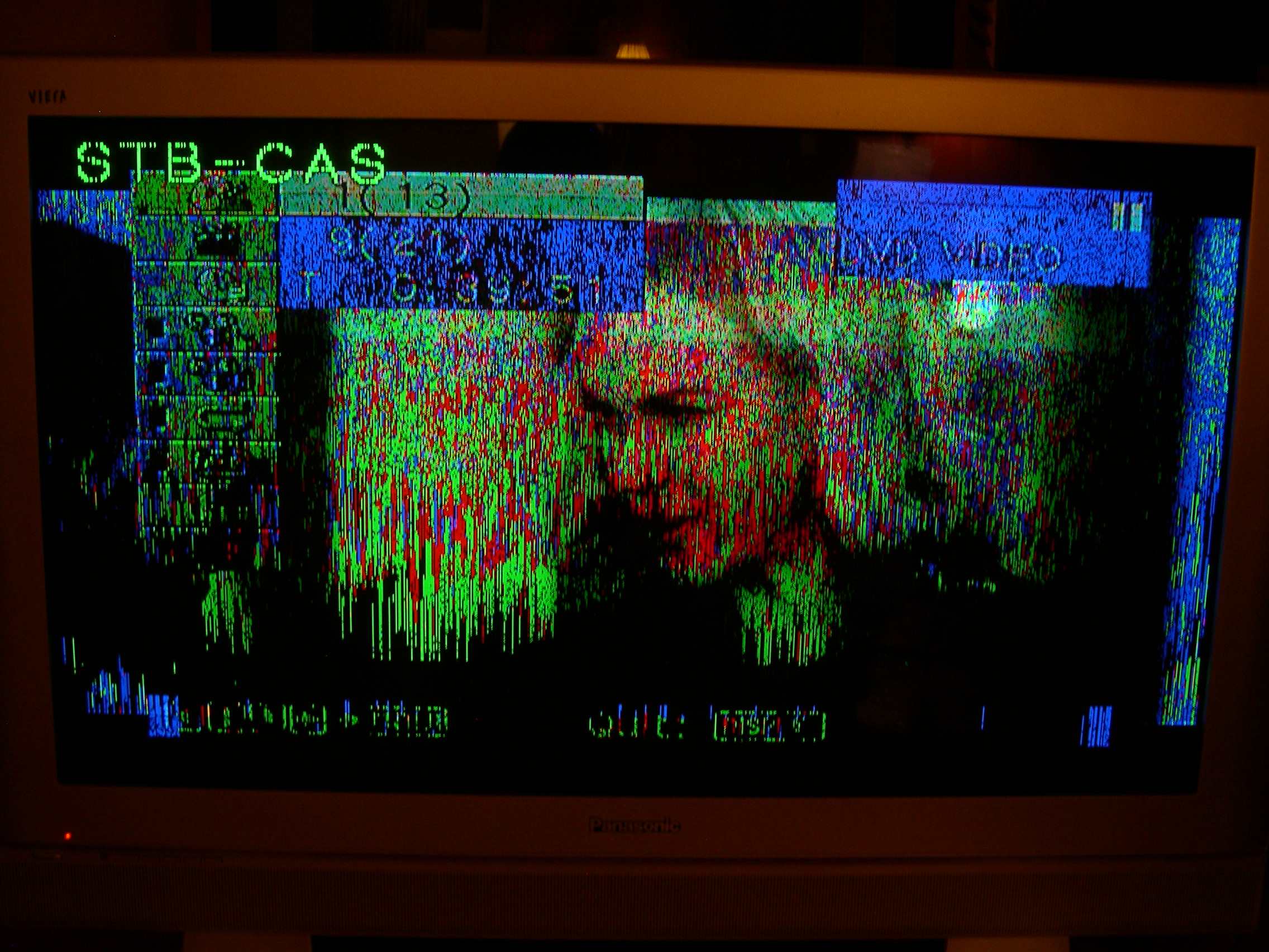

    I got a Panasonic TH-42PD50U 42" plasma TV that has random pixels that overlay the image (including OSD) all over. Over time they disappear as you watch, letting the image come through where they were, though most stay stuck. The image in the areas underneath them looks sort of right, maybe tinted. Any ideas on where to start? I might open it and try applying slight pressure to various boards, and see whether anything looks amiss. Thanks.
    Also, problem occurs moment it's powered on, no change over time. Previous images seem to linger slightly in these messed up regions. And occurs for analog and digital inputs.
    One other thing, when I ran in high picture mode with snow screen, it seems to improve somewhat. But then switching to lowest picture (brightness), pixels start to become unresponsive again.

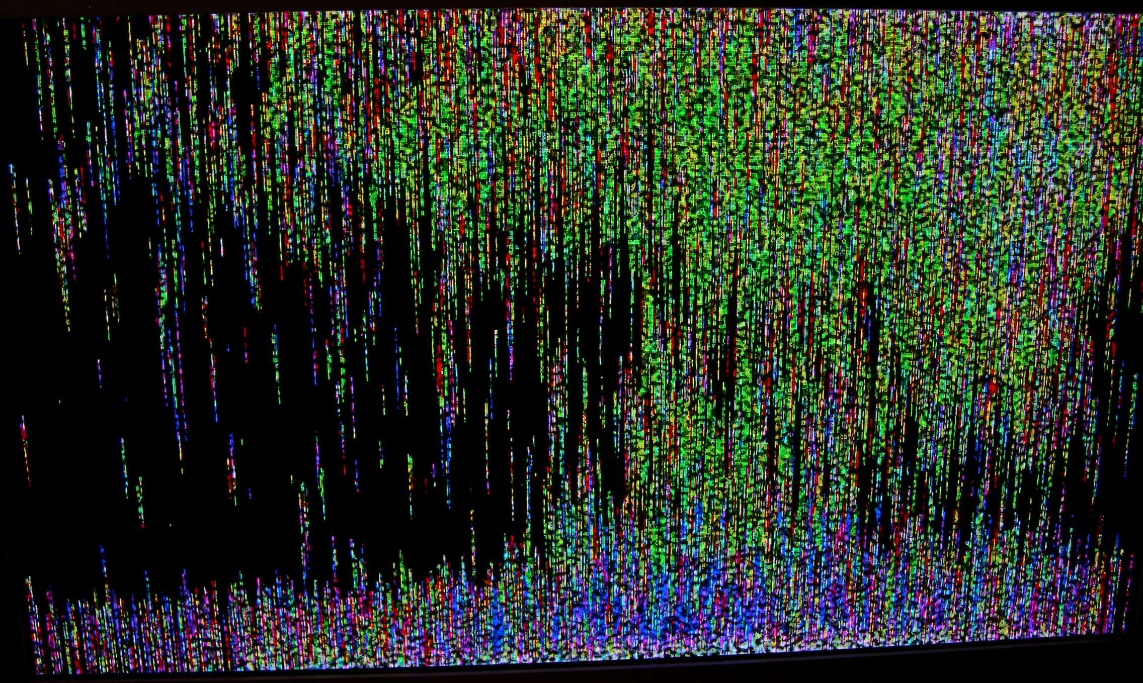

          I tried adjusting some of the voltage pots and varying the 67V, 156V, 12V, etc. a bit, but no visual effect.
          Today when I turned it on with lowest brightness, it was almost all black except for a little bit at the bottom and I thought it was damaged even more. But turning to high brightness, it slowly raised like a curtain, finally showing snow over most of the screen, with about 5% random pixels not working, and some black areas near the left and right sides.
          I thought it might be heat-related, so I let it cool, then ran a hair dryer over various boards. No effect.
          I took a picture of the pattern, turned it off for a while (so it could cool), then turned it on, and it was still the same pattern. Something has a memory effect in it, and it's not temperature. It seems that the only possible places for this memory is in the plasma panel itself (capacitance of each element? mercury distribution/vaporization?) or the RAM for the frame buffer in the digital board. Since the effect is highly dependent on brightness, I doubt it's the RAM.
          I'm trying to explain the pattern on screen and why it tends to affect certain areas more. My best guess is that a driver board isn't putting out the right signals, so is running the panel in a way that tends to expose slight differences between each pixel, even though these differences aren't a problem normally since they're being run away from a region that amplifies these differences.
          Much else I can do with only a DMM?

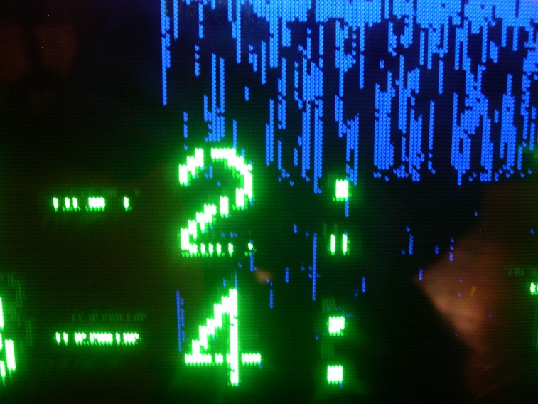

              When you say erase pulse not working, do you mean the signal to the SS board, or just the final pulse to the panel itself? And when you say SS fault, do you mean SS board? It's my understanding that the SS board is where the erase pulse is handled, along with the other "blunt" pulses (ones that go to the entire panel at once).
              I tried grounding each of the four UEH, USL, USH, and UML (after some resistor buffers, so I wasn't shorting the signals) to see what would happen, to get a better idea as to what the SS board was doing. After the UEH one, the whole screen got "erased" to black and only a few vertical lines at random points started "showing through". Even after a while, these only grew some and I was worried. After an hour or two, they grew vertically and expanded some horizontally, but still weren't filling in lots of areas. Waited overnight, same. I was worried that I had damaged it more. Today I messed with the various voltage trimmers, including some unlabeled on the SC board, and over time was able to fill in the whole screen to working how it was previously. I think I found that with the SC voltage higher (my guess as to what they adjusted), it got rid of almost all the dots for a while. I also found that lowering the erase voltage (VE) didn't seem to affect things.
              I've read a bit about how a plasma works. My basic model is that each cell is basically a capacitor that acts as a binary memory. To display something, it first charges the respective cells to around 67V, which won't cause any plasma. Then, it pulses a higher voltage across all cells at once, such that only the charged ones will reach plasma state. This also keeps the charged ones charged and the off ones not charged. It flashes them several times in a row for some duration (which varies for the cycle, depending on the binary weight it's currently at). Then it erases them by discharging them with a strong negative voltage ramp.
              Since many are sticking at black, this suggests that it's the charging that's not working, rather than discharging (erase). Or maybe if they're erased wrong, they can't be charged correctly either?
              I also don't have an explanation for the extreme memory effect, and how long it took to unstick the pixels from black so they all generally worked again. I noticed that this unsticking effect seemed to only run upwards along a column, virtually never sideways. If a column was working near the bottom, it would slowly grow upwards one pixel at a time. I'm wondering whether this could at all be due to panel fatigue. I found the service mode and this has 5982 hours on it and 2089 power cycles (which is quite a bit over its 7 years of life).
