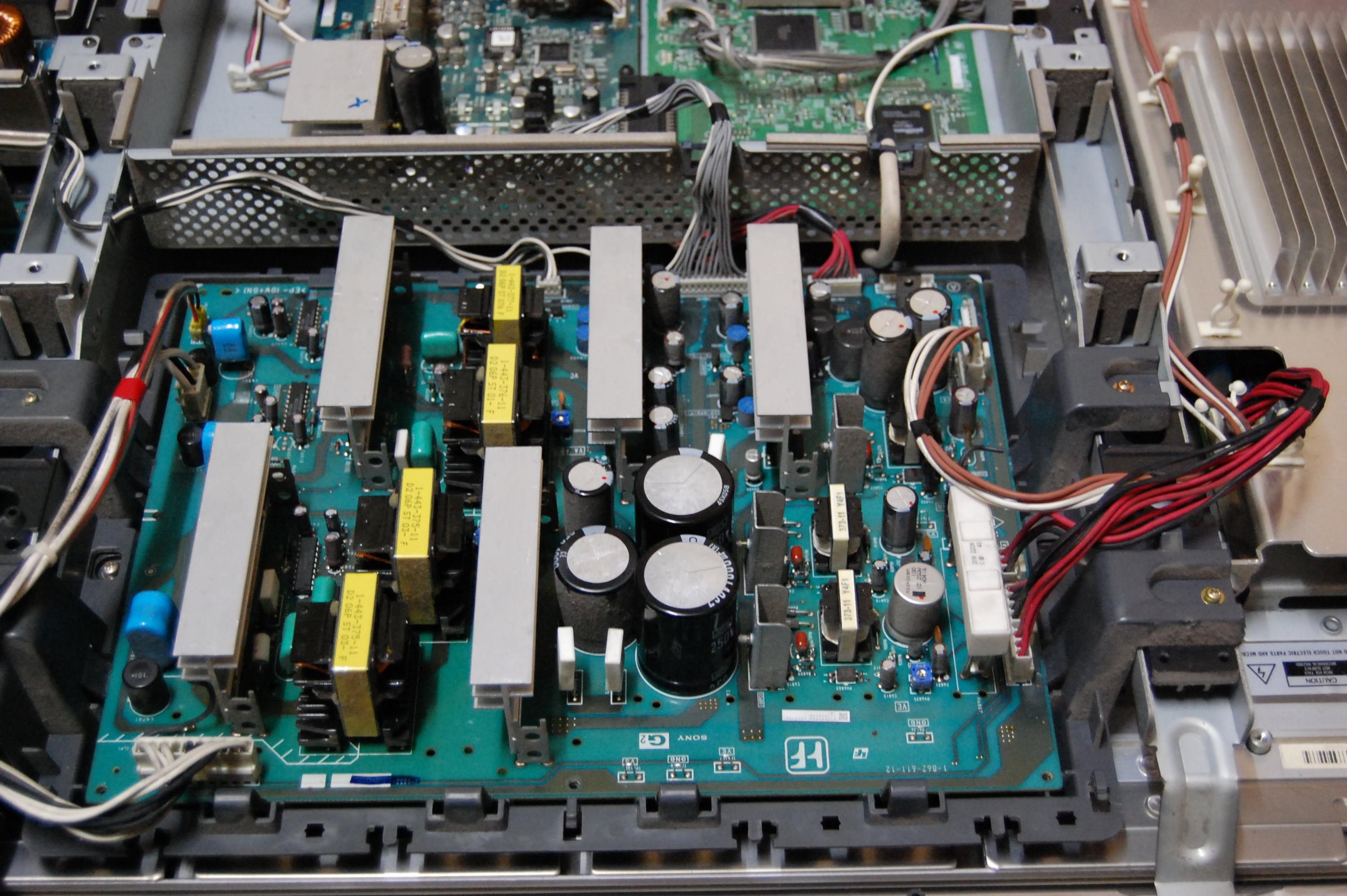

    ps. i don't know if are needed the same (having schematics) but here are some pictures of G2 board.
    if needed i can make photos of the rest.

    Which 170v: Vs, Ve, Vset?

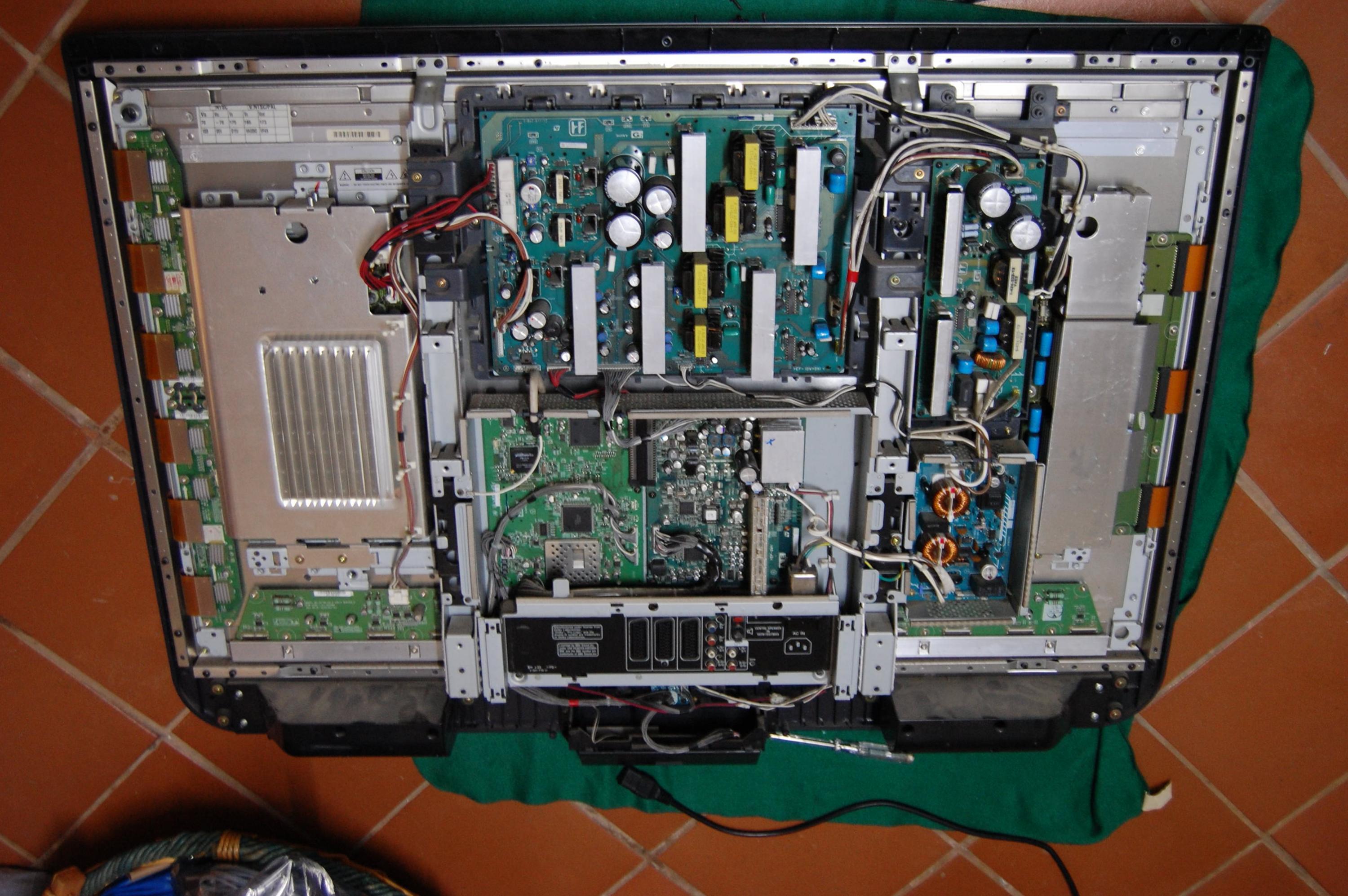

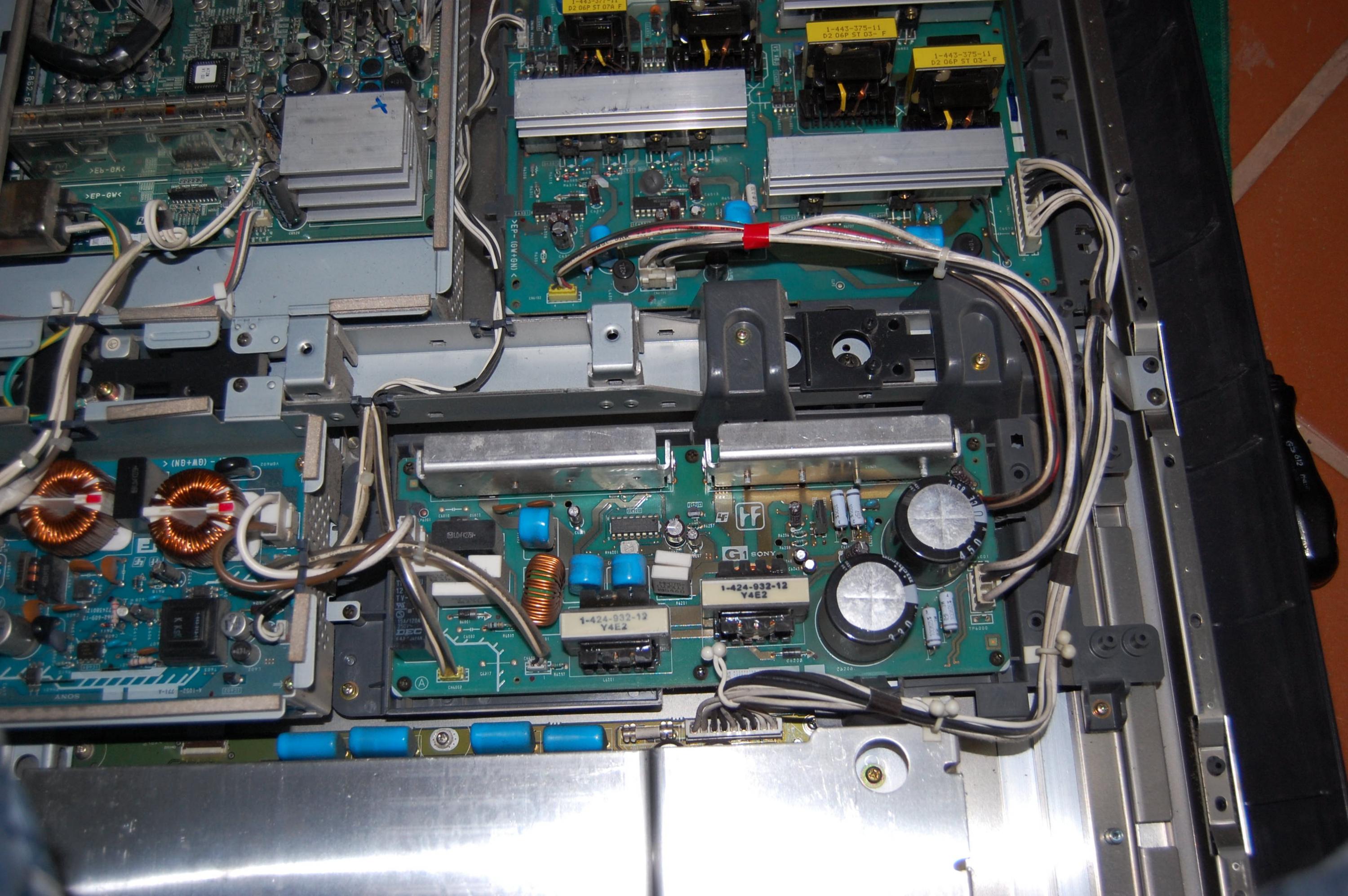

    And yes, could you please take an overview shot of the whole back.
    And then a more direct overview of the power supply.
    All with no flash but ample lighting.
      Re: Plasma sony ke-p42m1 does not display nothing
      Here are the photos of the whole back of tv.i hope they are fine otherwise let me know.
      All the three.. i can measure VS = 6V , VE = 6V AND VSET = 5V
        Blast a hairdryer on the power supplies before turning it on.
        Does it switch on?
        Do NOT touch heatsinks when testing for voltages as they may be LIVE!
          @gilly1984
          heating G2 power supply board the LCD PANEL goes ON!!
          what should i check?
          thank you
            Cold joints! Older Sonys were well known for it. Re-touch any suspect solder joints. Try narrowing down heat location.

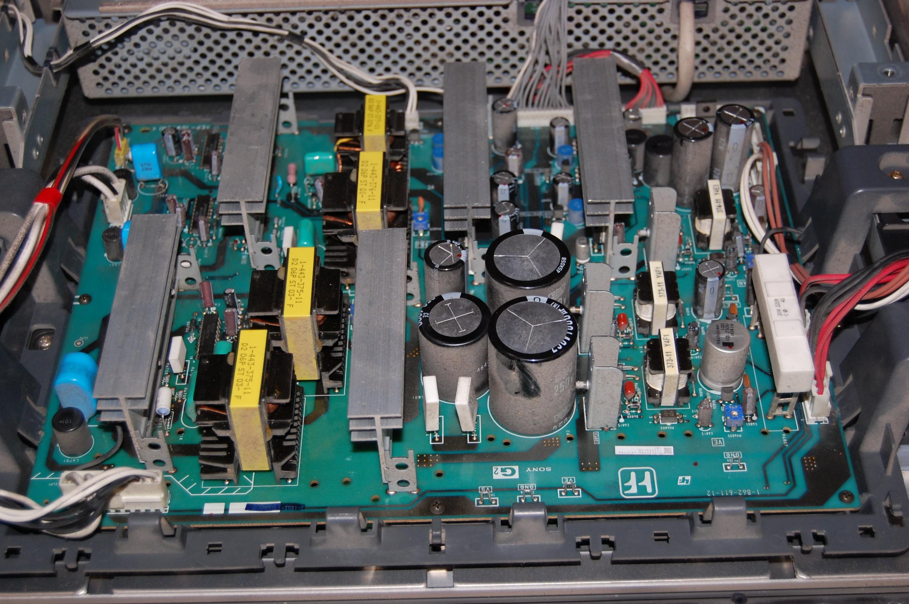

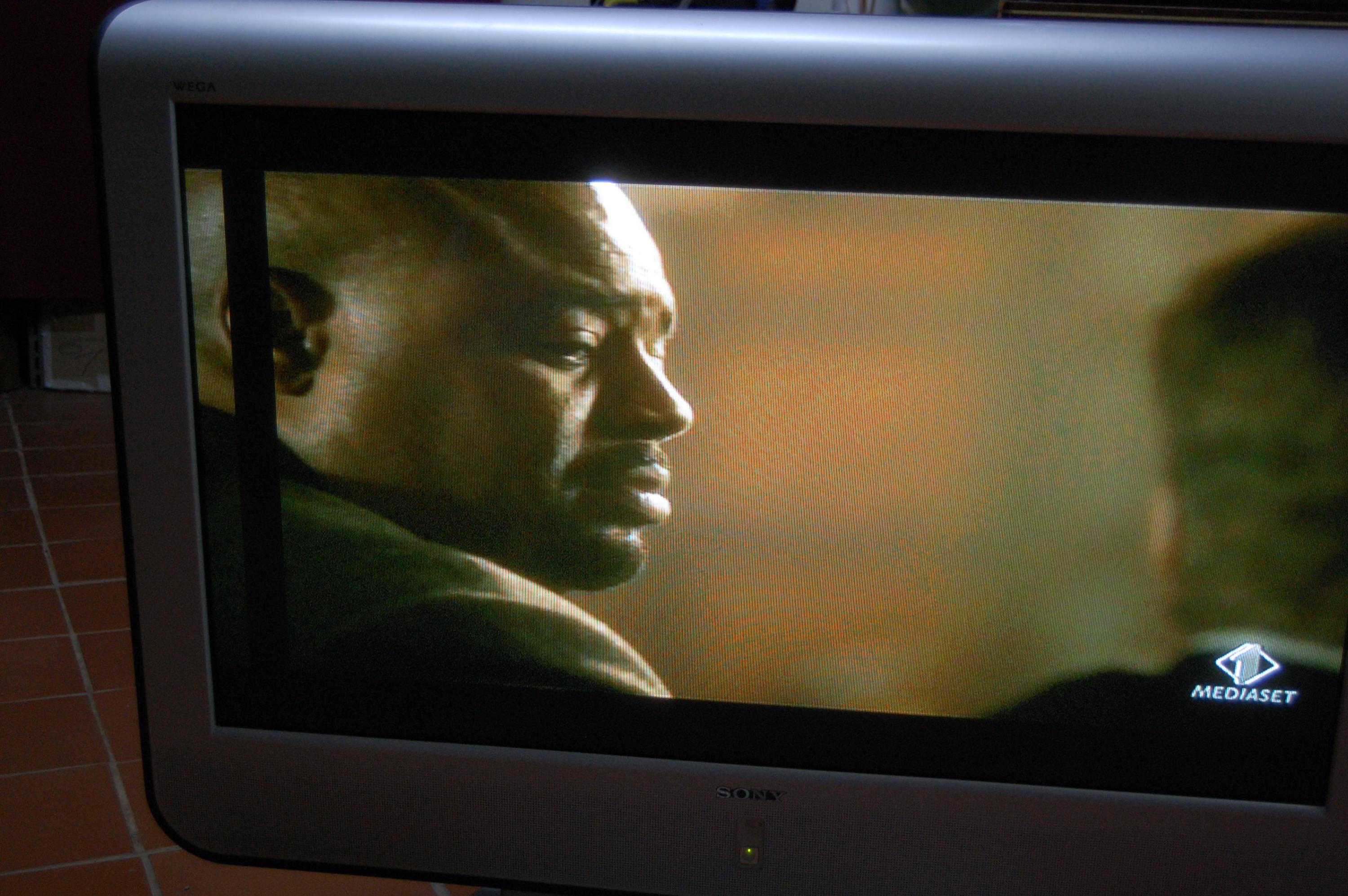

              btw, after resoldering G1 power supply area near 370V now the TV goes on all the times!
              BUT... there is a BLACK STRIPE on the left that was not there before...
              and a nasty noise that is coming from the part i attached in photo 2 in this post. like a BZZZZ

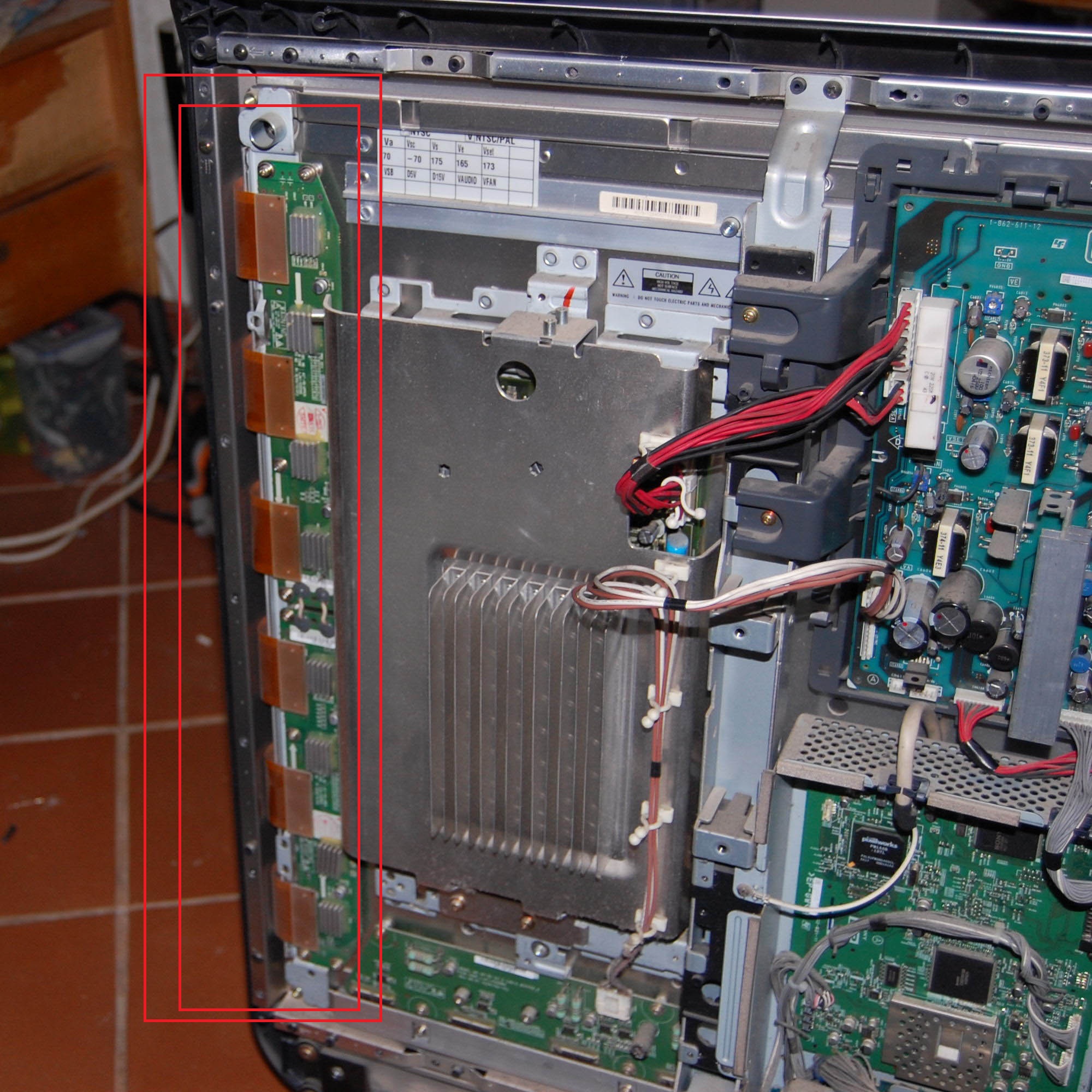

                Older plasmas buzz a lot, put the case on, won't be audible from 10 ft viewing distance.
                As for black strip, you need to take the bottom buffers off and inspect the flat flex drivers, may be a bad driver (=bad plasma panel) but I am aware the older ones commonly had cold joints, especially if it is intermittent, it is likely another cold solder joint

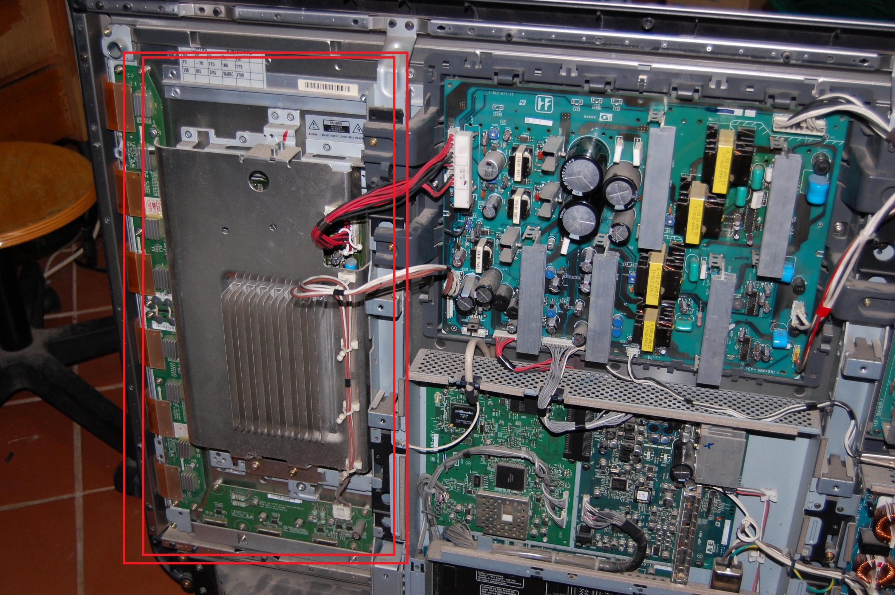

                  @tom66
                  thank you for your suggestion tom, but i don't understand very well what to do.
                  in attachment there are the only flat cables i found, are these that i should check or there are other ones? what should i do to check them?
                  thanks again

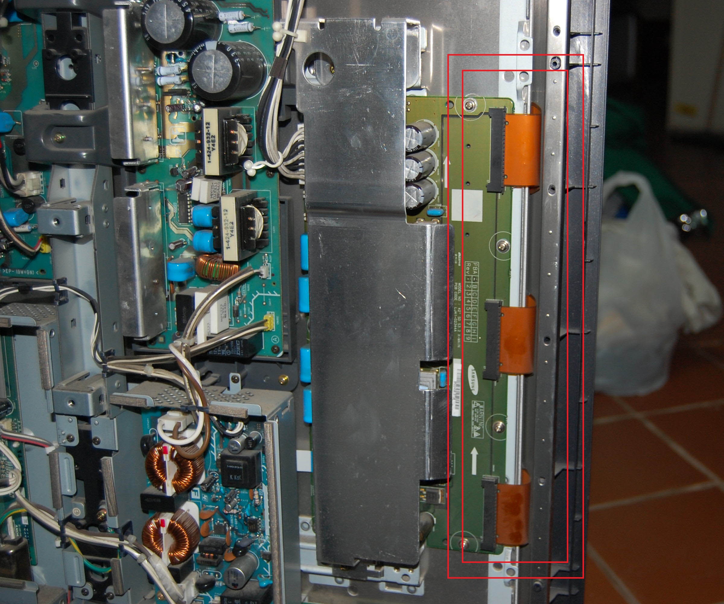

                    No sorry, from the bottom of the panel... you may have to take off the main board.
                      just to close this adventure, i found the flat cables tom66 told me on the bottom on the tv.
                      the first one on the right (staying behind the tv) was the bad_guy.
                      i had to remove all the panels to reach the flat cable, btw i had to resolder 2 resistors on the flat cable and all went to the life again. Now tv is working perfectly

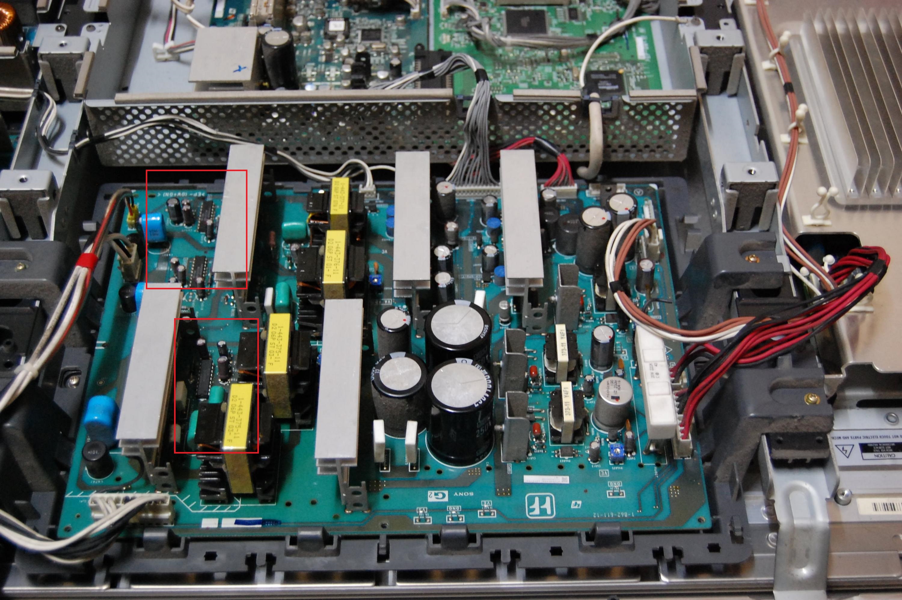

                                    So i run another tests and it seems theyre 2 places where i can heat and tv will go on, as shown in the picture, i have resoldered pretty much evrything on those areas, and still nothing, when the hardware gets cold i cant get no image.
                                    Notice that i only heat for about 5 sec, about 350 degrees, wich i believe is not enough to melt the solder.
                                    As tom66 said it might be bad caps, but i wanna be sure, cant the transistrs or maybe thos chips be heat sensitive, in my area caps are expensive and hard to get, i know i must try because theres no guarantee in this kind of things, although just want to have more certanties.
                                    sry for my very bad english
                                    and thank yu very much for the help.
                                      It's not melting solder that you're trying to do; you're trying to make a cracked solder joint expand, which even low temperatures will do.
                                        so you believe its cold joints il try look closer, the only thing is that no matter where i heat, on those places, it will get on.
