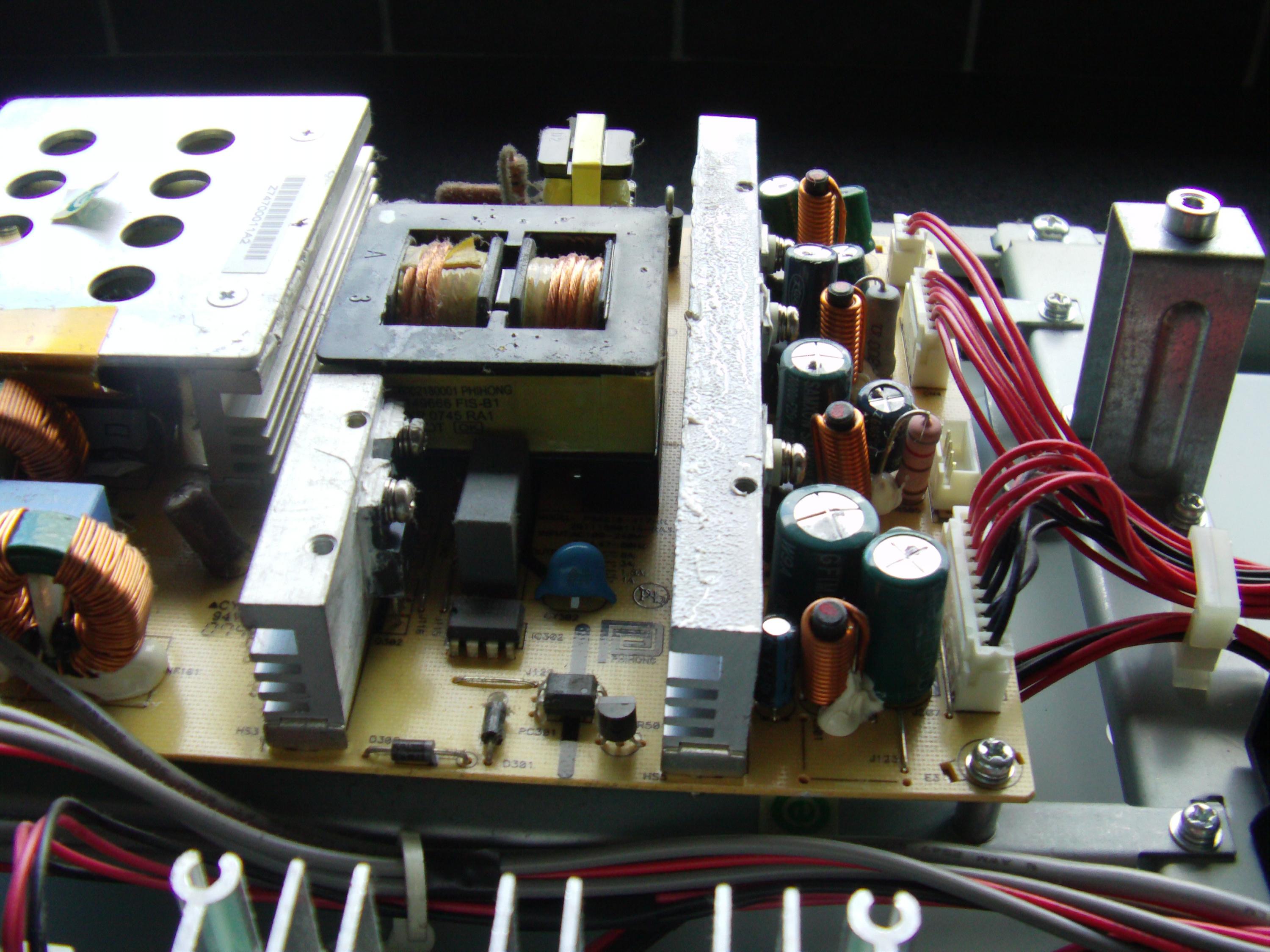

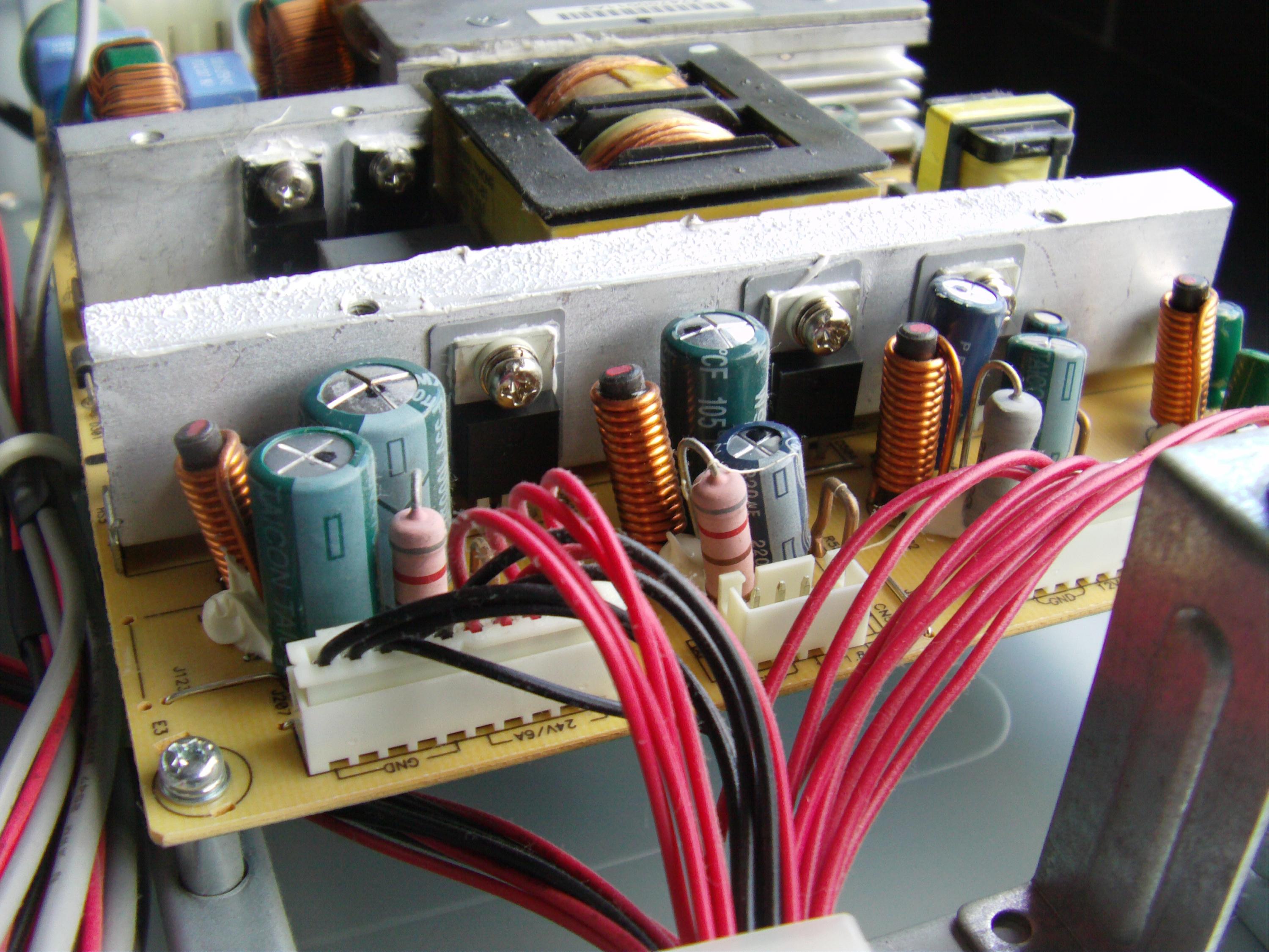

    Technika LCD32-407B Shuts off after 40 mins.
    Friend brought this round asking me to take a look, she said it turns off after 40 minutes and wont switch back on for a while.
    I opened it up and found 2 bloated caps 1 of which was beginning to leak.
    Replaced them and it has now been on non stop for 4 hours.
    This is just in case someone has a similar problem.
    Do NOT touch heatsinks when testing for voltages as they may be LIVE!
    Re: Technika LCD32-407B Shuts off after 40 mins.
    Nice easy fix, what caps did you use as replacements? Would recommend replacing all of the similar green Samxons, known bad caps.
    • retiredcaps
      • Apr 2010
      • 9271
      Samxon GF, a "known" bad series.
      --- begin sig file ---
      --- end sig file ---
      • gilly1984
        • Jun 2012
        • 751
        I replaced them with salvaged Rubycons lol. I know i should buy new but i had them lying about.
        35v 1000uf and 25v 1000uf.
