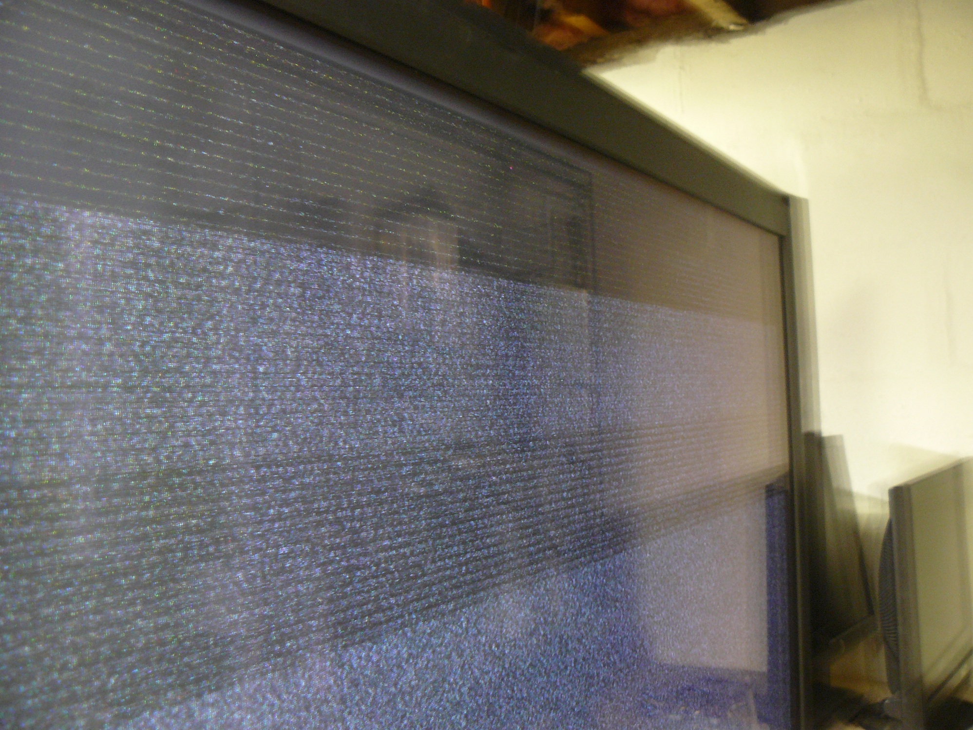

    I'm wondering if the upper buffer is on its way out. The top and bottom buffers are the dreaded samsung LJ92-01202A & LJ92-01203A that are known for failure. I did re-seat the connectors going to the upper buffer board but it made no change. I also checked the buffer to see if it was shorted and that tested good too. Voltages (Va, Ve, ect) are almost spot on as per the sticker on the panel, within +/- .02 volt. Just wanted to get a few opinions since i'm not very expierienced with plasmas. Sorry for the blurry pic but the tv is facing the wall. I can hook a source up to it if needed but i figured the picture i have you would get the general idea of my issue.

    Using a Multimeter on diode check put one lead on one of he caps - side and run the other lead along the connector (Both sides) where the buffer connects to the panel and check for any shorts. should read 600-700. the beginning will read 500 or so. if any are low then the ic leading to that trace is bad.
    Also, try removing the connector to the XSUS and see what happens
    Let me know
    Jon

      i'm getting .730-.740 on both upper and lower buffers doing the test you suggested. I unplugged the x-main and i don't get a screen at all.

        Ok, now, try removing the ribbon cables, one at a time from the xsus and, let me know what happens

          i disconnected the 3 ribbons on the x-main 1 at a time. I would reconnect the one i disconnected and then move to the next one. The picture doesn't look any different than the pic on post #1. When i finished i hooked all 3 back up and the screen didn't look any different than my pic in post #1. It's making me wonder if the x-main is failing. Is the IPM on the x-main the same as the Y?

            Yes, it sure is
            But, I would check the diodes 1st. they are under the heat-sink closest to the ribbon cable. they commonly go bad. which actually sounds like your problem more than the IPM

              Are you talking about the X or Y sustain?
