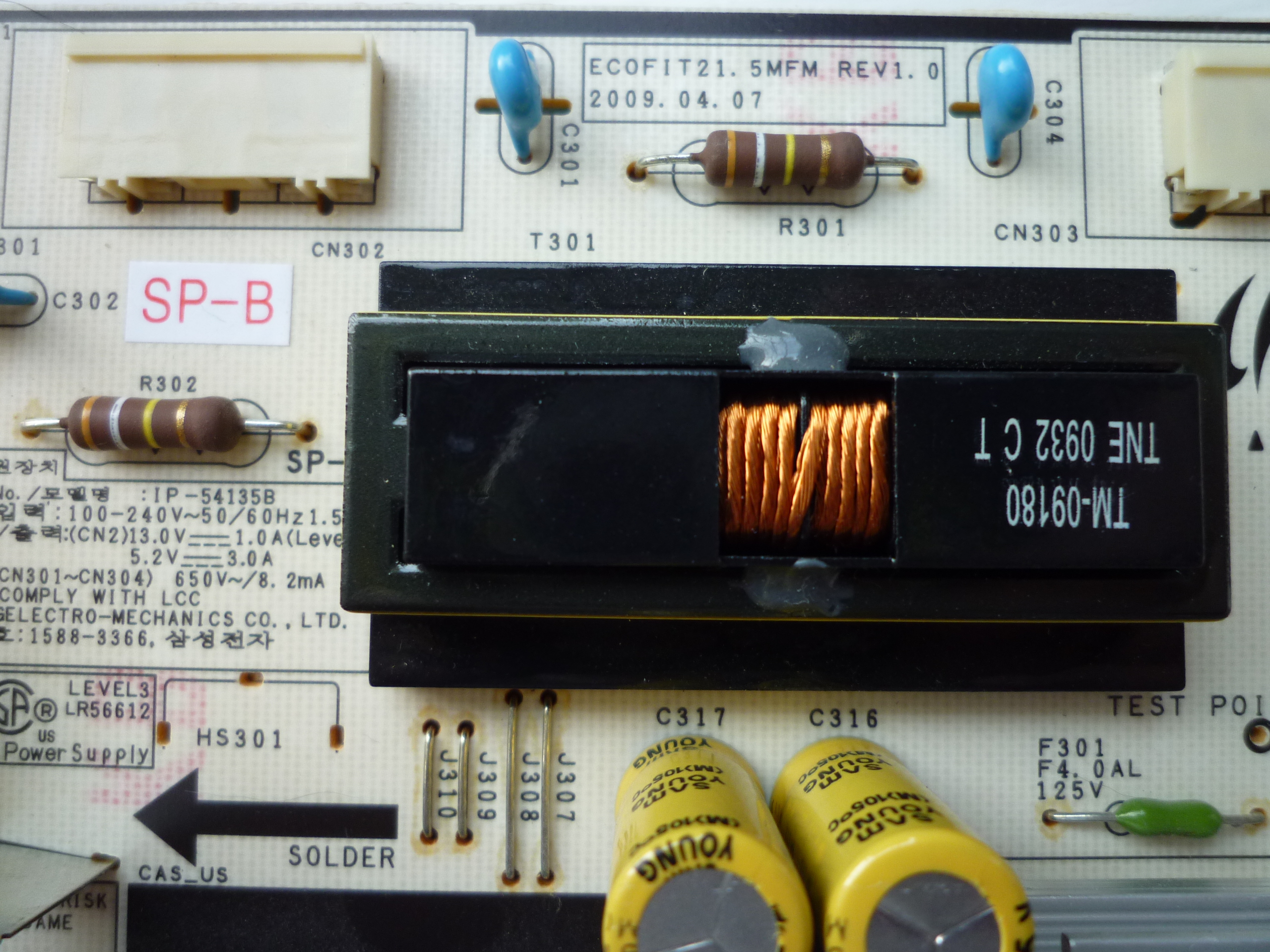

    Sammy has a 2s to black condition, stays switched on, has image (flash light test) Capacitors are Sam Young of which I have not yet replaced. Have read about the 2s to black condition in the previous thread. Am I correct in thinking that even though the power supply board appears to be operating i.e stays switched on etc, it could still have some faulty capacitors?

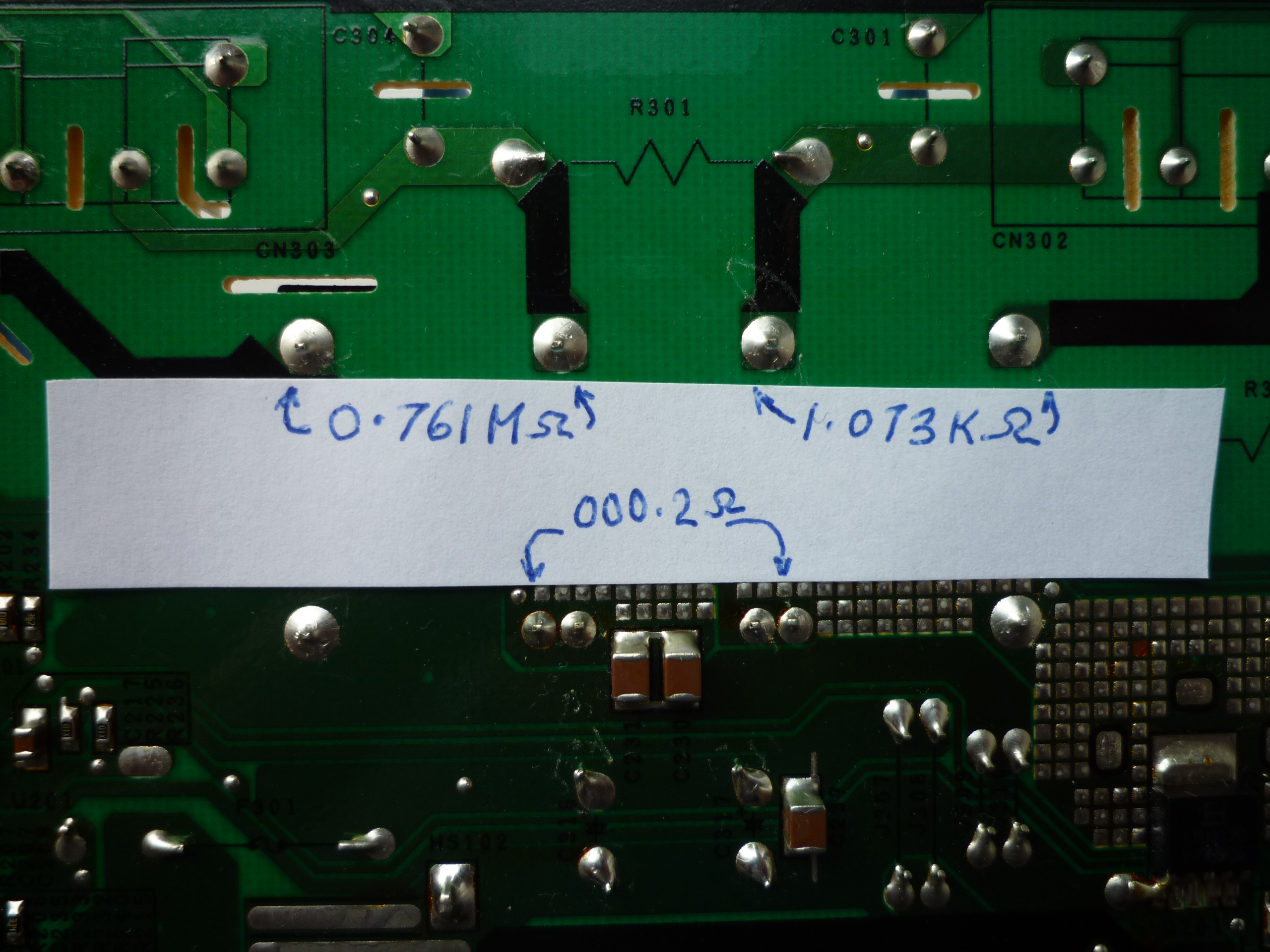

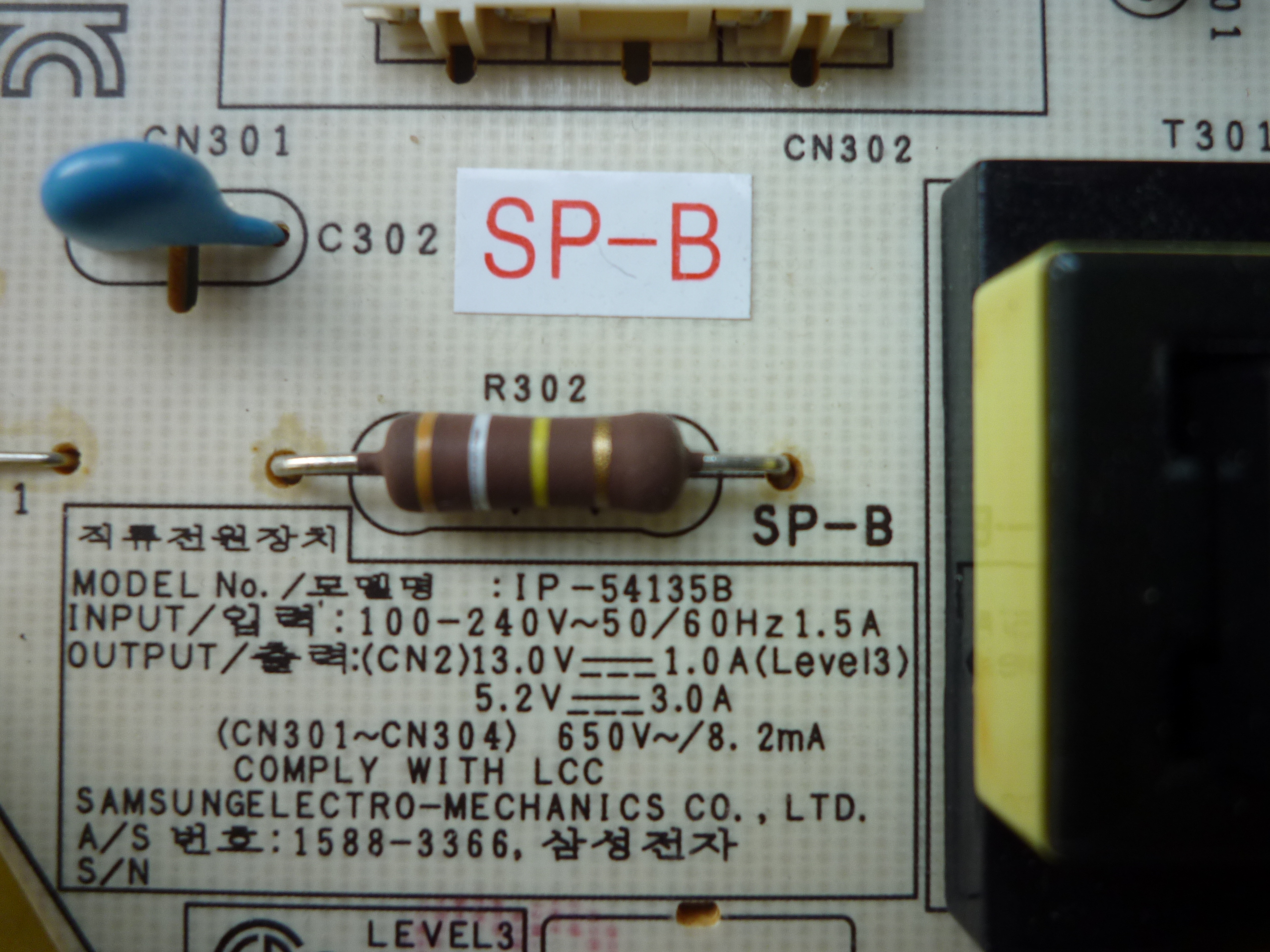

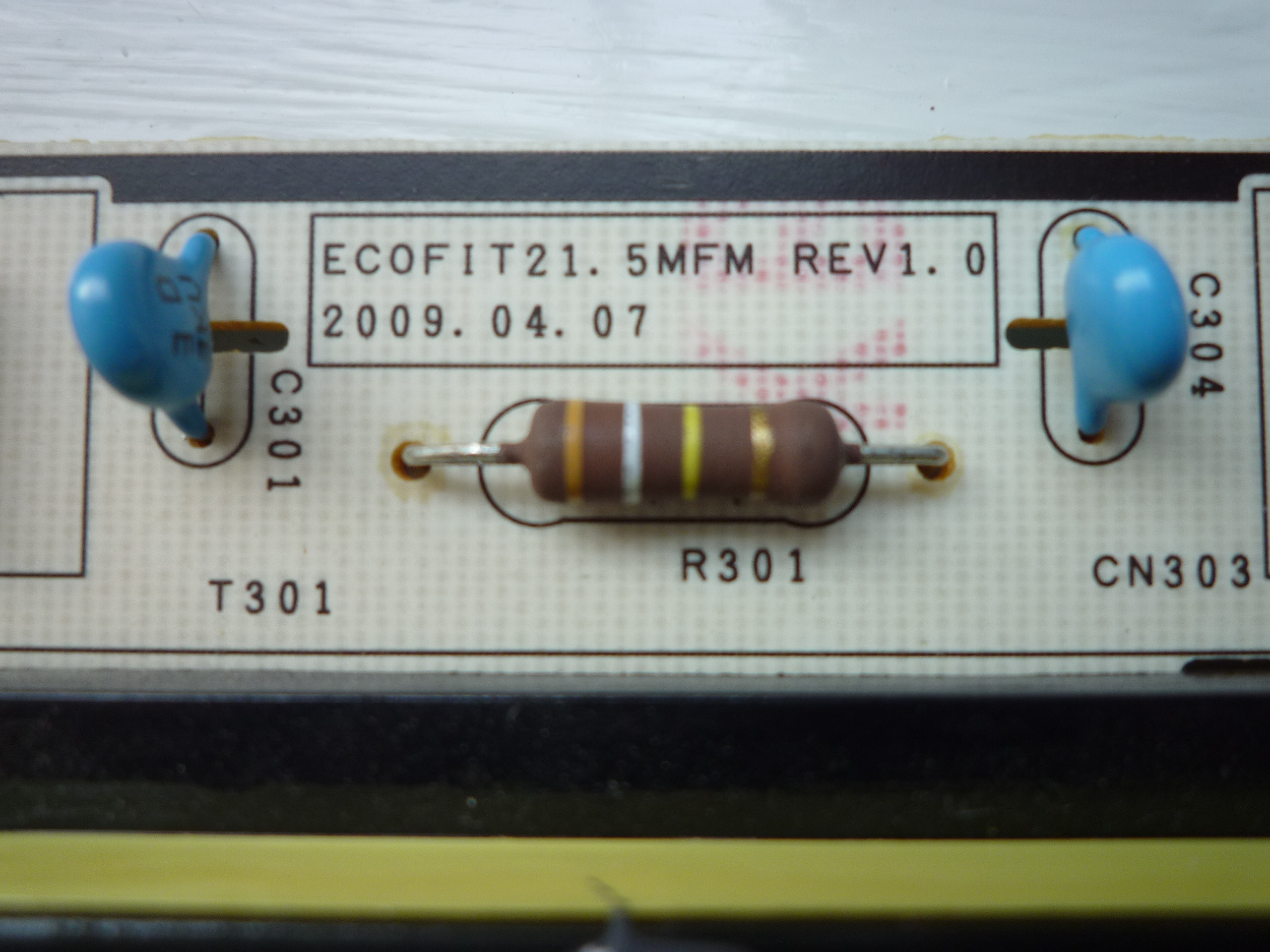

        Re-checked component values once again. There are two identical value resistors close to T301 which are R301 and R302. The bands are brown/white/yellow which I read as being 190K. The actual reading on R301 = 0.377M ohms and R302 = 0.384M ohms.
        If I'm checking T301 correctly, I have 000.2 ohms between primary windings, 0.761M ohms between one secondary winding and 1.073 ohms between the other secondary winding (as per photo)
          Re: Samsung P2270HD/LS22EMDKU - 2s To Black
          Do you perhaps mean 1.073k ohms between secondary readings? Very few multimeters measure down to milliohms. In which case, if one secondary measures 761k and one 1.073k, you have found the open secondary, it's the 761k one.

            Re-checked again and yes you are correct, should be 761K on one secondary and 1.073K on the other. Think my 'grey matter' is finally going!
            Have to way up the costs of parts against buying a second hand board?
              Well, a transformer is pretty cheap IF you can acquire it, as they aren't always available.
