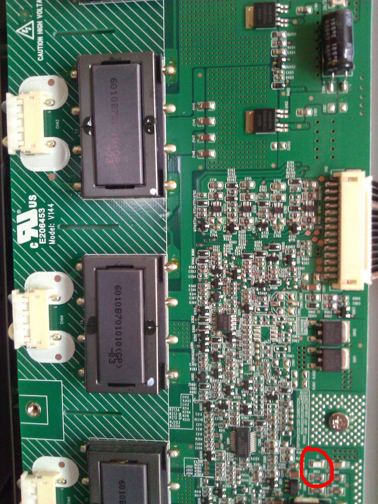

            Can you post a clear shot of the inverter? It doesn't look like the 24V is getting to the inverter - I'm suspecting a fuse on the PSU somewhere (and fuses can be deceptive, looking like anything...) This TV probably uses the 24V for the audio circuit as well, many do.

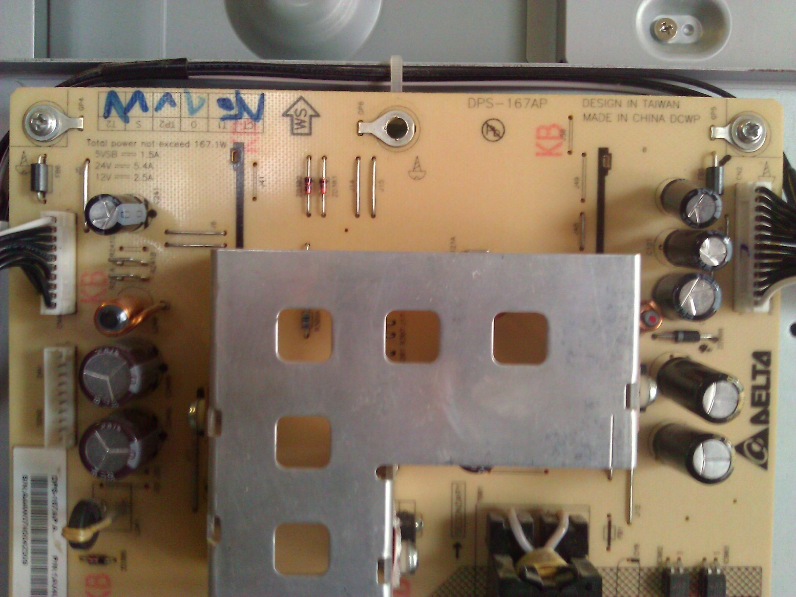

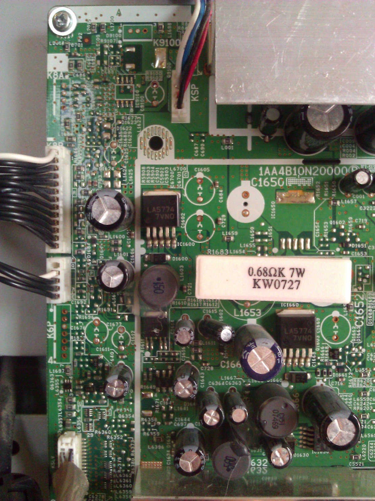

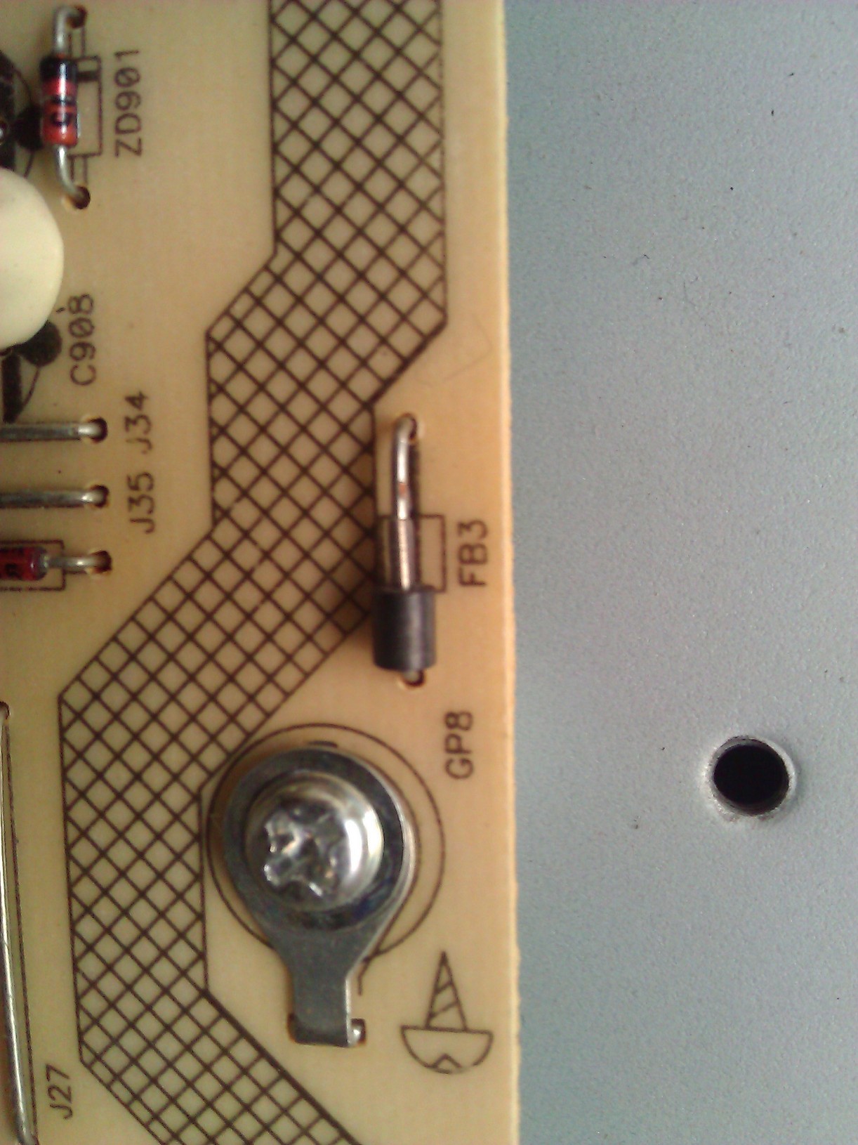

              I was just looking over the Power board and found this.. Would this ferrite bead cause a problem
                Re: SANYO DP37647 Sound no Picture
                I don't think so - it's just a bit of ferrous material wrapper around a wire. It's to reduce the interference the TV can kick out with regards to radios etc.

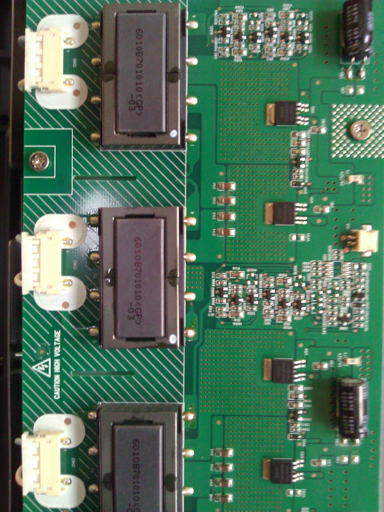

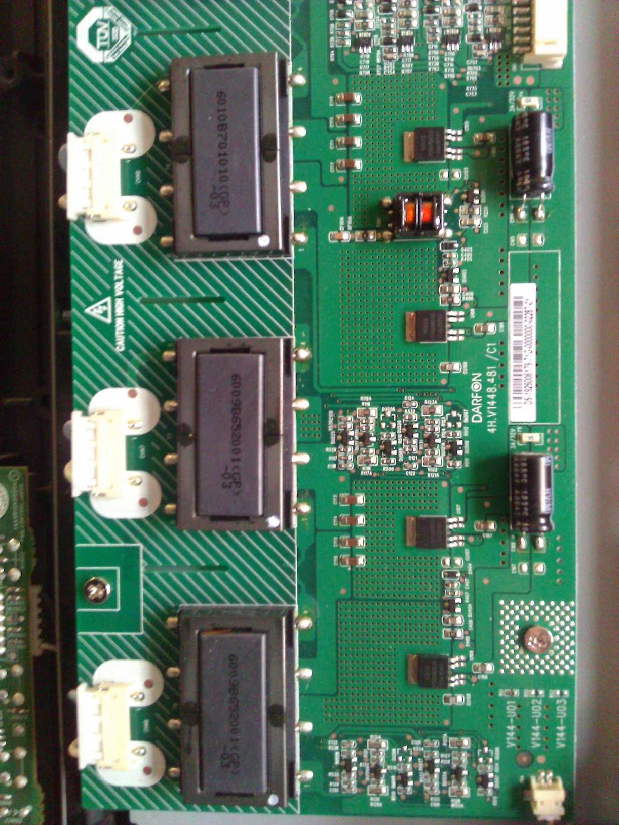

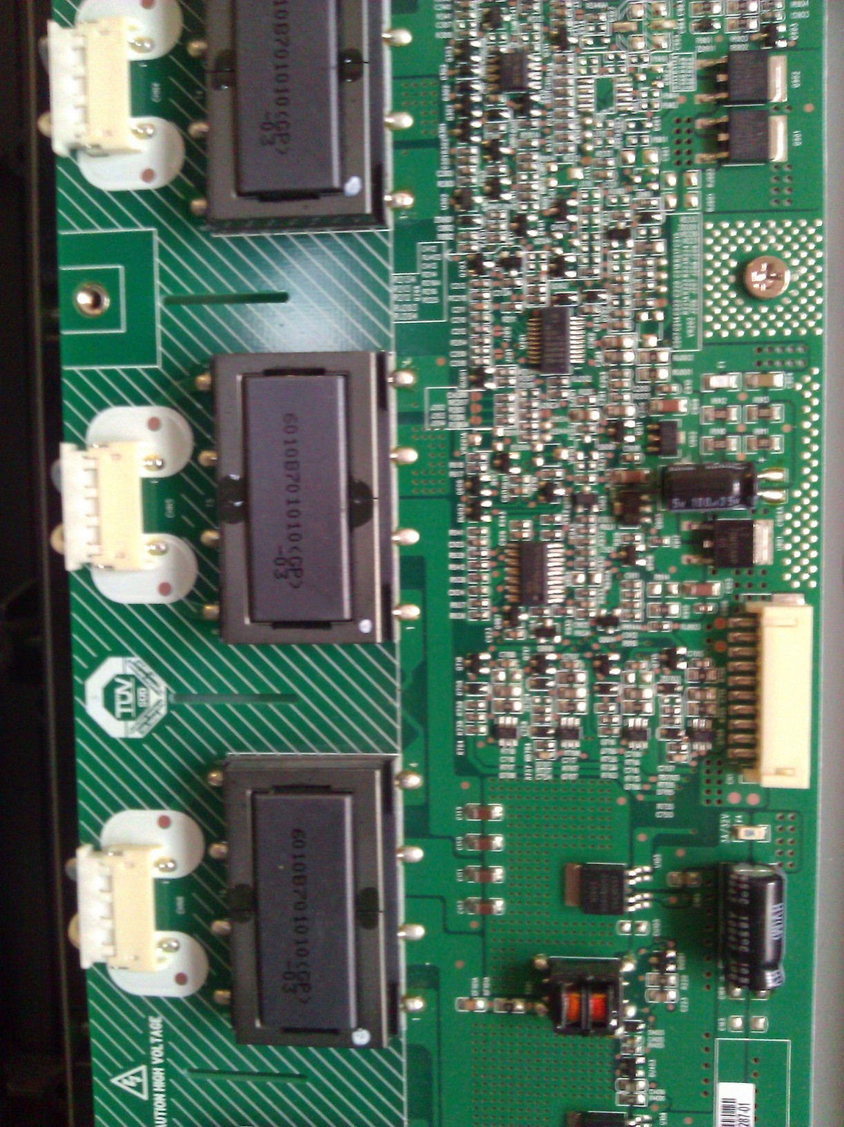

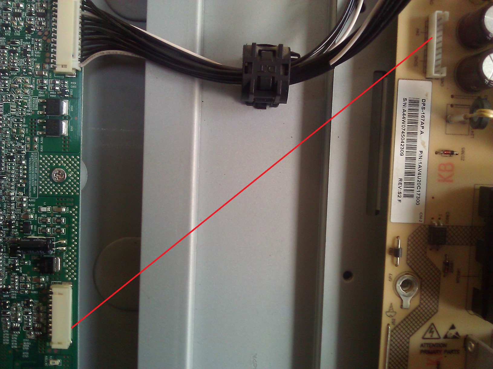

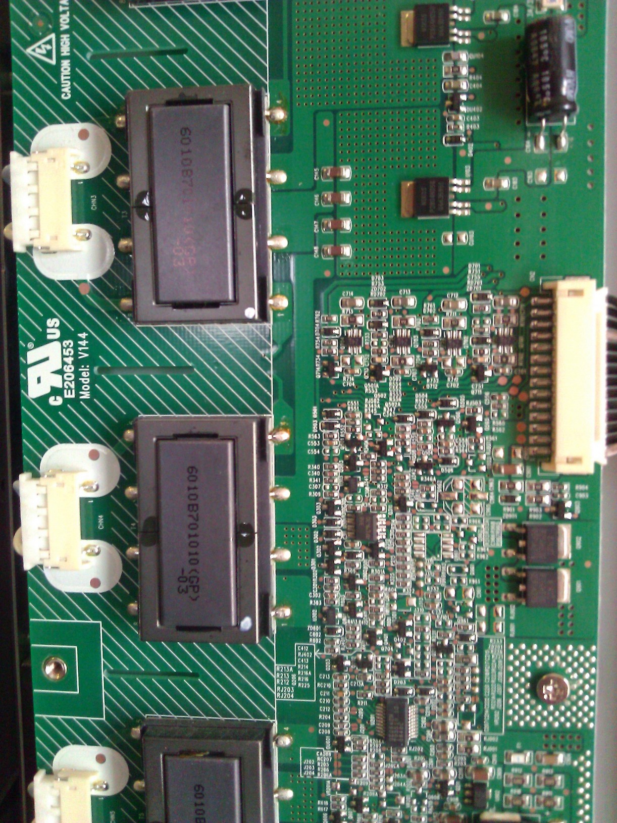

                  Its a long inverter.. Here are a few pics
                    One thing that made me scratch my head is... On the power board there is a cable 24v connection CN5 that is empty and there is also and empty connection on the inverter.. Is there SUPPOSE to be a cable going between the 2....

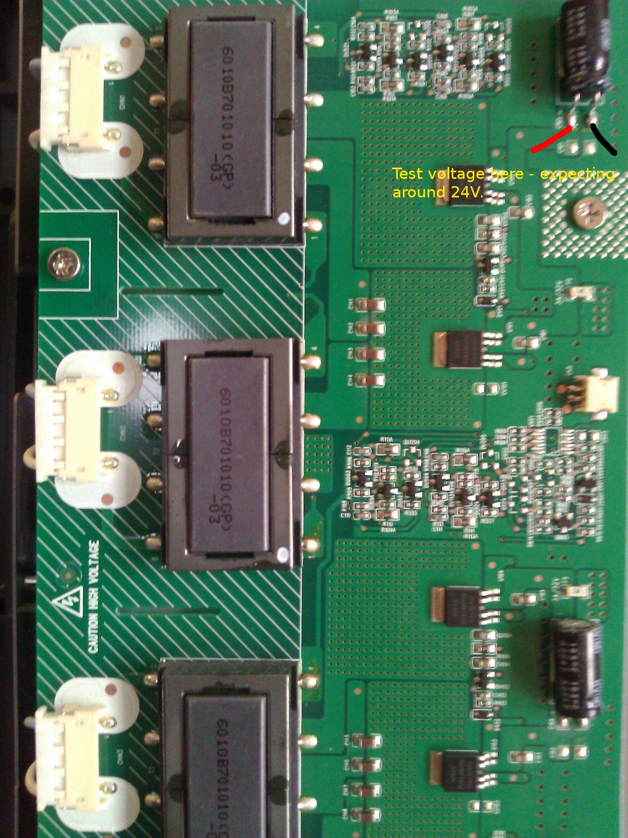

                      OK, test the voltage as indicated in the image. Red probe on the red highlighted pin, black on the black highlighted pin.
                      You can test the voltage on any of the main caps on the inverter.

                        Hmm I wonder. Perhaps the owner tried to fix their TV?
                        • lilmonk3
                          • Apr 2012
                          • 259
                          Thats what I am wondering... The set didnt SEEM to have been opened but ya never know
                            Do the check I mentioned - if it's zero volts or near enough zero, you can always solder individual wires between the PSU and inverter or crimp your own cable.
                              24v on all caps on inverter
                                So I think it's OK. That plug on the PSU is probably for a slave inverter, and on the other inverter is probably for a different PSU, or for use as a slave inverter in some way. Check all the transformers on the inverter next as you have Darfon ones and they often fail.
