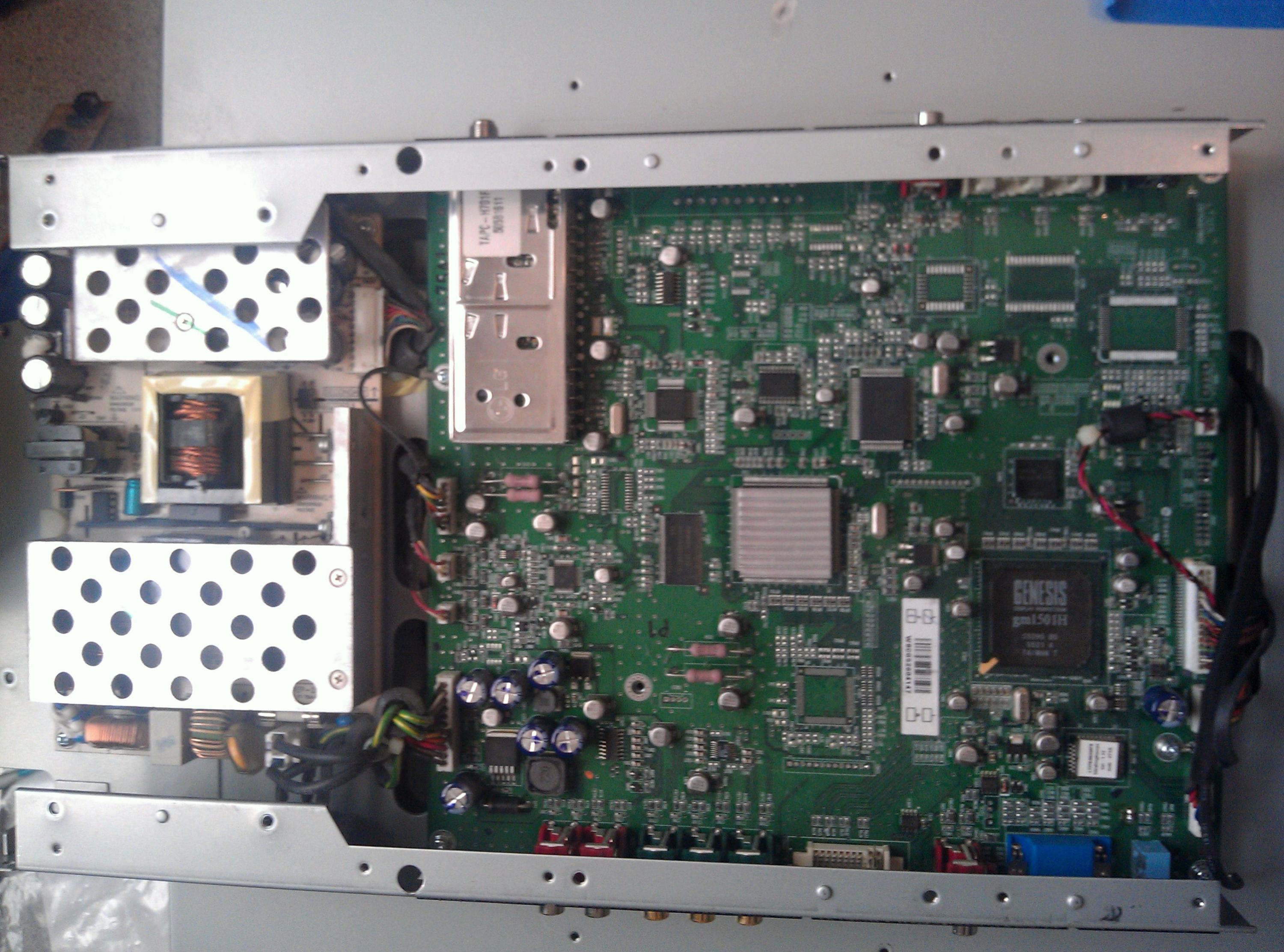

    No backlights
    So I have this Westing house LTV-27w2 and has the 2 seconds to black, can see image with light and has audio. I just wanted some input on the inverter board pin out CN2 , if some one has it to ensure my voltages are correct when turned on. If some one remembers where the post is for using another bulb in the place of mine could you let me know, I don't have any spares.

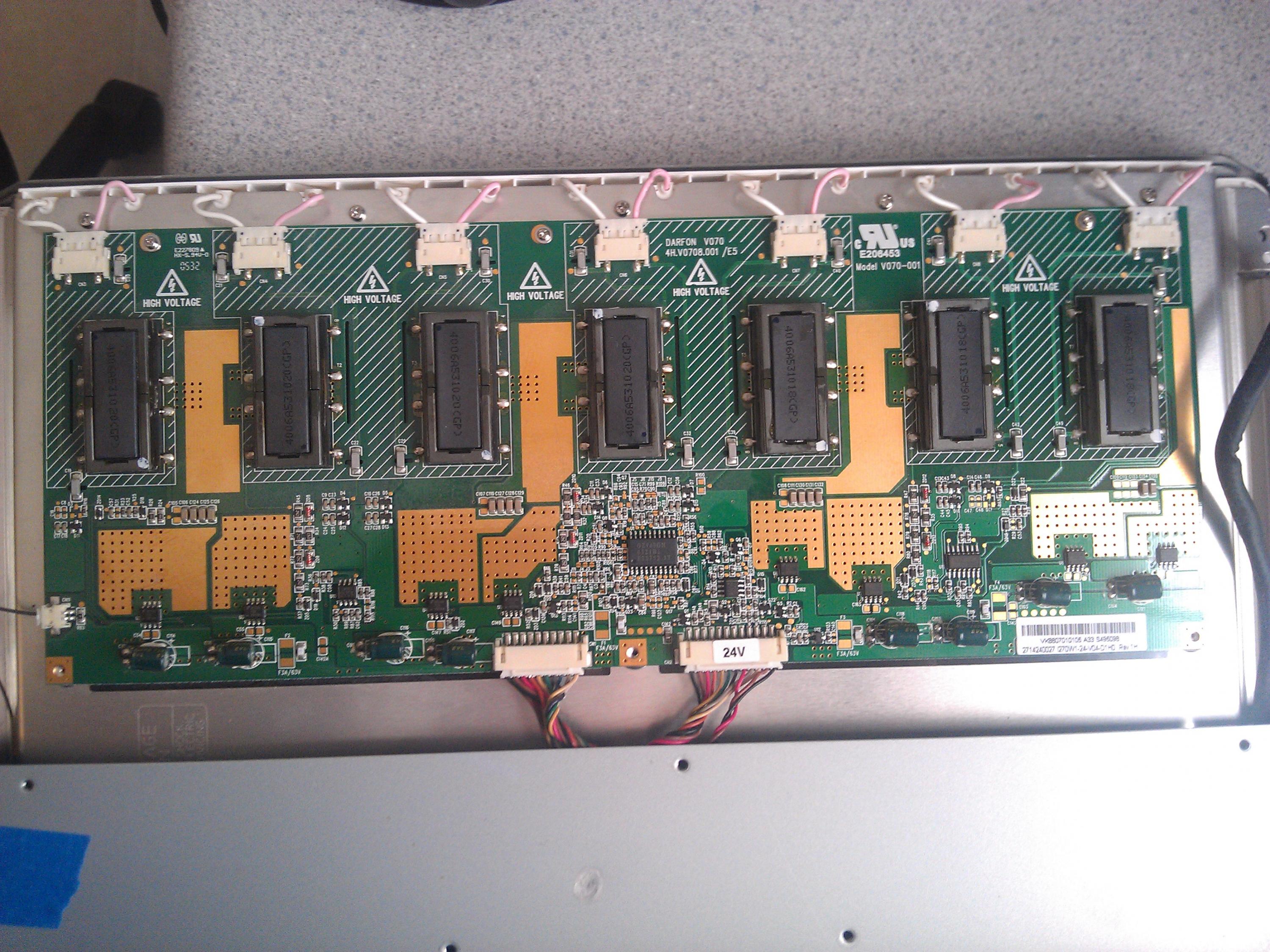

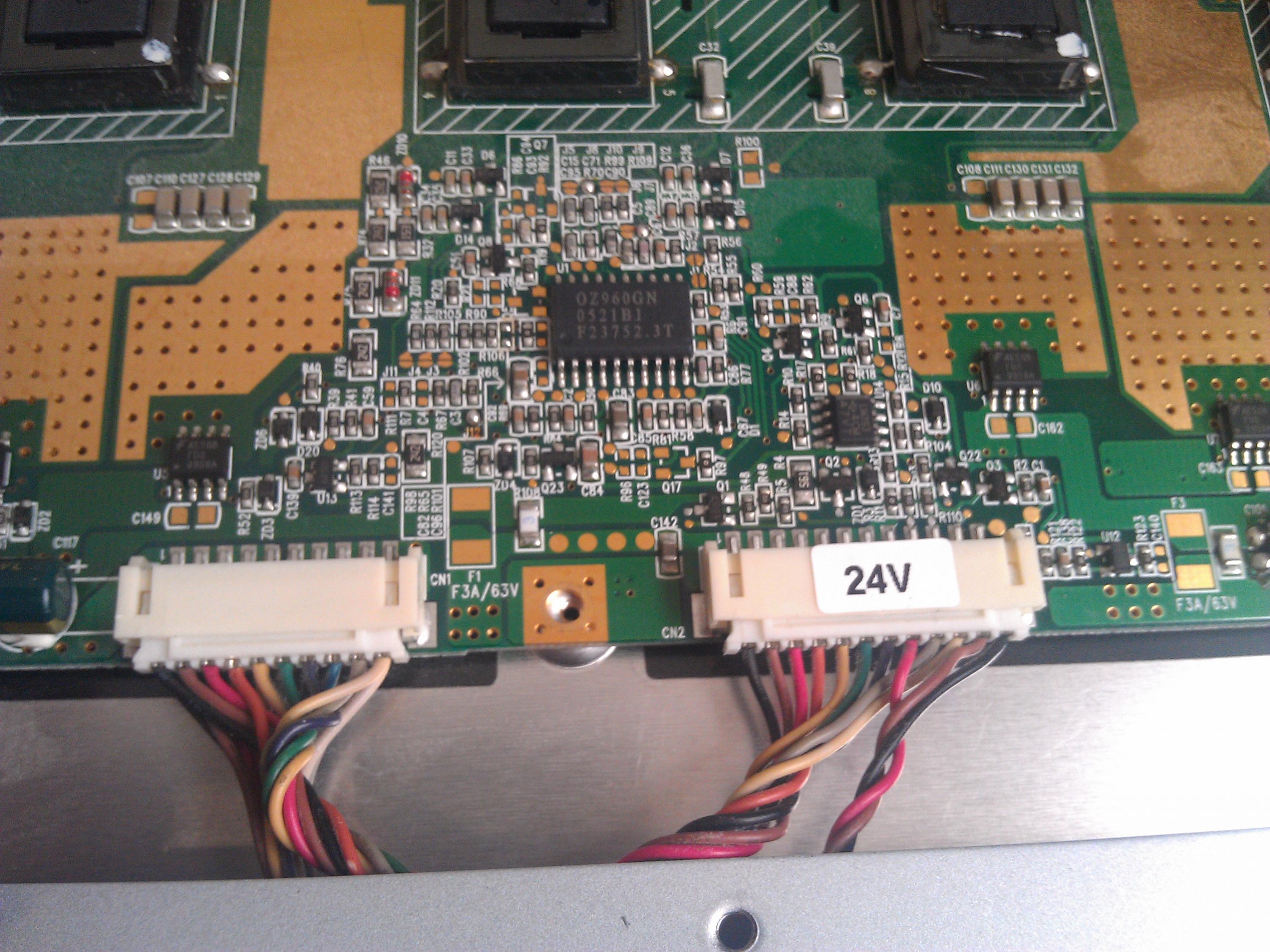

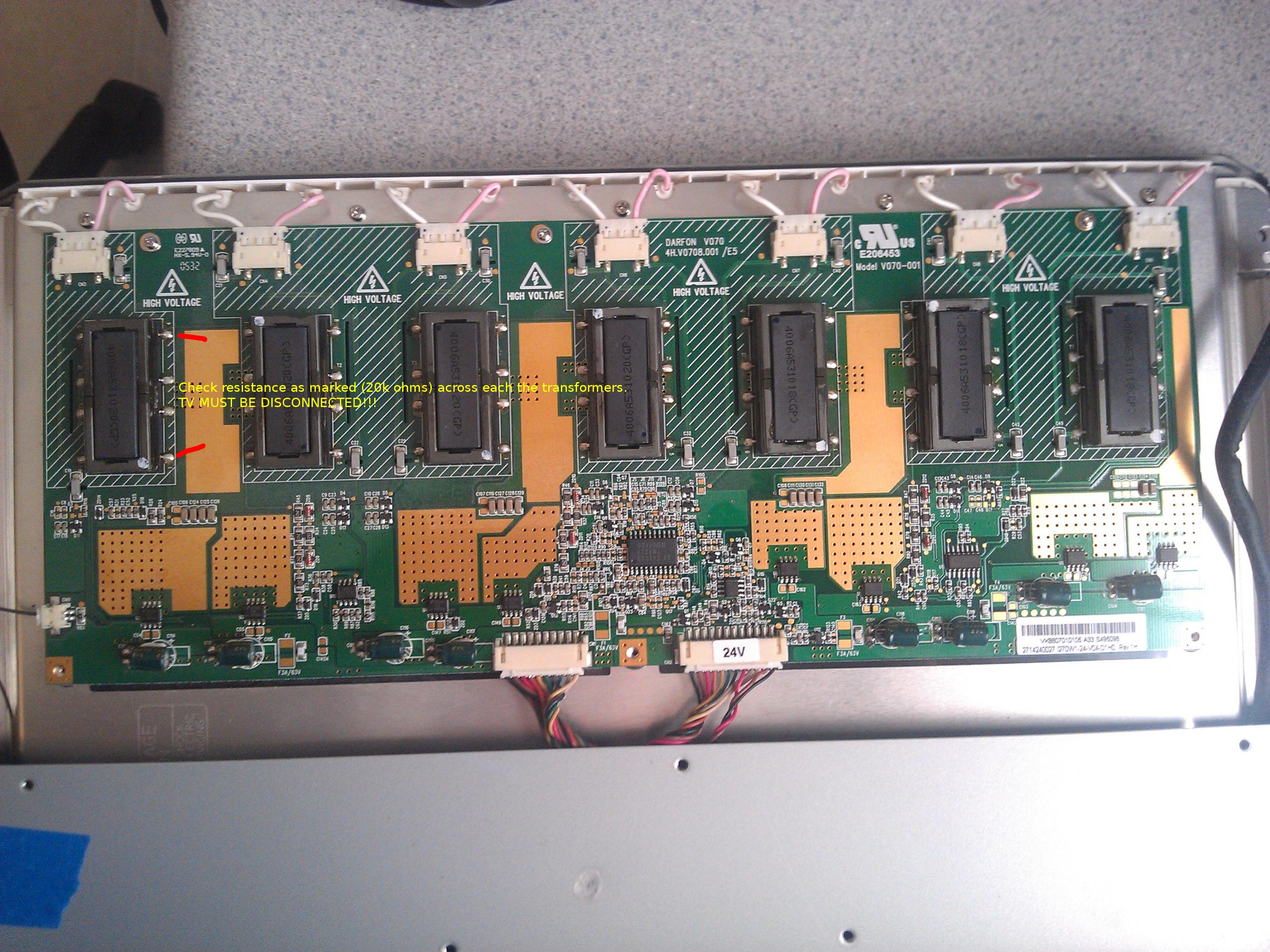

    You have a Darfon board, any time you have 2 secs to black with a Darfon it is essential to check the transformers. See pic.
    All transformers should measure with ±3% of each other. There may be a bad one on the board which measures otherwise.
    edit: Check both sides of the transformer too, not just the side I highlighted in the image.

      Thanks, I thought it might come to that, did a little research and these things are about 20.00 a pop. re-man board was about fifty and hate to have more problems later will let you known later, taking them out now.
        Re: No backlights
        Absolutely no need to remove them for the test, you can do it in circuit.
        Likely, only one will have failed.

            No, I meant you need to set your meter to 20k. They are typically 1-5k, can't remember exact figure right now. List all the readings you get on each transformer, and each side tested.

                You need to measure across the two pins I've highlighted only, and the other two opposite. No other measurements are necessary for now.

                  Transformer 1 pin 1 to 8 is bad. All the others in are the 950 ohms range.

                        Actually, I just stopped at transformer #1 and didn't look at the rest, but now that I do, #3, #5, #8 are bad in addition to #1.
                        Have a look at this diagram.
                        http://www.lcdparts.net/TransformerD...ProductID=2739
                        Remeasure all the transformers and report just S1-S2 and S3-S4.

                          Note some of the transformer pins might have a layer of "stuff". You may have to scrape off the "stuff" or get sharp probes to make good contact with the suspect transformers.

                            Thats a good picture now I can see primary and secondaries. will report back in a few.

                              Heres the results
                              Transformer 1
                              1/8=2.7k
                              5/4=960
                              Transformer 2
                              1/8=975
                              5/4=980
                              Transformer 3
                              1/8=960
                              5/4=960
                              Transformer 4
                              1/8=960
                              5/4=950
                              Transformer 5
                              1/8=940
                              5/4=954
                              Transformer 6
                              1/8=958
                              5/4=964
                              Transformer 7
                              1/8=955
                              5/4=950
                              • retiredcaps

                                Okay, 1 is bad for sure. Scraping that stuff made a big difference in the other readings as you can tell for youself.

                                  yes sir it did, can actually touch the legs, so I will get a new one and go from here. will measure it again when I remove it. sure is nice to have a diagram. Hate not knowing how something is wired. I really thank you guys for the help.

                                        Get a couple so you have a spare just in case. The ones at the "top" of the TV seem to fail more often than others. On mine, it was the 2nd from the top.
