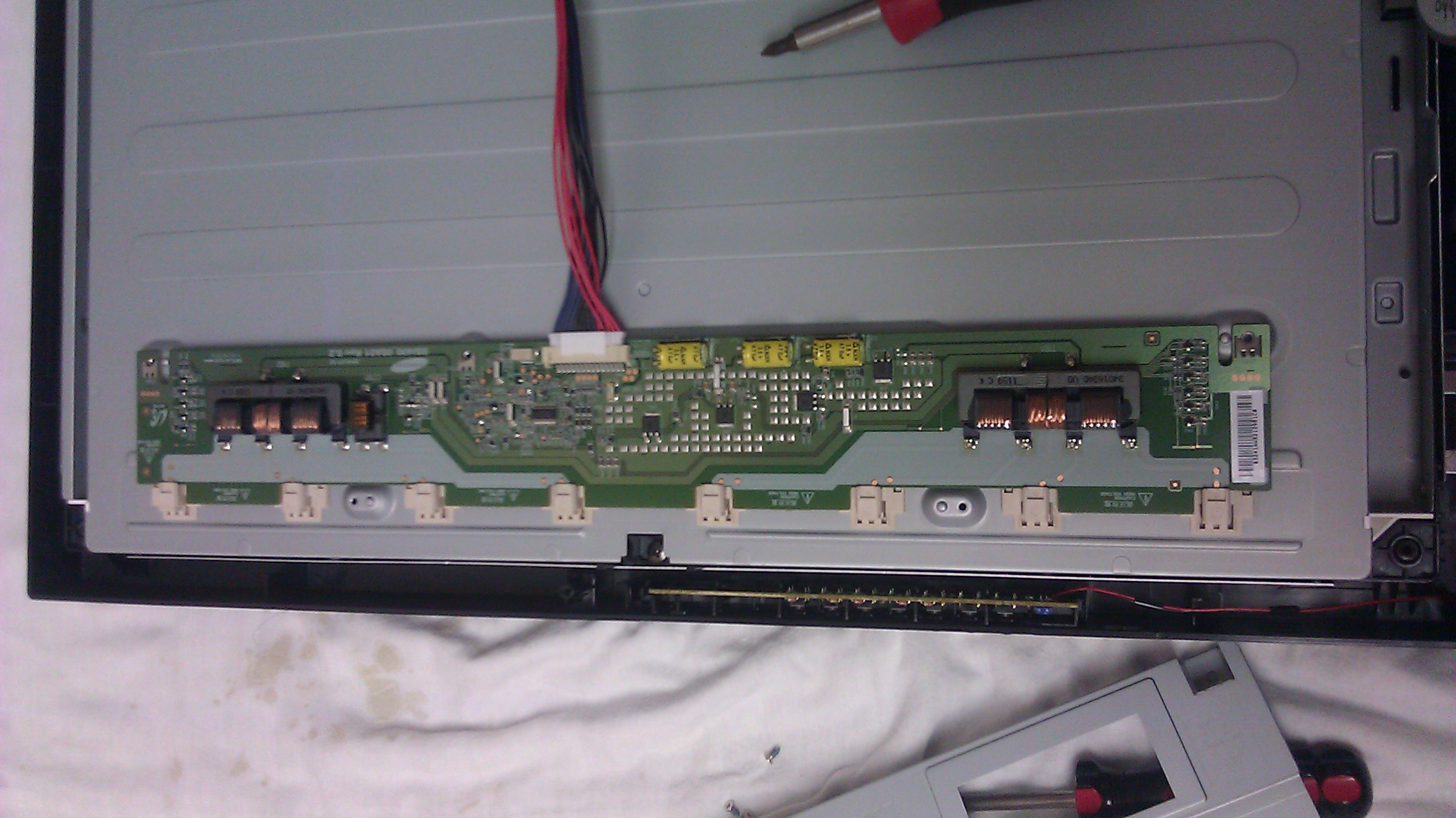

            OK. I suspect the inverter board or the main board. You have a multimeter? Can you post a picture of the inverter board? It's the board that the red and black multi-wire connector plugs into (not the power supply.)
              Re: Emerson LC401EM2F Flashes "Digital Television" then goes black
              Here is the inverter board. Quality may be lower than the others, had to take the pic with a HTC phone.
                    OK, this inverter has an error signal. That is a rare feature, but it could be that the inverter detects a fault, which then causes the main board to shut everything down.
                    Can you set the TV up as normal, and check a few things:
                    - one of the VIN pins
                    - the ERROR_OUT pin
                    - the ENA pin
                    To check them: Set your meter to the 200V scale; don't worry, the maximum measured will be about 24V, we just need to use a scale which will work. Then, place the black probe in the chassis of the TV. Probe the pin of interest with the red probe and then turn the TV on normally. Watch for any changes. I am expecting the ERROR_OUT to quickly come on, but then go off after a couple of seconds as the power supply shuts down. I'm also expecting you'll see VIN at around 24V (+/-1V) for a couple of seconds.

                        Did you get the TV as faulty or have you owned it since new/used? Since the voltages are staying up you -should- be able to select a source, or connect an antenna and listen to digital TV. I am pretty sure that the problem is the inverter if it shuts down with good 24V and enable pin being high.
                        Try this test. Test the ohms between each pair I've drawn. Use 20k ohm range, TV must be unplugged. Test the other transformer too - the one on the lower side. All readings should be nearly the same, within +/-3% of each other.
                        The photo isn't clear enough to see if there are any fuses on the board (there are almost certainly some), so if you get the chance, please take a clearer shot with a better camera. I had a TV which would briefly flash the backlight and it was due to a blown fuse, it was detecting a fault with half the bulbs because there is one fuse for each set.

                          All readings were between .610 to .614 ohms. I got this TV in this condition. The power supply board had been previously replaced and I have both the old and new power supplies. There are 2 fuses on the inverter board, both test good. No blown caps and no obviously damaged components or discoloration from heat. Also, the inverter output runs about 700v for a couple of seconds during the time the screen illuminates, this is regardless of weather or not I have the lamps connected. Same problem happens on either power supply.

                            You should avoid testing the inverter outputs some multimeters can be damaged by the high frequency AC (worse than the high voltage.) When the TV starts approx twice the operating voltage is applied to strike the bulb and make it light. But you are saying that you get continuous voltage, and the CCFLs go out before it dies?

                                    That's quite helpful. You can try seeing if there's a brief spike on the ERR OUT pin. It could be very brief. If there is, then the inverter is shutting down because it detects a fault.

                                        OK then, I would still suspect the inverter, as it may have a failure not signalled by the error pin.
