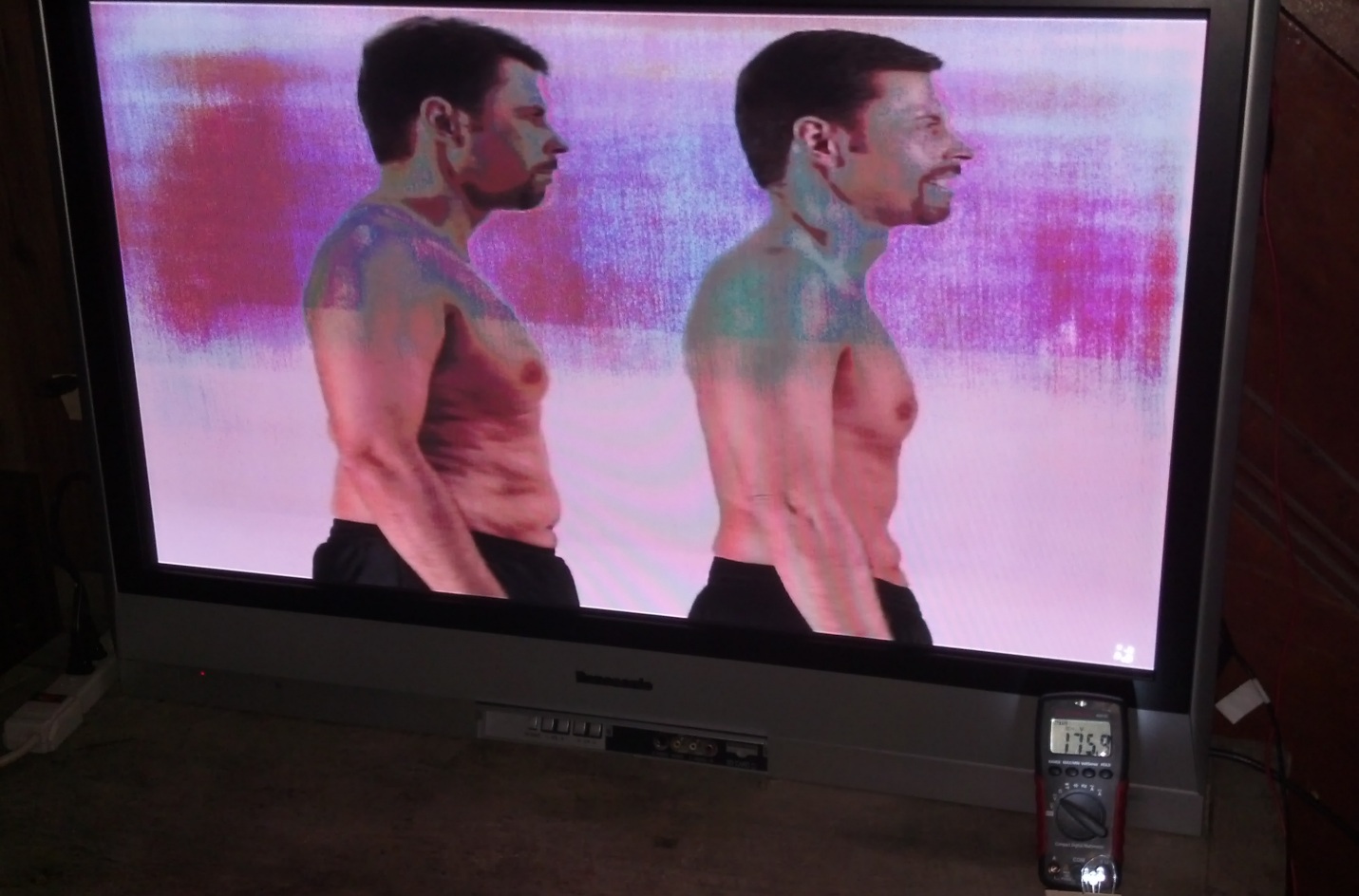

              Re: Panasonic TH-42PX60U Plasma Turning Off Occasionally 7 Blinks
              My first voltage test on VSUS last night is reply #22 (just wanted to make sure you seen the results)
              Tonight i borrowed some different DMM probes so that i could use my new/better Dmm with my grabber clips( grabber clips wouldnt fit on my new meters probes)
              I also set up the DMM and tv so i could watch the tv and monitor the voltage tonight.
              My new meter is giving slightly different voltage 192.7v ( as opossed to 191.6from last night with my cheap meter)
              VSUS = 193v is what the sticker on the tv calls for.
              I watched the tv and meter for 3,40 minute sessions and the VSUS voltage was pretty stable from a low of about 192.2v during bright white scenes to 192.8 for dark scenes. 192.7 average most of the time.
              But 4th session i stayed on a channel that had a infomercial that was bright white, and yeah you where right Tom the voltage started to drop to as low as 175v with colored pixels on the screen (see pic)
              For about 20 mins the voltage was unstable going anywhere from 175v to back up to 192.7 ,But the tv never shut down.
              After about 20 min the voltage became stable again at 192.7 and tv is still going and has not shut off yet.
              So yeah,Wild readings last night on the VSUS test point on the SS board,and tonights readings at the VSUS test point on SC board going as low as 175v.
              What do you think is going on?
              Have infomercials ruined this tv LOL! And sorry about the creepy pic LOL(its the only one i could get showing the image starting to act up)
              Thanks!
                  Bottom half looks good, top half not good. My first guess would be the SU board. 7 blinks covers SC,SD,SU boards.
                  Maybe this what is shutting it down. probably starting to fail and loading up the SC board taking the voltages down with it.

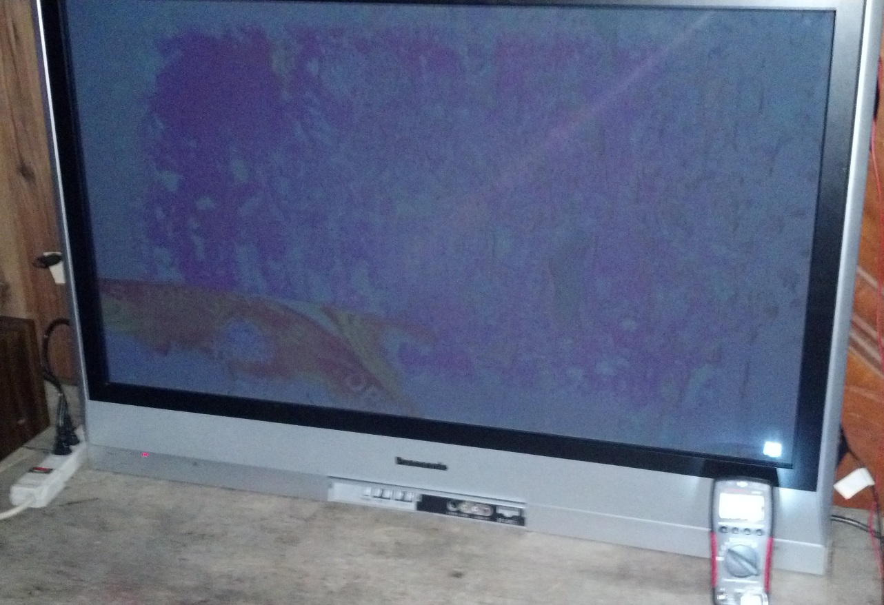

                        I was able to catch it tonight turn off watching the DMM, it went down to 150v and the screen was almost completly dark ,then it shut off.
                        The screen does get funky first at the top ,but it soon drops to the bottom of the screen then the whole screen starts to go dark evenly,
                        I caught a pic just before it turned off ,not a great pic but should give you an idea
                          Originally posted by allsmith
                          So I should back it down a bit then do the cycling,staying down lower than the original position? Or should i cycle the full range of the pot?
                          Return the pot to the original 193V setting once you have done the cleaning.
                          It definitely looks like insufficient Vs problems. The Pioneer I serviced though
                          would still have some visible discharge at as low as 130V, but obviously, very poor image.
