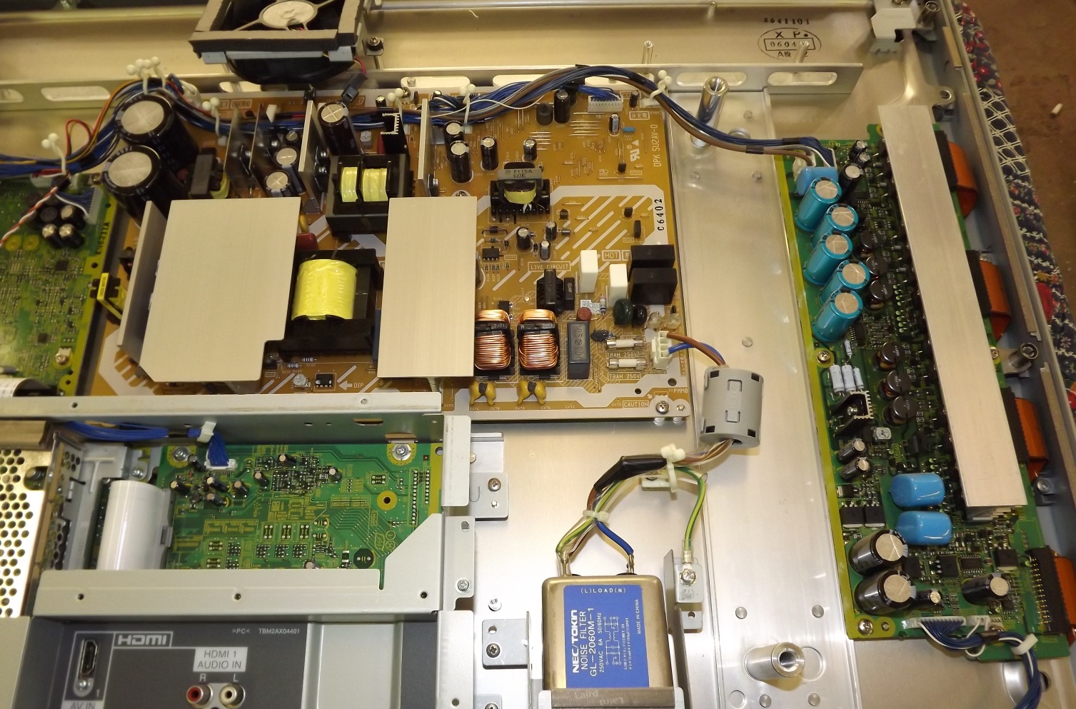

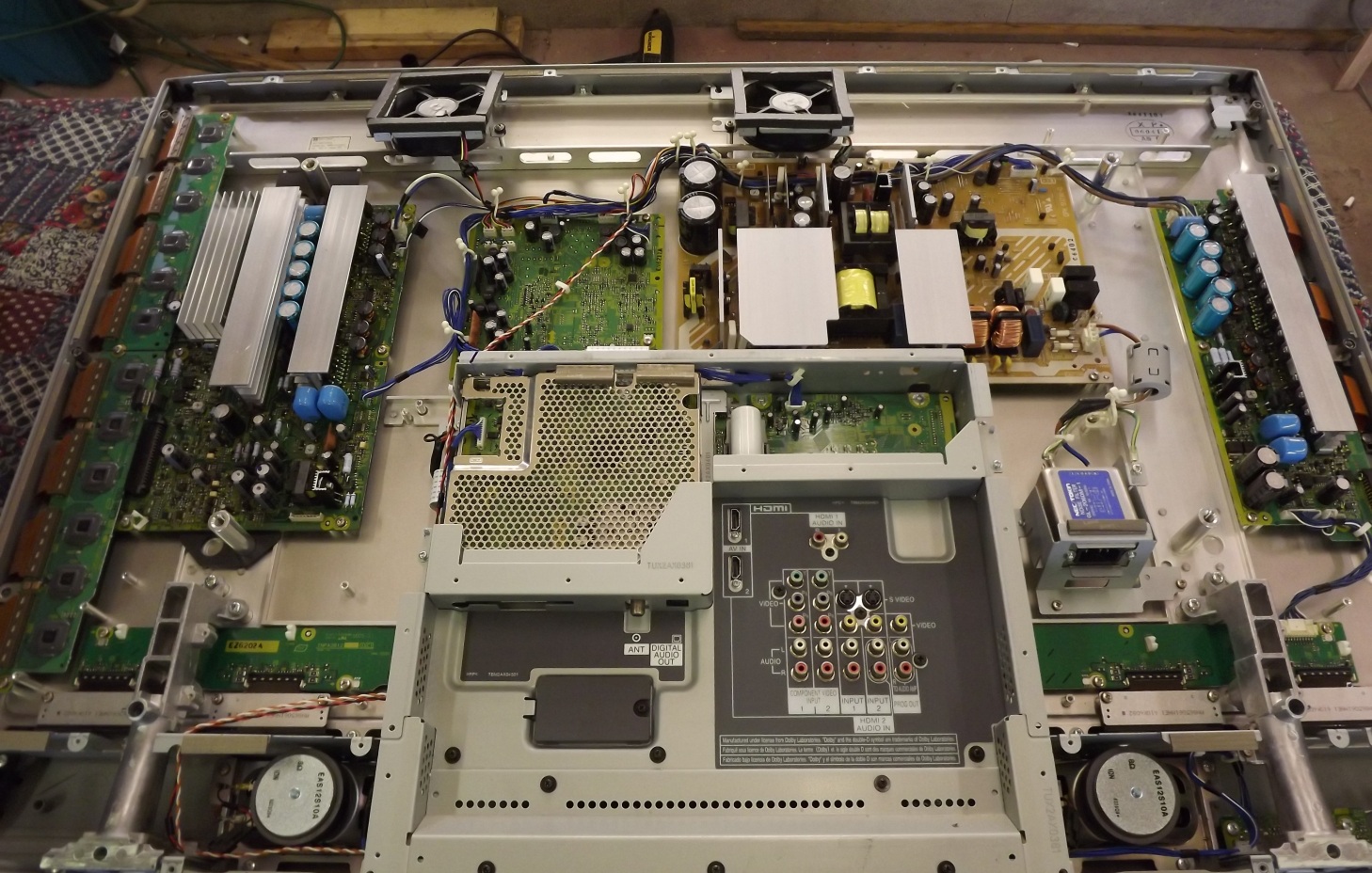

    I brought it home and opened it up and the first thing i noticed was the fans were very dirty and the gaskets around the fans that seal them to the back was deteriorating,so i cleaned the fans and put new foam gasket on the fans.

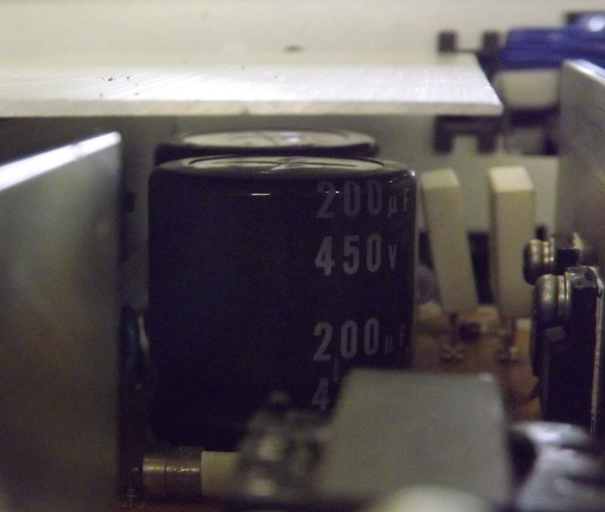

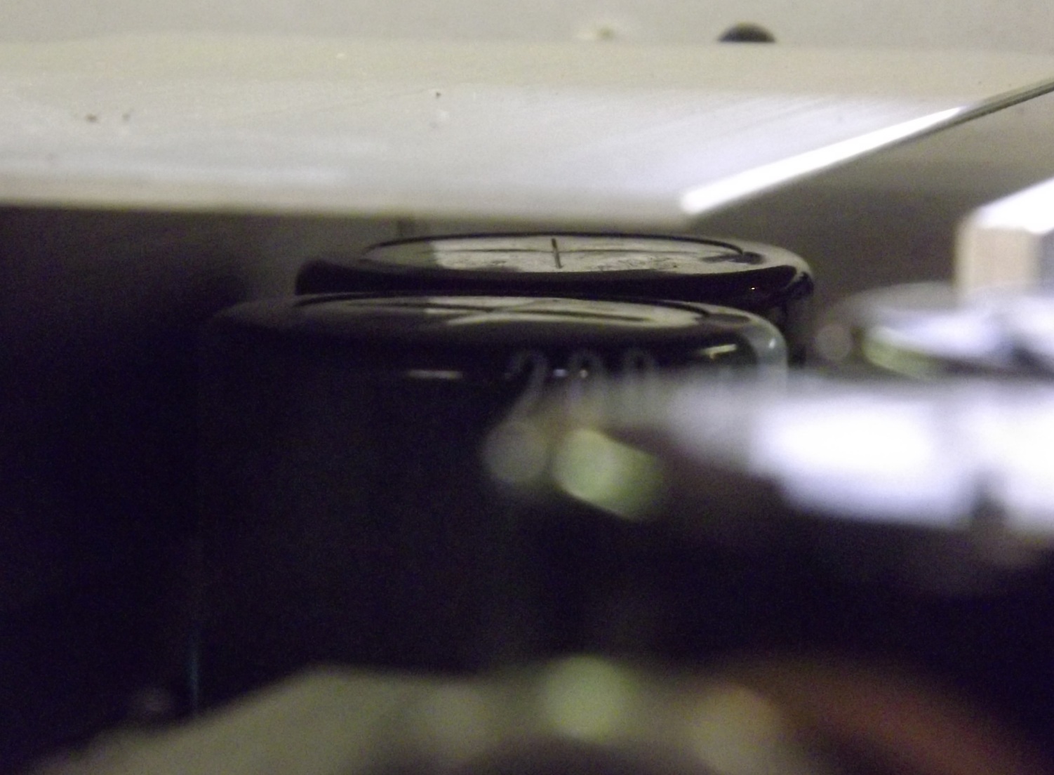

    Second thing i noticed is a capacitor on the power supply was slightly domed,it is one of two caps under the biggest heat sink on the power board.
    Its not bloated much but is some and all the other caps are perfectly flat,its a nichicon 200uf 450v.

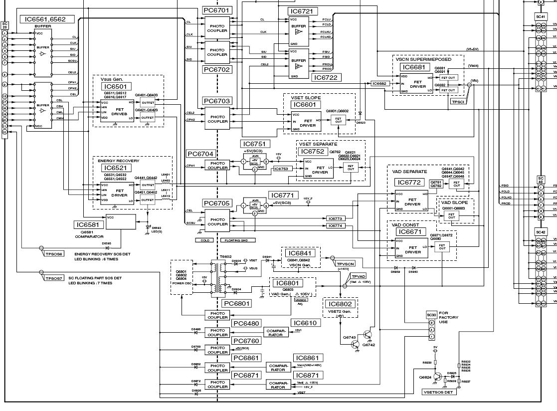

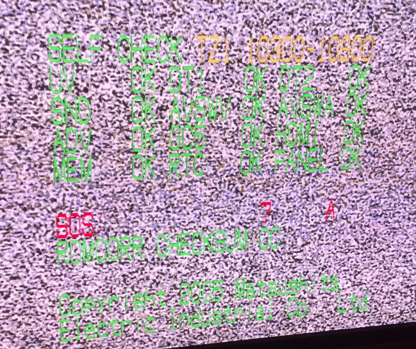

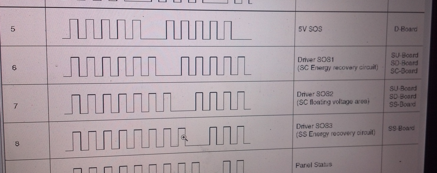

    I downloaded the service manual and 7 blinks is... Driver SOS 2 (SC floating voltage area) Test points SU/SD/SS board
    I did the self test on tv and everthing says ok,but it has SOS 7 A in red.

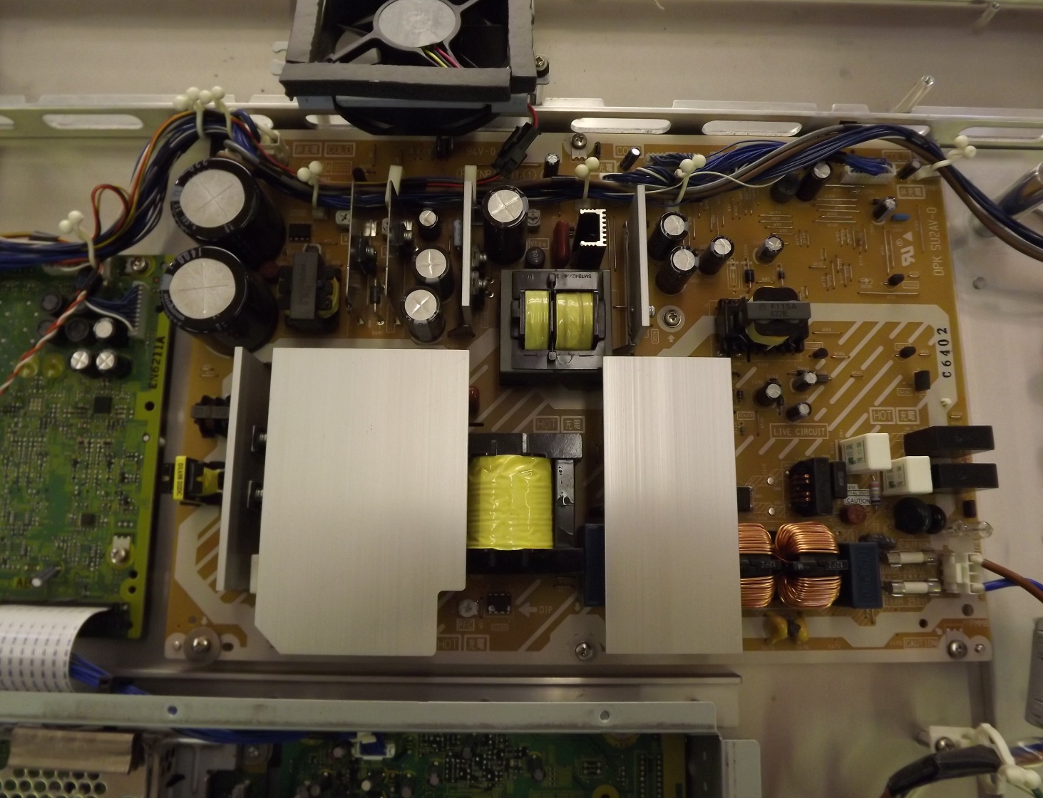

    I have a suspicion you have a cold joint or a dodgy Vsus voltage adjustment potentiometer. The screen going dim is an important symptom.
    It's quite normal for big caps to look a tiny bit domed from the right angle. Panasonic use very high quality caps in their older sets (newer ones are getting crappier ) so it's unlikely to be the problem.

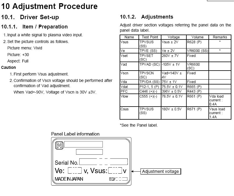

    Do you have a DMM (multimeter?) There is a test point for Vsus. It should be around 205V for older Panasonic, I think. Monitor it - if it starts dropping just before the picture goes, you have the problem.

      Thanks Tom, I was worried this one would be hard to troubleshoot as it is very unperdictable to when it shuts off,
      I knew it would be hard to see in the picture, but the top of the one cap under the heatsink definitely looks different on top than all the rest of the caps on the tv.Understandable that they are high quality caps though.

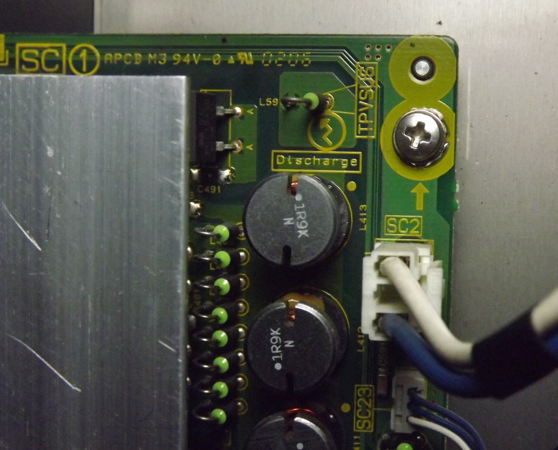

      Do you want me to get a close up picture of the area that the test point is at,so you can point it out to me?I can do it in about 9 hours from now as im about to hit the hay here soon.

        For now, I would say that cap is OK, as the symptoms don't really fit with that cap going bad.

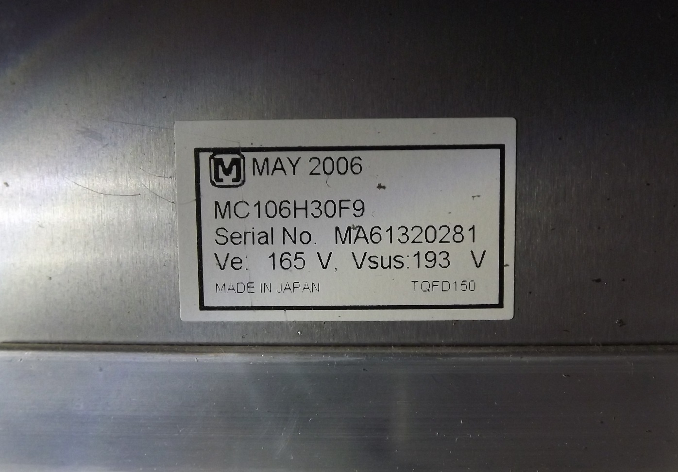

                  Originally posted by tom66

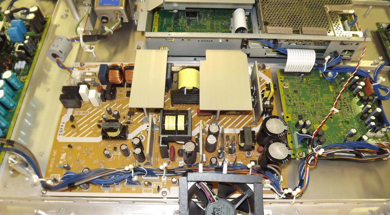

                  On the back of the plasma panel there will be a sticker indicating Vsus, probably hand written as the older ones were calibrated by hand by technicians. If it drops by any more than a couple of volts while running (even that wouldn't be ideal), I would say you have a problem.
                  I found the sticker..Vsus 193v

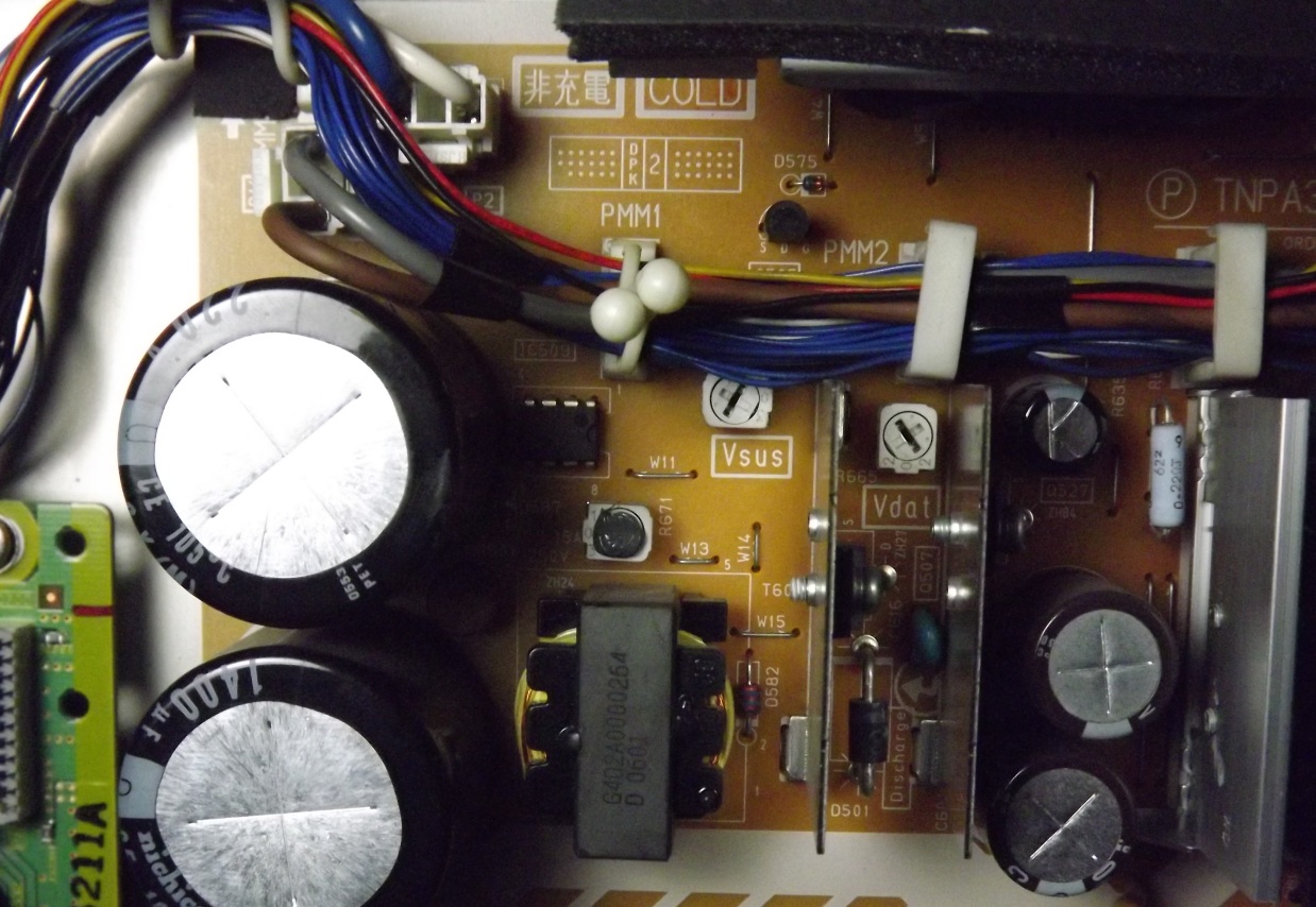

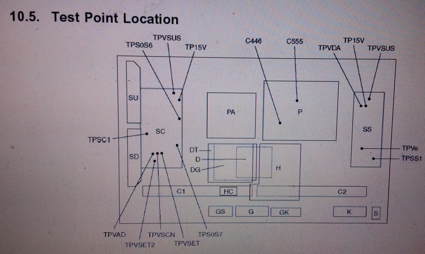

                  I found the Vsus pot on the power board.

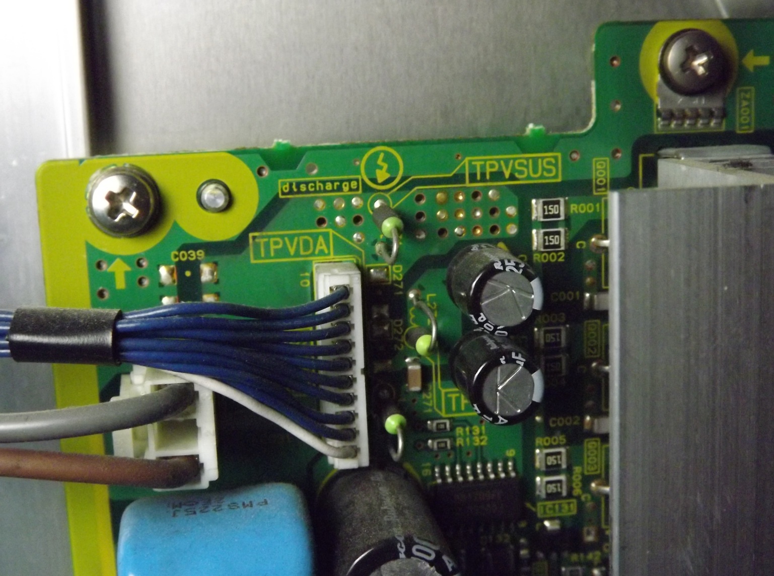

                  I found the Vsus test point on the sc board.
                  I found the Vsus test point on the ss board.
                  Will i need to be testing voltage on the Sc or SS board or both?

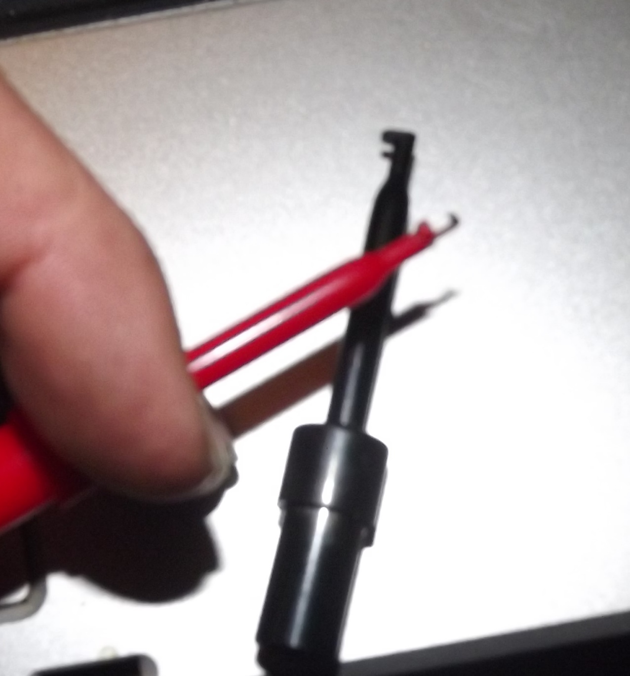

                  Do i need to attach my Red DMM probe to the bottom of the test point diode or can i hook to either side? Is my black probe going to chassis ground?
                  I have clip on probes for my DMM,should i get them all attached when tv is off for saftey? Any other tips on saftey as i see it says discharge at the test points,I do understand there is more voltage in these plasma tvs so i wanna be extra cautious!

                    I worked on a 2008 made LG 22 inch monitor. I unplugged the lcd from the power bar before I went to sleep (like I do with all my projects that I'm working on). The large filter cap kept its 165V DC charge overnight. I had to manually discharge the cap with a 100K ohm resistor.
                    The grabber clips are an excellent way to work with high voltage.

                        Measure it at the PSU.
                        Interesting design, this plasma appears to use a Ve voltage instead of Vda. Also, 193V is low for a Panasonic.

                            I didnt see a test point for Vsus on the power supply board,Just the pot.
                            But i probably didnt look good enough,I will look again.
                            So I dont test at the test points on the sc and ss board,but a test point on the power supply board?
                                You could use those too, there shouldn't be a problem.

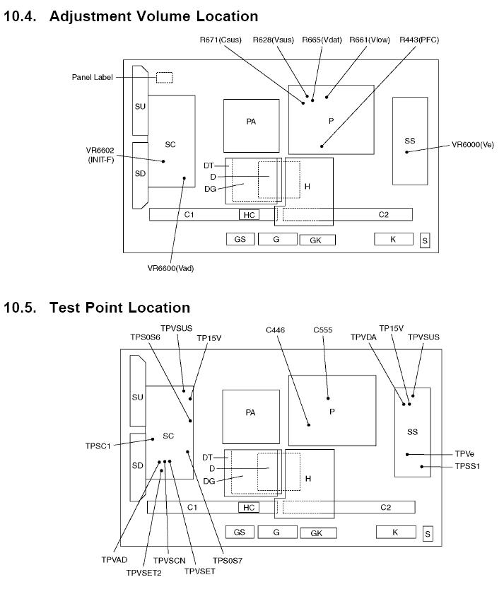

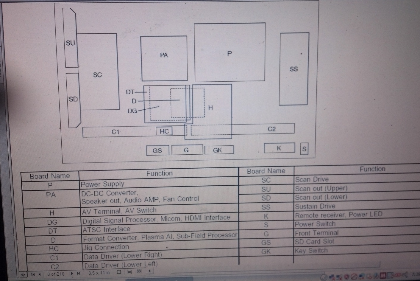

                                  Here are the test points from the service manual.
                                  Should i use chassis for ground?
