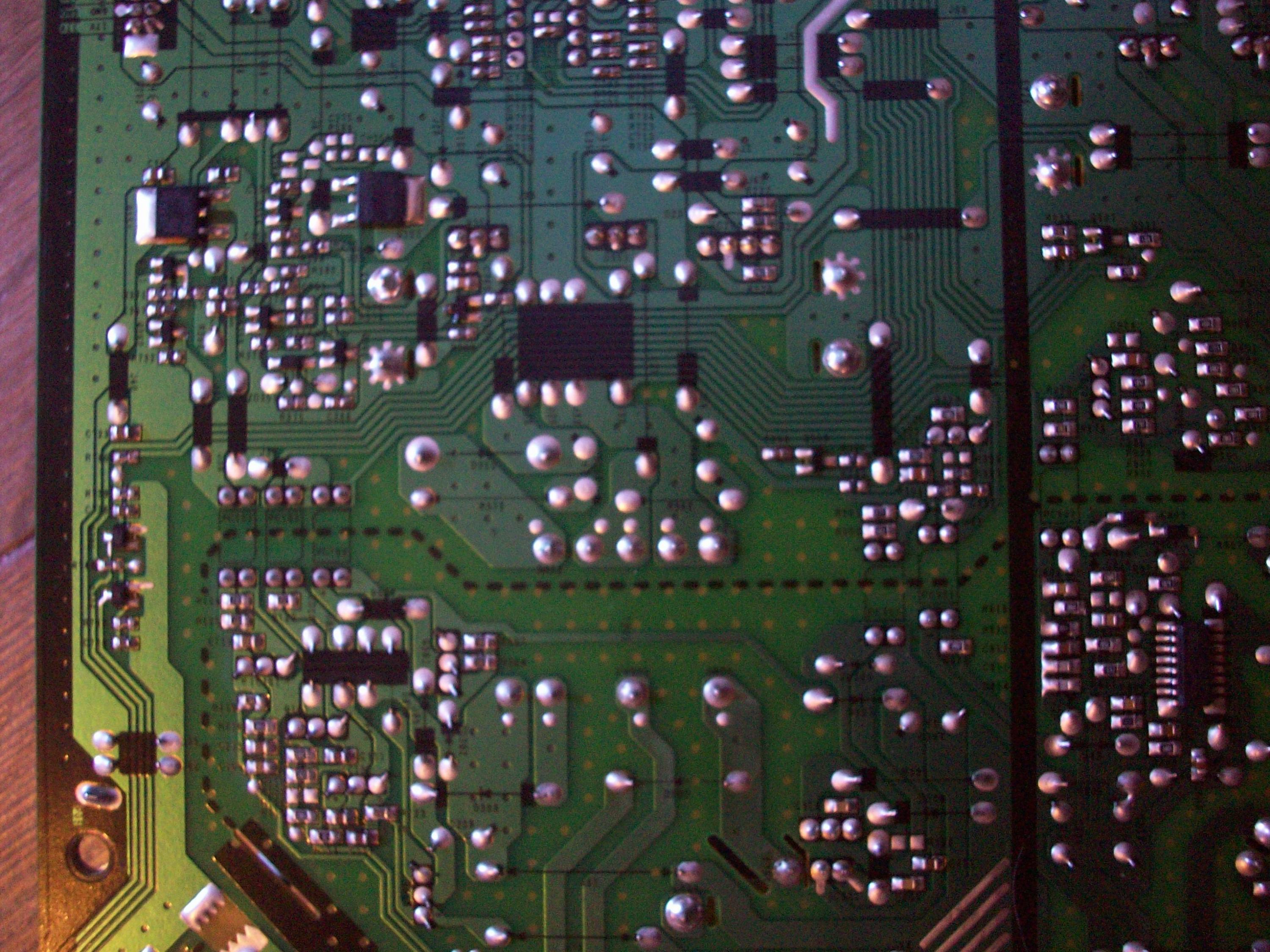

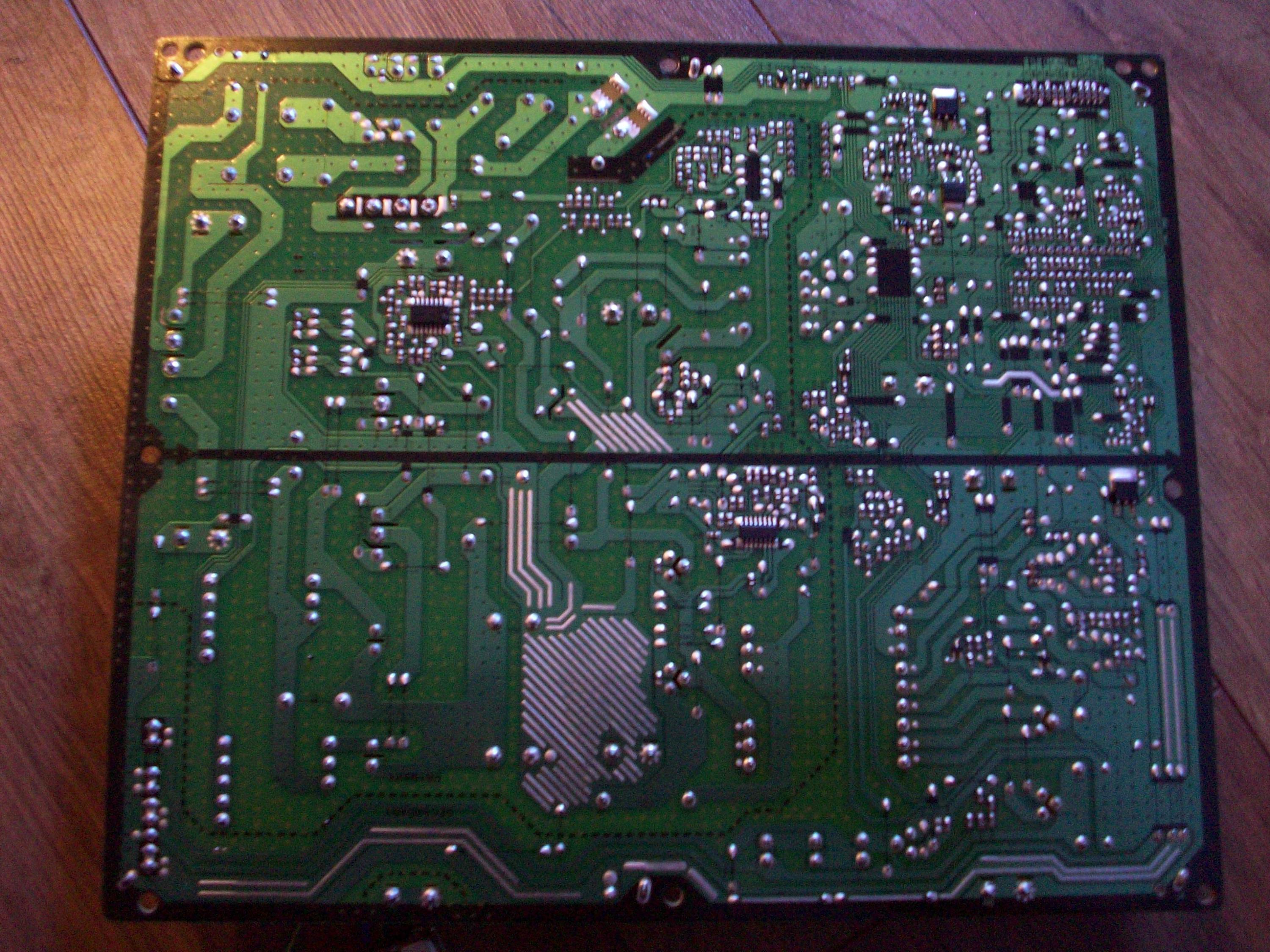

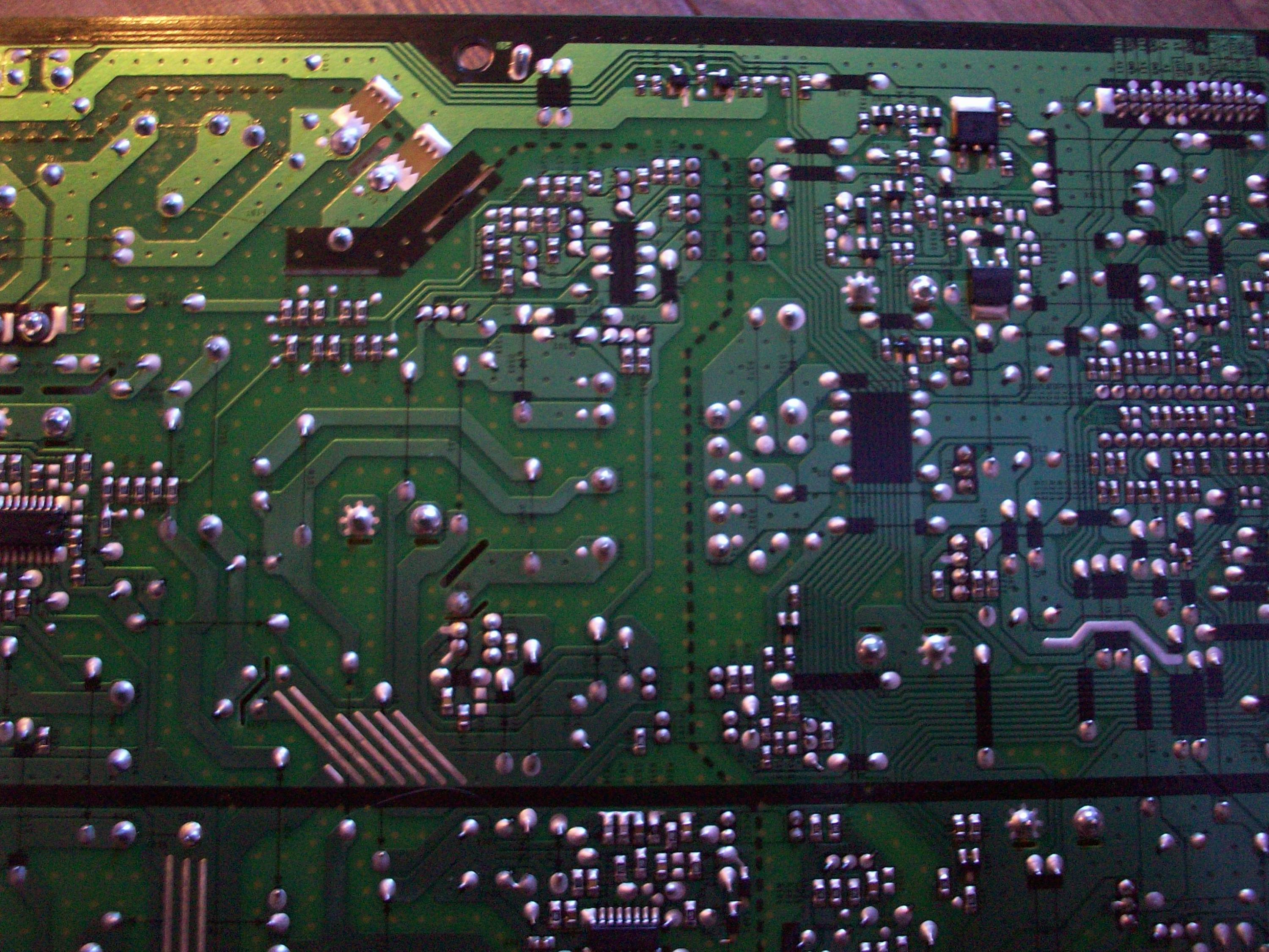

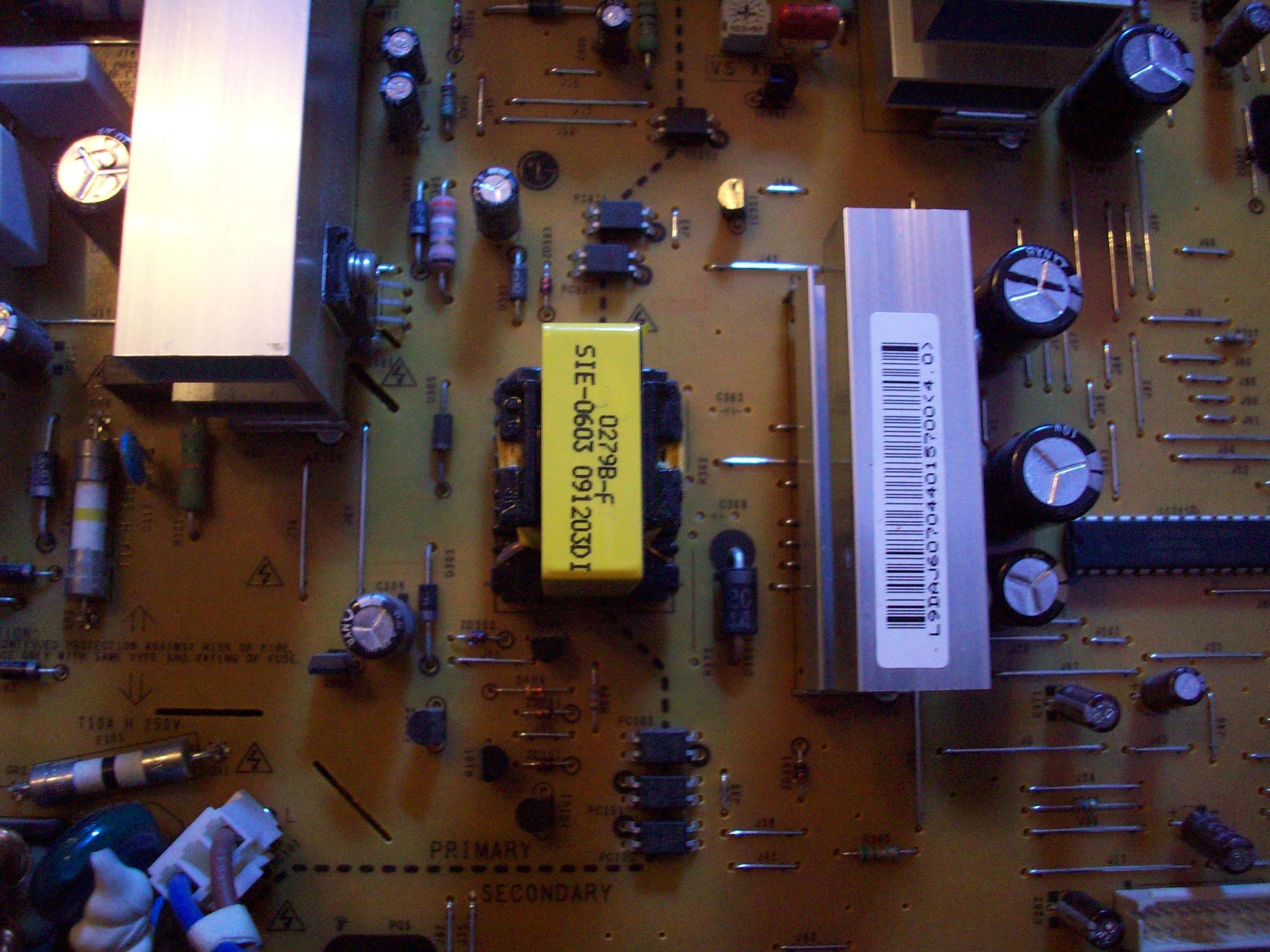

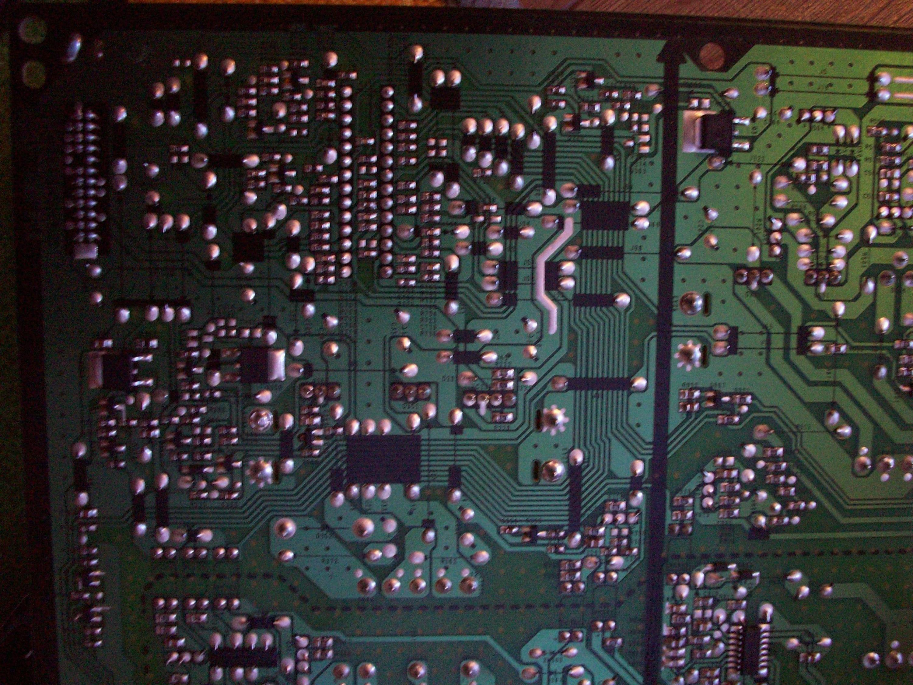

                              Re: LG-50PQ6000 clicks and clicks and clicks

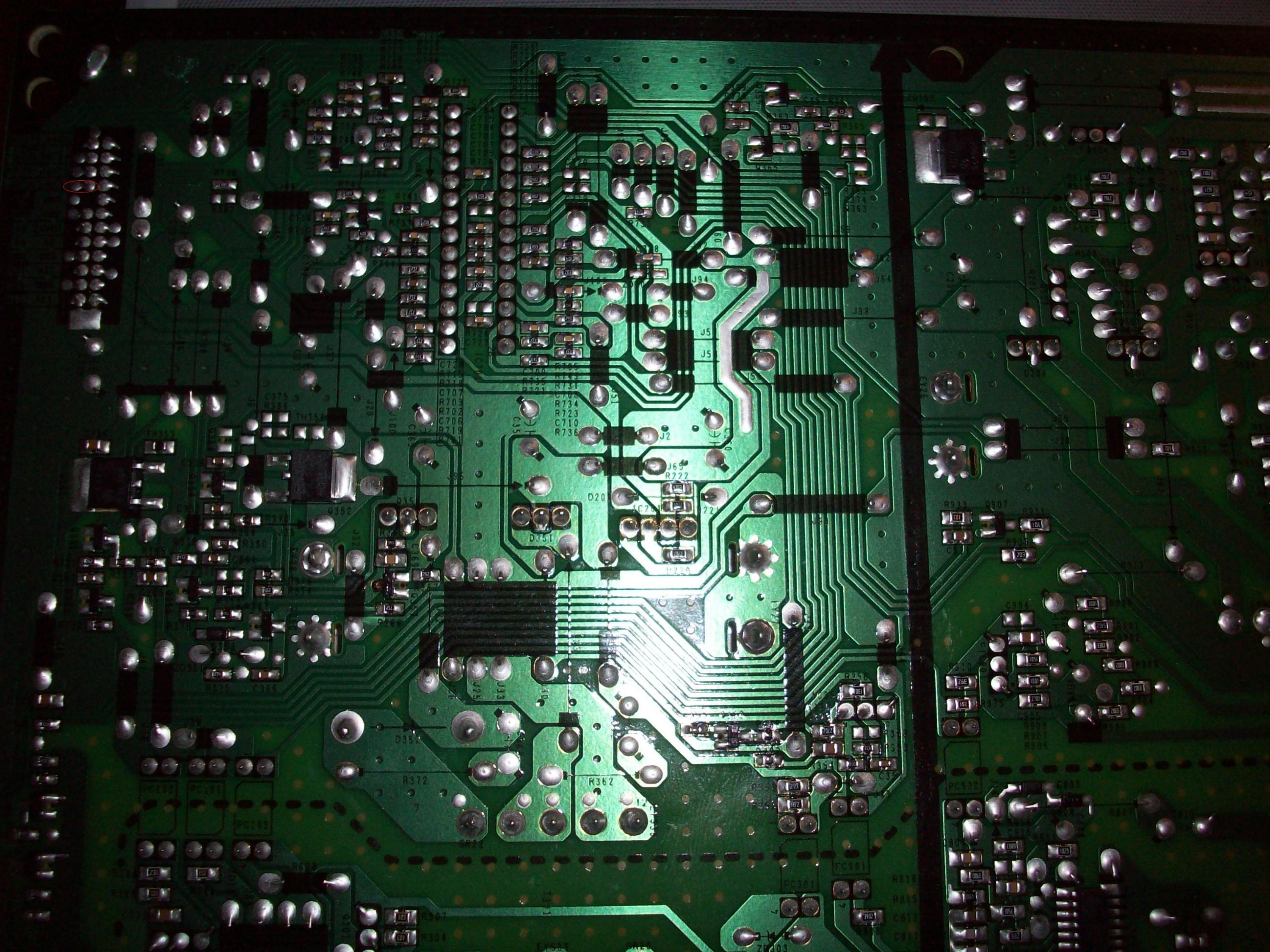

                              No, I think that is fine, and you have the AC detect problem. Can you share a pic of your PSU, from the top and bottom, in very good detail (2000x2000 or smaller, but the bigger the better.) I will try and highlight where to make the mod.
                              • Baileybum1234
                                • Sep 2012
                                • 245
                                ok think there attached. I assume your wanting to see the opto isolators so have tried to zoom in on these?
                                Thanks for your help by the way mate.
                                Repaired: LG50PQ6000

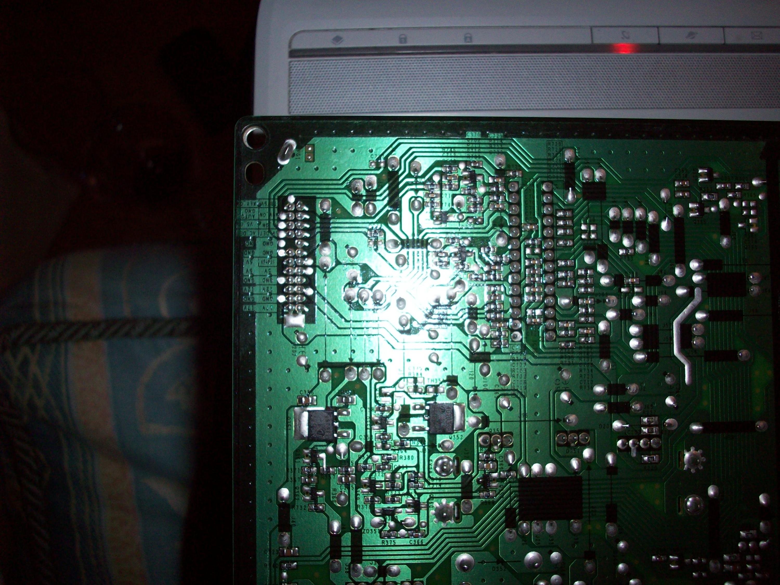

                                  Boring night in uni dorm at the moment. Can you highlight the AC det pin for me? I can't quite see it.
                                  • Baileybum1234
                                    • Sep 2012
                                    • 245
                                    Ok dont know if this will help. Boring night in dorm? What you studying electronics?
                                      I am studying MEng Electronic Engineering at Leeds, this is my first night . I can't see the traces on that board near that pin. Can you try taking a picture in sunlight or floodlight room - instead of with a flash? That usually works well.
                                      • Baileybum1234
                                        • Sep 2012
                                        • 245
                                        Ok that didnt work but you can see the identification on the board. Also hope this marked it for you.
