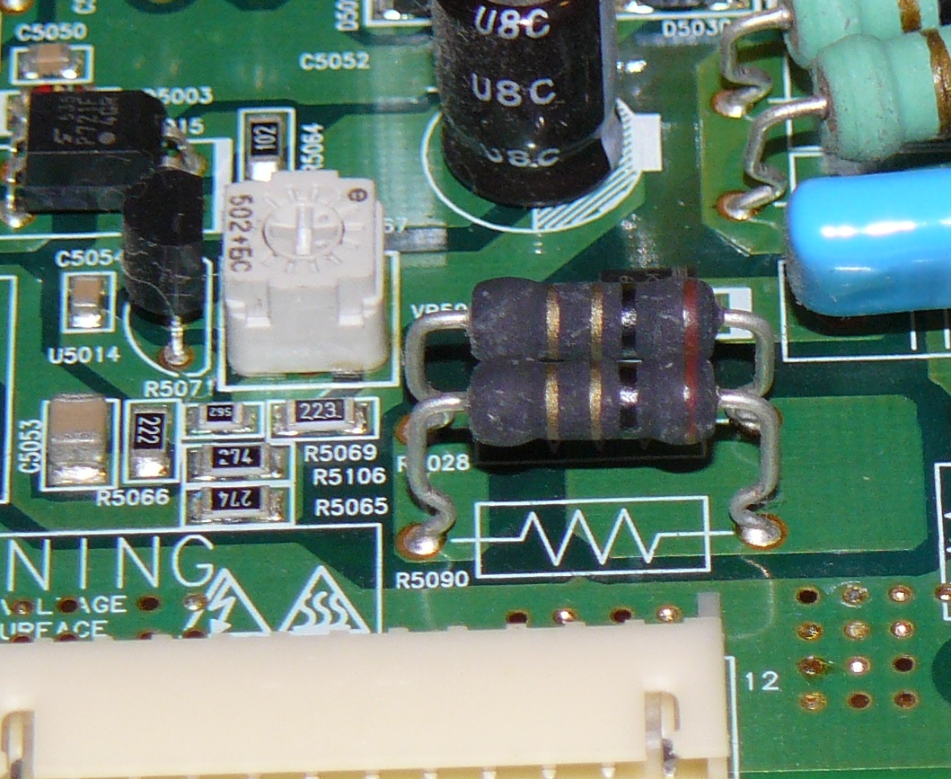

    I have a magnavox 42mf231d 37 that would need to be smacked on the right side (facing TV) for a year - 1/2 or whole screen would go black - sound ok. Now something burnt & no picture just sound. On the board (Y main PBA CODE: LJ92-01200A) I found a bad looking cap (C5040 - swollen) and I think it smells & looks like R5090 & R5028 are fried - I am having trouble figuring out the colors on these fried resistors (red, black, ?? burned -looks like gold, gold - several of these at other places in board) - anyone know what the correct resistors are for these two resistors. If red black gold gold - 2 Ohm 5% ?wattage?voltage
    Any help would be greatly appreciated.

    Could you include a pic and that would better help me find your info.

      Red, Black, Gold, Gold is correct. Here is a picture of a LJ92-01200A that i had in the basement.

        They are a funny colour, they may be fusible and\or flameproof resistors. If that is the case you should use proper replacements for safety.
        In any case, if you can find the service manual it will tell you the power rating of the resistors and if they are a special type or not.

              MOX (Metal Oxide). I tell the Wattage from the picture, you will have to take the dimension and match the size:
              Here is 2 Ohms MOX:
