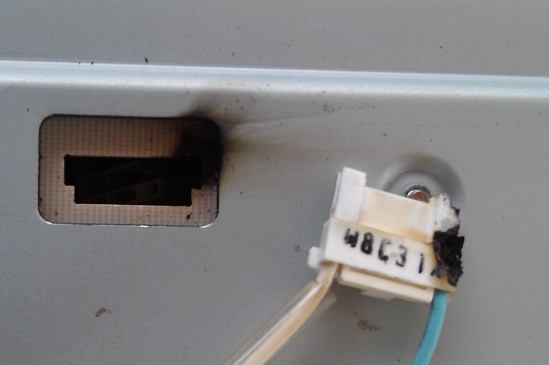

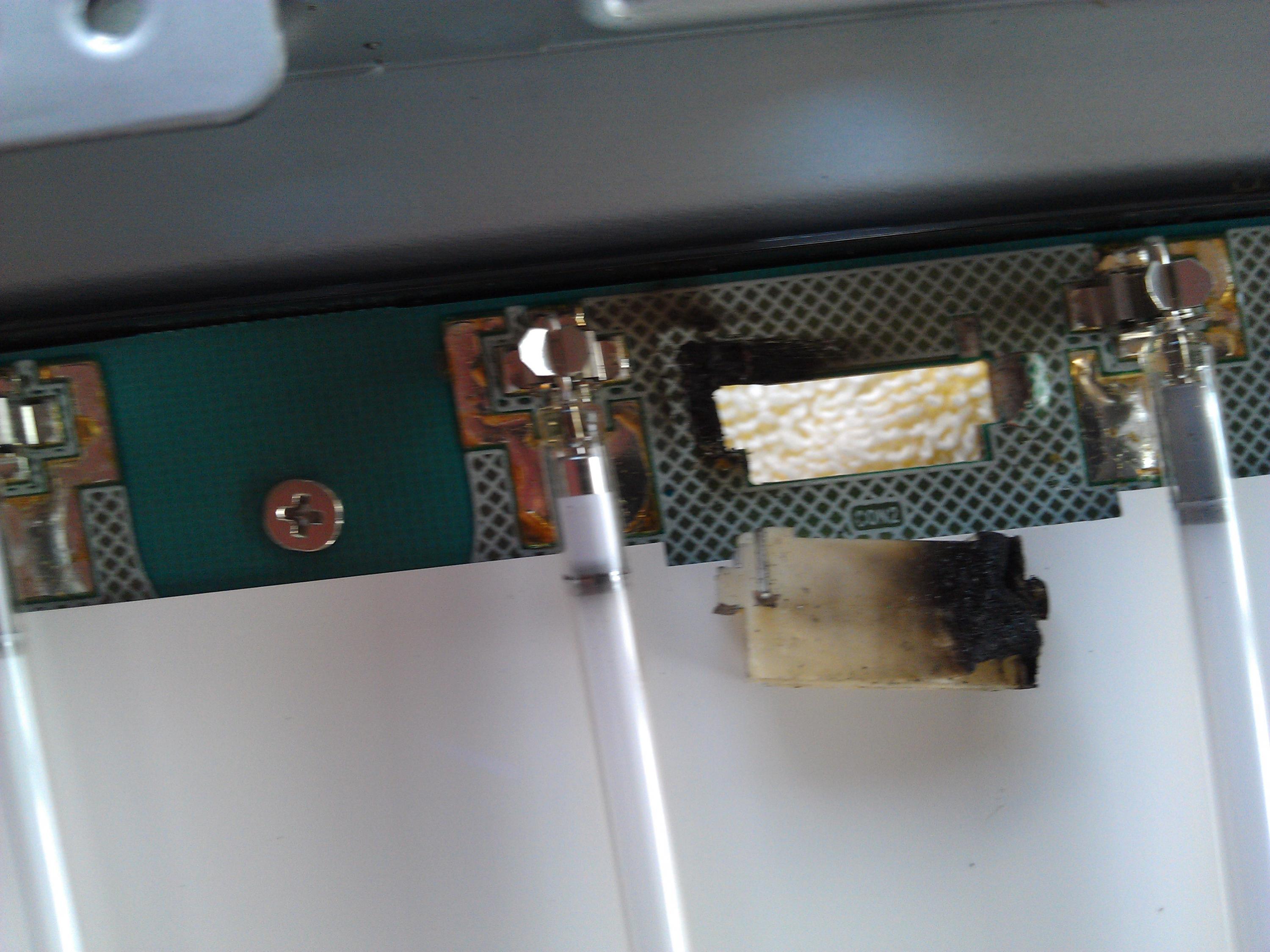

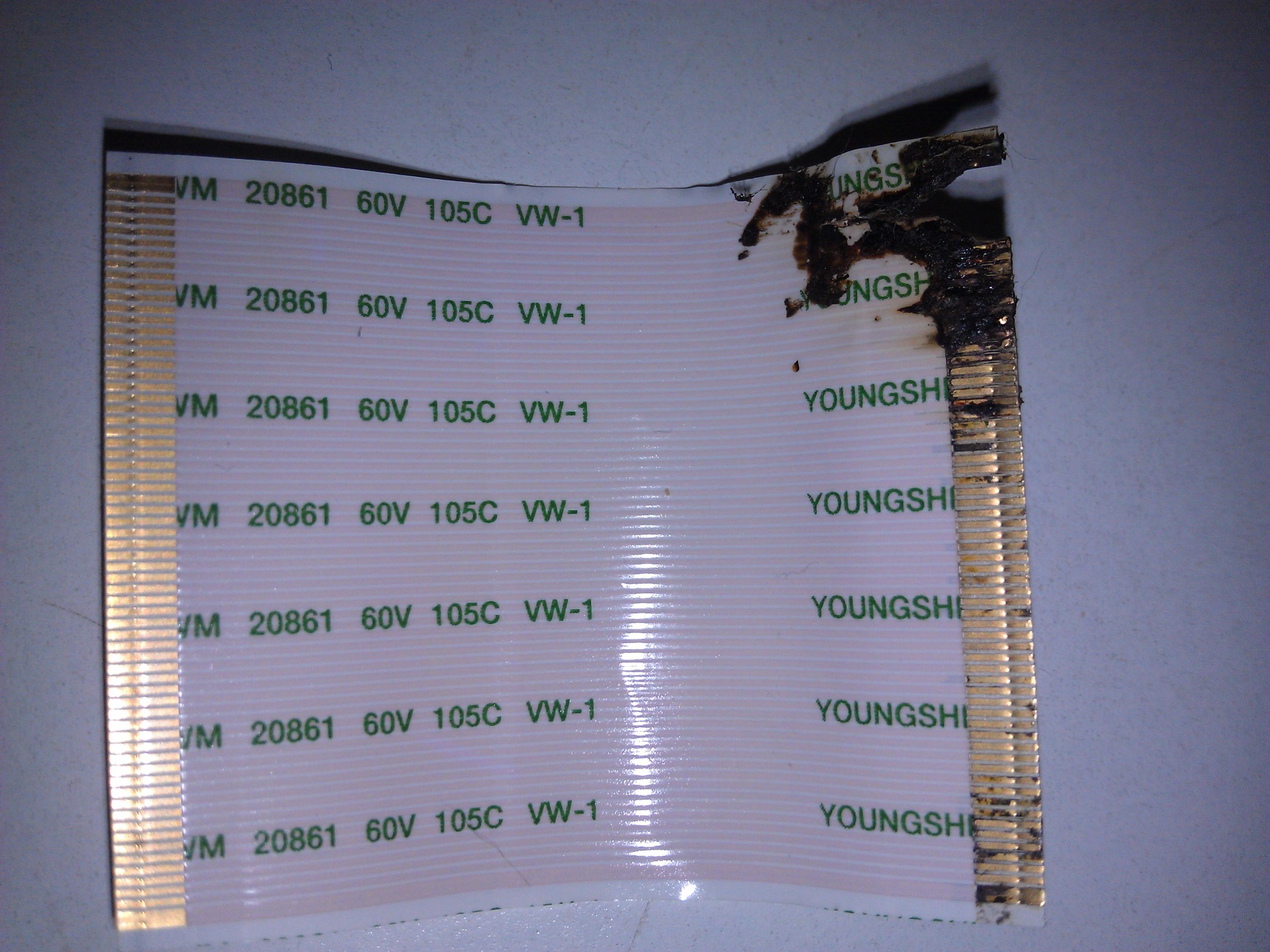

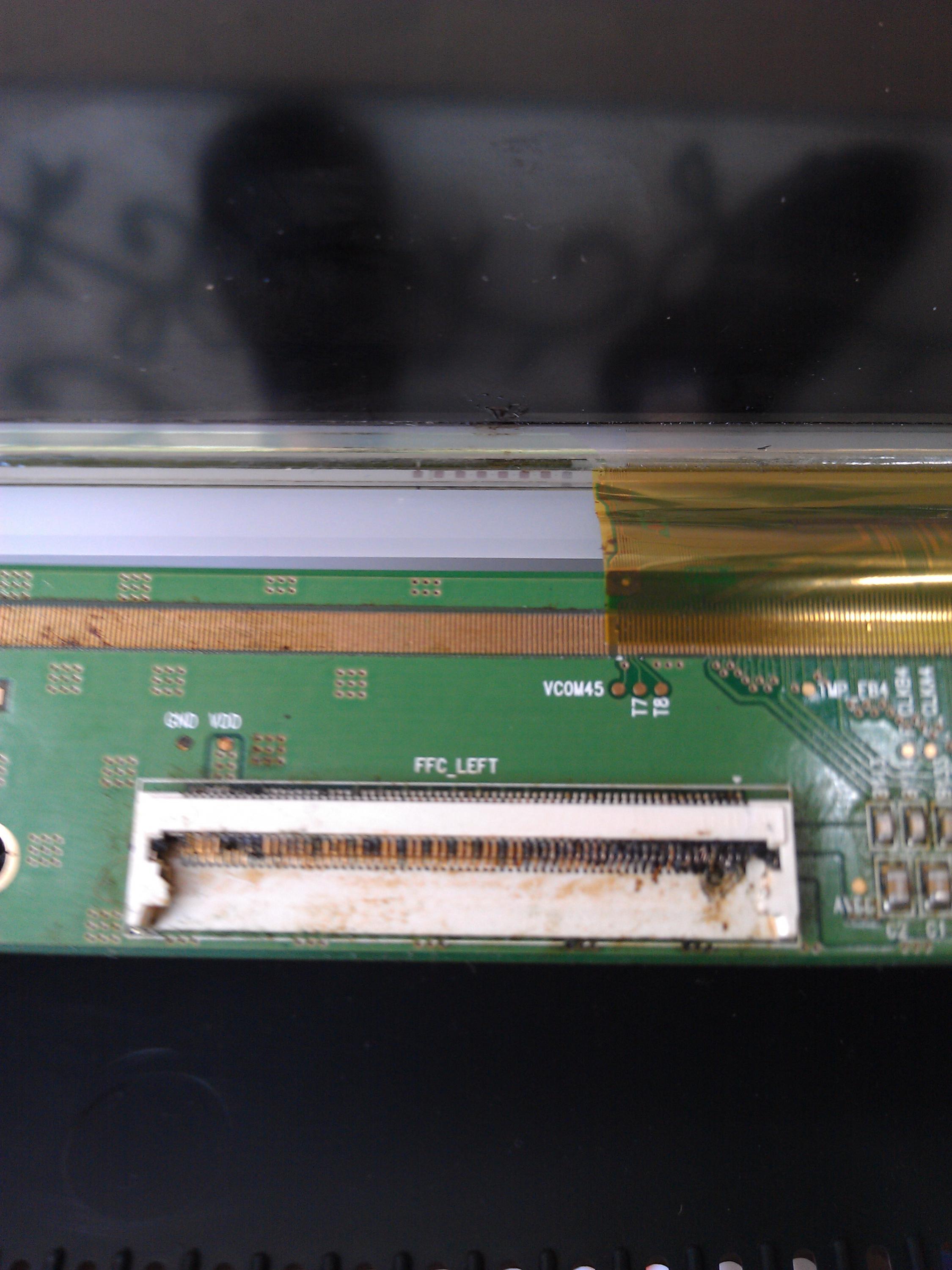

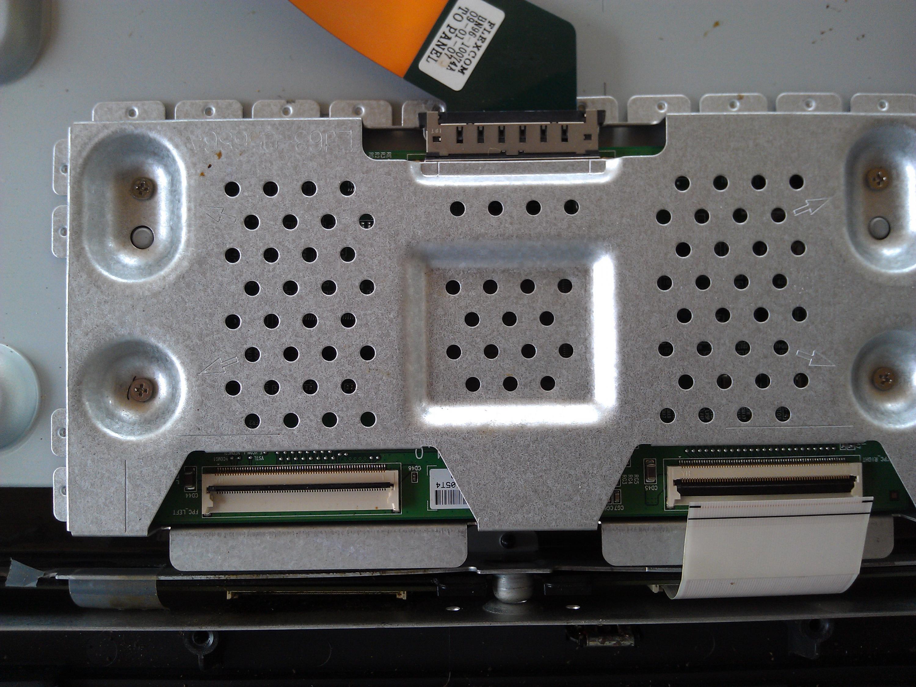

    Hey All, just yesterday I turned on my TV and smoke , sound and a quick dash to unplug it. Took it apart and found the Rt side inverter connector and board burned up, but this was the part I was stumped with. The FFC from tcon to the display connector had some type of black grease on it and I noticed that the black latch was missing. Now I brought this thing used a while back and had no problem until now. Has anyone ever seen this happen all at once ? I have only taken it apart and have not checked anything else because the FPC connector is hard to find. Seems molex made it and now it is in mass production and this exact one is not available unless you take one off another board .
    Re: Samsung 52 LN52B550K1F FIRE!!!
    It looks like it may have got some moisture inside the TV. The high voltage connector may have started with small carbon track first due to moisture or contamination and finally got worst so the high voltage just arch over to the lowest resistance path. You will have make sure to remove any carbon deposit otherwise it will arch over again.
      Yeah I did have some white corrosion specs along frame rail on that side of connector, may have gotten wet before I purchased it. Still gonna try to fix it just to see what happens.

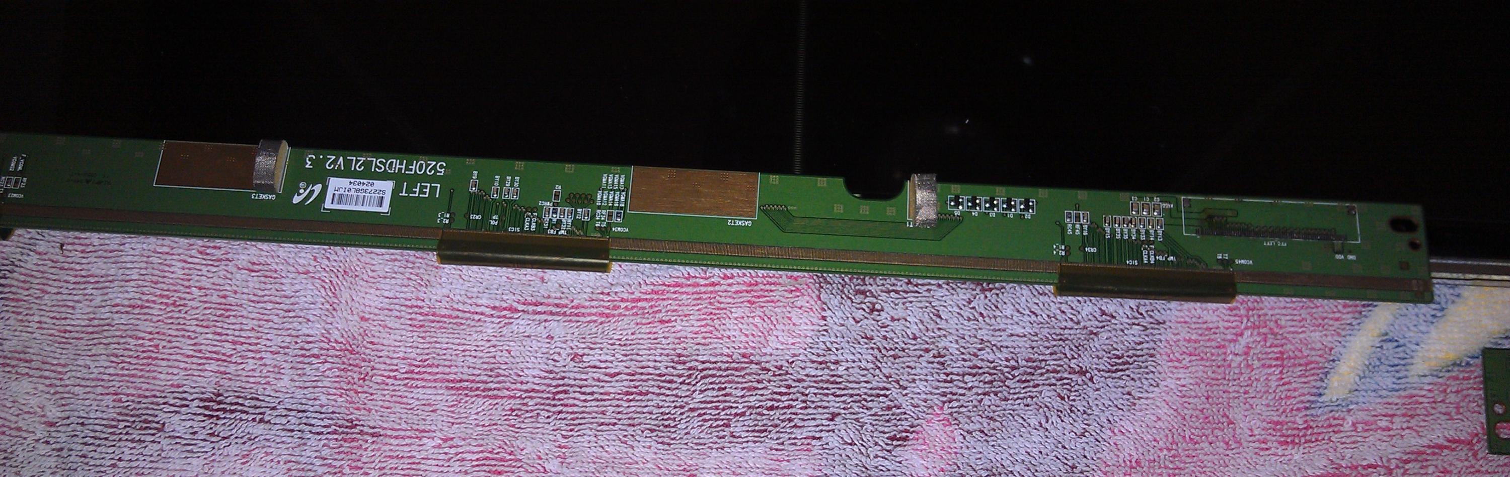

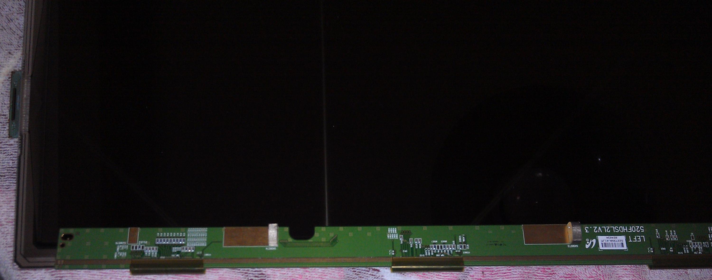

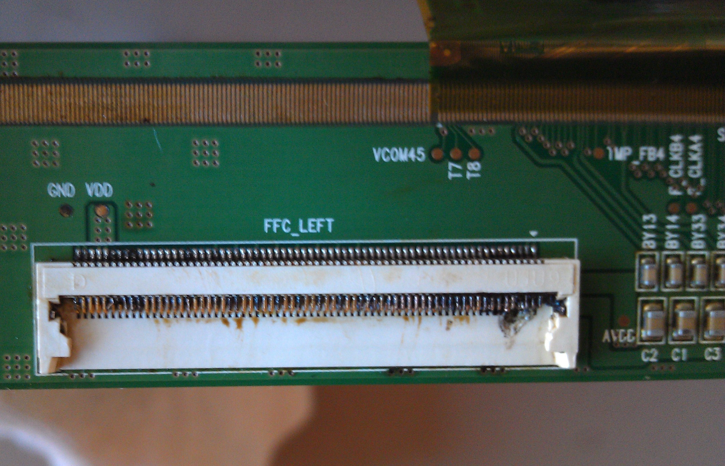

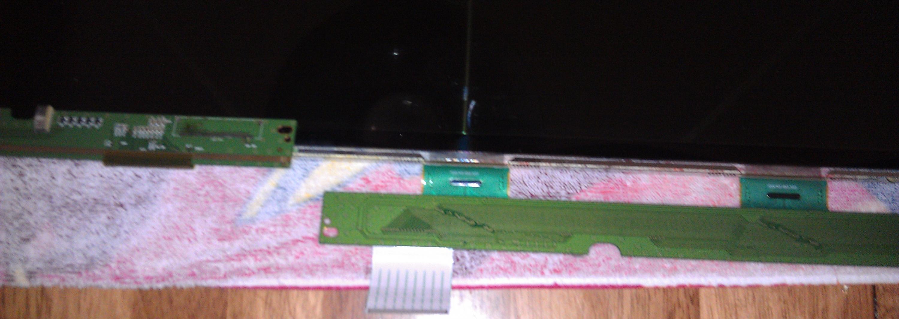

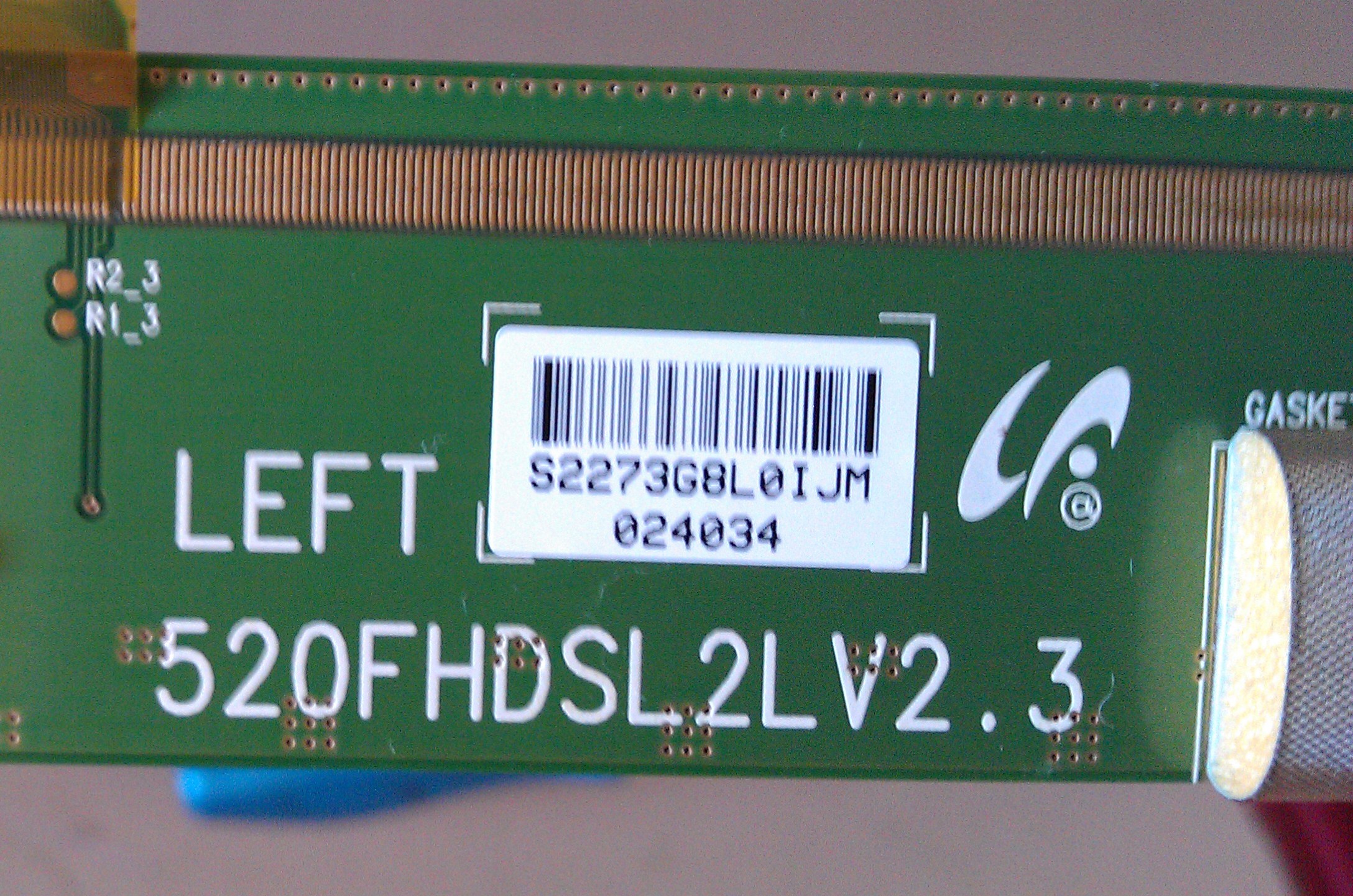

        So I removed the connector off the board(first pic), but took out 8 of the pad traces with it. so here is what I got in the pics. Does any one know if this board is replaceable ?
          It's the panel driver board... no, it's not replaceable. You may be able to replace the FFC connector on it.
            I found a connector that will work I just took out 8 of the solder pads when removing it. The traces look so small I don't know if it can be fixed.
              It looks like a multilayer board, you may have a lot of difficulty attaching it.
