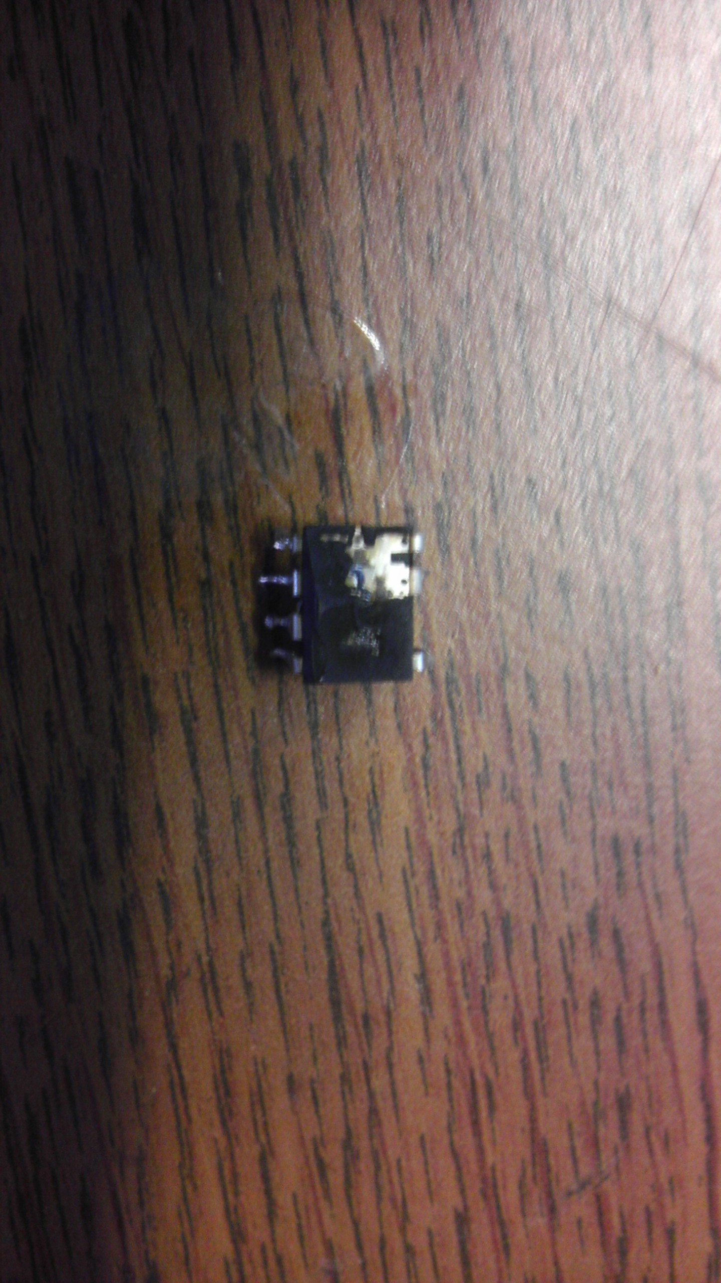

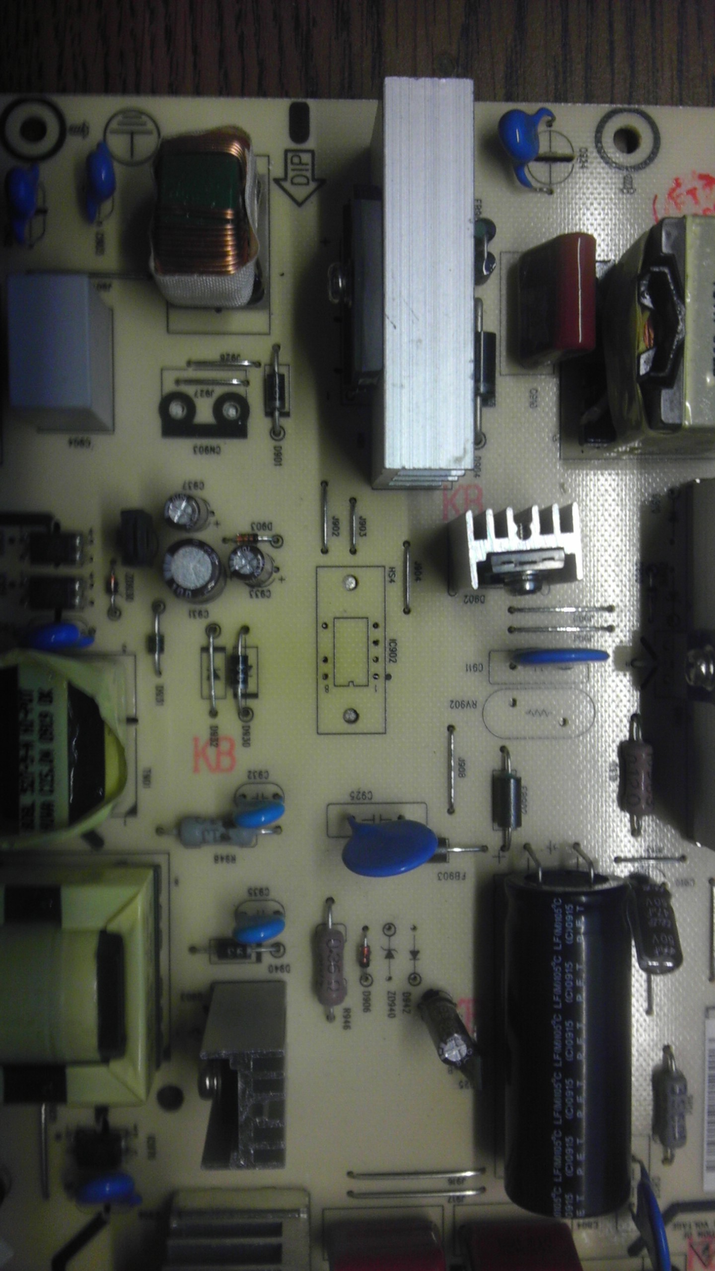

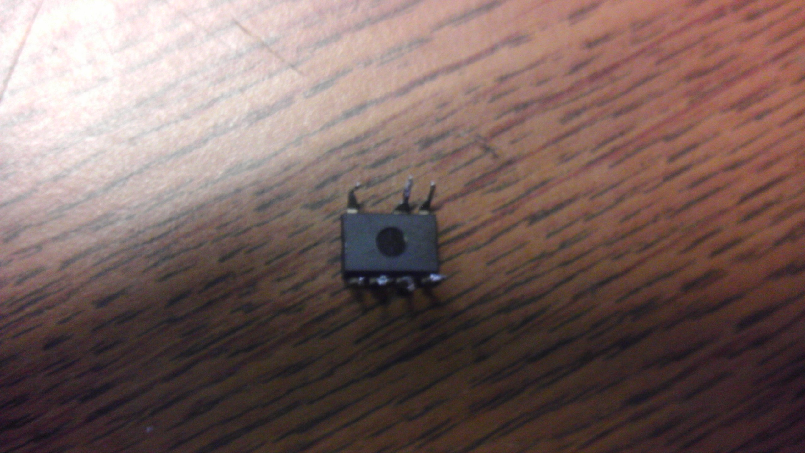

I have a power supply out of an Insignia ns-l32q-10a television set. I found a bad voltage regulator but unfortunately it is fried so I cannot get the part number off of it. I searched the internet and couldn't find any schematics or service manuals for this set. Any help would be greatly appreciated. The bad chip is at IC902 on the board. Attached is a picture. Thanks again in advance.
Insignia NS-L32Q-10A Need a part number for chip on power supply please

I have a pwr supply board that looks like yours. Number on the board is
715g3332-1.
IC 902 on mine is A6069H
SK982
13AP -
Re: Insignia NS-L32Q-10A Need a part number for chip on power supply please
Sounds like a Sanken STR-A6069H with the PWM controller and switching transistor intergrated into one chip. Also missing pin 6 as in the photo.Comment
Yup that's the part!! Thank you
