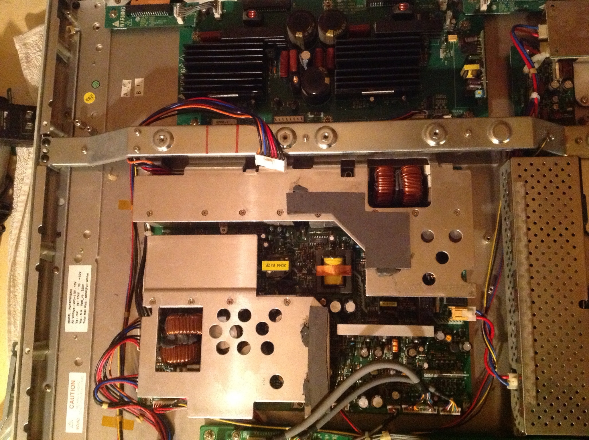

    Hi guys here's an update on what's going on with my LG plasma TV.
    I tried to resolder new ipms on my original y sustain board. however I still had a short on this particular board; Vs to ground short. I had a hard time finding where that short was coming from. So I decided to order a new y sustain board.
    I received it today. I Connected the board but I still have to same problem. I only get voltage out of the power supply board when the p2 connector on the y sus is unplugged see picture. So I tested this new board but But there is no short at all.
    So I guess the problem is not coming from my y sustain board. I also tried to disconnect the buffer boards from the y sus But it makes no difference. I'm really at loss here. Can something else have an influence? I'm starting to wonder if there is a problem with the control boards. There is this small connector P1 which I didn't try to disconnect him but I'm afraid that this might cause further problems. Any help would be greatly appreciated.
    Power board and z sus:

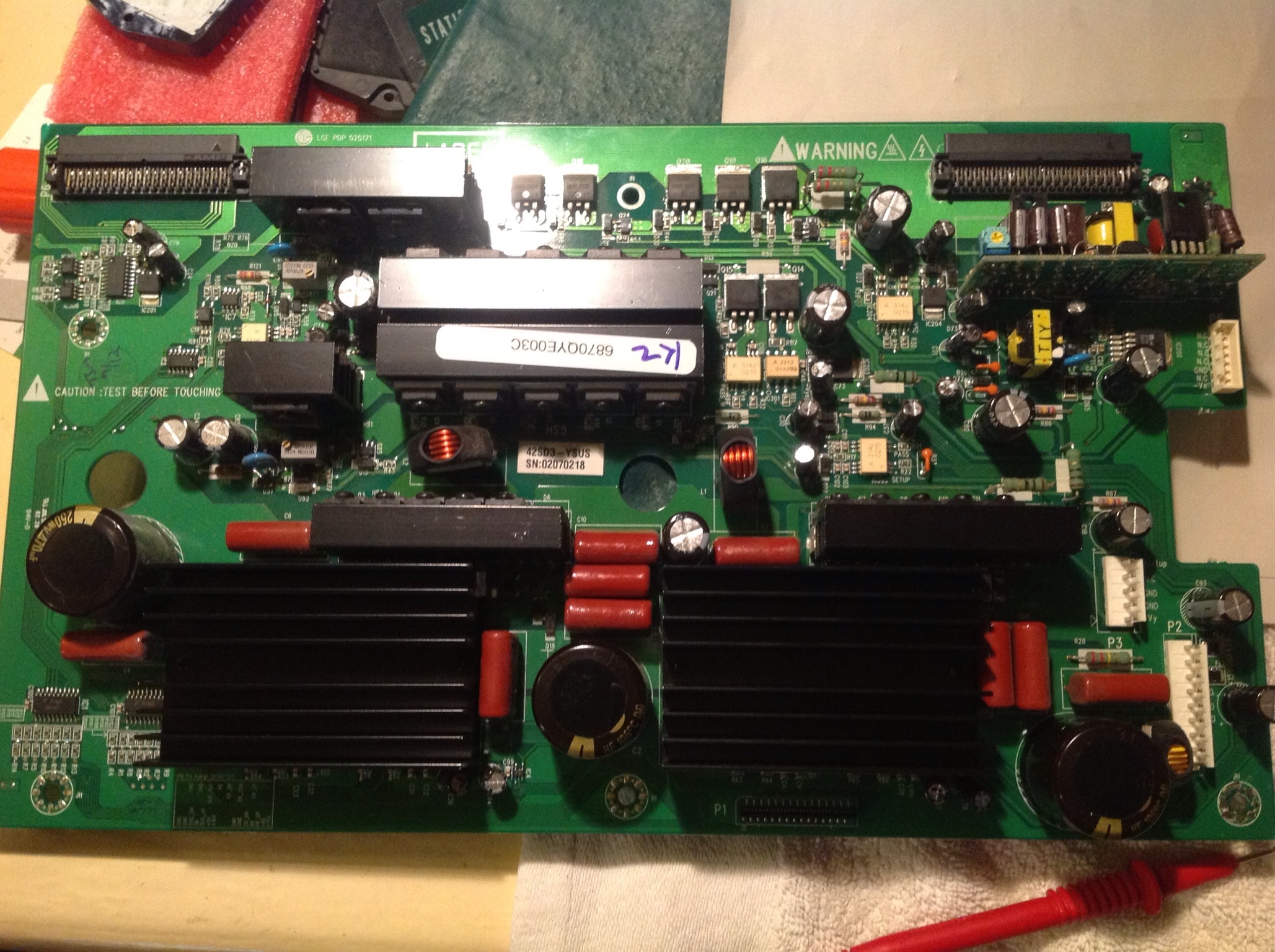

      Re: Lg plasma tv no video has sound
      New y sustain board

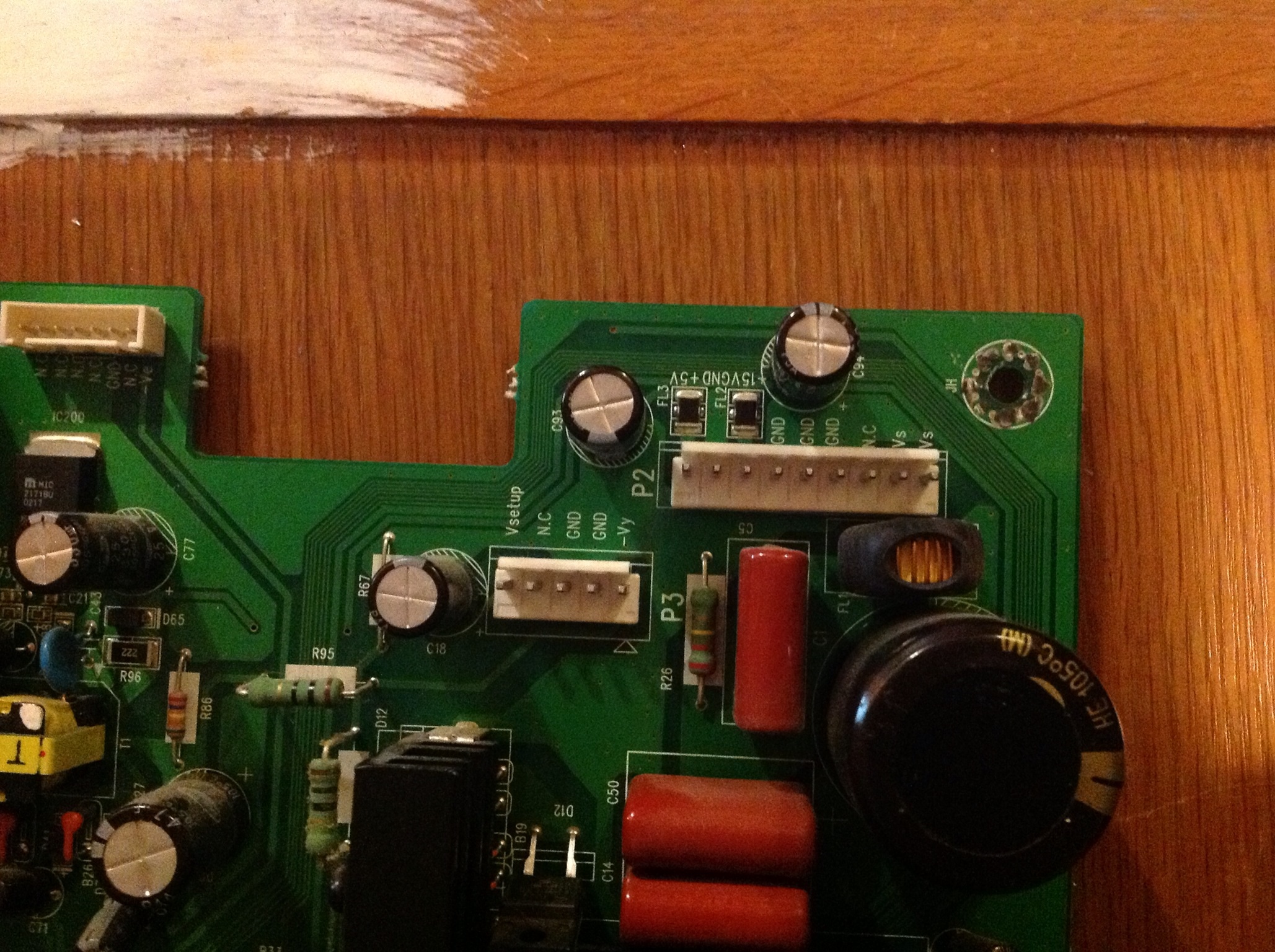

        P2 the one that needs to be disconnected in order to get dc voltage out of the PS.

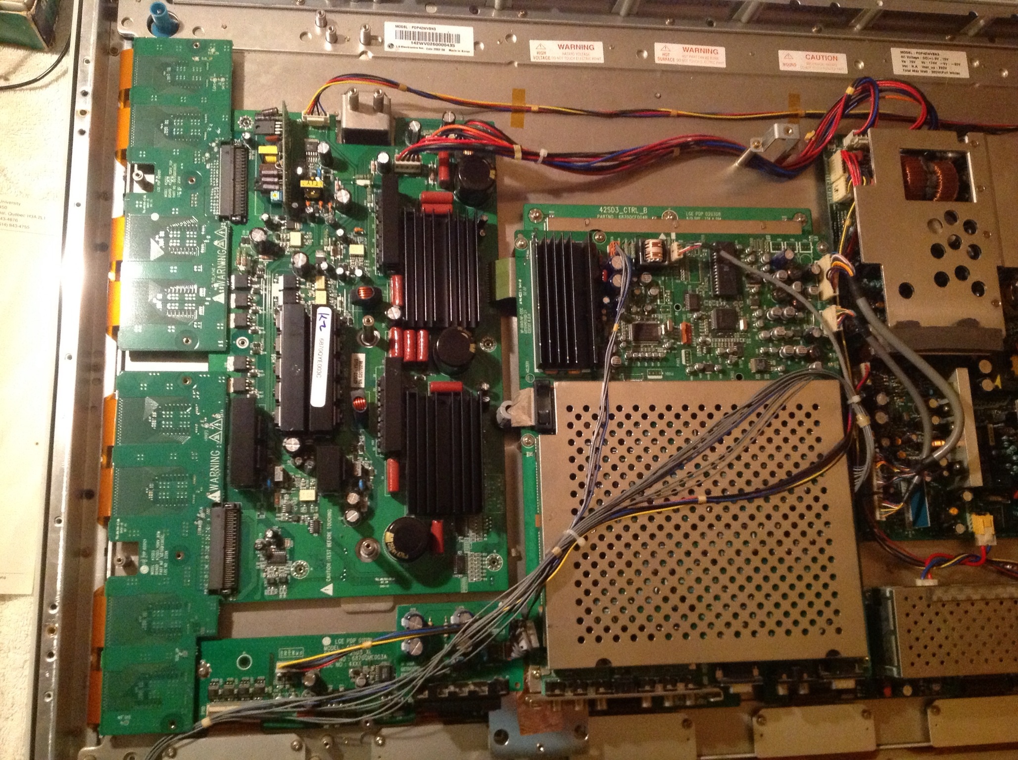

          Buffer, y and control boards.
