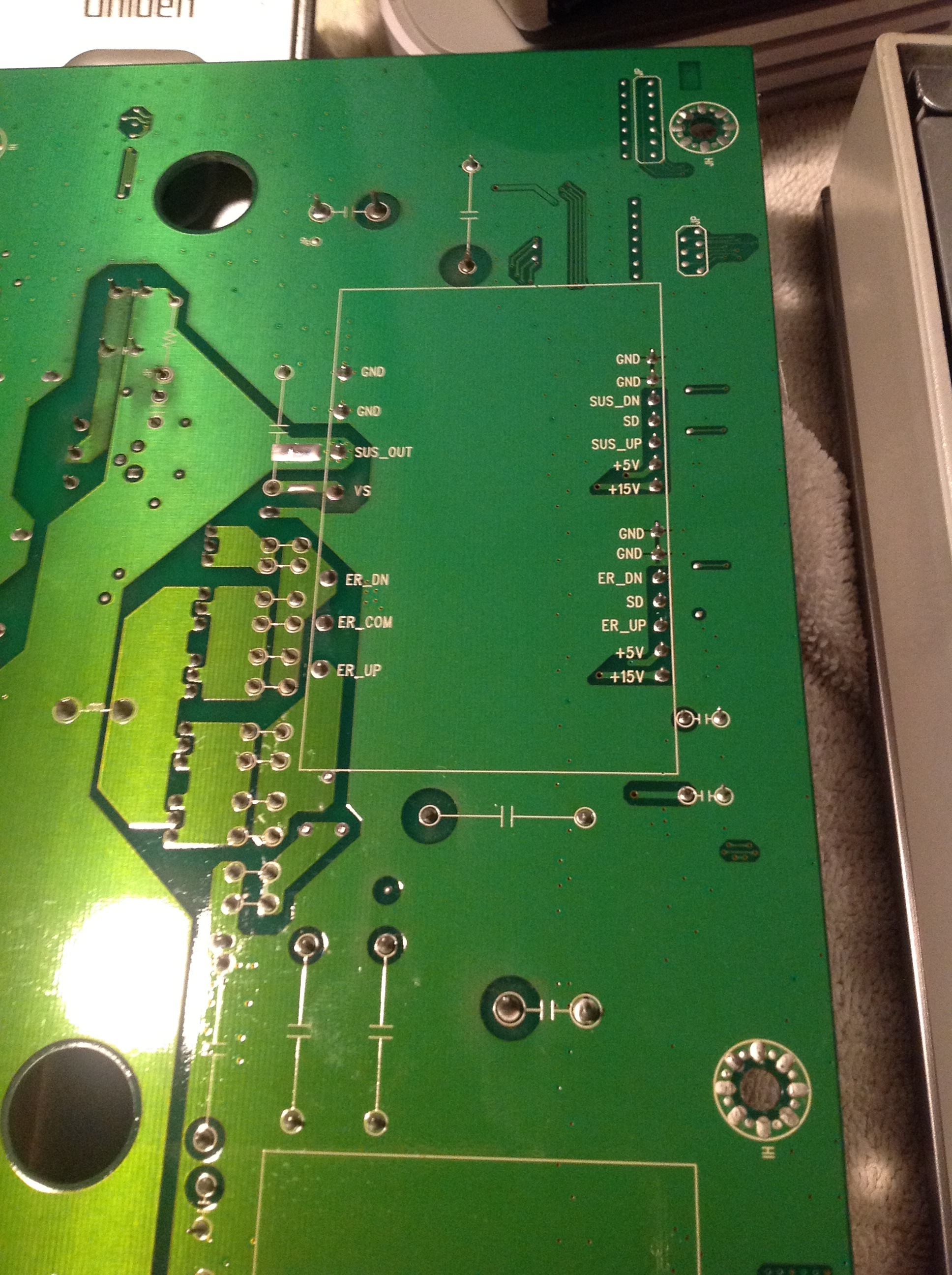

            Re: Lg plasma tv no video has sound
            Yes, post a picture of the rear underside of the Y-sustain, as the pins are labelled.
            • anthonyngan
              • Aug 2012
              • 23
              Here is the picture.
                OK, test from SUS_OUT to GND and Vs, then from Vs to GND.
                All should read open on 200 ohm range.
                  Is it possible to have no resistance at all between all pairs?
                  Do I have to unsolder the ipms to test them?
                        Alright!
                        I removed the ipms and found them to be shorted.
                        I found this site:http://www.pwrx.com/summary/IPM.aspx
                        However I'm having a hard time identifying the correct module. Can somebody help?
