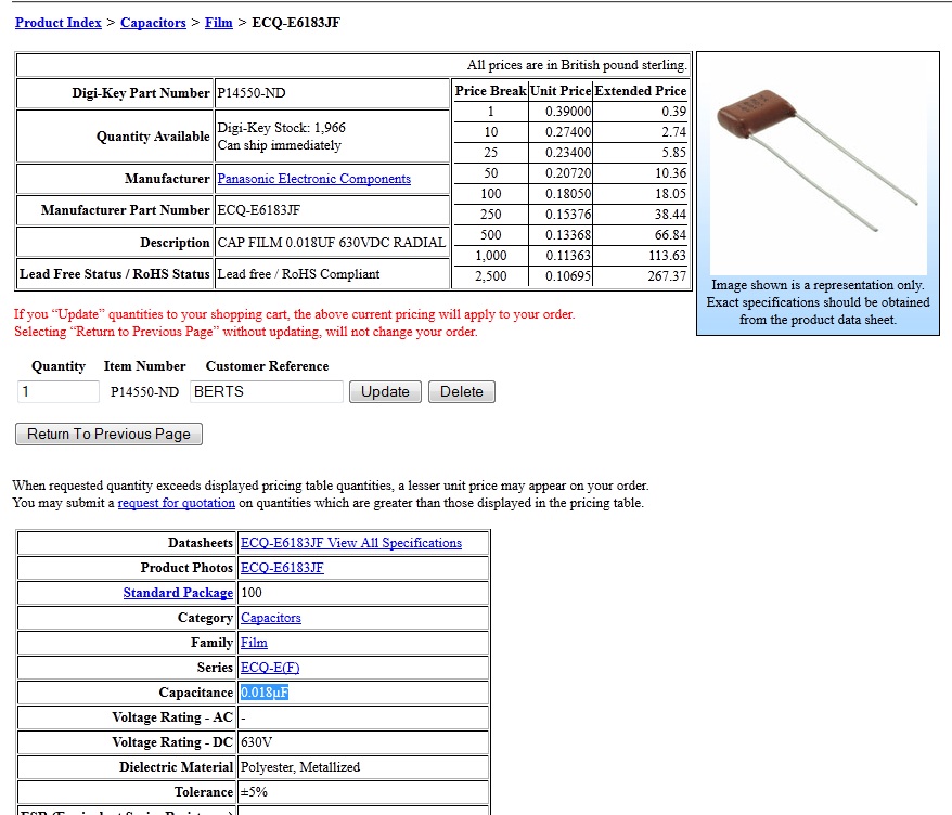

16mm leg spacing. I know the Digikey one is 10mm but I can make that fit if I leave the legs long. I am tempted to just buy it, but £12 postage for a 30p part OUCH!!
Ok - need to get our posts back in sync
What is the distance between your caps legs. I cant find an 18nf cap but there are 15nf and 22nf - the example I posted IS 630vDC but they also quote the ac voltage.
Ok here are 3 that I think will do if Tom can confirm 22nf is ok
One is 1000v but you have to buy 5
the other two are 630v - looks like you can buy 1.
If they are ok I can help if delivery is exhorbitant or min order applies.
Thanks Selldoor, I have read on the forum that someone used a 1000v without any problem. But I will wait for Tom to confirm before ordering. I don't mind buying 5.
I cannot confirm either way as I'm not certain on what decisions the manufacturer made in designing it. You could place a 10nF and 8.2nF in parallel. Th3_un1qu3 is the best to ask about this as he is well versed on SMPS design.
That cap right there looks like it is part of the snubber circuit on the transformer primary. It is fairly critical because if the cap is too small, then there is a risk of spikes killing the primary transistor, if it is too large, it'll cause excessive dissipation in the snubber resistor in series with it - RW801 i think it reads on your board. Since that cap is blown, are you sure the mosfet is good?
In this case, i would go with 15n as it is slightly closer to the original value. Edit: You've posted before me. Since you ordered the 22n, i would also beef up the power rating of the resistor in series with it. That looks like a 2W or 3W there, see if you can fit a 5W somehow.
For one I am not 100% sure the cap is bad but it is the only one with signs of damage and it seems a common problem with these boards. I have just ordered a Cap meter to allow me to test future caps but at the moment I have no way of knowing.
How would I test the mosfet?
Is the 22n a definate no-go as I have just ordered it?
Erm... wait. You said the set does turn on, just that it gets no picture or backlights. That means the mosfet is good, if it were blown you would simply get no power.
No. It will simply cause higher power dissipation in the snubber resistor i've mentioned earlier, which may, or may not be trouble. Do you have a temperature probe on your multimeter? Btw, check that resistor as well, it could have increased in value or failed open.
With the capacitor blown, the spikes caused by the leakage of the transformer make their way to the secondary side, which could cause some of the circuitry on the main board to shut down to protect itself, hence no picture. Same thing if the resistor has failed - so be sure to check that too - measure it with your multimeter on the 200k or 2000k range (can't see all color bands from the picture, but it's likely to be in the 100s of Ks), and compare with its color code. Replace if the measured value is more than 5% higher than what it should be.
