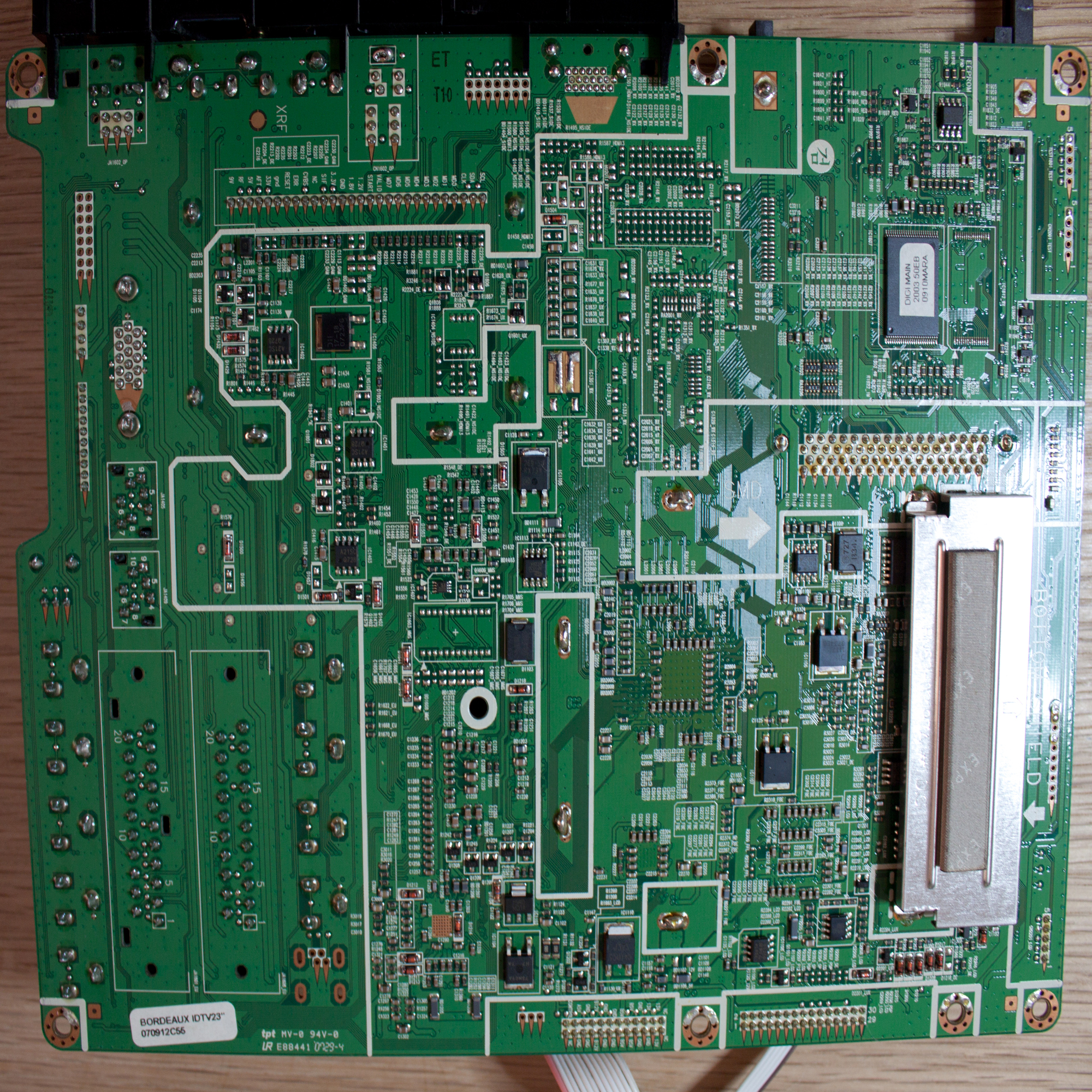

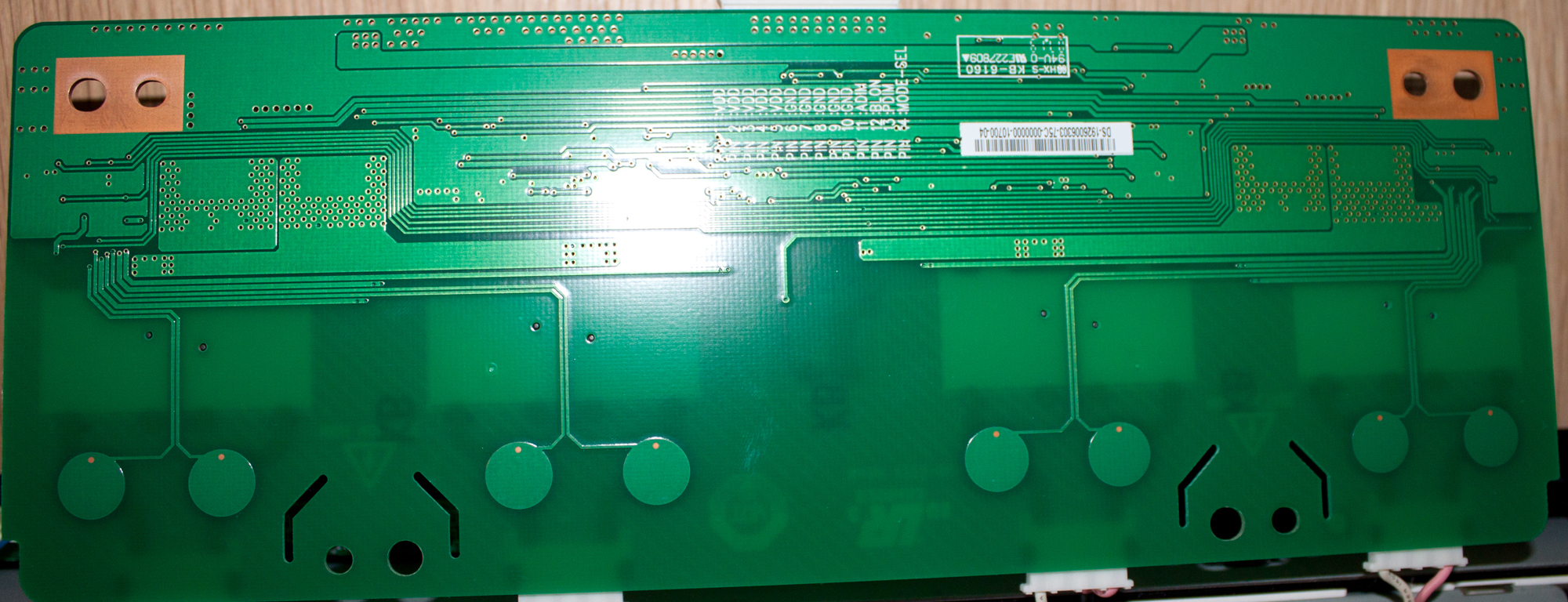

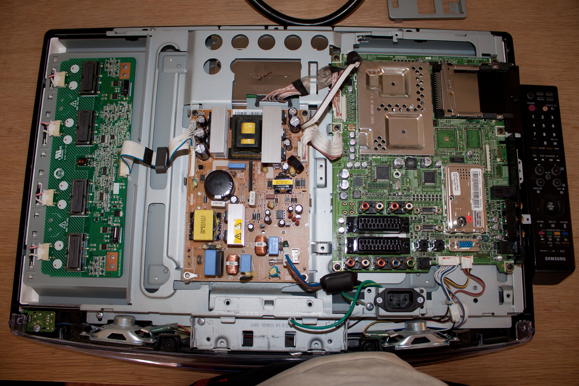

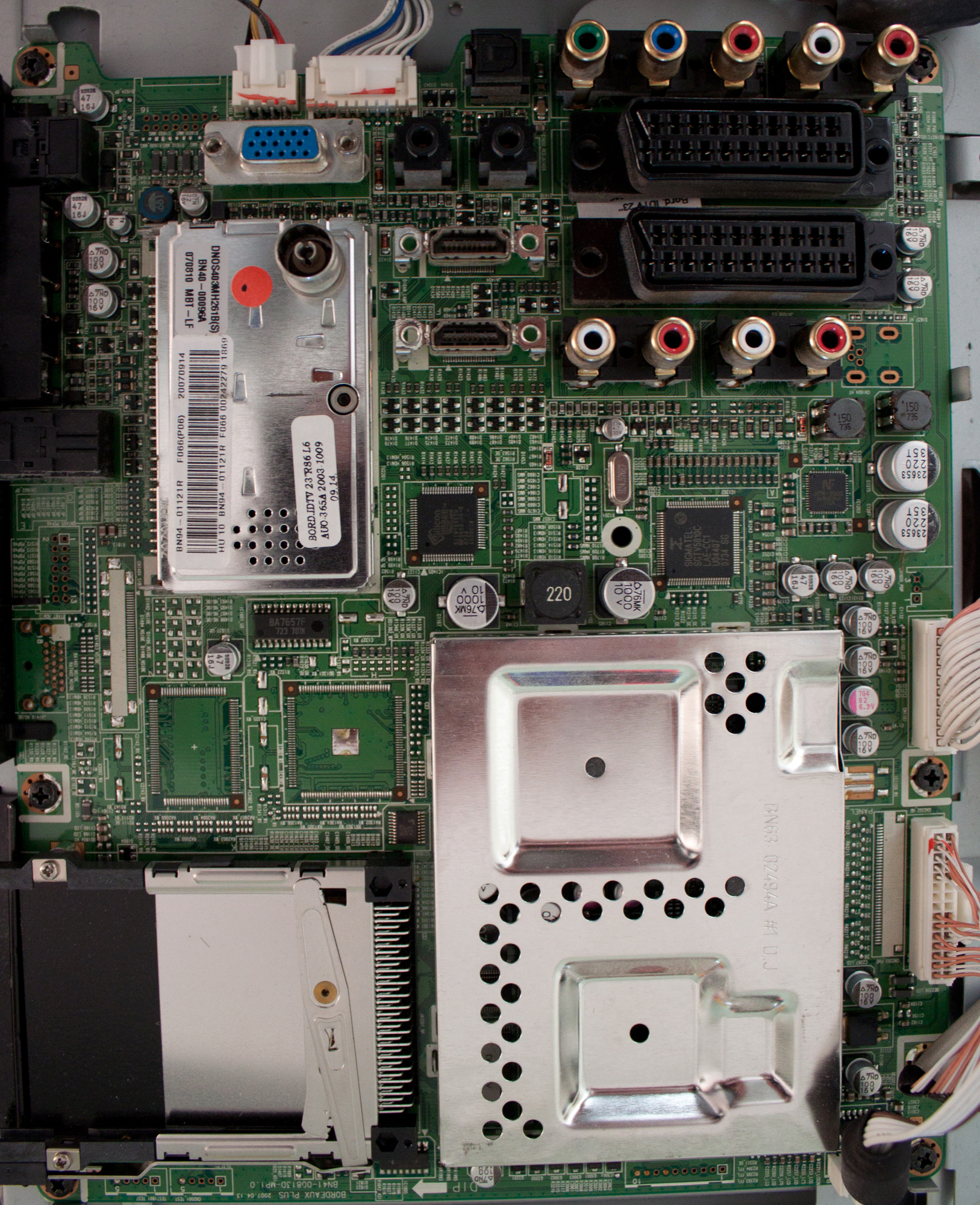

                  Seem to be working blind here - can you post some pictures?
                  please post good clear pictures of the whole chassis, and then pictures of each board, front and back and close up of connectors, (max resolution 2000x2000 and 2MB) using the manage attachments button, which is found by clicking "go advanced" under quick reply.

                    Re: Samsung le23r88bd (r)

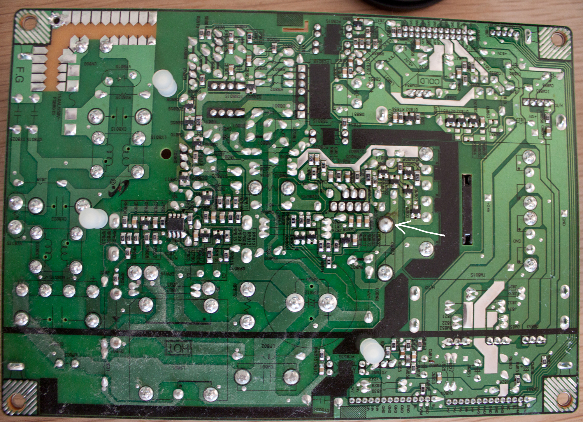

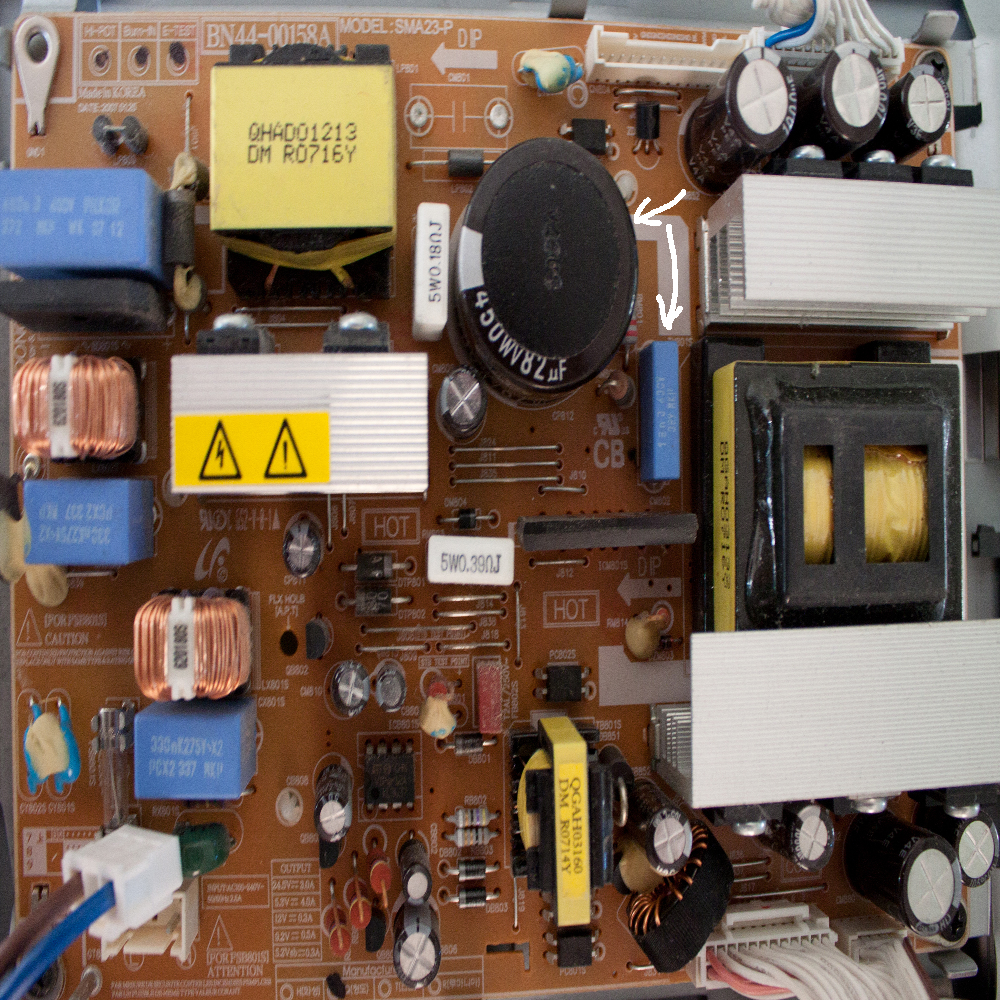

                    Hey, thanks for helping. Photos are attached, The large Cap on the power board looks a bit swollen, but I don't know if that is what they normally look like?
                    Also the Blue rectangular component on the power board has slight burn marks on the back, looks like it may have been repaired?

                        Here you go....
                          I have drawn a white arrow on the power board to the components that look suspect to me. Thanks again for any help.
                            Sometimes the Big Cap plastic lid looks a bit rounded if that is what you mean? we could tell better with a side view. The blue box is a capacitor but dont often fail.

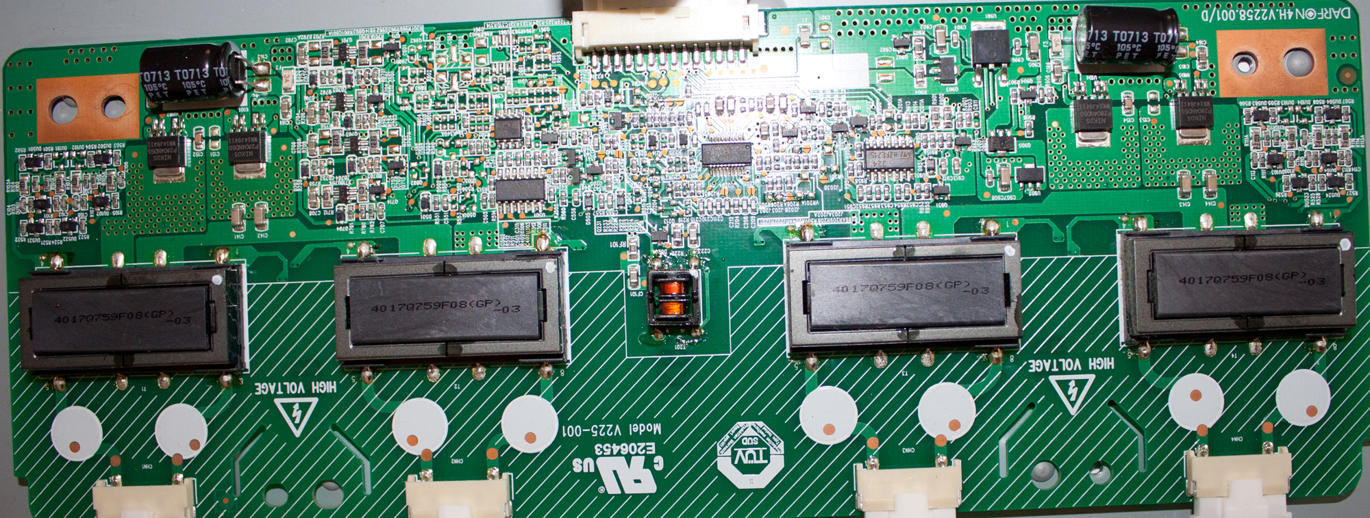

                            On the inverter board - pic 5 there are 3 fuses (at least) can you check them using ohms 20 on your meter post results like Inv Bd F1 x ohms and so on.
                            Have you checked the red fuse on the power supply

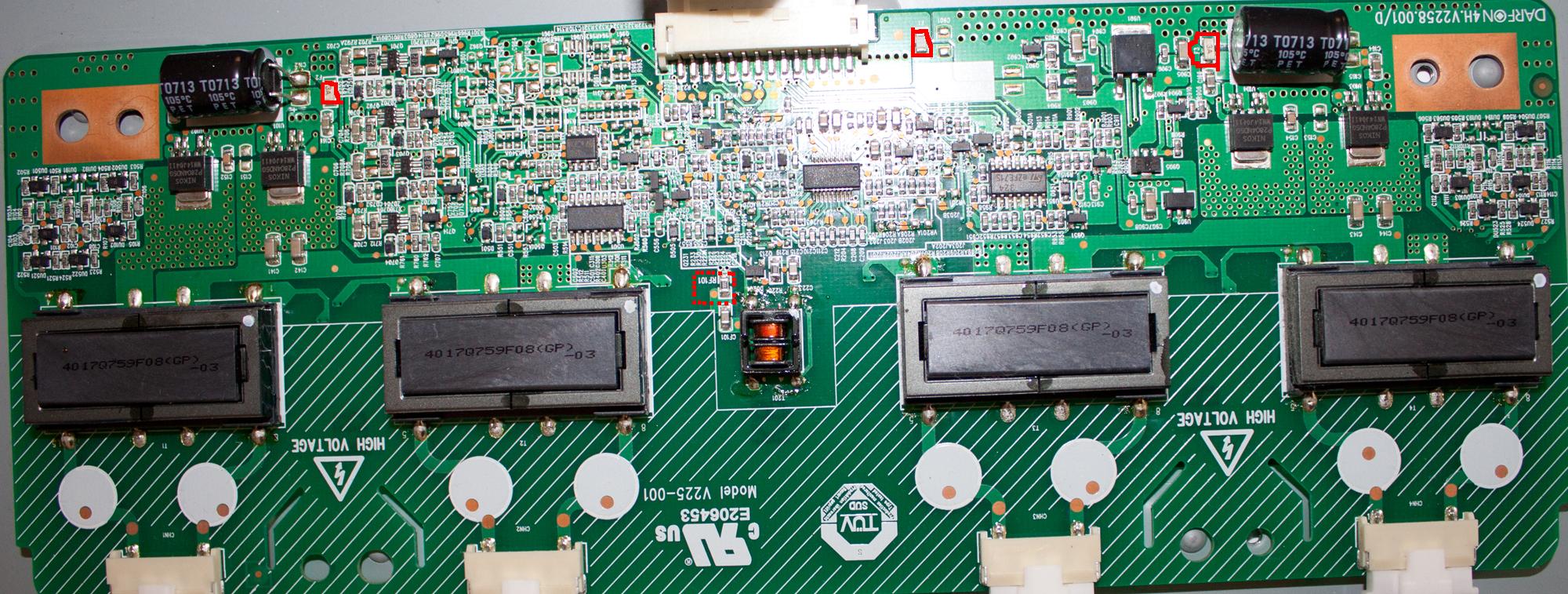

                              Hi would it be too much trouble to ask you to point out the location of the fuses you suggest that I should test? thanks and sorry to be a pain, am quite new to TV's
                                Tcon attached- there may be more cant see for flash and item in dots
                                not sure what that is but just test for continuity.

                                    Hi, all the fuses are good. The more I look into this the more I believe that it is a bad Cap on the power board. I have read another thread and a guy with exactly the same problem replaced the big blue cap and had success this would also concur with the heat damage to the board which is on one of the legs of that Cap.
