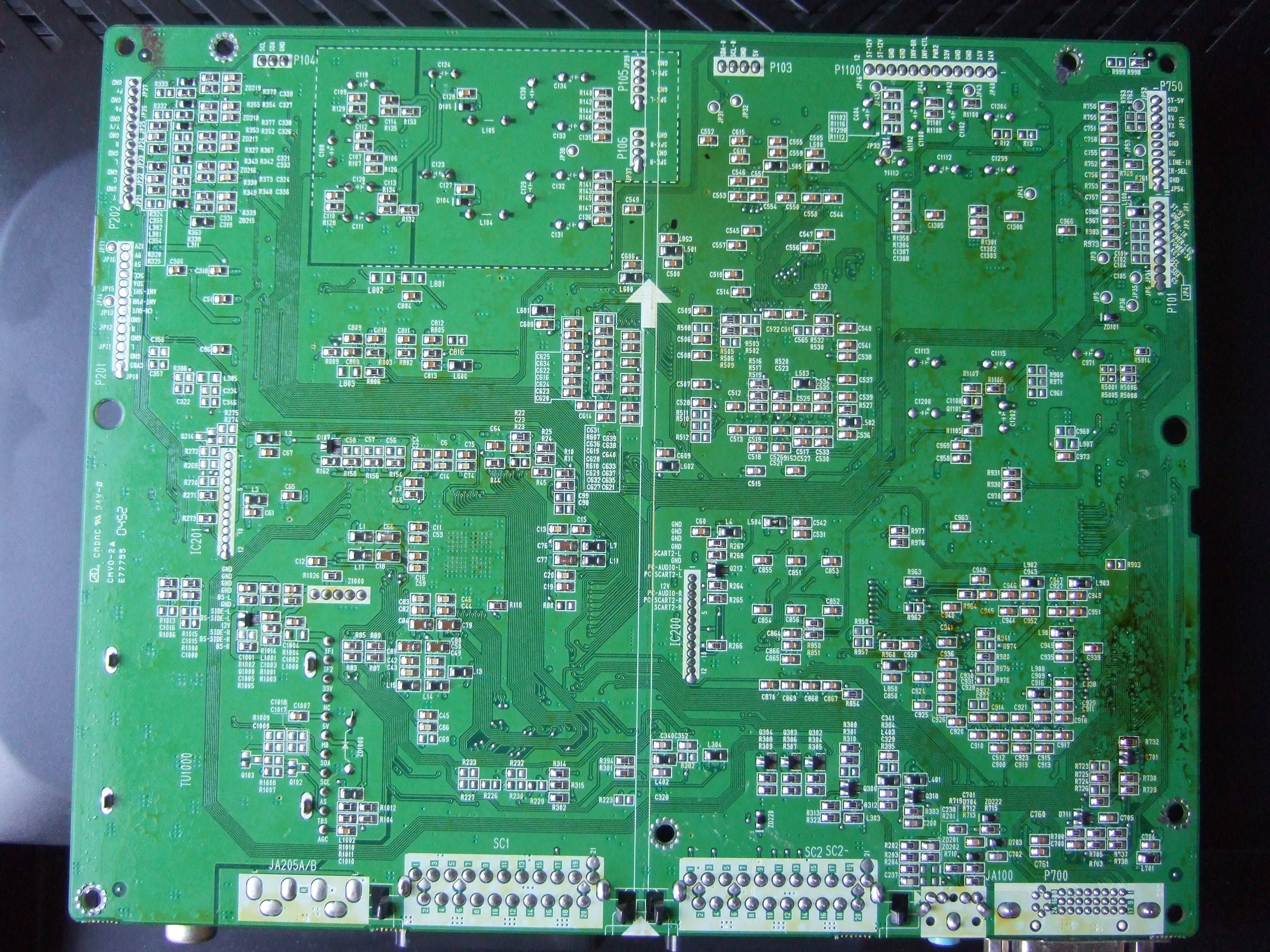

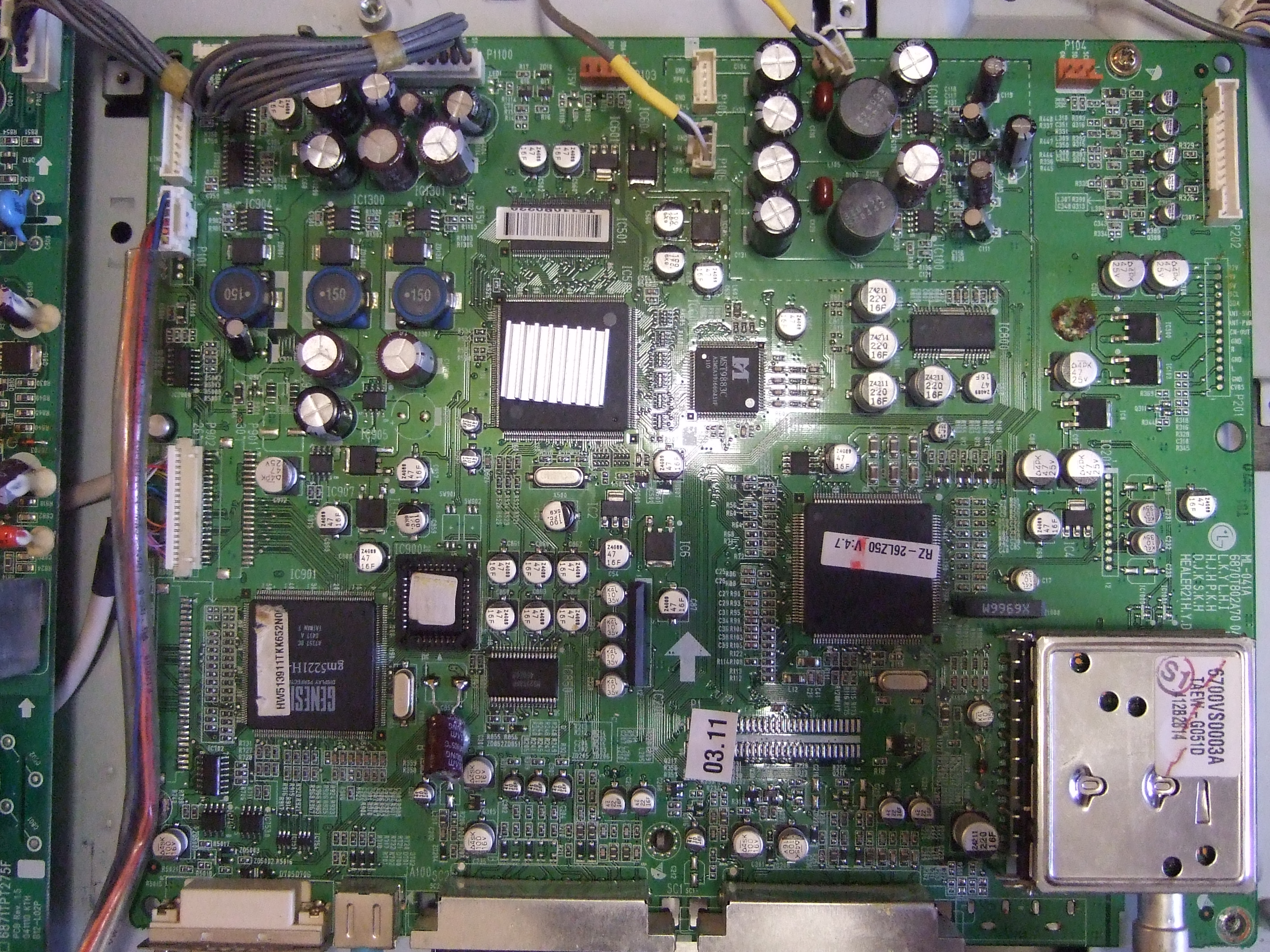

            Ok not sure why you would replace 47uf caps with 100uf
            one step up to 68 might be acceptable but double??
            Pictures are not really sharp enough for troubleshooting.
            I am a bit concerned by the browning all over the Main/AV board, particularly in the area on the back of the gmchip, has someone tried to reflow it? or do you know what has happened.
            Have you changed out the brown SamYoung cap near the big 5221 chip- Sam young are poor.
            Just above the 5221 chip in your pic there are IC 905 &906.
            Can you get the part numbers off them - are they voltage regulators?
            On the Tcon there is another U423 I think it says?

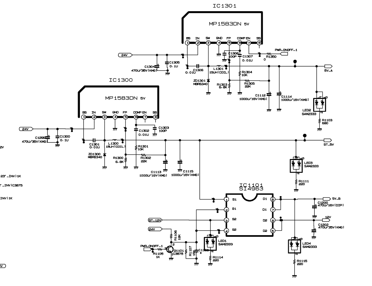

                HI,
                sorry fot the absence but i have been on vacations.
                i was able to find the problem but i dont know how to solve it.
                it appears the problem occurs on the output LC network of the MP1583DN (5v).
                I have a perfect square coming out the DC-Dc converter. But after the coil the 5v rail gains 400mv of oscilating noise.
                i have replaced the 2- 1000u 16v caps but no news.
                my next step would be to disconnect the 3,3v converter to see what happen.
                could some one please help me.
                thanks.
                  Re: lg rt26lz50
                  Replace the input 470u/35V cap too. Did you use low esr caps?

                    Re: lg rt26lz50
                    i have compared the ic1300 and 1301 outputs before the the coil and they appear the same. do you still advise me to replace this cap also?
                    the cap i used is a branded [M] (blue ones) probably that dont help much. I have aluminium versions but they are smd.
                      Re: lg rt26lz50
                      Possibly Panasonic caps. How did you measure ripple - with a scope?

                            Re: lg rt26lz50
                            finally i had time to replace the the 450uf on the input. but the problem persists. do you have any other alternative?
                            im wondering if the problem is not from the 5 to 3,3v dc-dc converters.
