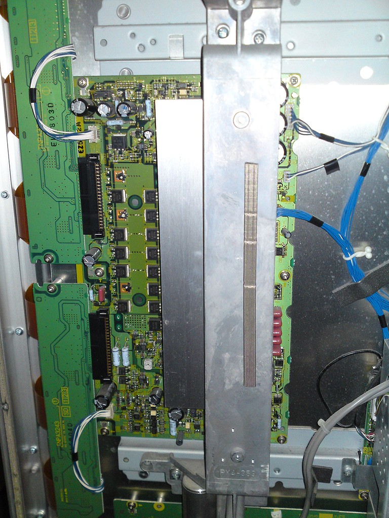

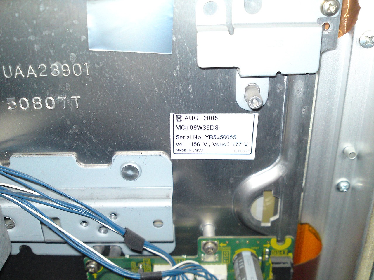

    What do you think?? What plasma module type is it, btw?

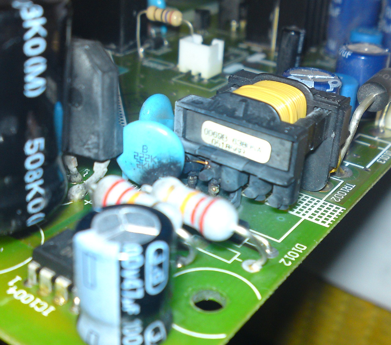

            I just found a possible problem. There is a serious burn in that corner. This blue cap C1023 looks quite busted. Take look at pics. See this two tiny wires on transformer?! Let's desolder it all out to take a closer look ;-)

              Yep, looks like the safety cap which should never short under normal conditions (CE requirement)... has shorted.

                Wow! Actually cap and diode are OK. They only got dirty when transformer TR1002 burned! These two tiny wires on the transformer primary are disintegrated. My doubt is, is it a cause for malfunction or consequence of some other malfunction on this PSU?!
                What shall I do now? What to put in the place of this transformer, how do I know it's specs??

                  Th3_uN1Qu3 has detailed the processes for rewinding transformers; you might want to contact him. However, I suspect the failure is due to a shorted MOSFET.
