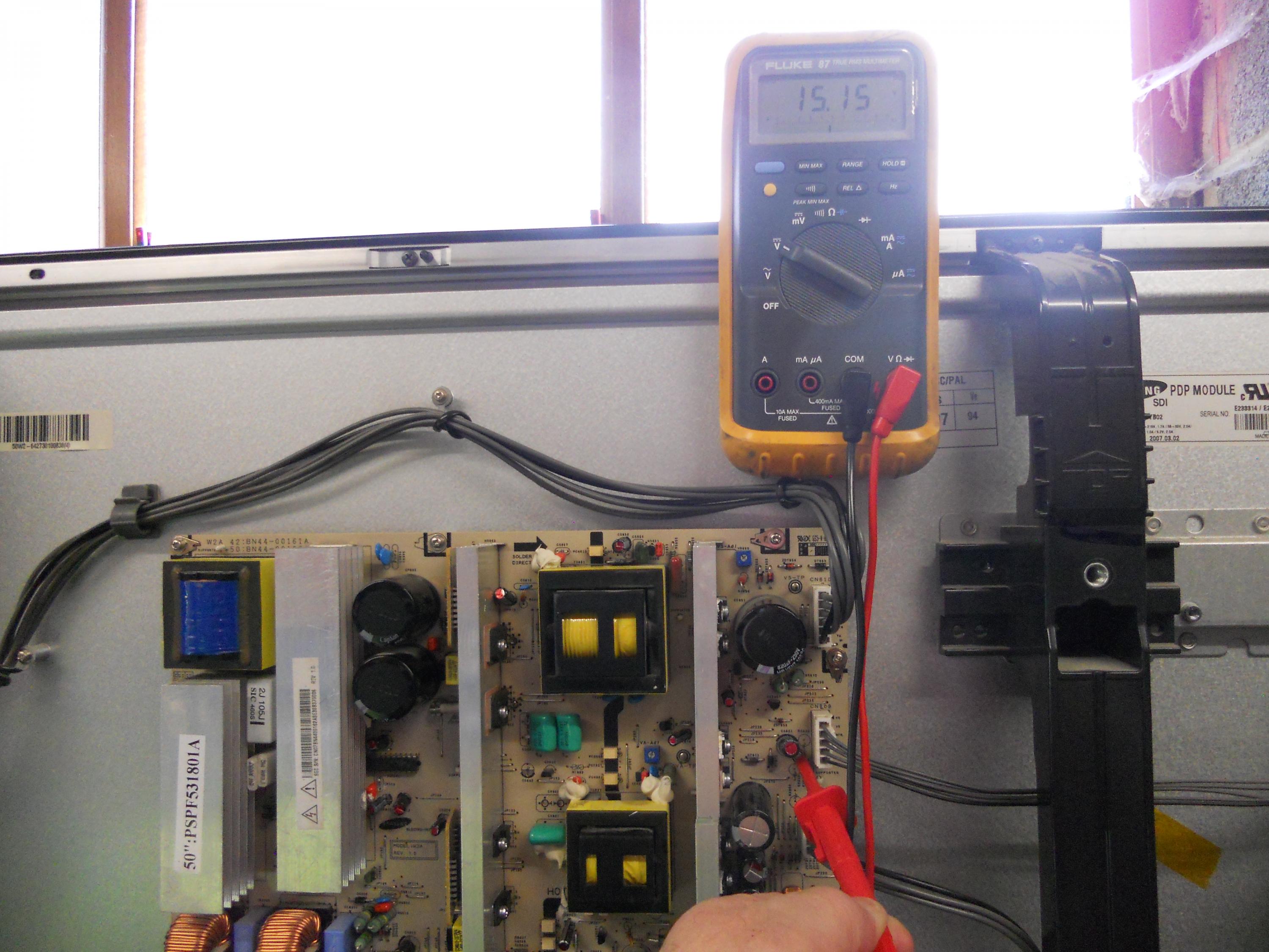

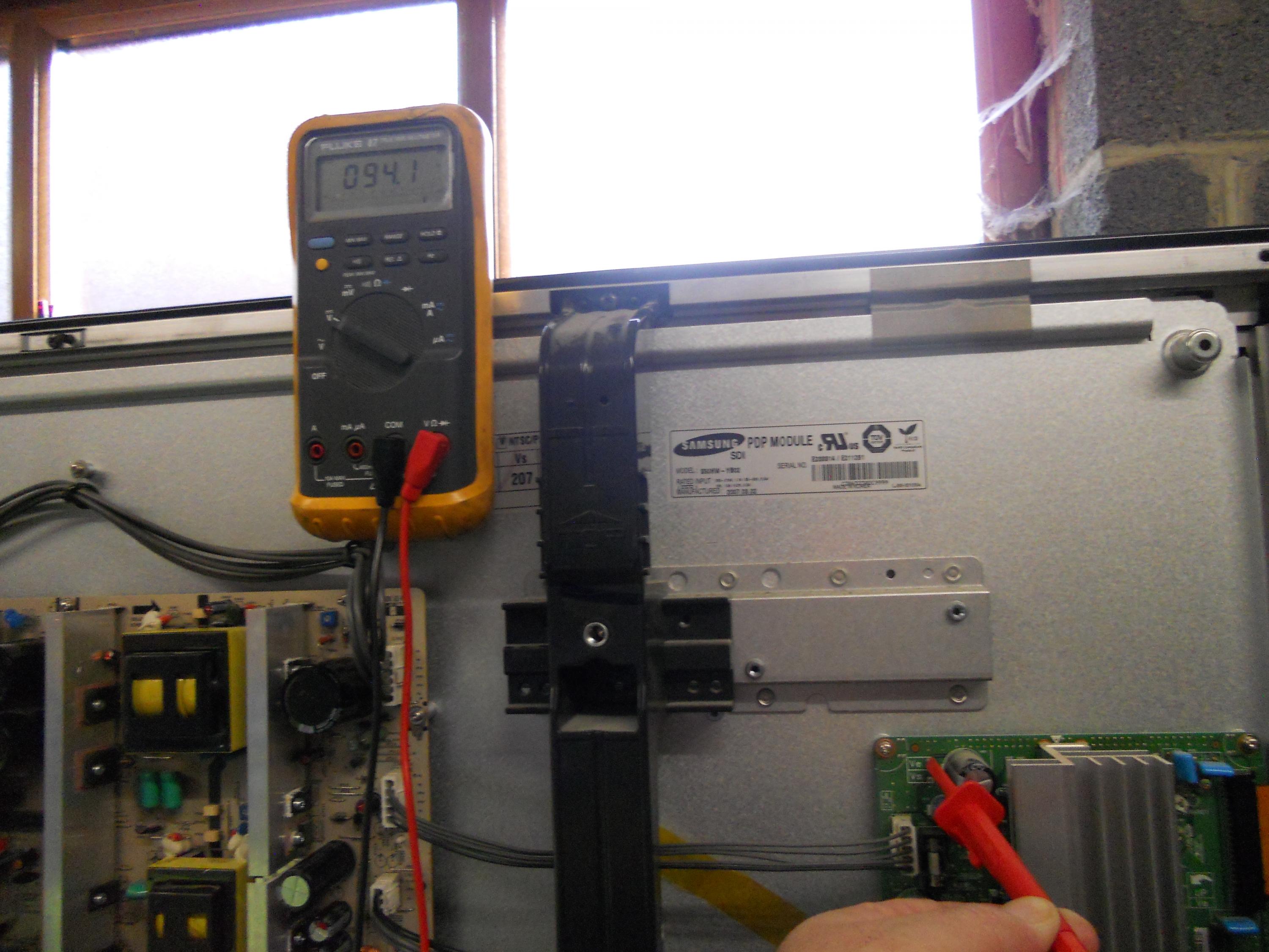

                What I believed to read Ve was actually Vg on the Power Board. I have rechecked Ve on the X Board and it is 94.1VDC (pic 1427). Vg on the Power Board is measuring at 15.1VDC (pic 1426).

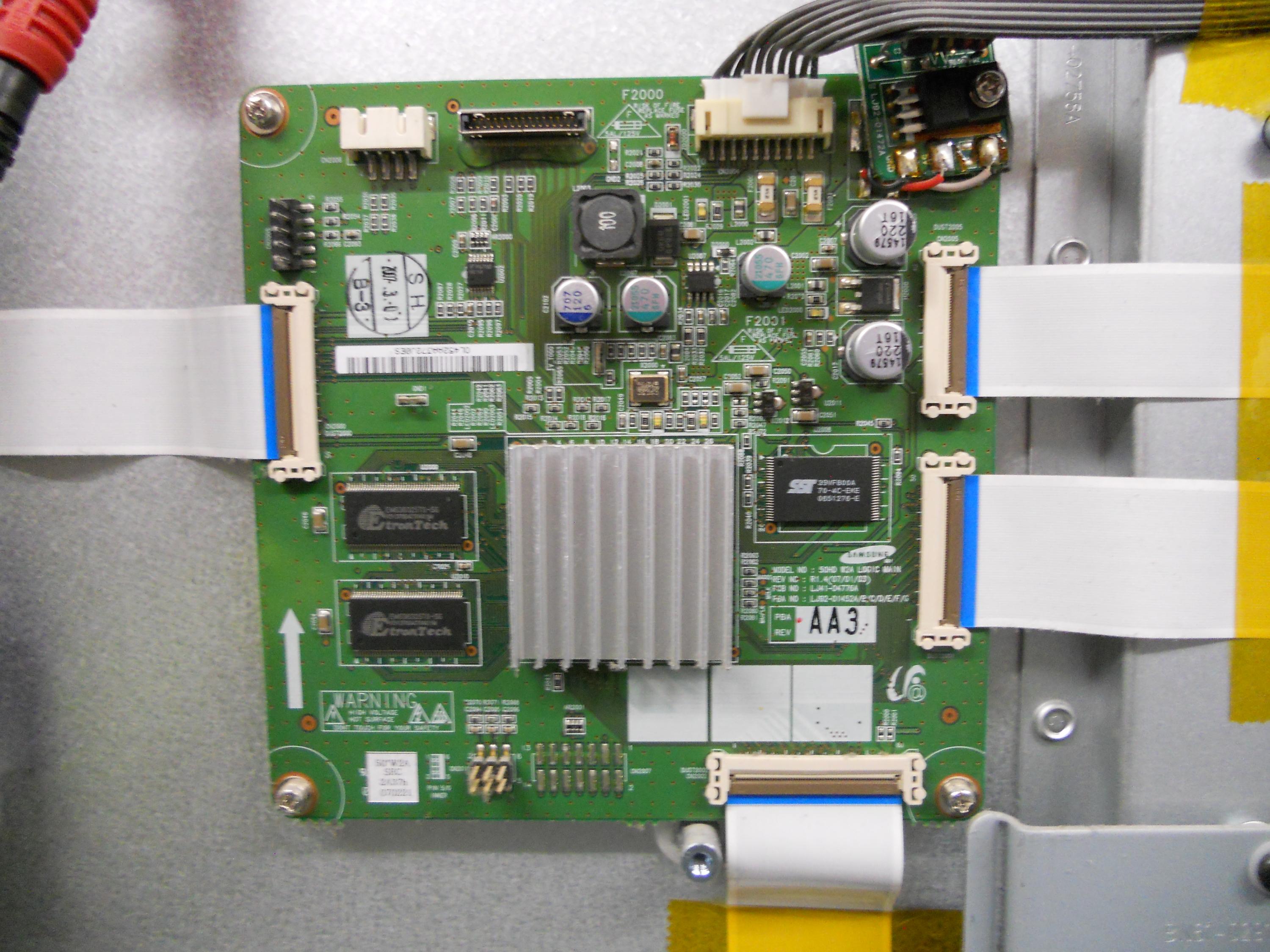

                                Re: Samsung PS-50Q97HD powersupply problem
                                I have exposed the logic control board and attached a picture. Could you confirm if it is the block of six pins at the bottom left or the five inline pins at the top left that are the ones to be used for the Test Patterns?. Incidently when I had the AC supply on with the PSon grounded and the resistor fitted onto VSon to Stby a single green LED was flashing on the logic board and two other LEDs were solidly illuminated.
                                • mjharrisuk
                                  • Feb 2015
                                  • 18
                                  • England
                                  Upper 5 Left Pins are marked CN2008 and the lower 6 Left Pins are marked CN2010. I have tried searching for running the Test Pattern associated with this TV logic board. As far as I can see from other posts associated with other TV logic boards I need to short pins 3 and 4 and it allow it to run through the screens sequence. Is that correct?
                                    First it is not good practice to apply jumpers when the boards (logic/main ) are connected, this can damage them, so only do this when the boards are disconnected (or with the signal wires(PSon /VSon) from the board taken out of the plugs).The pins for this test are the ones marked 1-6 on the lower left hand.for the test you need to connect pins 3+4.
