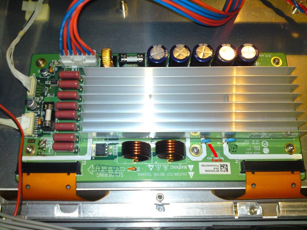

                      Re: Plasma 42V7 problem - please help!!!
                      Picture of where to test, you could use a hook probe.

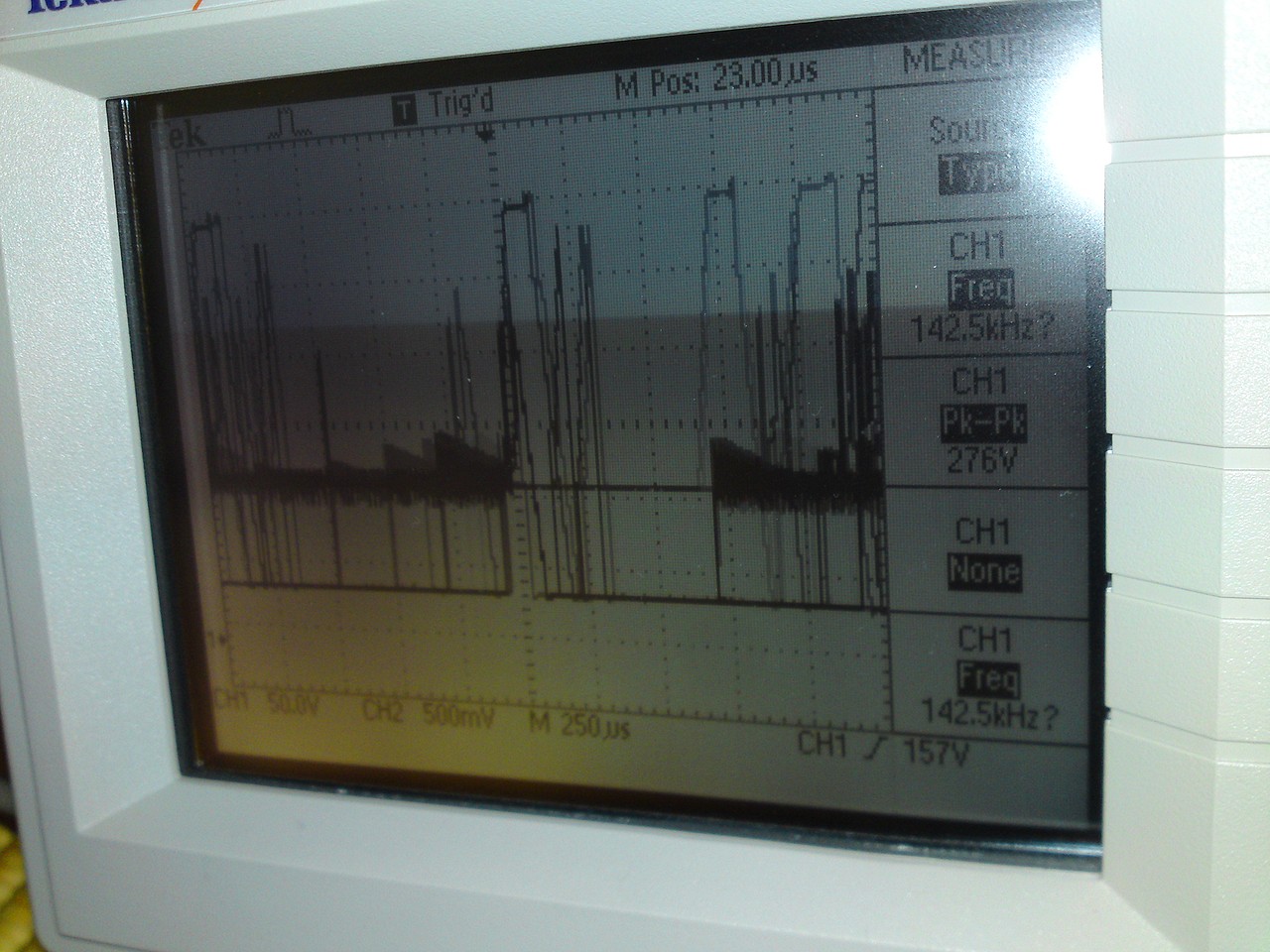

                        Originally posted by tom66
                        With your scope, check Zsus output. 10X probe, 5V/div, 20ms/div. TV trigger works sometimes, if you have it.
                        I checked Z-SUS output with a 60Mhz scope. As I'm no expert at oscilloscope reading, I recorded a movie and few pics so if you can take a look. When TV starts to show some picture, lite clicks are heard from Y-SUS board and oscilloscope reading on Z-SUS changes a bit at that exact moment... I think it didn't happen during this video. Please if you can guide me step by step through this scope process, as I'm not familiar with scope and this types of signals. I measured voltage on that same point - it's +128V. Is it Vzb?
                          Nice Tek scope...
                          Vzb should be around 90V for these TVs I think, although when I played around with it, it didn't seem to make much difference. But your Zsus waveform looks pretty good. It is only a square wave really; nothing else.
                          Check Ysus - there is a test point "Yscw" I think - you can check the sustain output to the buffers there. Ysus wave is much, much more complex.
                                Just the big metal connectors going to Y buffers One will be ground, the other will be the waveform you need to test.
                                I found what you say in service manual. It's "Vscw" and it should be tested at bead B39 which is connected to center big metal which goes to buffer boards. Other two upper and lower metal are not connected to ground.
                                Should I test it with scope across ground and B39 (center metal)? See pics...

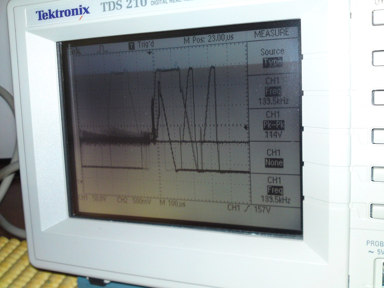

                                  OK, we have some progress here! ;-)
                                  I measured Y-SUS output wave with scope. It's obvious something is wrong with it! When picture briefly appears, wave on scope jumps. I recorded a video of this condition. Actually, that was longest burst of displayed picture I ever got on this broken plasma.
                                  Look at the movie:
                                  http://www.youtube.com/watch?v=UTkkJBE5FdM
                                  When picture is near black voltage is 135V-155V, but when picture is briefly displayed perfectly voltage jumps to 190V and clicks are heard from Y-SUS and IPM get normal buzzing noise! Something like IPM is switching on and off...
                                  What do you think?
                                  Btw, picture is little bit "slow" I believe because misadjustment of VsetUP and VsetDN.
                                  Thanks!
                                  S
                                    Does your scope have a pulse-ramp rate trigger? Try triggering on the slow VSET ramp; it ramps up over several microseconds.
                                    It sounds like your Y-sustain is faulty. This issue can be caused by a walking-wounded IPM.
