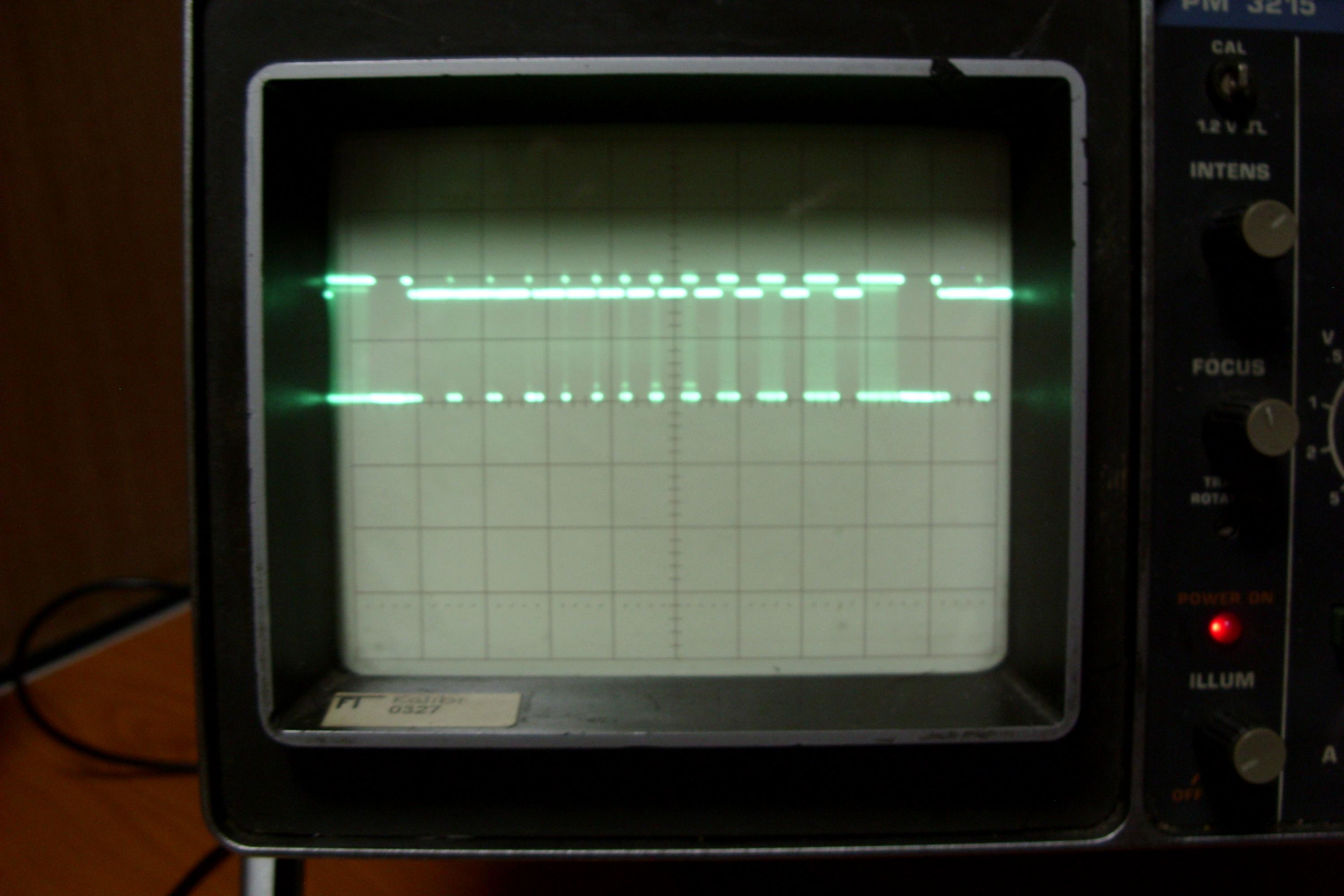

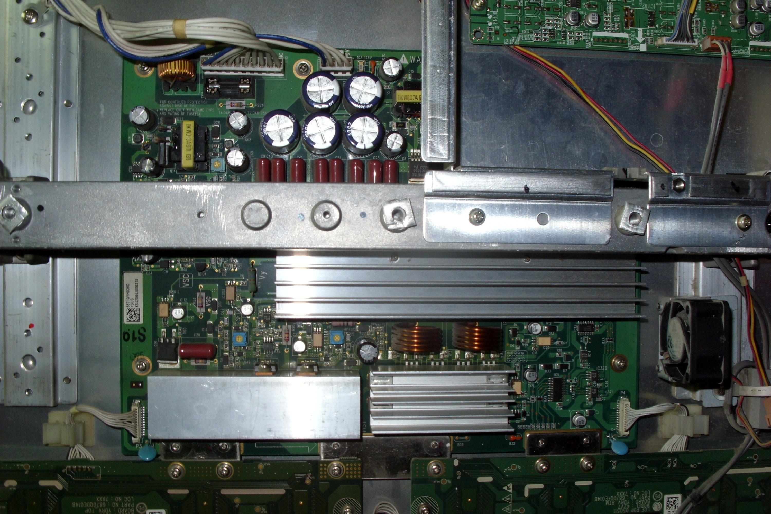

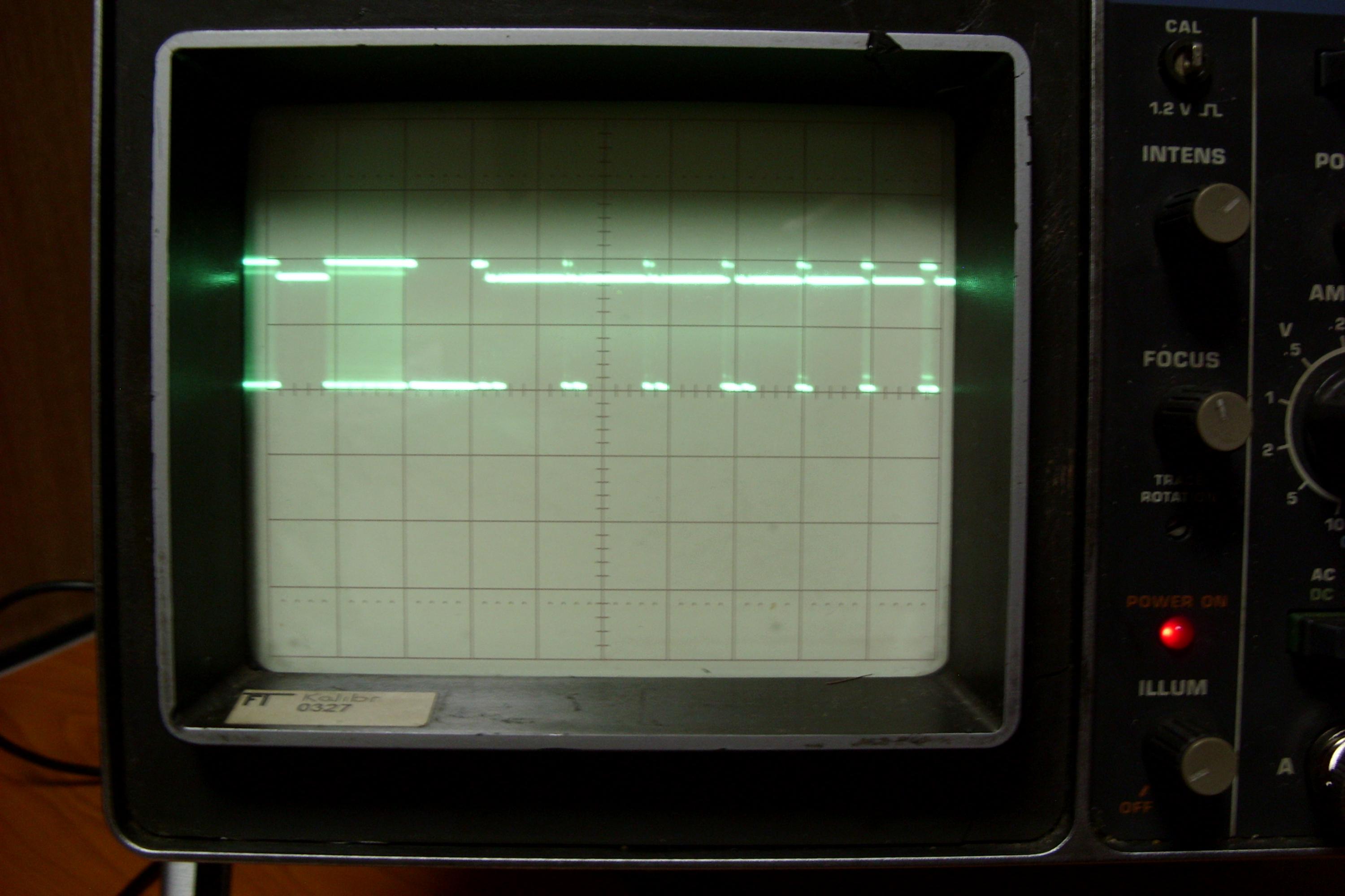

                      Re: Plasma 42V7 problem - please help!!!
                      Here's a pic of the Ysus. And here's the waveforms of the Zsus at the orange bead near the two large inductors, i suppose that's the one you were referring to. 100v/div, TV trigger. First pic is 1ms/div, second 2ms/div.
                      Waveform is the same at the blue cap you asked the OP to check.
                        The waveform from the Z-sustain looks good. The Vzbias is being applied (lower, static portion) and the panel is being sustained (higher, oscillating portion.)
                        As for the Y-sustain, I think you should test at B32.
                        Also, test the voltage across those caps I mentioned previously. One end of them is grounded, so you can just try and find the positive with your meter's COM attached to the chassis.

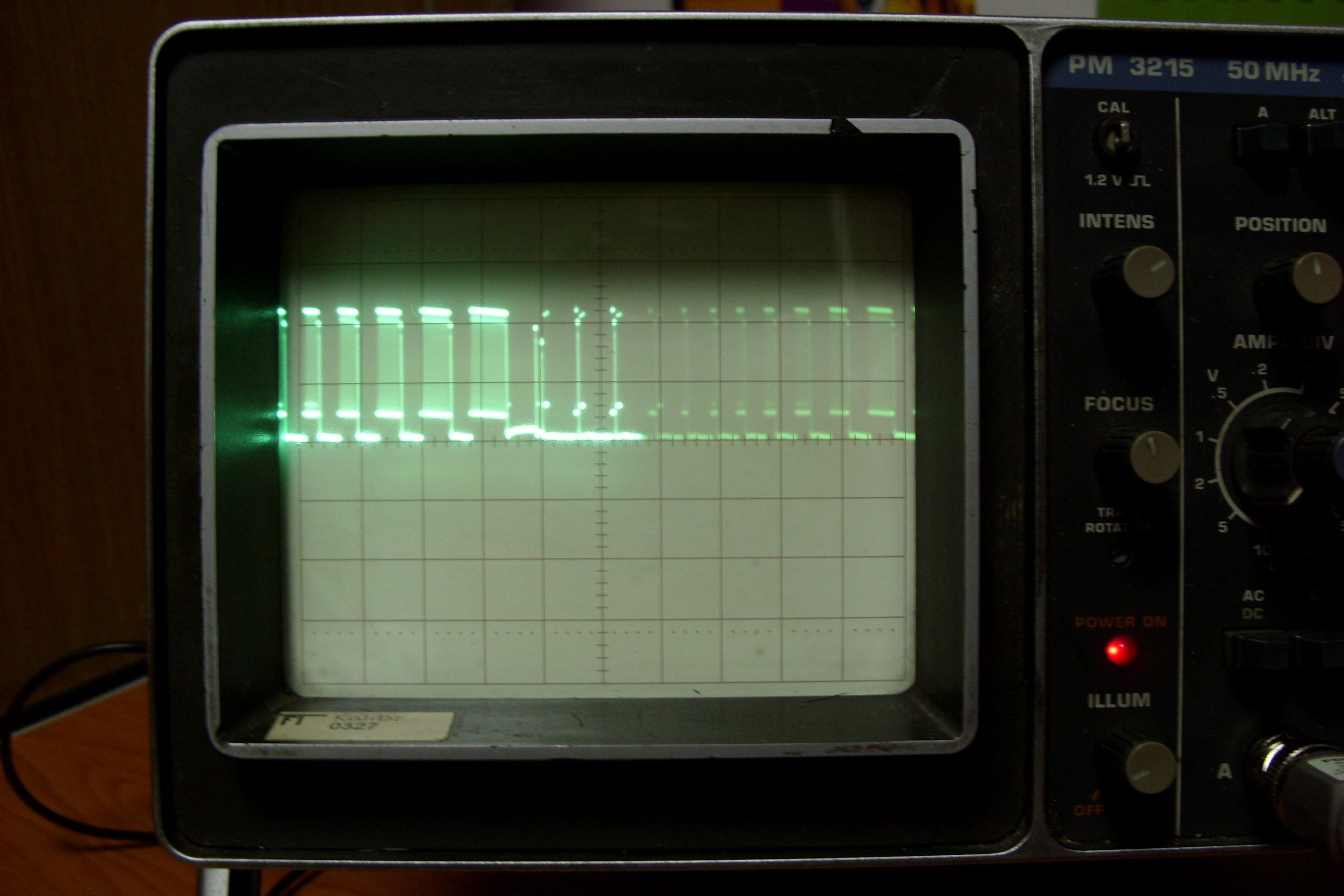

                          #72
                          I think i found a problem.
                          Red caps on Zsus read 92.9v
                          Red caps on Ysus read 6.08v.
                          Also, it might be my imagination, but the waveform of the Ysus seems to have dropped in amplitude. I tested it about 20 minutes ago, but didn't take a pic then. It looked something like the OP's waveform.
                          Now, it's lower in amplitude, and there's a hiss noise at regular intervals. When the noise occurs, the waveform spikes (to the amplitude it should've had?), and i can't catch it. Here's how it looks now, when it's stable. 2ms/div, 50v/div. So... ordering an Ysus already?
                          A working TV? How boring!
                            #73
                            Sounds like a bad IPM. Swap the IPM or the Y-sustain.
                            You need to take a longer shot at 10ms/div using a long exposure on the camera so we can see if there are any ramp or set up waves.

                              #74
                              There USED TO BE a ramp when i first measured. No longer.

                                #75
                                You should check if those transistors are still warm, if not then check the transistors on there for shorts or replace the whole Y-sus. The buffer may be OK, check with DMM using this method, use the middle pad on each buffer board, not the far pad for your return pad. http://www.youtube.com/watch?v=51SZsfH60EY

                                  #76
                                  The two transistors are no longer warm since the waveform changed.
                                  I'm going to check the buffers some other day. We phoned the owner before i left the shop, and he can't be bothered to come pick it up (we told him it isn't worth fixing), so it's ours to keep. Hence we'll be taking the cheaper route... I'm going to order an IPM and once it arrives, i'll resume troubleshooting.
