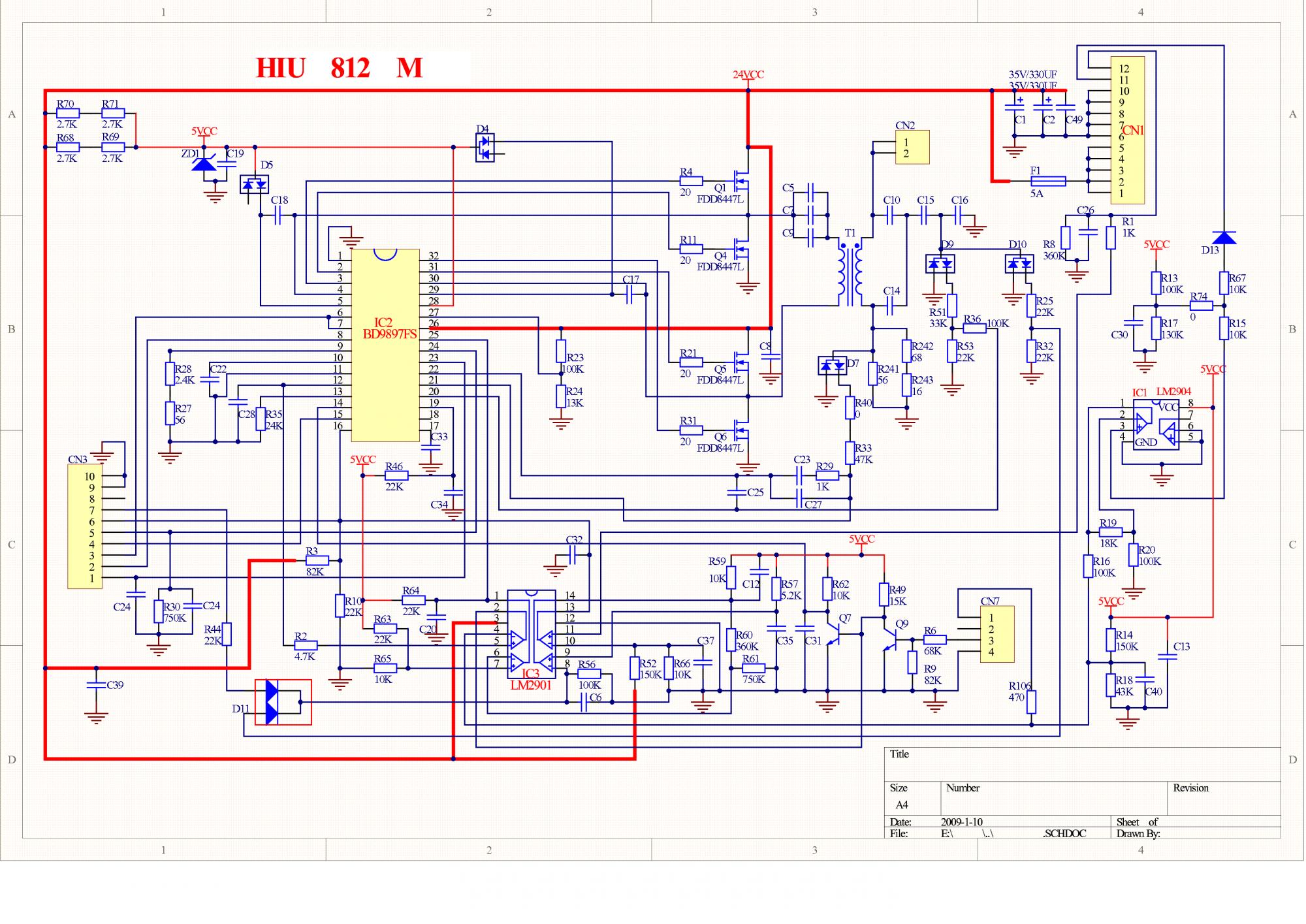

        My master FETs all ohmed out at around 1.3M Ohms from both legs and the slave Q205 and Q206 did as well. The left hand FETs on the slave board ohmed out at 0 so they were shorted. I am going to test my 9897 IC. I still have two brand new 9897 IC's to use if necessary. If you aren't comfortable replacing/soldering the SMD 9897 IC then I'd recommend replacing the entire board. I could be wrong but those readings on your master FETs don't seem good, you sure they aren't shorted?
        Regarding testing the backlight...The backlight doesn't seem to show any distinct pattern when it comes one, maybe a bit dim though if anything. After pressing the power button the backlight flashes quickly once then off a couple of seconds then back on for about a second or two then goes off. The green power light stays on throughout and after all of this occurs.
        Also...the voltage at the input to the transformers is about 5.5V when the TV is on but backlights are off after they fail to stay lit. If I measure that voltage as I turn the TV on it spikes briefly when the lights comes on before dropping back to 5.5V after the backlight fails.
        I have attached inverter schematics that seem to be the same boards though these are labelled 812 instead of 813.

            I found a couple of different versions of the SM for this TV at elektrotanya but none include any schematics or diagrams of the inverters, only the interconnect block diagrams for the boards. It also does not include the interconnect between the master and slave. The schematics I attached for 812 M & S are the closest I have found.
              Re: Toshiba 32AV500U picture but no backlight
              Do you have the Master in PDF?
              • DakotaKid
                • Nov 2010
                • 165
                attached as pdf. Hope this helps.

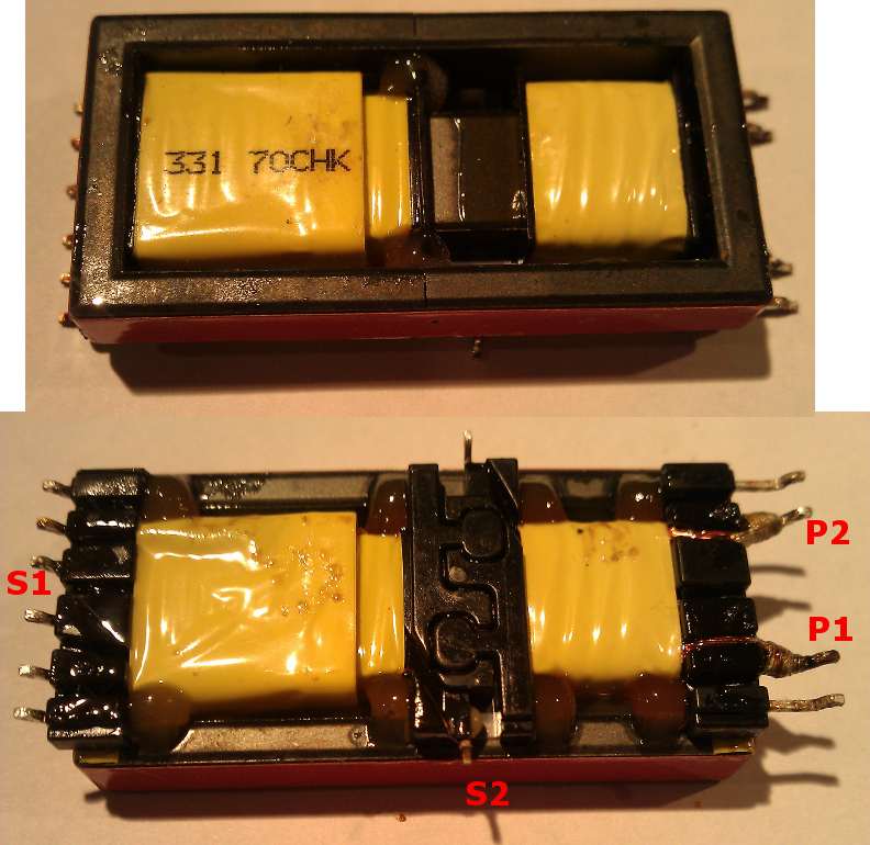

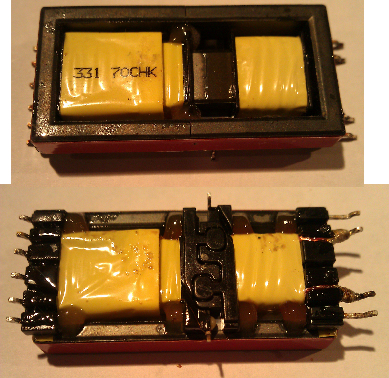

                  Here is the transformer. I haven't yet figured out which pins are P and which are S.
                    #29
                    As you can see from the schematic, there are only 2 windings on the transformer. so you should be able to read the resistance on each windings, for example, the one on the bottom of the picture, on the right side you can see copper wires from the bobbin to the terminals.
                    Usually the high voltage side will have resistance of 500 Ohms and higher.
                      Here is the updated picture of the transformer. Resistance measures .1 Ohms across the primary, 23.2 Ohms across the secondary high voltage side.
                        Try brute force way below. 23.2 ohms is way too low for a secondary resistance reading.
                        https://www.badcaps.net/forum/showpo...6&postcount=20

                            I would be interested in seeing what others get when they test their transformers for resistance. I get 1300K Ohm from P->S pins but continue to get about 23 Ohms on both the master and slave transformers between S1 and S2. The brute force method yielded nothing different. This is a very straightforward two coil transformer so there aren't many different ways to check it. The other odd thing that I've seen on mine and all pictures of these boards is a whitish color residue that looks almost like a scorch mark around each of the middle transformer pins. Every time I search for any info on this TV I find info about this inverter problem and comments around the microfuse, FETs, control IC, two large caps, and (sometimes) transformers having been replaced. I am beginning to wonder if the entire circuit is so poorly engineered or built with inferior parts such that it blows everything from the fuse thru the IC, caps, FETs, and transformer. I have yet to read about many successful repairs of this TV / inverters. It also most likely explains why Toshiba changed to a re-engineered single inverter board mid production stream of this TV. Sorry but my patience is wearing thin. I know the answer is there but it sure is elusive.
                                  The inverter transformer I pointed to in post #21 is only an example of what to look for. That is, the pins may vary as to which is the primary and secondary. 1300 ohms or 1.3K ohms sounds about right. You listed 1300K ohms, is that a typo?
                                  If inverter transformer measure 1300 ohms on each board, then they are likely okay.
                                    Originally posted by electronicsurplus
                                    Sorry, I hope I am not hijacking this message or whatever it is called. I have a pdf a copy of the service manual for that television
                                    No worries. I have the SM pdf but the problem is that it doesn't have details for the inverter boards, only the connecting plug voltages. I posted board schematics for the inverters in an earlier post but it doesn't list capacitor values or expected voltages at test points. Since we are pretty certain that these TVs are failing due to the inverters and have found failed components on the inverter boards it is that detail that is needed. But, thanks for the info.
                                    It really is 1300K but that is measured across the Primary pins to Secondary pins. Across S1 and S2 measures 23 Ohms which leads me to believe the transformers are possibly bad which might in turn put the backlight into shutdown mode. Last night I measured the voltage at all pins on all IC's on both inverters. I will post that here when I can put it in a readable format. There is definitely a "screaming/hissing" noise coming from the Slave board transformer when the backlights briefly fire up. Unfortunately, the length of time that the backlight stays on is so brief that it's about impossible to get voltage readings except when it has already shut down.

                                      Since the Master and Slave use the same transformers, I would swap them and see if the noise follows, you already replaced the IC and the MOSFET's on the Slave board already, right?
