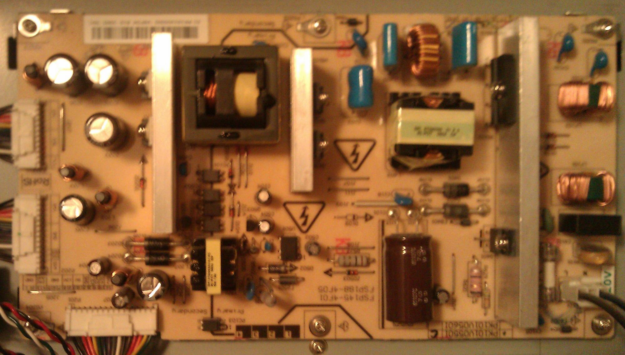

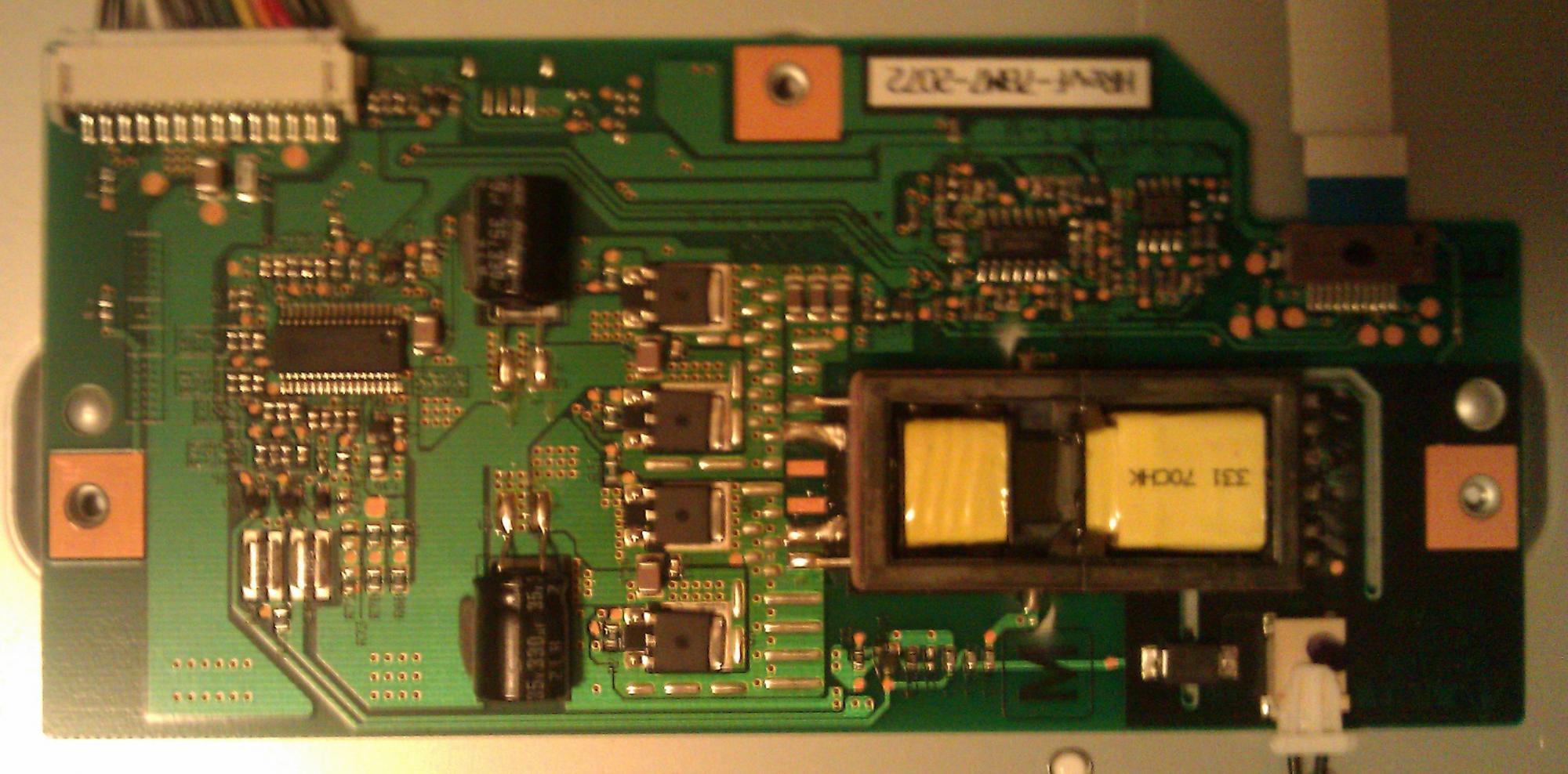

    I have a Toshiba 32AV500U LCD that powers on but stays black. Flashlight test shows that the OSD menu does come up. Sound works when hooked to source. Outputs on power supply appear to be good at each connector with 24V (23.4V) going to right and left inverter boards. Each inverter board is fused with a 5A pico fuse on the power input. The left inverter fuse reads 0.01 ohms, the right inverter fuse reads .9 ohms.
    I need to re-test the BKON to make sure it has power. Caps on power supply appear to be good, many are rubycon. No sign of burn marks or failed components.
    Pictures (bad I know, I will replace them when I can get it in better light with a better camera) are attached. This is the power supply and the left and right inverters.

    Check the four ICs on each inverter for shorts.

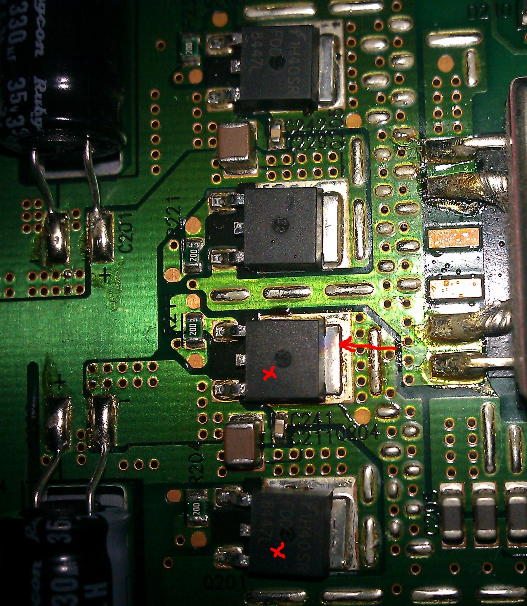

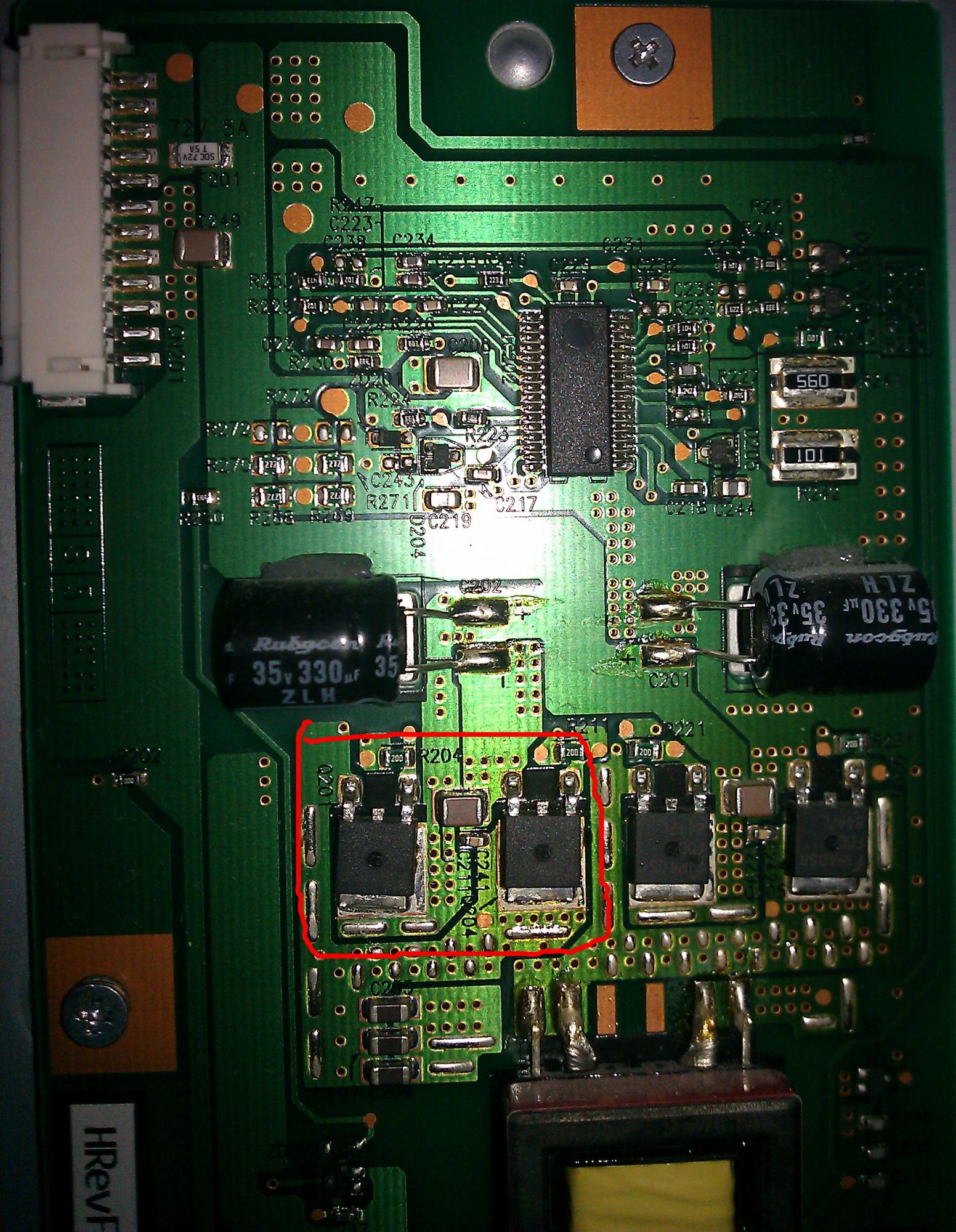

      Indeed retired!! I found two shorted IC's on the right (looking at back) inverter board. The the two leftmost IC's are shorted. These are FDD8447L MOSFETs and you can see in the close up pic I've attached that the second one looks like it has gotten hot at some point because of the discolored metal on the tab.
      Other than ordering a couple of these, what next? What should I check to determine the root cause of the failure? I believe the right part is Digikey FDD8447LCT-ND

        Personally, I would order 10 of these for $9.04 and replace all 8.
        Remove the ones that are shorted and verify that they are shorted out of circuit.
