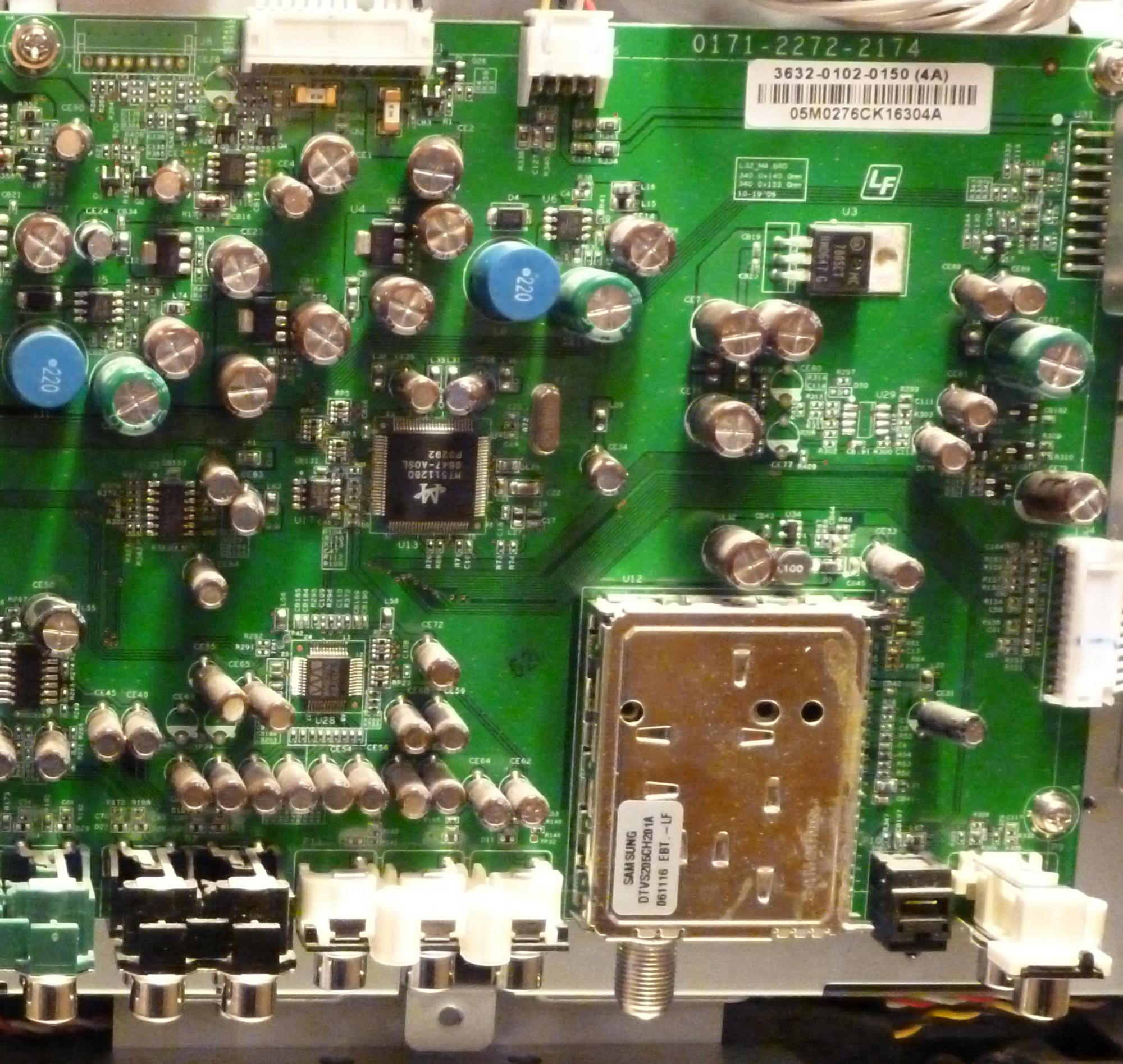

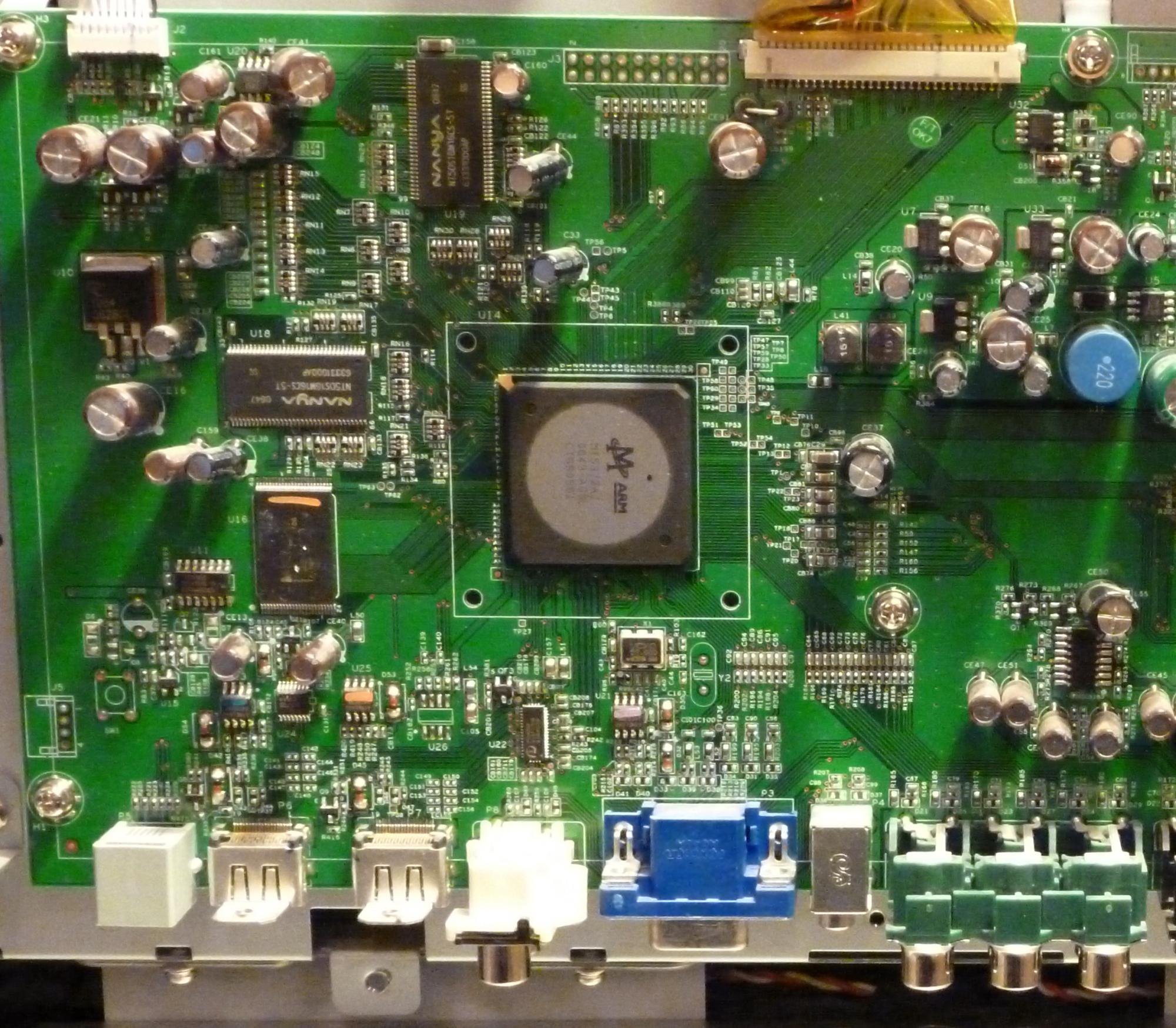

            Re: VIZIO VX32L - no pic, no sound, processor reset ?
            Yes - I first read the other threads covering the U33 problems and ran all of
            those checks before posting this thread. I have included all of my measurements
            below. I have also ordered a regulator to replace U33, for good measure.
            The circuit diagram that I downloaded is VIZIO L32 HDTV10A_MTK,board 3632-0012-0150. My main board is 3632-0102-0150 (part #0171-2272-2174).
            I am including pictures of the main board, hopfully the resolution is ok.
            The device that I believe is the eeprom in U16, just left of the processor
            and has an orange line across the top.
              U16 looks a bit complex for an eeprom - have you tried cleaning the surface with isopropyl alcohol.
              Pics are not quite clear enough for troubleshooting U11 or U23-25 are more
              like what I have seen as eeprom chips - what are their part numbers.
                The alcohol worked on U16.
                U16 MXT064021 9LV320CTTG S565200
                Below are the part numbers of the other chips.
                U11 74RC00
                U23 ATMEL640 24C02BN (2K Serial EEPROM)
                U24 PISC 3257QE Z0644
                U25 ATMEL632 24C02BN (2K Serial EEPROM)
