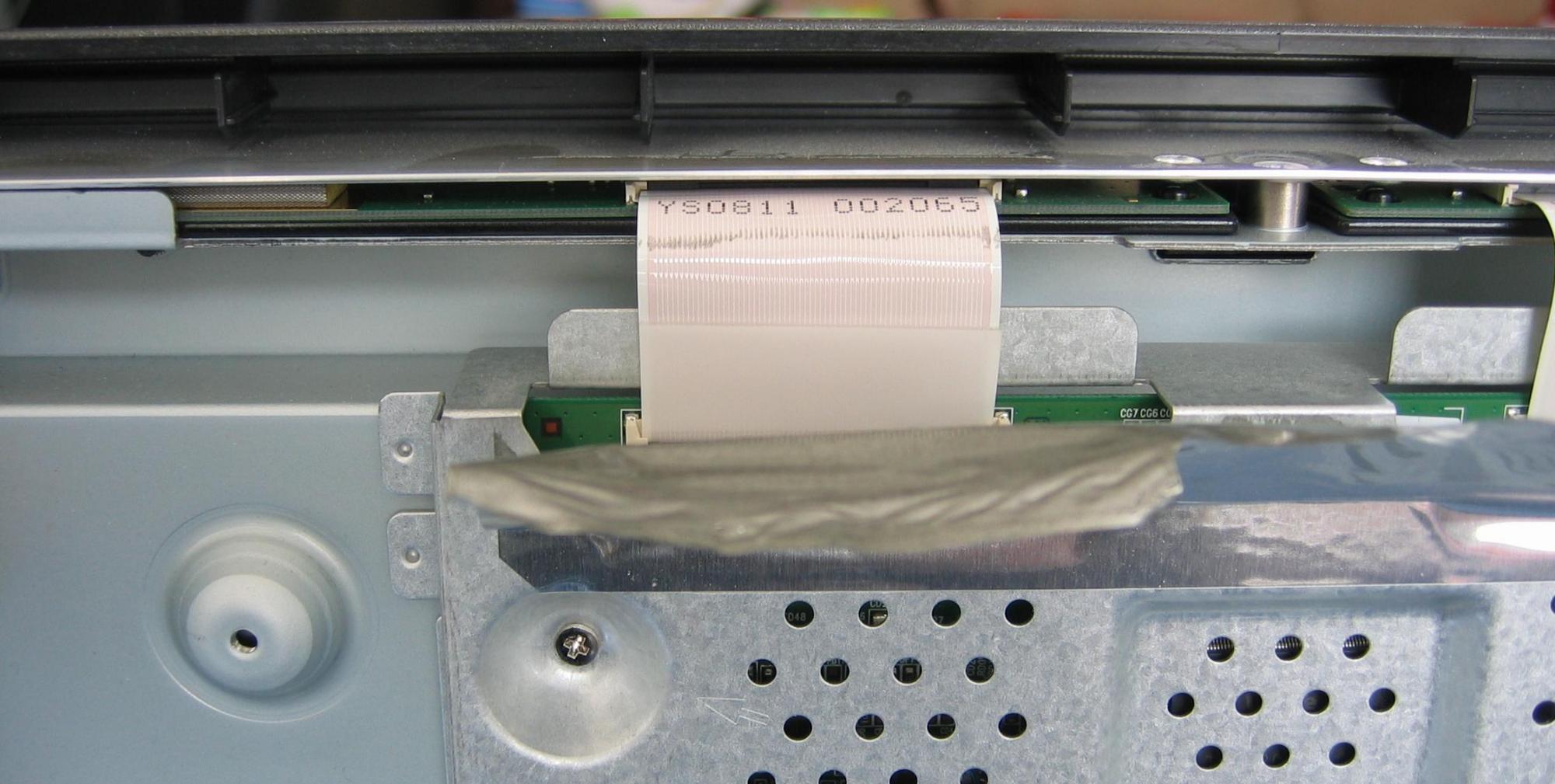

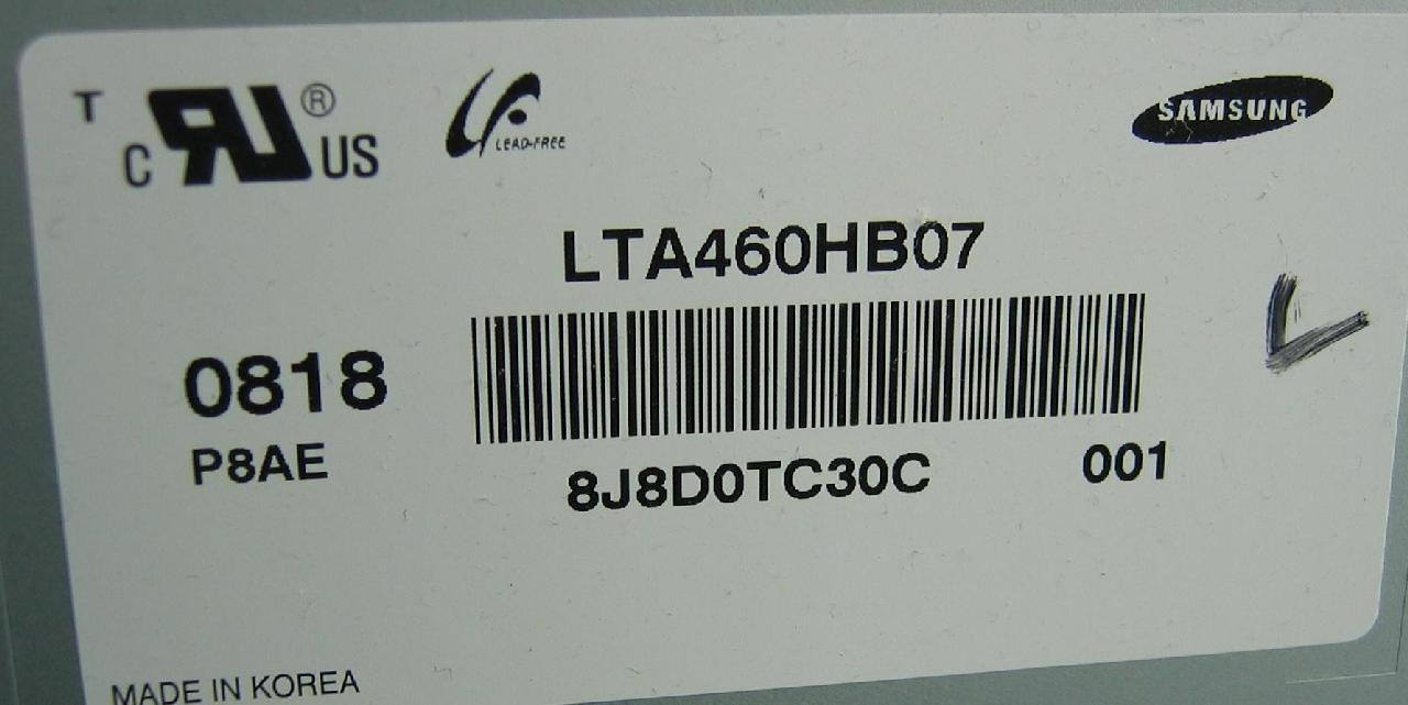

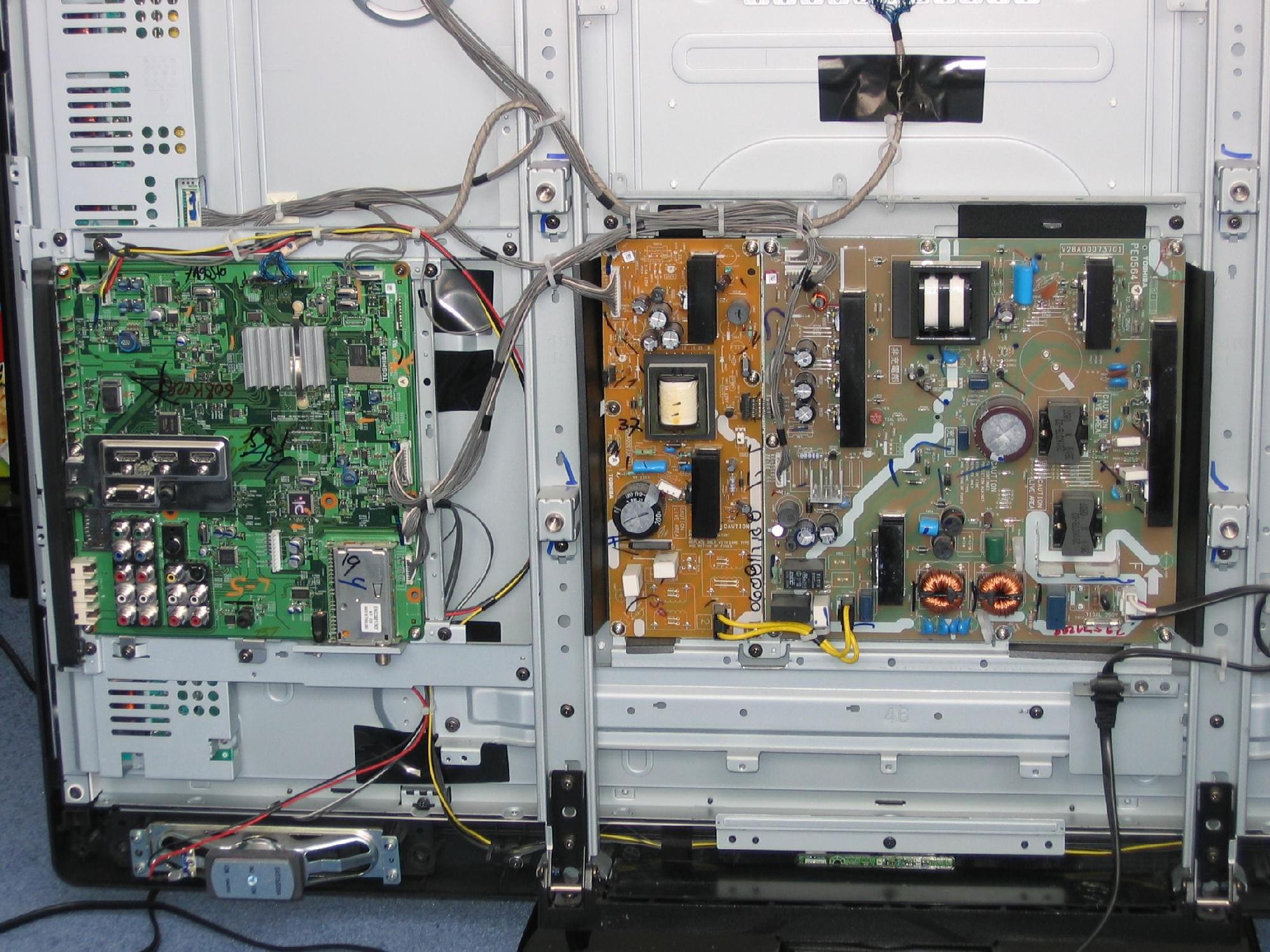

    I'm trying to fix Toshiba 46RV53CU 46 inch LCD TV for someone.
    History
    It was purchased brand new from Costco. The TV was made in August 2008. In 2009 it was serviced under warranty because it couldn't be turned on/off with the remote control. Now it is out of warranty.

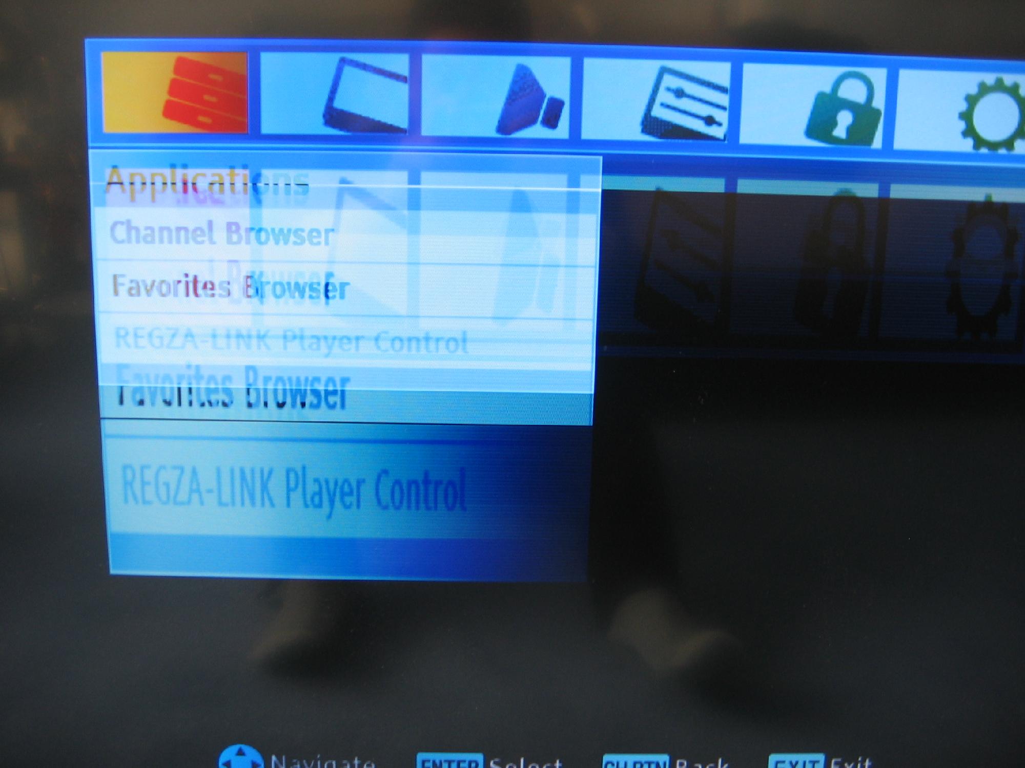

    Symptoms
    When you turn it on, it has ghosting images. I'm told that after the TV warms up, typically 5 minutes, the ghosting images go away. They put this TV away for several months and they got a new TV. So whatever they told me may not be true anymore.
    I have only had it for a couple of hours, but when I left it on for about 30 minutes, the "no video signal" ghosting image never went away.
    It wasn't until I pressed the top right hand corner (when looking from the front) together that the ghosting went away.
    I then unplugged the TV for about 30 minutes and let it cool down. After I turned it back on, the "no video signal" was ghosting again so I immediately pressed the top right hand corner and the ghosting went away.
    I notice that if I gently twist and flex the TV, the ghosting will come and go even when the TV is warm. Once the ghosting goes away it will stay away, but I don't know for how long because I only watched it for about 20 minutes.
    Analysis
    1) I'm thinking the tcon is good.
    2) I could have the infamous tab bond issue because this is a Samsung panel.
    3) I could have a dodgy solder joint or connection somewhere along the thin panel board that runs the entire length of the TV.
    Next Steps
    1) I will leave the TV off overnight and try flexing it again when it is cold to see if the ghosting goes away or not.
    2) I will try reseating and cleaning the t-con connector.
    3) I'm a bit hesitant to take the entire TV apart to get at the tab bonds, but will do so if people don't have any other suggestions.
    4) From what I understand tab bonds are not fixable by the DIY even though "bumpers" might provide a temporary fix.
    Suggestions are welcome!

  • Mr Bill
    • Nov 2011
    • 648
    Re: Toshiba 46RV53CU - possible bad tab bonds or tcon?
    Pressing on the exact same spot clears the image along with twisting it is a pretty textbook diagnosis of tab bond failure. I am amazed that this is your first lcd repair with a 5500+ post count

          • cashkennedy
            • Aug 2011
            • 668
            I like working on monitors, as theyre usually much easier / cheaper to fix.
            As the other people have said, this is classic bad top left tab. You meet every possibly symptom of this problem
            46/52 screen size
            samsung panel
            pressing corner fixes problem
            flexing screen fixed problem
            problem fades when warmed up.
            Using foam tape / or other methods, you can get the tab to stay down, and many people have been able to use the tv's succesffuly every since (1-1.5 years now, since most people started seeing these issues around 1 year ago).
            You could also try the 10 watt resistor technique that is highly succesfful on 32" sony's , and as far as i know im the only person to ever try it on a 40" and it worked well. But 32" and 40" sonys have a different issue i believe, which is recognizable because pressing no tab makes the problem go away, and the ghosting is even across the whole screen. On the other hand the samsung 46/52 inch panel tab bonding ghosting issue is usually really bad on 1 side of the screen and no ghosting on the other side.
            Fixed so far 12 lcd's , 1 plasmas, 5 monitors, 0 dlp's (plan to keep the dlps at 0). and 3 atx power supplies, and 2 motherboards.

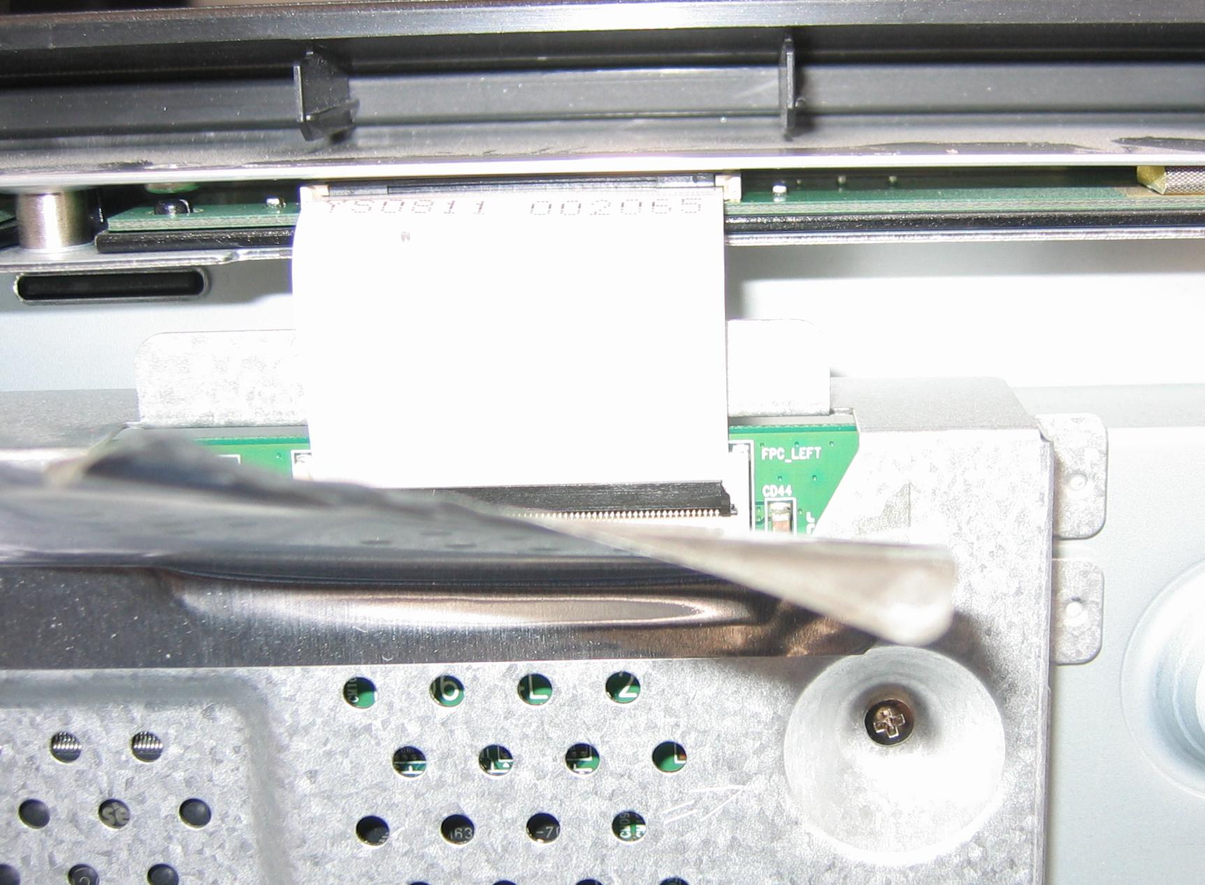

                    • retiredcaps
                      • Apr 2010
                      • 9271

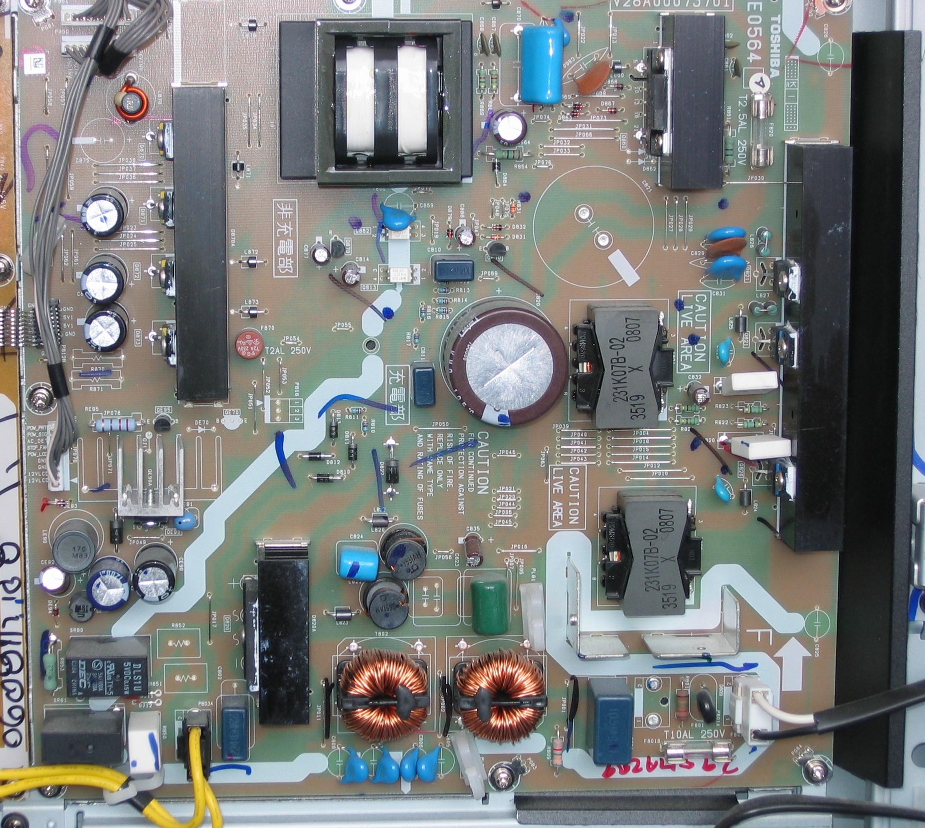

                      I tried reseating all the tcon connectors that I could access. There is a possible removable connection from the two thin cables underneath the metal shielding, but that will require more time and space that I have right now. I have to remove the entire frame to get at it.
                      I took off the tcon metal shield and did some voltage measurements (VIN, VDD) and nothing was fluctuating. The sole voltage regulator measured 1.840V which is well within spec.
                      Anyway, I included a handheld pic with 1/80 exposure (best I could do today).
                      An ebay search shows that this tcon is used a variety of TV sets and manufacturers.

                      • Jasgriff
                        • Feb 2012
                        • 578
                        Whats the hole in the middle of the wise view chip?

                        • retiredcaps
                          • Apr 2010
                          • 9271
                          It is some sort of glue like substance. The chip is fully intact.

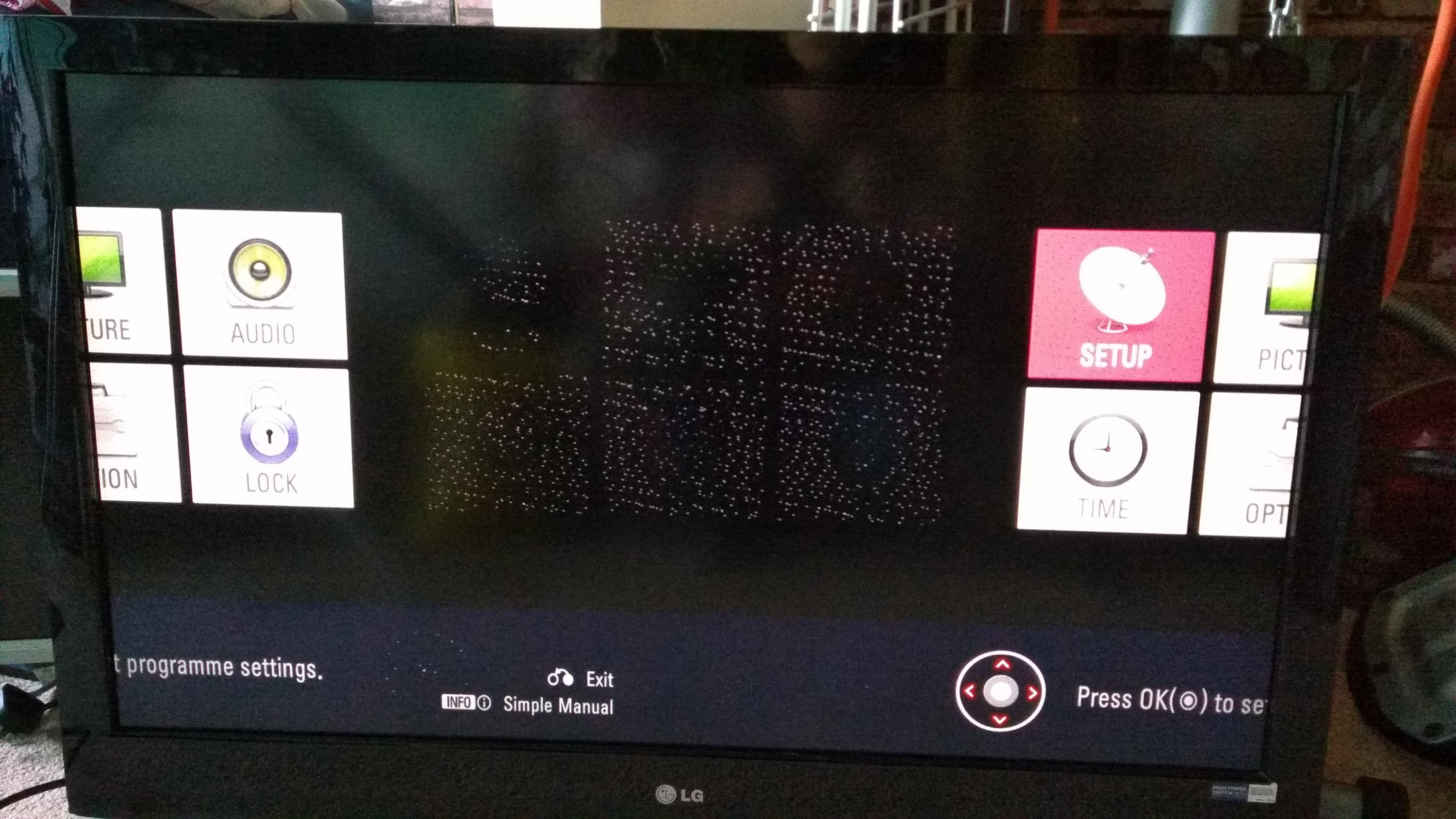

                                    • antas
                                      • Jul 2014
                                      • 148
                                      • Ireland
                                      Hi guys. I have got a similar issue with my LG 42LH3000. Just replaced t-con board and have this issue with the picture. Is that means bad t-con board or something else? Thanks to all in advance for any help.
                                      • antas
                                        • Jul 2014
                                        • 148
                                        • Ireland
                                        Any ideas, please?
