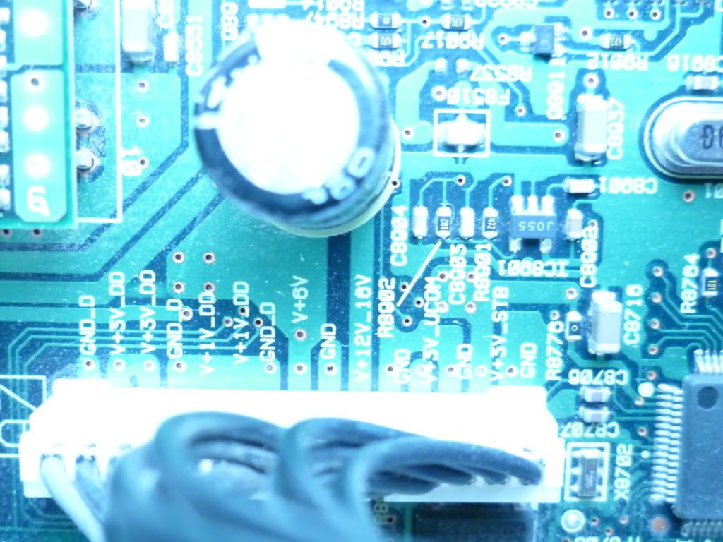

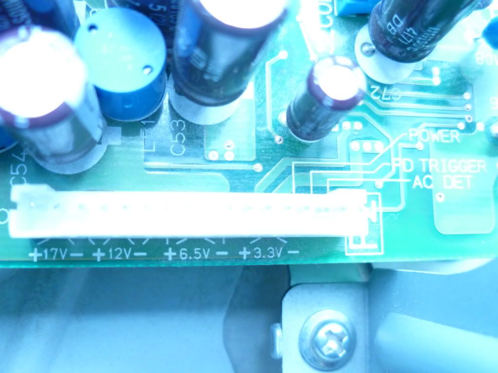

pioneer plasma PDP-435PE
    replied
    Re: pioneer plasma PDP-435PE
    Originally posted by sienoki View Post
    Yep them readings roughly match pin outs on service manual
    Good. Now what does it say about AC detect? Does it seem right?
    (I'm trying to get you to do this yourself, so you learn a bit about the process.)
    Leave a comment:
  • sienoki
    replied
    Re: pioneer plasma PDP-435PE
    Have you tried plugging the DVI output on media box into an LCD monitor or another TV?
    Ive no other tv available to try dvi cable..all ive got is hdmi ports on other tvs
    Leave a comment:
  • sienoki
    replied
    Re: pioneer plasma PDP-435PE
    Have you read the service manual?
    Do the voltages roughly correspond to pin outs?
    Never serviced one before... wouldn't have a clue.
    Was at Robot Club - sorry I couldn't post.
    Yep them readings roughly match pin outs on service manual
    Leave a comment:
    replied
    Re: pioneer plasma PDP-435PE
    Have you tried plugging the DVI output on media box into an LCD monitor or another TV?
    Leave a comment:
    replied
    Re: pioneer plasma PDP-435PE
    Have you read the service manual?
    Do the voltages roughly correspond to pin outs?
    Never serviced one before... wouldn't have a clue.
    Was at Robot Club - sorry I couldn't post.
    Leave a comment:
  • sienoki
    replied
    Re: pioneer plasma PDP-435PE
    Originally posted by sienoki View Post
    Downloaded schematics for media box & them readings seem to be correct?
    After reading quite a few findings about solid green & red lights on this receiver box its pointing towards the trap mode..i dont think my friend has had this opened before as it was heavily coated in dust..is there any other way of getting the tv to turn on without this box?..thx
    Leave a comment:
  • sienoki
    replied
    Re: pioneer plasma PDP-435PE
    Originally posted by sienoki View Post
    My brothers got a samsung plasma with a media box..could i try his media box with this tv?..it wouldnt knack up any settings or owt trying this?..thx
    My bros isnt a media receiver just a fancy dvd player..doh
    Downloaded schematics for media box & them readings seem to be correct?
    Leave a comment:
  • sienoki
    replied
    Re: pioneer plasma PDP-435PE
    Originally posted by sienoki View Post
    My brothers got a samsung plasma with a media box..could i try his media box with this tv?..it wouldnt knack up any settings or owt trying this?..thx
    My bros isnt a media receiver just a fancy dvd player..doh
    Last edited by sienoki; 03-17-2012, 08:11 AM.
    Leave a comment:
  • sienoki
    replied
    Re: pioneer plasma PDP-435PE
    Originally posted by sienoki View Post
    Readings from 16pin on media box psu
    18.94
    gnd
    11.93
    11.93
    gnd
    7.02
    7.02
    gnd
    gnd
    14.18 not sure with this being in +3.3v- pins?
    3.41
    gnd
    gnd
    2.461-power
    .005-pd trigger
    2.690-ac detect
    http://i1068.photobucket.com/albums/...5/P1000995.jpg
    http://i1068.photobucket.com/albums/...5/P1000997.jpg
    do you readings from this pinout as yet..thx
    Leave a comment:
  • sienoki
    replied
    Re: pioneer plasma PDP-435PE
    On the media box. Use DC volts. Measure with power plugged in.
    Try plugging in the DVI output to another monitor, too.
    Readings from 16pin on media box psu
    18.94
    gnd
    11.93
    11.93
    gnd
    7.02
    7.02
    gnd
    gnd
    14.18 not sure with this being in +3.3v- pins?
    3.41
    gnd
    gnd
    2.461-power
    .005-pd trigger
    2.690-ac detect
    Leave a comment:
    replied
    Re: pioneer plasma PDP-435PE
    Originally posted by sienoki View Post
    The AC detect on the tv?..if so is it taking a vdc reading from any of the pin outs with AC on the tv psu..thx tom
    On the media box. Use DC volts. Measure with power plugged in.
    Try plugging in the DVI output to another monitor, too.
    Leave a comment:
  • sienoki
    replied
    Re: pioneer plasma PDP-435PE
    No idea, just check the AC detect. The key to troubleshooting is to check one thing after another (eliminating possibilities) until you find the fault, not to try random things! The message, after all, is MR-AC, which seems to me to indicate a fault with the power supply.
    The AC detect on the tv?..if so is it taking a vdc reading from any of the pin outs with AC on the tv psu..thx tom
    Leave a comment:
    replied
    Re: pioneer plasma PDP-435PE
    No idea, just check the AC detect. The key to troubleshooting is to check one thing after another (eliminating possibilities) until you find the fault, not to try random things! The message, after all, is MR-AC, which seems to me to indicate a fault with the power supply.
    Leave a comment:
  • sienoki
    replied
    Re: pioneer plasma PDP-435PE
    Originally posted by sienoki View Post
    If i press both tv & receiver box power buttons at same time the tv led is solid red(standby) & receiver both green & red both solid..took measurements from receiver box & voltages seem to be correct on all boards...cant test the leads got no other source to try on..does it sound like tv at fault & not receiver..thx
    The AC detect pin being 2.690vdc does that seem to high??
    Im thinking maybe this receiver box needs resetting somehow..how easy is it to do & what would i need..thx
    Its got 1 of those trap switches..maybe i will give him it bk..thx
    Last edited by sienoki; 03-16-2012, 10:37 PM.
    Leave a comment:
  • sienoki
    replied
    Re: pioneer plasma PDP-435PE
    Okay one DVI and one PanelLink cable. Fun, custom interfaces.
    Check for good supply voltages - 3.3V, 6.5V, 12V, 17V.
    Read service manual troubleshooting flowchart... follow all the steps.
    Especially check the AC detect signal.
    Plug the DVI output into a DVI monitor if you have one available... check if you get video.
    If no DVI monitor use a DVI-HDMI cable and plug into a HDMI TV.
    If i press both tv & receiver box power buttons at same time the tv led is solid red(standby) & receiver both green & red both solid..took measurements from receiver box & voltages seem to be correct on all boards...cant test the leads got no other source to try on..does it sound like tv at fault & not receiver..thx
    The AC detect pin being 2.690vdc does that seem to high??
    Last edited by sienoki; 03-16-2012, 07:48 PM.
    Leave a comment:
    replied
    Re: pioneer plasma PDP-435PE
    Okay one DVI and one PanelLink cable. Fun, custom interfaces.
    Check for good supply voltages - 3.3V, 6.5V, 12V, 17V.
    Read service manual troubleshooting flowchart... follow all the steps.
    Especially check the AC detect signal.
    Plug the DVI output into a DVI monitor if you have one available... check if you get video.
    If no DVI monitor use a DVI-HDMI cable and plug into a HDMI TV.
    Last edited by tom66; 03-16-2012, 06:17 PM.
    Leave a comment:
  • sienoki
    replied
    Re: pioneer plasma PDP-435PE
    Obviously, first step check all supply voltages to media box.
    How does the media box connect to TV? Does TV have any inputs on rear, or is it just one IO cable between media box and TV?
    I have my own shed, dedicated to TVs...
    Its a PDP-R05FE media box connects to tv with 1 cable split in 2..
    http://i1068.photobucket.com/albums/...5/P1000992.jpg
    http://i1068.photobucket.com/albums/...5/P1000970.jpg
    http://i1068.photobucket.com/albums/...5/P1000965.jpg
    Last edited by sienoki; 03-16-2012, 05:19 PM.
    Leave a comment:
    replied
    Re: pioneer plasma PDP-435PE
    Obviously, first step check all supply voltages to media box.
    How does the media box connect to TV? Does TV have any inputs on rear, or is it just one IO cable between media box and TV?
    I have my own shed, dedicated to TVs...
    Leave a comment:
  • sienoki
    replied
    Re: pioneer plasma PDP-435PE
    Originally posted by retiredcaps View Post
    It is because your pics exceed the restrictions below. Use manage attachments.
    I keep getting upload failed when using manage attachments..you guys will have to bear with me on this 1..its all opened up on my bed & wife doing my head in...i need a workshop with a hammock..lol
    Gonna get some more pics sorted
    Leave a comment:
  • retiredcaps
    replied
    Re: pioneer plasma PDP-435PE
    Originally posted by sienoki View Post
    Sos for not using manage attachments it wasnt working properly last time..do you only need psu pics for now..thx
    It is because your pics exceed the restrictions below. Use manage attachments.
    Leave a comment:
