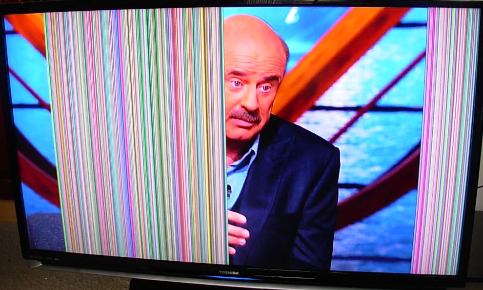

    I've researched the "vertical colored lines" problem with this Toshiba LCD, and based on everything I've read it seems to be related to bad ribbon cable connections from the LCD panel to the PCB. It seems like a really common problem with this particular model.

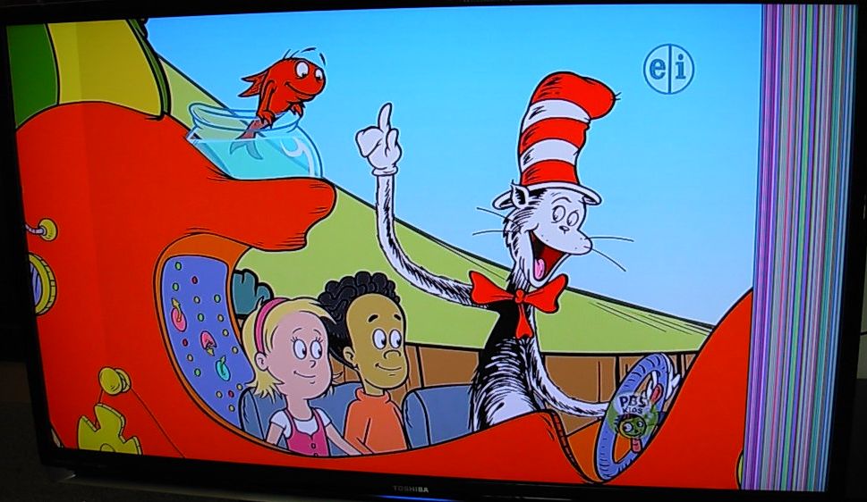

    But I'd appreciate some input on this since there are actually two things going on with it. When the tv is first powered on, there are vertical colored lines in the center and on the right side of the screen (see first pic). Then, after about 20 mins or so, the center vertical lines disappear (see second pic). As you can see in the second pic, the far left side is lighter than the rest of the screen for some reason. And the right side vertical colored lines remain, and never go away no matter how long the tv is powered on.
    Does this seem like both issues could be related to connection problems between the lcd ribbon cables and the pcb? Or could one issue be related to TCON problems, or other?

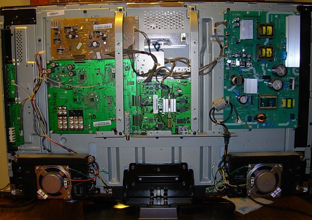

    Also, in order to get at the LCD panel ribbon cables, it appears I need to remove the front plastic frame. Has anyone done this on this particular tv? I have searched high and low trying to see how to do this with no luck. And while I did find the service manual for this tv, I have been unable to view it because it is not in a normal PDF format (it uses the "Zeus" engine, which I have installed but continue to get errors when it tries to load the DWF viewer). I have tried 3 different web browsers with no luck.
    Basically what I'd like to know is if there is a way to detach the front plastic frame without disassembling everything from the back of the tv (circuit boards, etc.). The reason is that from what I've read, I need to be able to press on the ribbon cable connections while the tv is running, to see specifically where the problems are and how to fix them.

        Re: Toshiba 40RF350U LCD - Vertical Colored Lines
        Panel board resistors making a bad connection. Seen this before with this model.. repaired by adding a little flux and resolder. Found this out by using a pencil eraser in pushing on the offending resistors until I saw the picture straight out.
