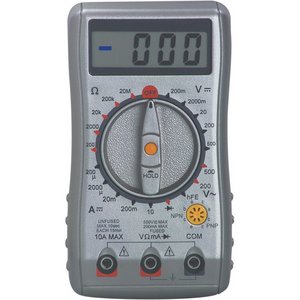

          I have a multimeter but not sure on how to use it can you suggest some good tutorials.
            Re: Sumvision Cyclone Micro Media Player Adaptor
            Can you post a picture of your meter? Or a link to the manual?

              here we go its a digitor q1467

                    Bad caps or bad rectifier, among others. The power supplies are intended as black boxes. If you find the output to be low, there is a problem with the supply. You'll probably have difficulty putting it back together, as they are laser welded I believe. A better solution is to get a new adapter with any connector, then (carefully noting polarity) chop the plug off the old one (with some wires) and new one, then solder and heatshrink the connections.
                    You can test the output of the power supply by using your multimeter and a spare piece of wire. Touch the negative to the shield (outer connection) and stick the wire in the middle, with the positive probe connected to the wire. Measure on 20VDC.
