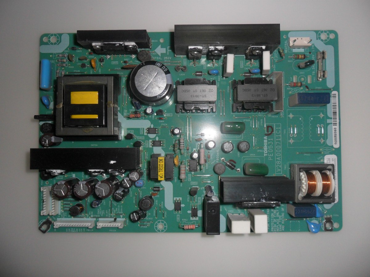

Toshiba 46RV530U - No Display. Has some power...

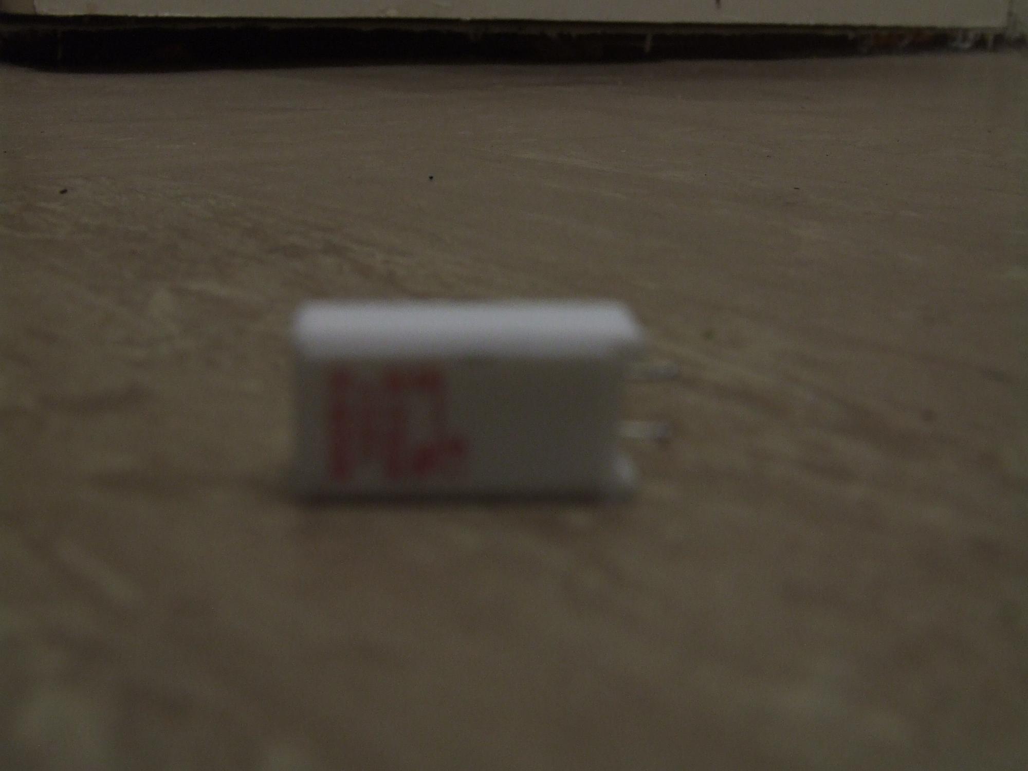

    what u mean by the colour code pal
    Some resistors have a colour code printed on them which encodes the value - does yours?

      yes it does pal and i posted a pic but will post 1 again

        Re: Toshiba 46RV530U - No Display. Has some power...
        all i can see on the resistor is the type that i have specified and its in red pal if that helps
          @Tom66 - hi - it is a ceramic pot with fuse/resistor and thermal break inside.
          see the pdf linked in earlier post. I cant actually find one to buy. What could he use instead - a quickblow ceramic fuse? fusible resistor? They cant have a very high opinion of their boards if they think it is going to overheat to that extent?
            i have tried to take a pic of the resistor if this helps
              looking at the the pdf table Rated power by combination of Thermal fuse with mine saying RGDU5M-5E could i use a 2.8W
                TOM66 do you have any suggestion on this for me pal is there anything else i could use
                  I can't read the resistor value but my guess is 1.8 ohms. It is a fusible resistor; the exact value should not be crucial.

                    #29
                    i take it as a 1.8ohms pal but do u have any idear wat watts they are plz
                      #30
                      "Whatever Fits"
                      A bigger power rating doesn't hurt.

                        #31
                        According to the table in the pdf the 5E is 2.8 watts
