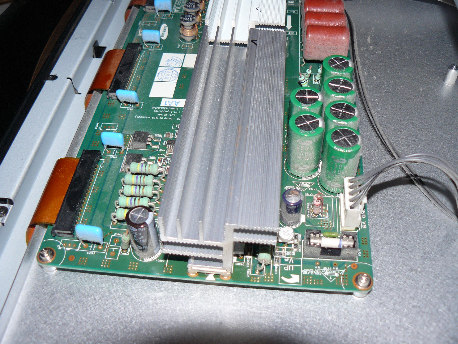

        1) Post a picture of them.
        2) Also list the manufacturer and the series so we can determine their quality.
        --- begin sig file ---
        --- end sig file ---
        • Mr Bill
          • Nov 2011
          • 648
          Re: Philips 50PFP5332D/37
          The brand is Samwha. I'm pretty sure they are a junk brand. The 2 little ones are M series. The Large Green ones are PF series. Also the large green ones are 150uf 250V.
            Series are normally 2 letters. I see PF, PT, and RH.
            RH is their caps for ballasts. From other past badcaps threads, PF and PT are mysteries since they are not on samwha's website.
            Lacking that information, I can't tell you what a suitable replacement might be, but I'm guessing Panasonic FR
            http://search.digikey.com/us/en/prod...422-ND/2433556
            will suffice of the obviously bloated one.
            I'm guessing the large cans are just general purpose caps and there are a number of choices at digikey/mouser for 150uF 250V.

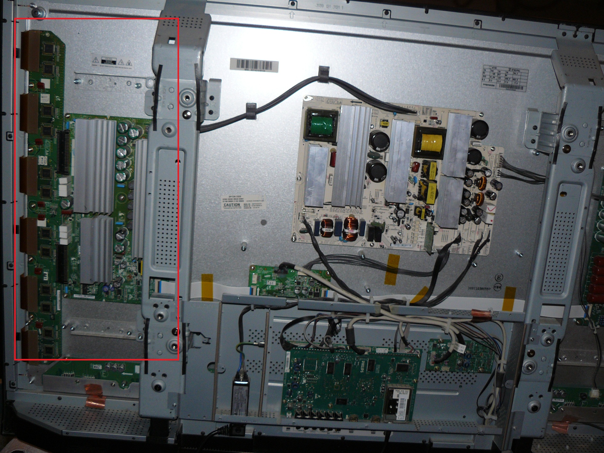

                I replaced the cap and the tv turns on but i'm getting a buzzing over in the upper left corner area.
                When the tv is first turned on you can hear the audio for about a second or two followed by a brief flash of snow then the picture comes in. I've had the tv on last night for 4 straight hours with no problems. Turned it off then went to bed. Turned it on this morning for about an hour with no problems again.
                But the buzzing is very annoying and i just have this gut feeling something is going to or is already failing.
                I measured the dc outputs on the power supply
                VS 200-215V (206.1v)
                VA 61v-65v (63.2v)
                VG 15v (14.65v)
                d5V 5.3v (5.13v)
                5VSV 5.3v (5.16v)
                5Vstb 5.3v (5.32v)
                12Vssb 12.4v (12.25v)
                VSND_POS +17v (+17.22v)
                VSND_NEG -17 (-17.12v)
                So is there anything else to check? The panel is a Samsung S50HW-YD07
                  Loud buzzing is usually indicative of a broken plasma panel. If it is coming from the upper left corner then it is possible that the glass nipple on the panel has been broken. It is in the upper left corner of the panel in the open cylinder coming off the panel frame. If it is broken then eventually all of the gas will escape and you will not get a picture. At that point it would be too expensive to repair and will only be good for parts.
                  It is possible that a component could be failing on the Y-sustain but it would be hard to pinpoint until it actually fails. The fact that you still have a picture makes me believe that the Y-main and buffers are fine but I could be wrong.
                  • Mr Bill
                    • Nov 2011
                    • 648
                    The glass nipple is still there and as far as i can tell not broken. The buzz is definitely coming from the ribbon areas on the y-scan drive board. Im putting my ear from top to bottom of that board and i'm hearing it. It gets quieter as i move towards the center of the tv.
                    Is this one of those just run it until it fails situations?
