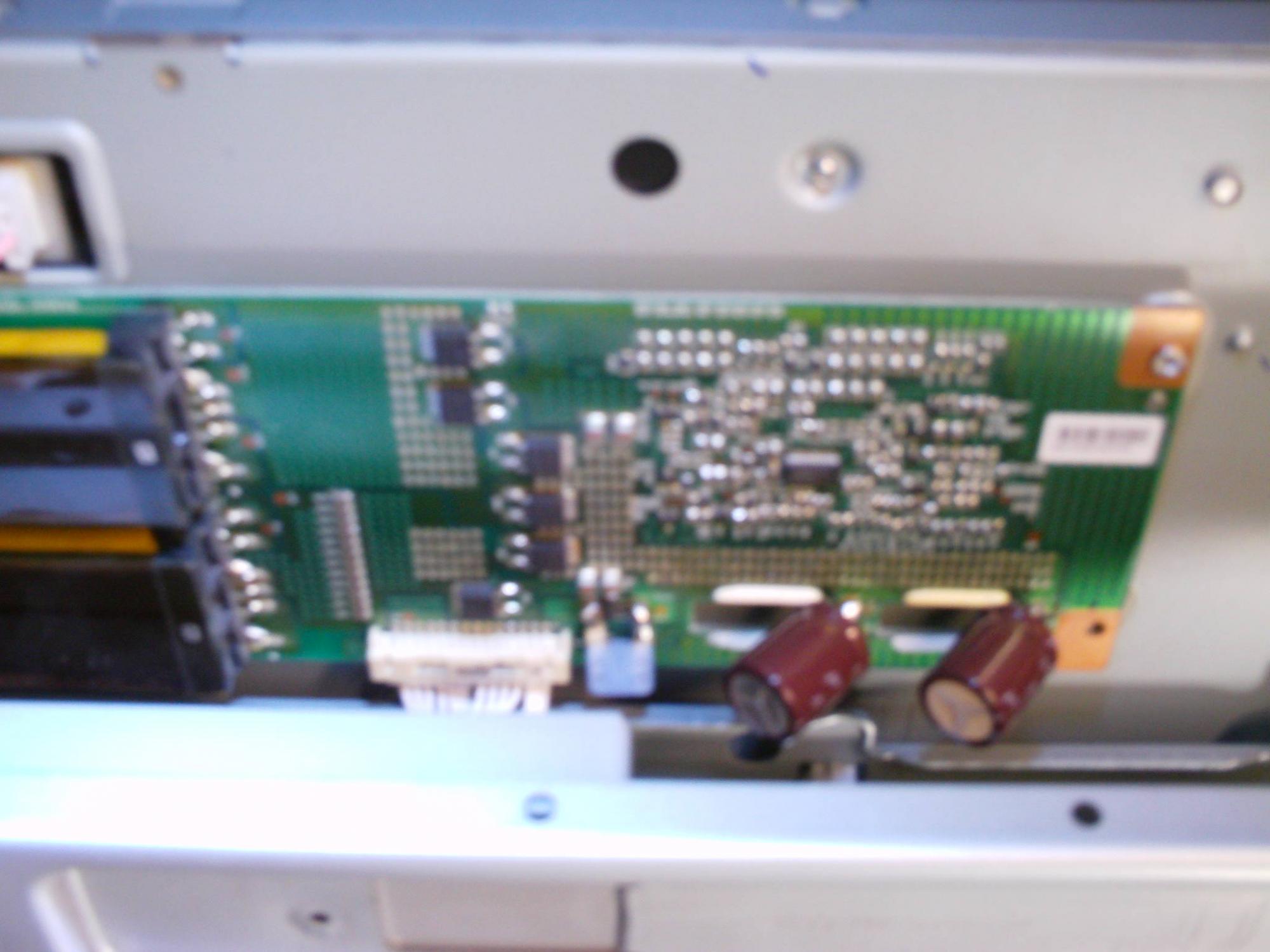

    Hi everyone
    just finished fixing a dead philips 37" 37PFL5332D LCD tv that took a power surge, just some caps on the power supply board and a fuse and both main caps on the inverter board, but as I was searching for parts on ebay i saw an ad the said an 820 uF cap could be used in place of the 670 uF ones that were blown, so i did that and it works fine, but i hear a sound from the inverters that is almost like how high tension lines sound, only less power going through but that same kind of sound. I never heard the tv before it blew so maybe this is normal, it is not overly loud, just very quite in the basement where i was working and I haven't hooked up the satelitte to it yet but I get full function ; menu's etc. What effect does the increased cap value have on the inverter board?could i go even higher value than 820 from the original 670? just wondering as I have some brand new samxon caps that are 1000's and wondered if i used them the power sound might diminish a bit.
    Here is a pic, sorry about resolution, digital camera is next on the fix list, the 2 big brown caps are the replacements and are 820's replacing the 670's, the auto fuse is temporary until my fuses arrive

    Changing uF is only okay if the circuit is not frequency sensitive.
    Most experienced people would recommend not to in an Inverter.
    That said:
    680uF to 820uF isn't a huge change. It's essentially within 20% and uF goes down as caps age.
    A little humming noise is normal from transformers.
    It is also louder when the parts aren't closed up in the casing.
    If it's so loud it's annoying then find the correct 680uF caps.
    If not [and the screen works okay] then don't worry about it.
