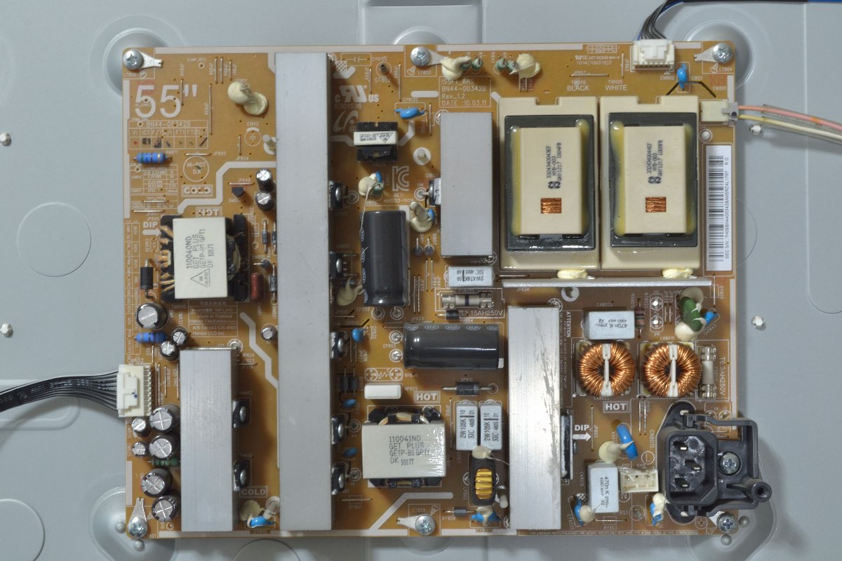

    I didnt get a chance to take a pic here is one off the net
    the Burnt resistor is Just under the Horizontal Large Cap
    Dont yell at me Bill I didnt take that pic with the Flash on!

          1. Don't post pictures inline. It seriously inconveniences retiredcaps and pisses off others - there are threads that I now ignore because some yahoo loaded it with oversize pictures.
          2. We need pictures of YOUR power supply.
          3. Four posts to do what could have been done with one - typical newbie mistake.
          4. The MUR460 is a 4.0A, 600V Ultra Fast Recovery Diode and is available for $.65 to $.84 from Digi-Key.
          5. As to why it failed - it's hard to tell without a picture of the power supply that failed, isn't it?

            Well Bill I am sorry I am such a Nube!
            The supply in the pic is not Failed. But the one I removed Clearly Failed its cracked and Burnt as well as heat marks on the board. the board shows No other Signs of failure no buldged caps or obvious loose items. I will get one found or ordered and search the board for any cold connections.

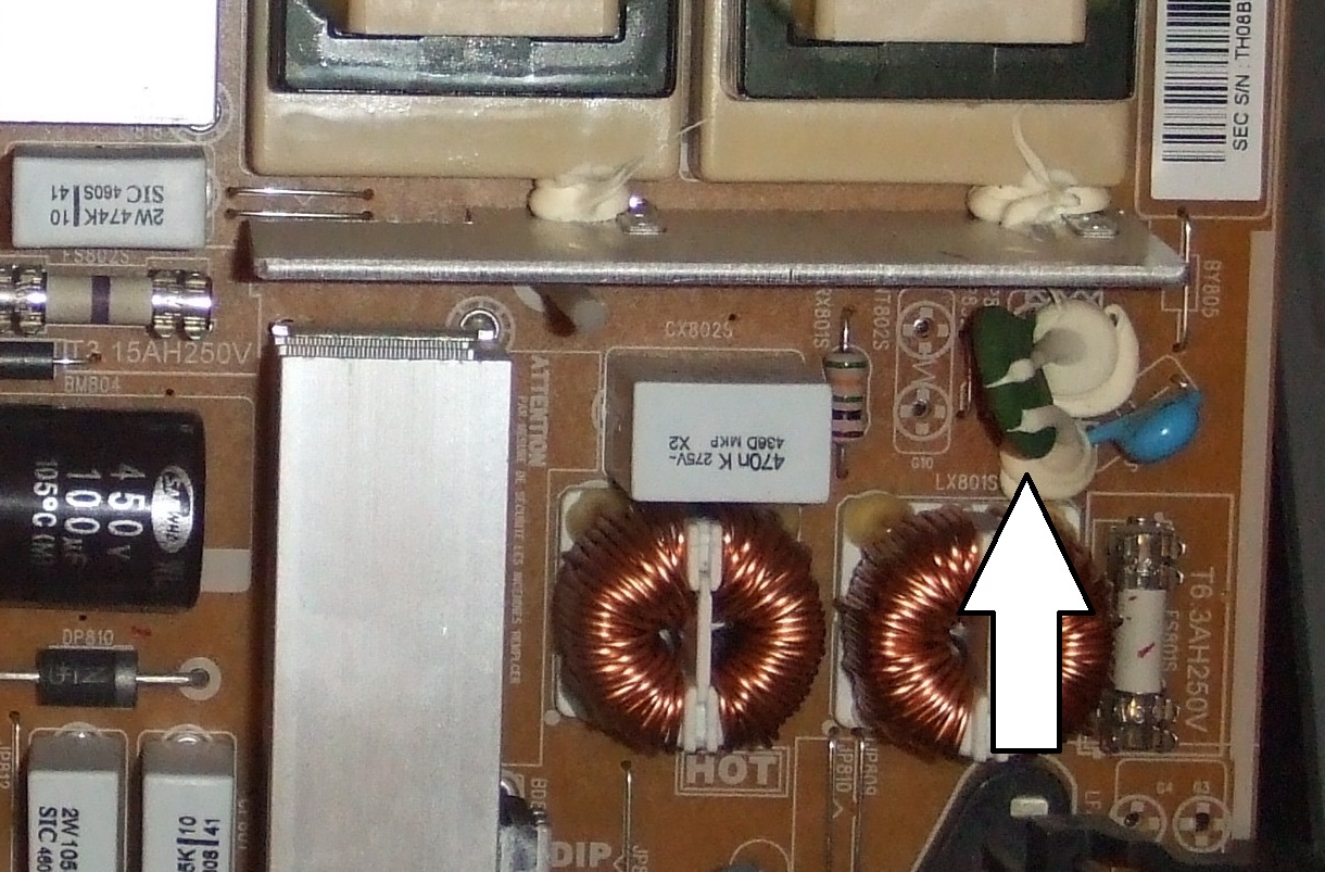

                                Hello guys,
                                My tv has a PSU # BN44-00342B.
                                It stopped all of a sudden due to power failure, as you see it is a ceramic green Cap that has blown, but unfortunately nothing left from it so ican get a replacement; can someone help?
                                Tx
