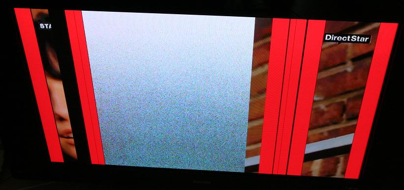

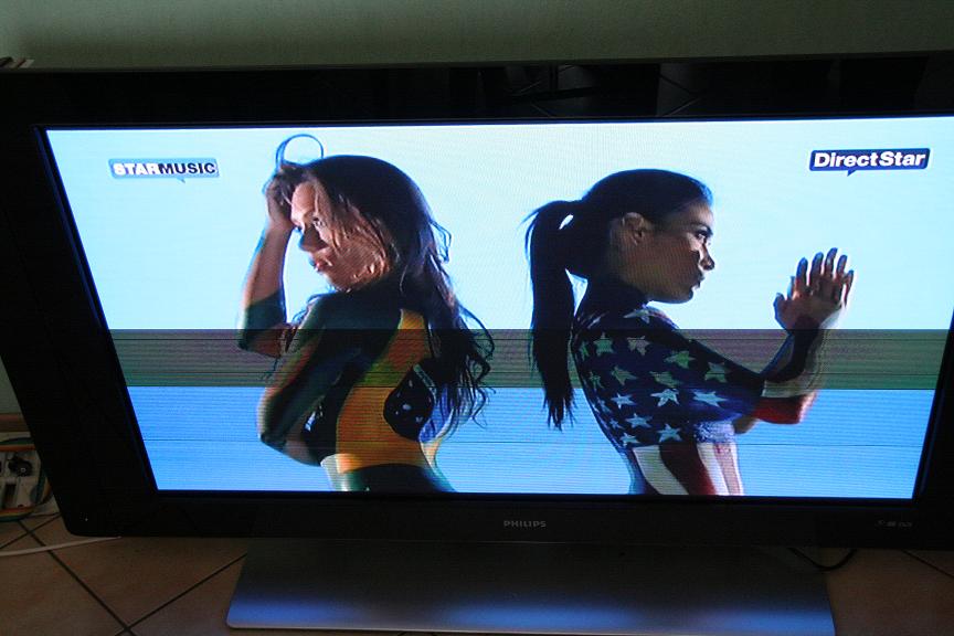

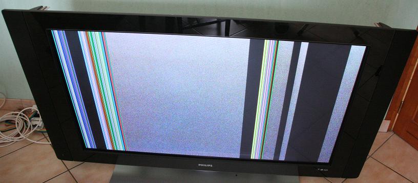

                Can you post a picture of the problem?
                • Shadock
                  • Dec 2011
                  • 10
                  Re: PHILIPS 50PF7521D12 black screen (with some tips)
                  The first picture shows the problem obtained after the first test, it
                  The second one was after having pushed a connector on the Y-buffer (with TV on...)
                  The third one is the result of havind disconnected and reconnected all Y-Buffer connectors (TV unplugged this time). This screen is displayed only few seconds before the PSU falls in safe mode displaying error code 13 (VCC problem). I will try to check if there's another GND problem with the PSU this morning.
