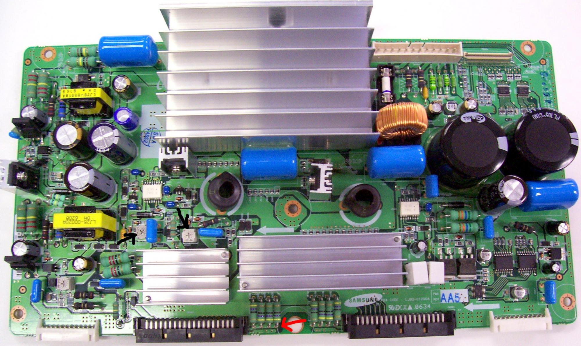

              Post a picture of the Y sustain board. I'll tell you where to test.

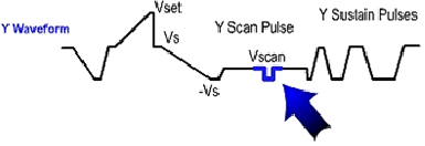

                        Re: How to Adjust Ysus board (LJ92-01200A) from Magnavox 42MF231D/37????
                        Oh, this is a Samsung. Same idea though, but the timings are known as Yfr and Yrr.
                        Turn TV off.
                        Get out a 10x probe for your scope.
                        Attach the 10x probe to the resistor I've highlighted in RED. (VERY IMPORTANT! DO NOT USE A 1X PROBE!)
                        Set the scale to 10V/div or 20V/div.
                        Turn TV on and allow it to warm up for a minute.
                        Adjust the trigger until the waveform starts to look like this:
                        The important thing is the Vset ramp up, and the ramp down. Align the trace so you can see just this. This requires creative use of the trigger and hold-off features on an oscilloscope.
                        Next, get the service manual for your panel.
                        Adjust the upward ramp timing (black arrows) so it is the same as in the service manual.
                        Do the same for the downward ramp timing.
