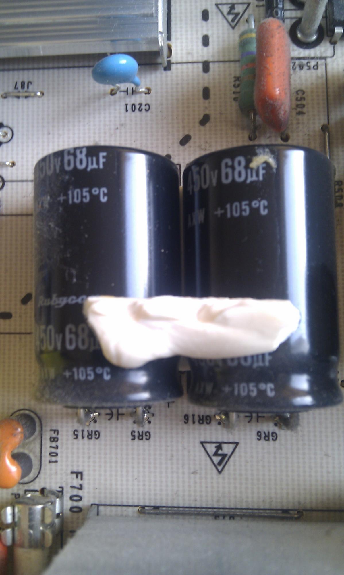

    I have 2x caps on the power supply board that i would to replace, reason of repalcement is that it takes too long to start up the tv.
    Specs of the cap: 68uF/450V AXW Rubycon.
    (See picture)
    I searched for this component on the web, but i could not find anything.
    Any advice of replacing this components with another types?

    Re: LG 32LC51 power supply caps

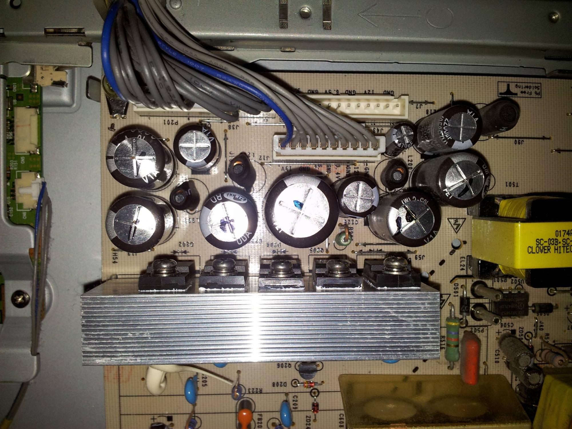

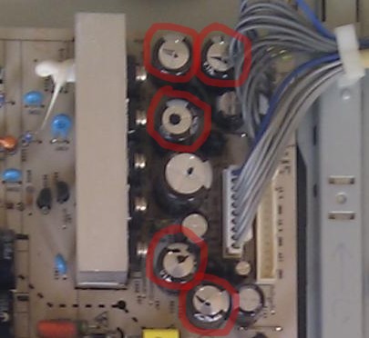

    Don't touch those. You have to replace these ones (2200uF 10V CrapXons)
    edit: actually - change all of them (2200uF, 1500uF and 470uF ? .. picture isn't clear enough). They will all eventually fail.
      Those two caps are on the AC side and:
      - They won't affect start-up time.
      - Those rarely fail - even if they are crap brands.
      - You have Rubycon - which are one of the best brands.
      mob pointed you to 'one of' the places where there are caps that could affect start time.
      Those are the DC filter caps and if bad they will charge slow so the affected DC voltage can be slow to get to the operating voltage.
      Any of them, not just the 2200uF.
      There are other things that could do it but that group of caps is probably the most common.
        Thanks Mob, thanks PcBones for the clear information.
        I was informed by someone that the 2 caps i mentioned were the reason of start up fail.
        Anyways, i hope the affected caps you mentionend are still in stock somewere.
        thanks again

            No, don't use another set of CapXons or whatever crappy makes and series you have in your power board (I remember fixing one 32" LG with that same board that's why I suggested that yours is equipped with bad 2200uF CapXons).
            Please provide a better picture of your caps.
                I agree that the picture isn't clear enough. However, it looks like the majority of Capxons are all bloated. If yes, that would explain your long startup time.

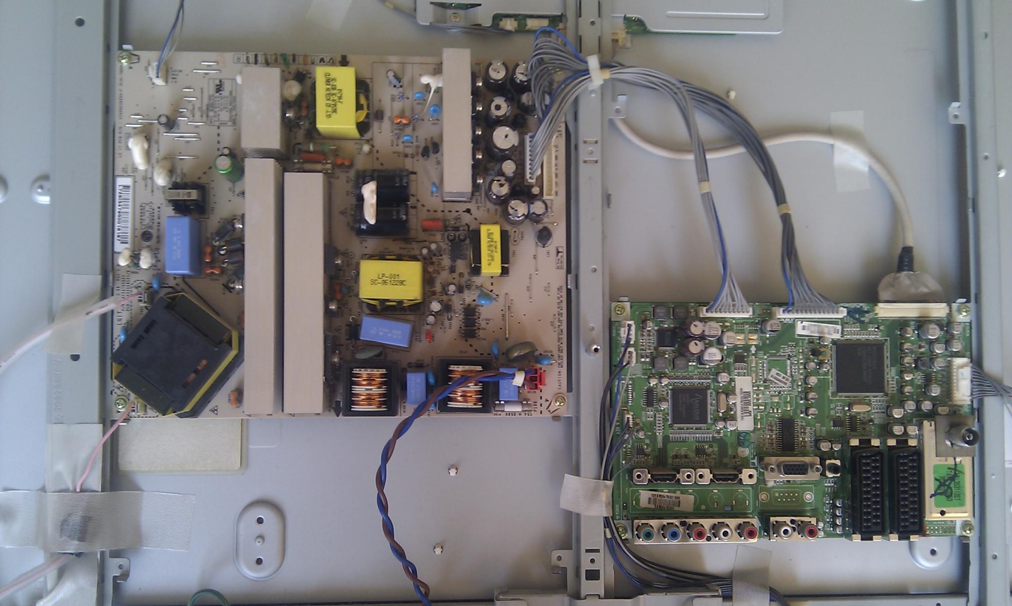

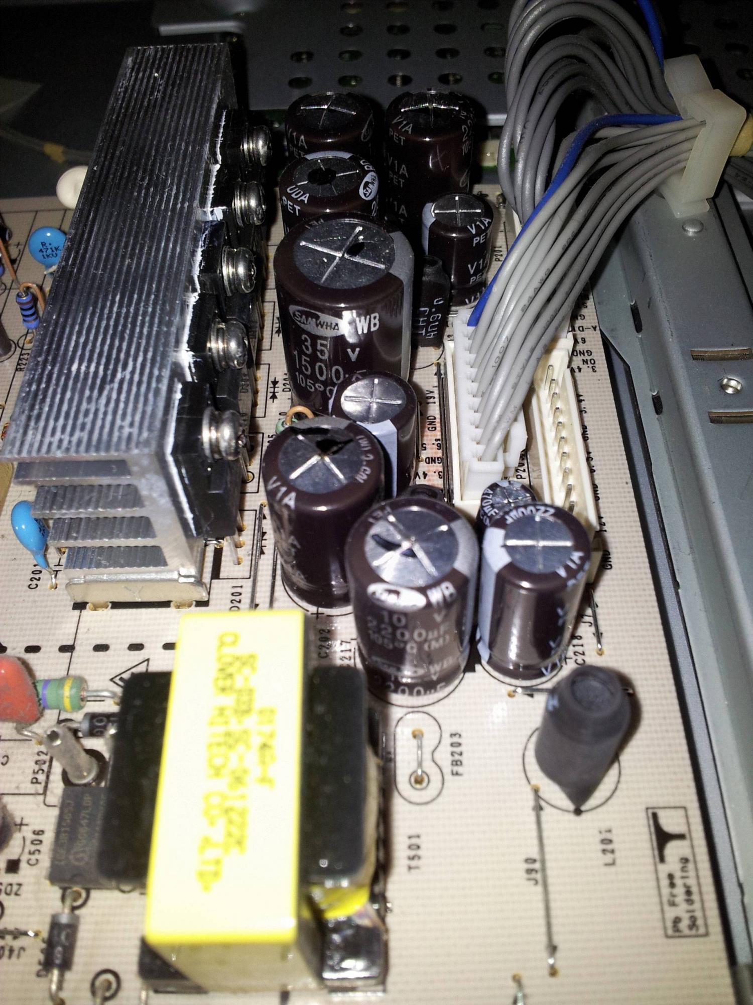

                  Ok, I have made better prictures.
                  Caps are made by "Samwha".
                  @Mob, the specs of caps you mentioned to be replaced are:
                  (beginning from top of the picture)
                  2200 uF/10V
                  2200 uF/10V
                  2200 uF/25V
                  2200 uF/10V
                  2200 uF/10V
                    That info isn't enough. Also need diameter and series to look anything up.
                    I can see the "WB" series mark on some of them but if other series are present you will need those data sheets too.
                    http://www.samwha.com/electric/product/product23.html

                                Ok, i have more details now:
                                C1= 10,25mm W, 13,7 mm H, 470uF/25V RD
                                C2= 12,7 mm W, 22,2 mm H, 2200uF/10V WB (bloated)
                                C3= 12,7 mm W, 22,2 mm H, 2200uF/10V WB (bloated)
                                C4= 12,6 mm W, 25,3 mm H, 2200uF/25V RD
                                C5= 16,4 mm W, 26,4 mm H, 1500uF/35V WB
                                C6= 10,1 mm W, 17,1 mm H, 470uF/35V RD
                                C7= 12,7 mm W, 22,2 mm H, 2200uF/10V WB (bloated)
                                C8= 12,7 mm W, 22,2 mm H, 2200uF/10V WB (bloated)
                                C9= 10,0 mm W, 21,6 mm H, 2200uF/10V RD
                                C10= 6,4 mm W, 13,6 mm H, 470 uF/10V RD
                                • PCBONEZ
                                  Grumpy Old Fart
                                  • Aug 2005
                                  • 10661
                                  Your format kind of threw me for a minute.
                                  Except for 6.3mm it is standard to round dimensions to the nearest 1/2mm - but you wouldn't know that yet.
                                  Figured it out, corrected to the data sheet dimension, and added Ripple [mA] and ESR [ohms] as applicable.
                                  Also rearranged to make it an easier read.
                                  Some of this may have been covered already.
                                  The WB are low ESR.
                                  They are roughly the same grade as Panasonic FM and FR but differing can sizes can make better or lesser ESR grades good choices as replacements.
                                  [Want Ripple the same or more. (Ripple is basically a current -limit- for the AC component.)
                                  [Want ESR the same or less. (ESR can be thought of as the resistance to Ripple.)
                                  [Want the same uF. (If you MUST fudge then go up by one standard value. That's ~20%.)
                                  [Want volts the same or more. (Lacking actually measuring the voltage present.)
                                  [Never get 85C temp rated caps. They don't last as long.
                                  [And of course they have to fit in the the space and not be too tall.
                                  The old and new cans don't have to be the same size as long as they fit and the specs are good.
                                  But: when you change can size consider that the lead spacing might be different. [Mounting consideration.]
                                  10mm and 12.5mm are usually both 5mm LS but not always. Other diameters are usually different.
                                  [C2, C3, C7, C8] WB 2200uF/10v 12.5x20mm - 2360 mA - 0.025 ohm
                                  Some Options:
                                  Panasonic FM 2200uF/10v 12.5x20mm - 2600 mA - 0.018 ohm
                                  Panasonic FR 2200uF/10v 10x25mm - 2470 mA - 0.018 ohm
                                  Nichicon HM 2200uF/10v 12.5x25mm - 2800 mA - 0.012 ohm
                                  [C5] WB 1500uF/35v 16x25mm - 3460 mA - 0.015 ohm
                                  Some Options:
                                  Panasonic FM 1500uF/35v 12.5x35mm - 3750 mA - 0.012 ohm
                                  Panasonic FR 1500uF/35v 12.5x30mm - 3630 mA - 0.013 ohm
                                  ~~ On to RD ~~
                                  The RD are not low ESR so you skip ESR when choosing replacements. [It's not in their data sheet.]
                                  These are aka: 'GP caps', meaning General Purpose.
                                  You still want the same Ripple or more.
                                  That said, most techs I know choose 'entry level' low ESR caps anyway because the QA is tighter.
                                  'Entry level low ESR' means low ESR but on the low end of the low ESR totem pole. [IAW: ESR Grade.]
                                  [It's my term that some have adopted but it's not an official term.]
                                  Those are series like Panasonic FC, Nichicon PW, Chemicon LXZ.
                                  There are probably dozens of 'entry level' series of Jap caps that will work for these.
                                  As long as the Ripple is enough you're good.
                                  The gotcha is that RD [like most GP caps] have Ripple rated at 120Hz and low ESR caps use 100kHz.
                                  There is a conversion in the RD data sheet. [In the Frequency Coefficient of Ripple table.]
                                  I included the Ripple correction to 100kHz in the brackets at the end to help things along.
                                  [C1] RD 470uF/25V 10x12.5mm - 449 mA [674 mA @100kHz]
                                  [C4] RD 2200uF/25V 12.5x25mm - 1235 mA [1420 mA @100kHz]
                                  [C6] RD 470uF/35V 10x16mm - 521 mA [782 mA @100kHz]
                                  [C9] RD 2200uF/10V 10x20mm - 844 mA [971 mA @100kHz]
                                  [C10] RD 470 uF/10V 6.3x11mm - 272 mA [408 mA @100kHz]
                                  I'll let you look for the GP replacements.
                                  Partly because I don't have the slightest idea about what is available in Holland.
