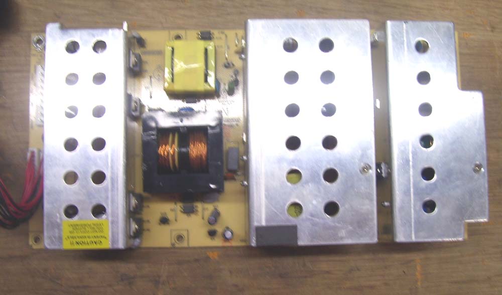

    Polaroid TLA-04641c no stand by power
    I have a Polaroid TLA-04641c with no stand by power. Caps look fine and pulled and tested a few , (have a atlas ESR70) pics attached any ideas/
    thanks mike

    Re: Polaroid TLA-04641c no stand by power
    The big cap reads 152 v with power on
        What is your line voltage? 152 volts is rather low for the voltage across the large cap; that implies a line voltage of about 110VAC.
        There are three ICs on the back side of the board; two toward the top, one near the bottom. What are the part number of those ICs.

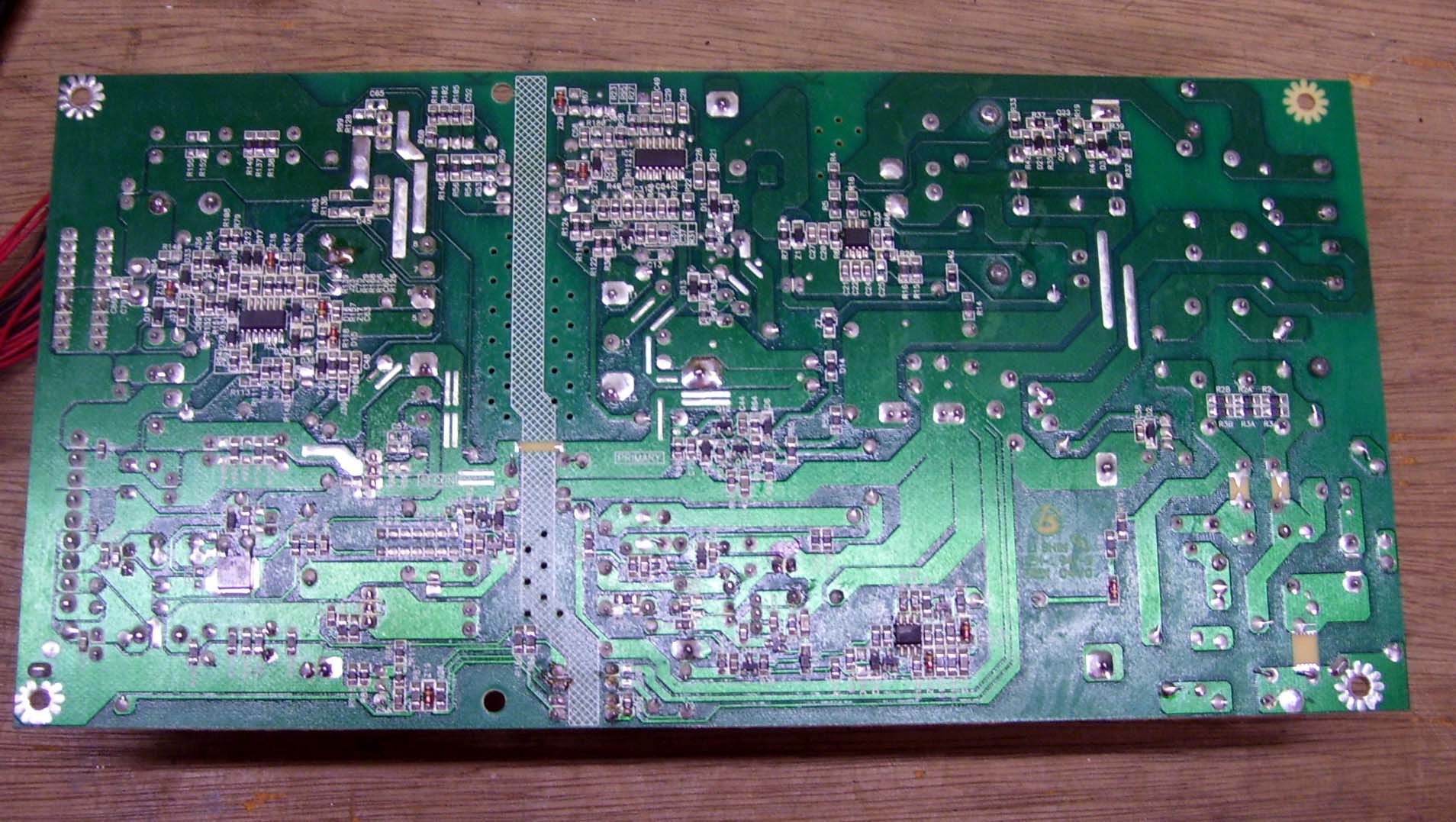

          big 1 top is = L6548D
          small tp = 1653a
          bottom small = 358 ez535 if i see them right
              Originally posted by mcross
              small tp = 1653a
              This looks like the right chip.
              http://pdf1.alldatasheet.com/datashe...P1653ADR2.html
              From the datasheet, it looks like pin 8 is your VCC and startup threshold is min = 12.25, typical = 13.25, and max = 14.5 V DC.
                  No. That's the PFC controller. I'd have expected it to be the small IC near the bottom of the picture, but '358' would be an LM358 dual op-amp.
                    Of the 3, that looked the most promising since the other is an ACPI regulator for DDR memory.

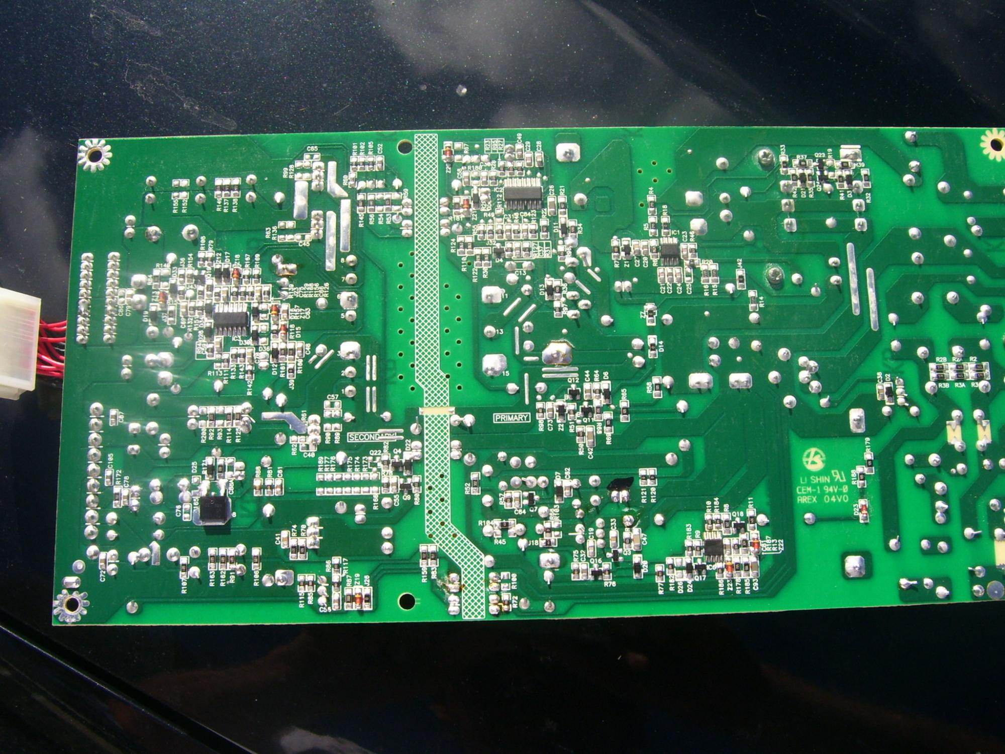

                          Better picture guys

                            Re: found dead disc cap 331k 1kv
                            found dead disc cap 331k 1kv near transformer, i can i replace it with?
                              A 330pF, 10% 1000 Volt ceramic capacitor, such as TDK CK45-R3AD331K-NR; Murata DEHR33A331KA2B, or Vishay F331K29Y5RN63J5R.
                                still no stand by , time to look for new ps i think
