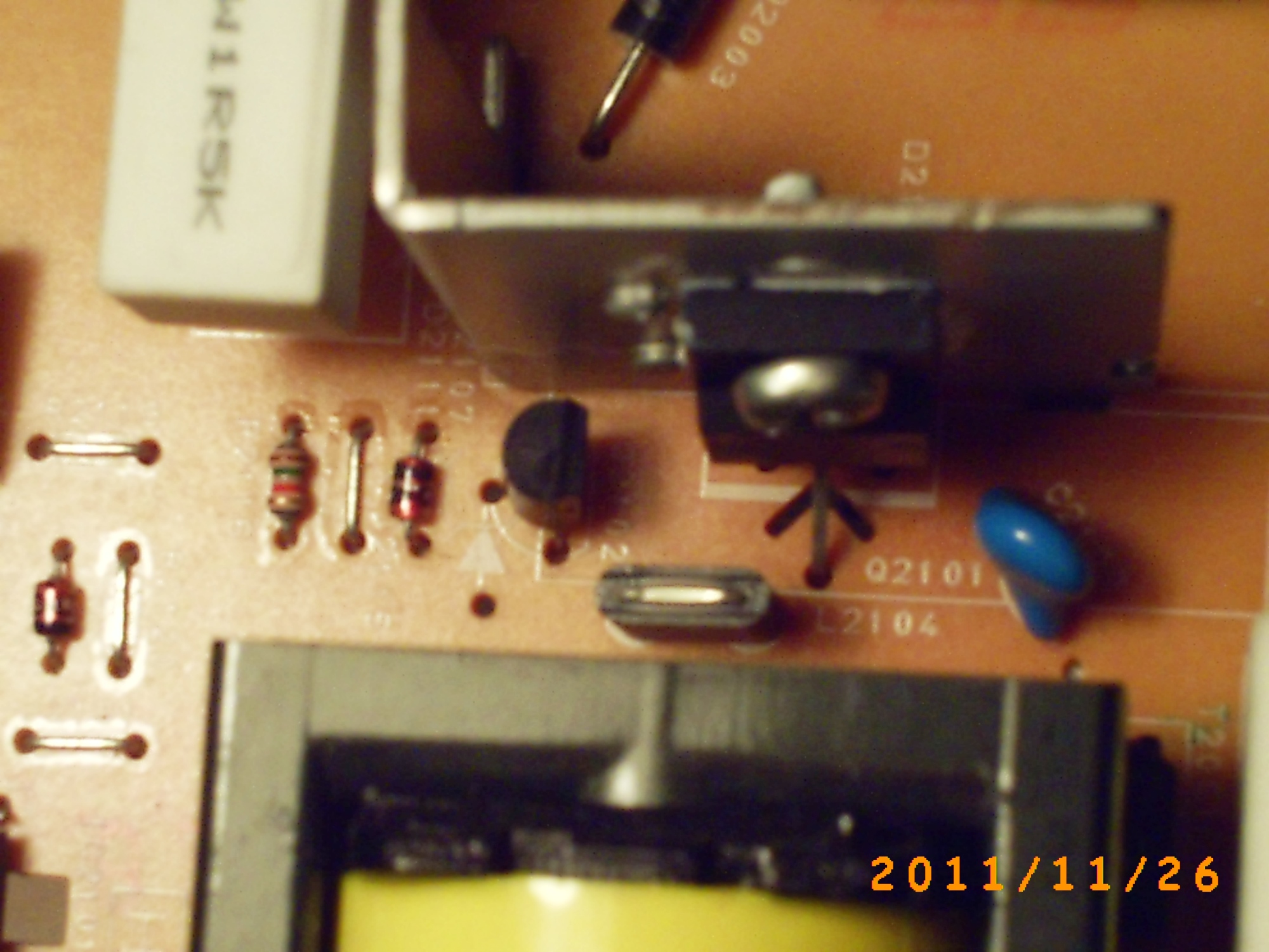

    Thanks PlainBill, Ive tested the zener as you suggest & im getting a reading of 1.1 both ways so whats next?.,,,,many thanks.
    1.1 What? Ohms? In circuit or out of circuit? Where is it; I haven't been able to locate it on the pictures? Details like this are important, and that certainly sounds like the zener is bad.

      Ooops sorry PlainBill I meant to say its out of circuit, With the meter set at 200 ohms the reading was 1.1 which i presume is ohms, The zener board position is D2107 (see pic) sorry its a little bit fuzzy.,,,cheers.
        Re: Toshiba dvd/hd recorder RD-88DT-K-TB dead.
        Would seem bad then, but could you check again on the diode range?
        The problem is going to be identifying the voltage of the replacement to be used. It might be possible to infer it from the circuit, but a schematic is often necessary. Finding one could be difficult.
        Edit: Spoke too soon. Here it is: http://elektrotanya.com/toshiba_rd-8.../download.html (Not an exact match to your model, but Toshiba list the RD-88DT series as being the same as RD-88DT-K-TB; I'm guessing the -K-TB is only a variant or something.)
        There's a layout on page 61 and schematic on page 49.
        The part number for D2107 is 27BSB-T26. A 27V Zener diode. Member of the BZX series, datasheet here.
        It would seem the diode is involved in limiting the gate drive to the MOSFET. I would not have guessed that from the board or its position.

          Tom you are a star!, ive now d/loaded the schematics & hopefully will be able to find the culprit, i`ll keep you posted,,,,,,Many thanks.
          Just one other thing, the link to the BZX datasheet takes me to datasheets for BZV series I was just wondering why?.

            Ah yeah, my error. BZV is surface mount and would be a bugger to solder to a through hole PCB. Here's the BZX datasheet.
            But almost any 1/2W zener diode would probably work.
