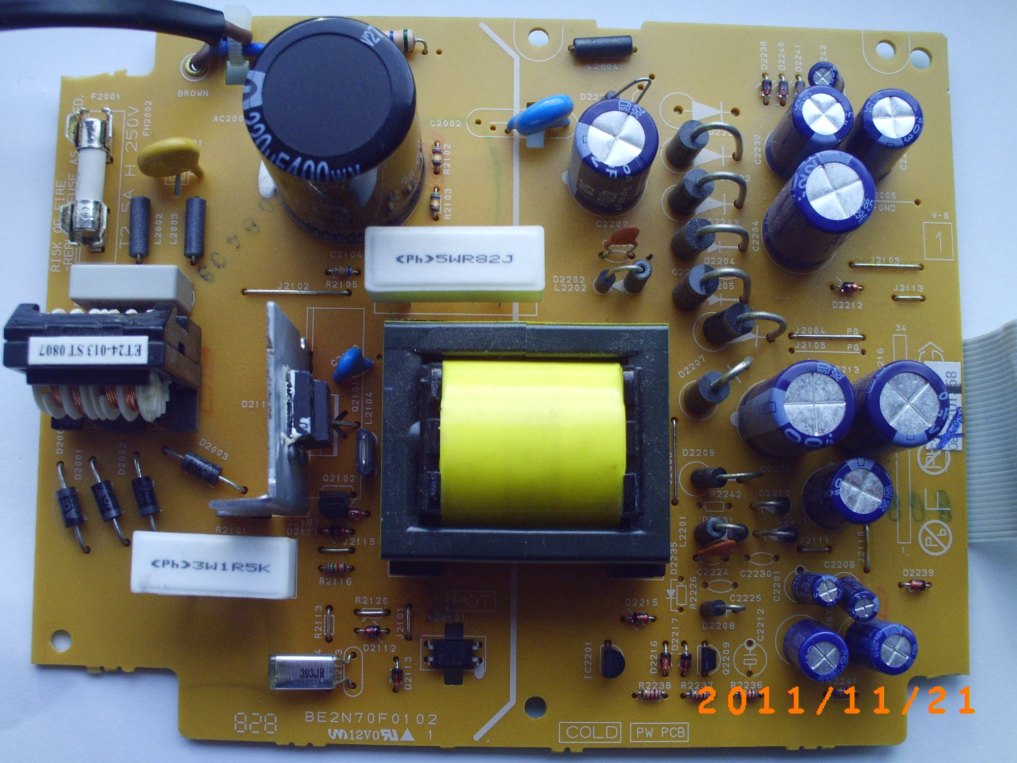

    Hi again, I hope ive listed this in the correct place, As in the title my dvd/hd recorder has gone dead, This happened after we had a power cut recently,
    A visual inspection of the power board shows nothing obvious,
    Im in the process of removing the fet (K3798Q)as i figure this might be the likely candidate as the diodes on the `hot` side check out fine, Now ive never tested one of these before so this will be another lesson learnt (any pointers?),
    The powerboard number is,,,BE2N70F0102,,,,,Many thanks.

    first check the fuse should read short circuit
    check d2000 to d2003
    check R2101 1.5 ohm
    check the Q2101- Q2102
    D2107 - d2111
    IC 2101 optocupler & D2112
    check 5W resister 0.82ohm
    then check all the diods by the caps on secondery side
    hopefuly by then you should have found the faulty componants.
    google how to check fet.
    Tony
      Re: Toshiba dvd/hd recorder RD-88DT-K-TB dead.
      Does the fuse check out fine?
      Do you get 150 - 350V across the main cap?
      Does the big white resistor check out okay? (1.5 ohms?)
          Originally posted by froggy
          Now this might be a daft question but i guess ive got to check everything off board, I am a beginner to this sort of thing so youll have to be patient with me, anyhow so far the fuse is fine, the d2000-d2003 check out fine, The Q2101 I thought was a fet or have i got that wrong?, so much to learn I guess!.

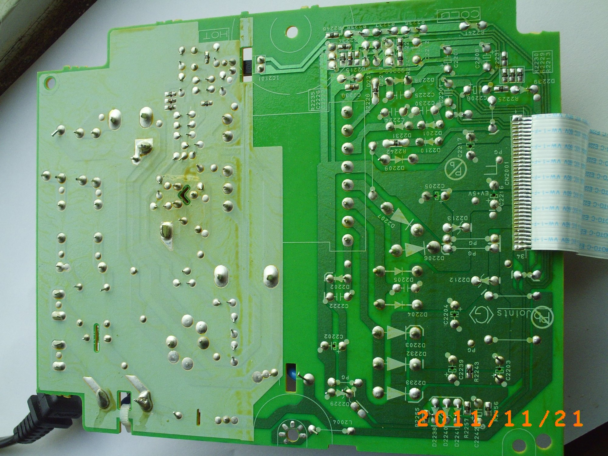

          Sorry to jump in here, but you may be going about this the wrong way. Looking at the bottom of the board, there are actually only 9 outputs. On the 34 pin conductor they are 1, 2, 3, 4&5, 6-19, 20-23, 24-29, 30-33, and 34. Pins 6-19 are ground.
          The first step is to measure the voltages from 6-19 to the other 8 pins or groups of pins. Next, carefully measure the voltage across the 220uF, 400V cap. All of these tests are done with the power on, so be careful.
          Ordinarily, basic tests can be done with the power off and the components in circuit. In most cases the resistance of a shorted diode will totally swamp any other resistances, so check the resistance across each diode with the DMM on the 200 ohms scale. If any check read than 100 ohms, unsolder one end and recheck.
            Thanks PlainBill for the tip, unfortunately I had already removed the fet & a transistor (Q2101-Q2102) so thought it was as well to test them rather than refitting so i could power it up,
            The fet as far as i can make out is suspect, I say this as ive tested it two different ways as suggested on google & it didnt do as they said it should,
            I`ll be getting one ordered & in the meantime i`ll go through the rest of it just in case something else has been taken out.,,,,cheers!.

              Are you sure about the part number K3798Q? No results on Google for it. Can you post a pic of the part?

                    Im having problems indentifying a zener, The markings are `27B`, does anyone have any idea where I can get the spec for this please or know an equivalent for it?....Many thanks.
                      That is a member of the BZX27 series, a 1.3W axial zener diode. Datasheet here. You'd need the voltage too, which is usually written like "5V6" or "22V".
                      Zeners can fail, but why do you think it has? They usually become short circuits both ways when they fail.

                          Zeners are just like any diode. Almost always they fail short circuit. Test both ways. If you get less than about 50mV both ways, I'd consider it failed.

                                  Most FETs fail short circuit when they go bad, so usually the fuse goes bang at the same time. (Also check the plug fuse, this can sometimes go too.) Often this is accompanied by a loud bang while you are using it and then it goes dead.
                                  For zeners it really is as simple as checking using the diode test mode. You should get about "500" or "0.5" one way and infinite (usually "1 ." or "OL") the other way.
                                  I would advise you replace the FET if the fuse is not blown as it's probably not the problem.

                                    Thanks Tom, Well I checked the fuses both in the plug & the one on the PCB & even the mains cable & they are fine,
                                    Now back to the zener, basically I checked it on diode setting both ways & got a constant `beep`from the meter either way so im assuming it is u/s.

                                      Don't use the 'beep' from a continuity or diode test for anything except finding out if point 'A' is connected to point 'B'. The resistance which is considered a short can vary widely.
                                      My preferred method - set the meter to the 200 ohms range. Check the resistance across the zener. Reverse the leads and check again. The resistance should be over-range in both directions. If it reads less than 1 ohm, the zener is shorted. THEN we can start figuring out what voltage it should be, based on where it is in the circuit.

                                        Thanks PlainBill, Ive tested the zener as you suggest & im getting a reading of 1.1 both ways so whats next?.,,,,many thanks.
