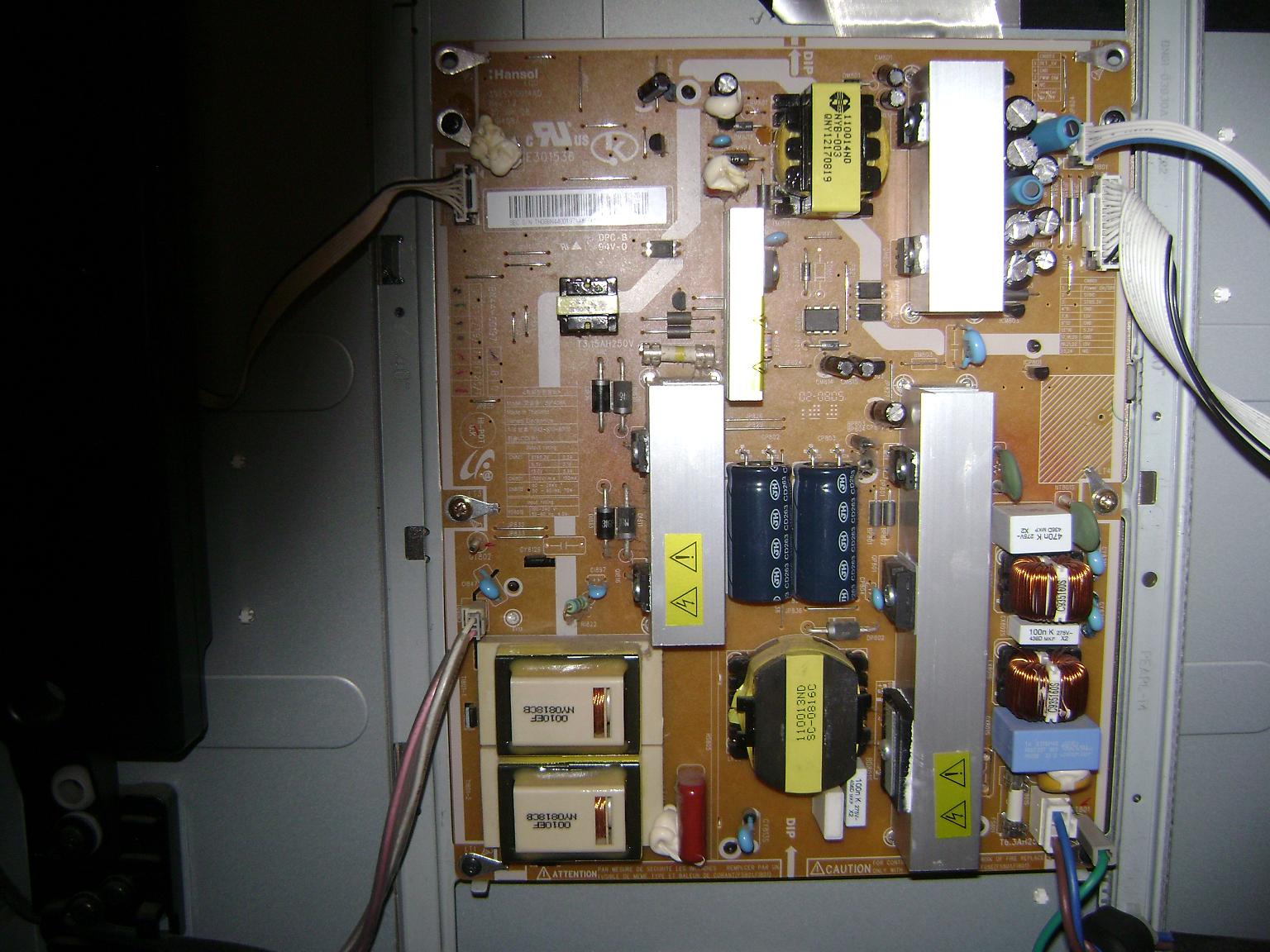

    This set had already been recapped but the failure continues. I was told that it would shut down from time to time.

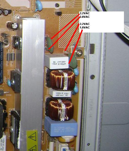

    Checking this power board, there are two components that I'm not sure of. These two green components are hotter than crap and may be close to a thermal breaking point. There is no significant voltage drop across it AC or DC, so I'm guessing it's a current component. These heatsinks get pretty warm as well. Like remove finger after five seconds warm. I need to know how to proceed. You can see also that the two green components have gotten hot enough to change the board color a little in that region. They have resistor markings on the board in their position.

    Thermistors. They normally run hot.

      I could not see if there was a cap in the board that has shrink tubing around it. I have had a few of these come in with the tubing and the caps were bad from excessive heat build up.. The caps that had the shrink tubing insulation were small values.
      Check the inverter transformer with a flyback checker to see if any are breaking down. An old flyback checker like sencore 48 would work.
      Just a couple of ideas

        Re: Samsung LN40A530P1F - Shuts off from time to time
        Thanks for the help guys.
        The heat shrunk components are inductors.
        I still have a bad feeling I'm chasing down a temperature related problem. The heatsinks are warmer than I'd like them to be. This set has not shut down since I got it from the person that complained about the problem. The difference is that I have the back off and it's in my garage/shop, which is cooler than normal. Maybe it's getting the ventalation to barely keep it going without a problem. This sucks!
        I'm thinking about ordering a replacement board just to see if these are normal temps. Intermittent problems are the worse. I take that back, samsung is the worse.

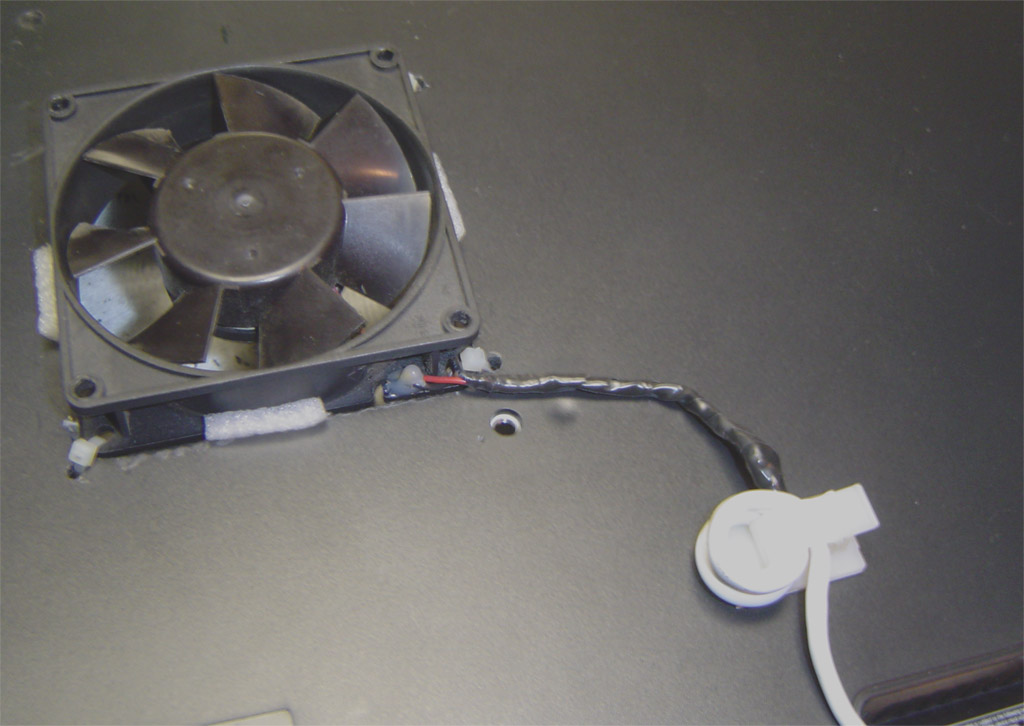

                I garbage picked this same tv last summer and had a similiar problem. Mine would run for 10-15 minutes then I'd lose the video on it. I recapped the PS with slightly higher voltage on the caps and it "appeared" to be working. A few weeks went by with it working fine and all of a sudden the problem was back. No video but sound was fine. Power it off and back on and it would continue to work. It appears to be a heat issue in my case. I'm going to save up for a refurbed PS. For now I modded a fan into it to blow on the area that gets the hottest and it works fine. Mine does'nt power off it when this happens. I did'nt mind cutting a hole in it since I'm going to keep it for personal use in one of our bedrooms. They even threw out the remote with it.

                  ^ I did a similar fan mod on mine, but mainly because the PSU runs so ridiculously hot you can easily burn your fingers on the heatsinks (don't try that while it's running.. they're live)
                  Mine now has an 80mm fan running at ~3.5V at the back where the VESA holes are.
                  It's fed from an adjustable voltage regulator on a piece of scrap PCB, which in turn is fed by a switched 13V output of the PSU.
                  The tiny bit of airflow that thing produces already made one heck of a difference. The PSU is now running about hand-warm

                          That sounds pretty cool. Mine is a usb fan that has to be plugged in on a separate power source because the only usb port on the tv is the service port and I was afraid to try it out plugged in there. Don't want to chance ruining a board. If you get a chance sometime do you think you could post some sort of instructions how I could wire mine up like you did? For me pictures work the best. I'm pretty limited on my knowledge of this stuff.
