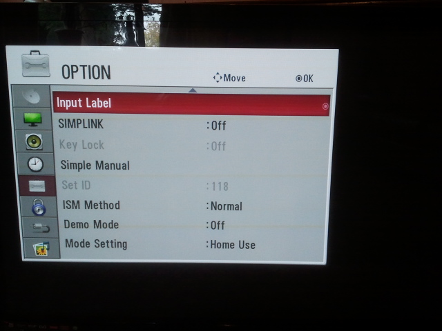

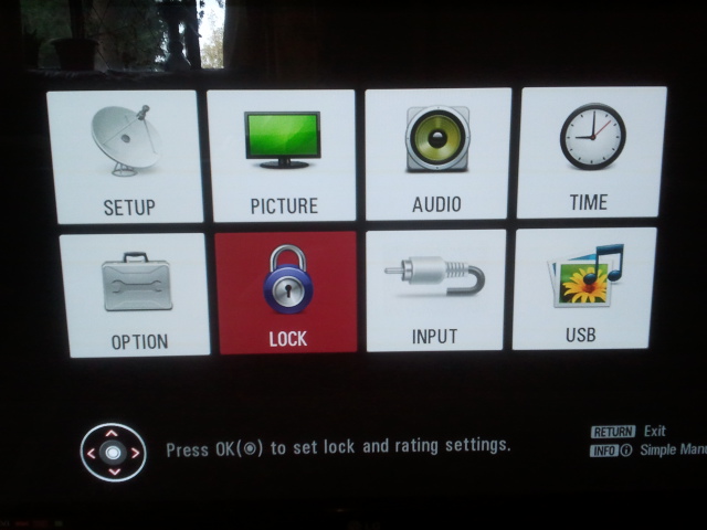

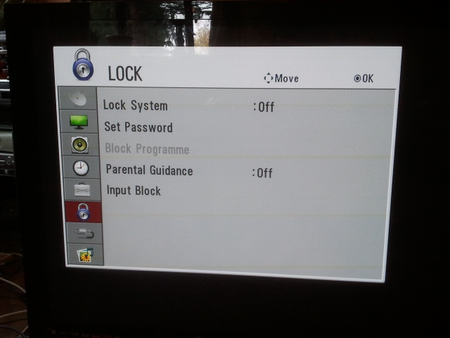

                            Can you post a picture of the service menu?
                            We aren't magic, and the service manual isn't helping - so let's take a lucky guess at where the shop/hotel mode is.
                            • buffy
                              • Nov 2011
                              • 20
                              Re: lg 50ps3000 no picture no signal warning in foriegn language
                              Please see photos attached of the menus available

                                had a talk with lg today about this fault and they told me how to do a factory reset,the option for this is should be in options where i have been looking all along, this option is no longer in the menu,it has gone, it has disappeared, its vanished???. any ideas would be wellcome .
