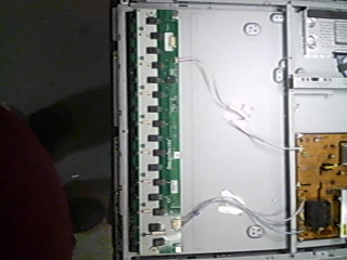

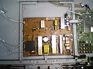

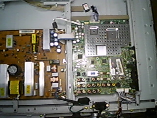

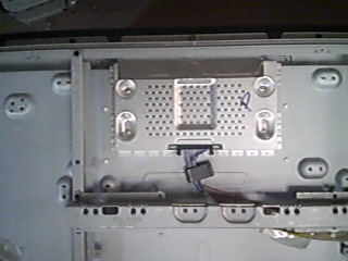

    Samsung LNT 4053H powers up for about 90 seconds but back lights never come on. Checking capacitors show nothing bad.
    The inverter board's fuse is good. All the voltages are checking good on the power supply board.
    Is this just an automatic inverter board replacement??
    Can the T Control module cause the inverter backlights not to work??
    These are the following pictures...
    Thank you for your help
    Bill

    Thanks for including photos but they are so far off, it's hard to see any components. My advice would be first to verify if there is a picture present when the set is on by using a flashlight. Is there sound as well? If these both are present then I'd check the inverter board. Usually they will have their own fuses. Also you can check for burned transformers. Give this thing a good visual and see if you dont find something.
