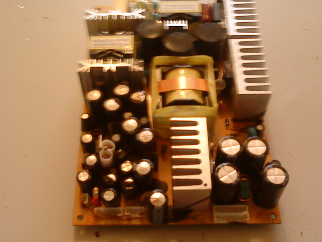

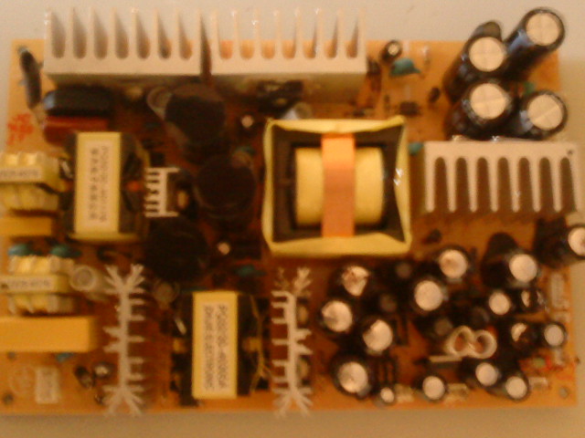

    Symptoms: not even turning on(ex. no lights)
    Dismantled it and found allot of bad capacitors with the top exploded and allot of discharge on the board and a few scorch marks around heat sink.
    8x ksd 25v 2200uF 105% (some leaky others where buldged)
    6x ksd 10v 1000uF (some leaky others buldge, 1 normal)
    1 ksd 16v 1000uF (fine)
    What should I replace these with (higher volt capacitor?) and will any of the other stuff on the board need replacing?
    Thank you hope I have made stuff clear, I'm new to this kinda stuff.
  • retiredcaps
    • Apr 2010
    • 9271
    Re: Sansui - san2701 (hd tv) Australia
    Start with replacing ALL the electrolytic capacitors regardless if they are bloating or not (including all the little ones). Stay with the same uF and voltage. Make sure the replacement caps fit the diameter and height restrictions that you may have with tight spaces.
    Members here like Panasonic FR or FM series (low ESR caps which are required for a SMPS) for replacements. If neither are available as the 1st choice, then go to Panasonic FC series.

      Ok thank you. will this thread stay open so if I have more problems I can just use this one.
      Also I will look at getting some better pictures. Phone ones aren't making the cut.
      • retiredcaps
        • Apr 2010
        • 9271
        All the threads stay open here.
        Don't bother. We can see the bulged caps. Replace all the caps and retest. Chances are that is all that is required.

          I'm wanting to know what these rubber capacitor looking things are. They are round and have radial leads but they are attached to the side of the cylinder not the bottom like a capacitor and are insulated with a rubber tube.
          I'm wondering about the polarity because I pulled on out thinking it was a cap, does it matter or will I need to work out that.
          on the circuit board it had a squiggly line.
          Cheers in advanced

                Sounds like an inductor, but perhaps you could post a picture to be sure.
                Most inductors have the circuit legend L and a number beside them.
                Most inductors don't have polarity and can be fitted either way. The exception are those with more than two terminals, these are tapped and it is important they are refitted as removed.

                  its a inductor thank you sir. so it won't matter which way I put it.
                  Now just waiting on 3 more caps from the usa.
                  snap mount capacitors will still work on a board won't they?
                    No need to replace the inductors, they rarely fail.
                    You cannot use snap mount capacitors. You need normal radial lead capacitors.

                                    Well just over two years this lasted now a Disc Capacitor has just gone and died.
                                    We heard a POP.
                                    Anyone know what I can replace the disc capacitor with?
                                    its a 151 1kv...
                                    I am unsure what the 151 means and the 1kv means.
                                    Any help to make this tv last until the screen dies would be good.
                                    • Amraks
                                      • Nov 2011
                                      • 725
                                      150pf
                                      1000v
                                      Is this what that code means??
