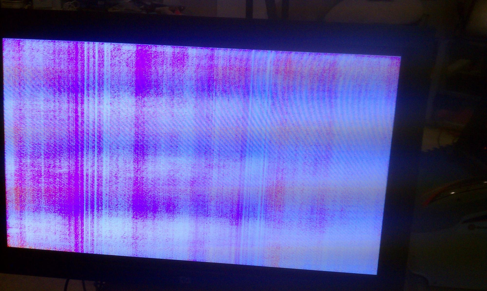

    hey guys.. my hp pl4260n plasma was working great one day and then the next i got this next day (see link). So this tv has been replaced and has been sitting in my basement with much thought of what to do with it. Until last month when my Samsung went out with a simular issue. On the Samsung i was able to replace the buffer boards and now that one is back un and running.
    http://www.youtube.com/watch?v=ES3n9F_ob6k
    So the question is: Can the HP PL4260n be fixed.?
    my thought is either the digital board or the buffer boards..
    Thoughts?

    Yes it can be fixed. The problem looks at though the buffer board has gone. There is only on long buffer board on this one as it is the LG 42X3 panel. Pictures of the back of the TV will help you get more definitive answers or help in finding the problem.

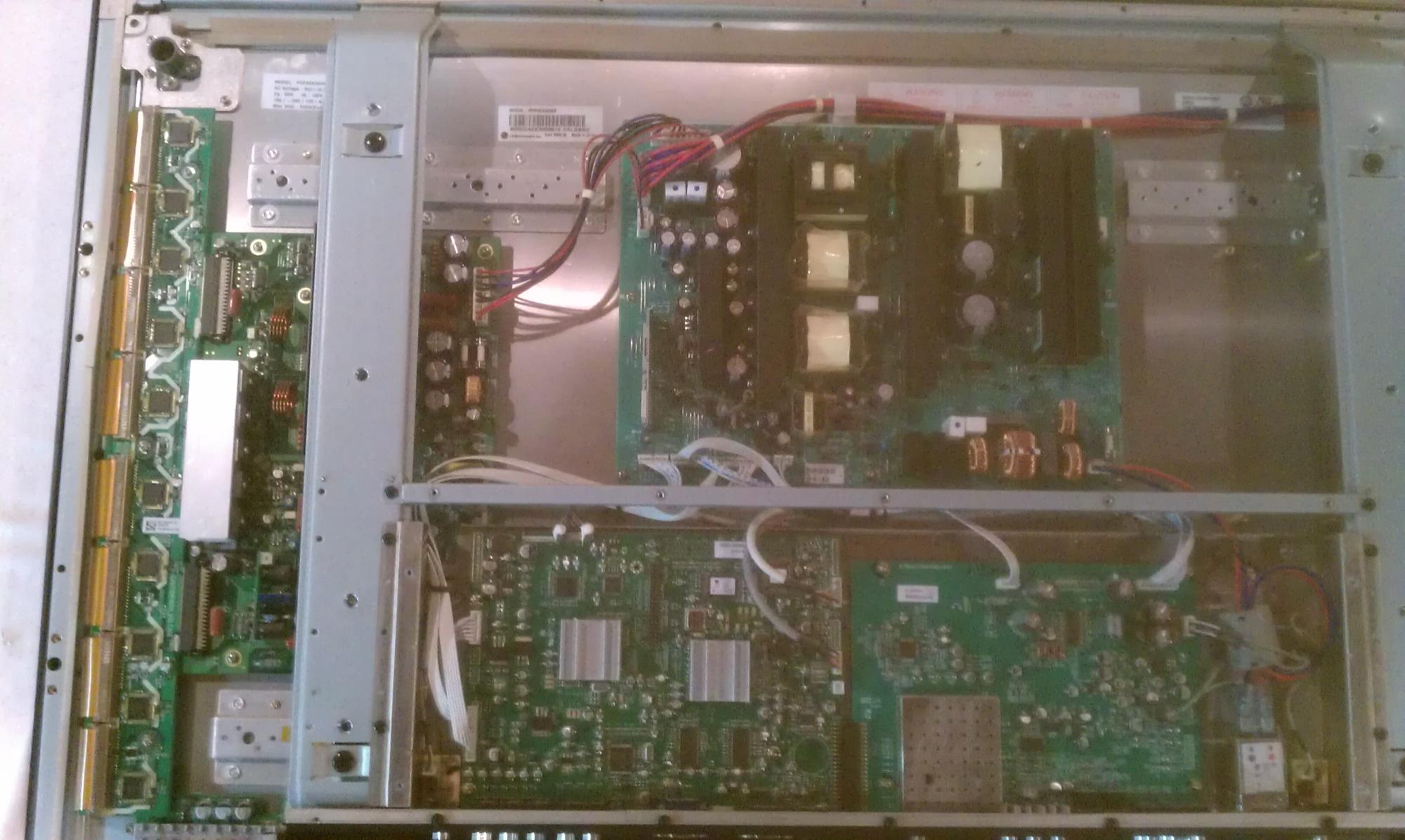

      Here's a shot at the open backside of the Hp tv.. Looks as if the buffers are long the left side..
      thoughts on the best places to get repaired or replaced?
      see attached images

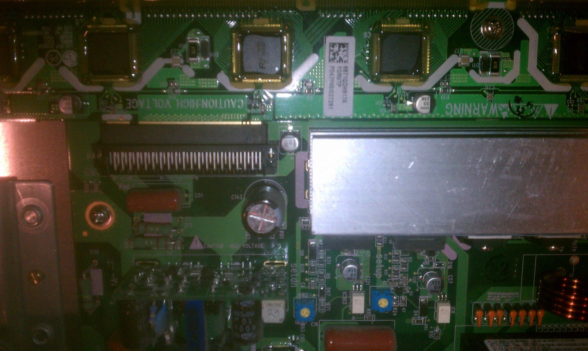

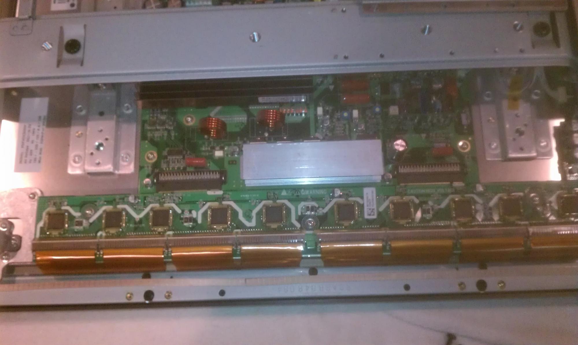

        Here's a couple additional pics of the buffer boards..
        any help would be helpful and if anyone knows a great place to get some of these components
        Thanks!

              thoughts between either the buffer board and the YSUS main board, i've had one comment on anther board that it's NOT the YSUS board
              thanks!
