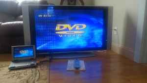

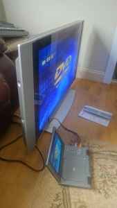

    Thinking of buying lg du-42py10x
    this guy says that there are stripes all on the left side of the TV and my research tells me that this is a pretty common problem but no one seems to say what it is that needs replaced. I want to have at least a decent working knowledge of what may be wrong with the TV before I spend the money on it. I'm thinking either the y-sus or z-sus but any suggestions would help. Thanks!!

    Re: Thinking of buying lg du-42py10x
    How about taking a decent picture of the TV? If the stripes are horizontal, the problem is probably a bad Y buffer. If they are vertical, it's either the X-buffer or the panel.
    Given the age of that TV, anything over $25 is too much to pay.
      ya they aren't the greatest pictures but I didn't take them, that is what the guy sent to me. Thanks for the input though
